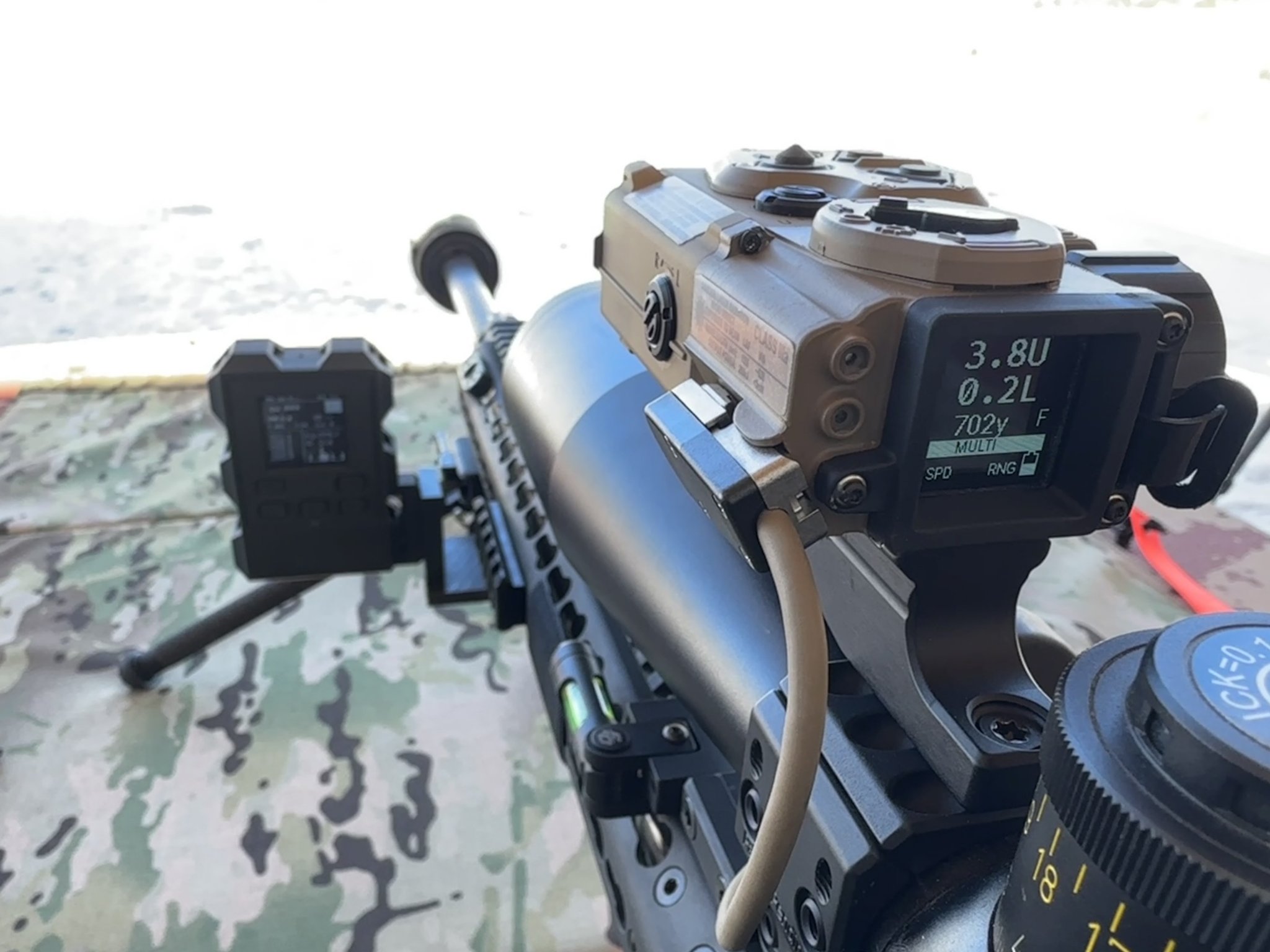

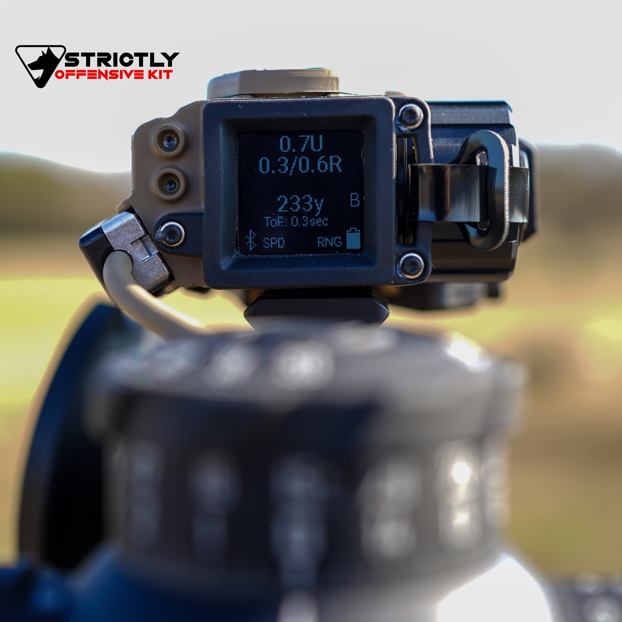

Those who have hands on, can you compare digit size readout on display to both original Raptar and the new one with AB that has two lines of display. The later is too small for me to see, and I'm afraid that the MARS-L unit readout will be too small also. Maybe a side to side comparison picture would be best.

I will cover this in a review later on. I've had this thing in hand for a while and want to make sure I've done it justice before sharing my thoughts.
Short answer is, there's a lot of adjustment in the MARS such that it really feels apples to oranges relative to the Raptar. From a display perspective, it's still small, but larger than the Raptar. The entire unit is only about the size of a business card.

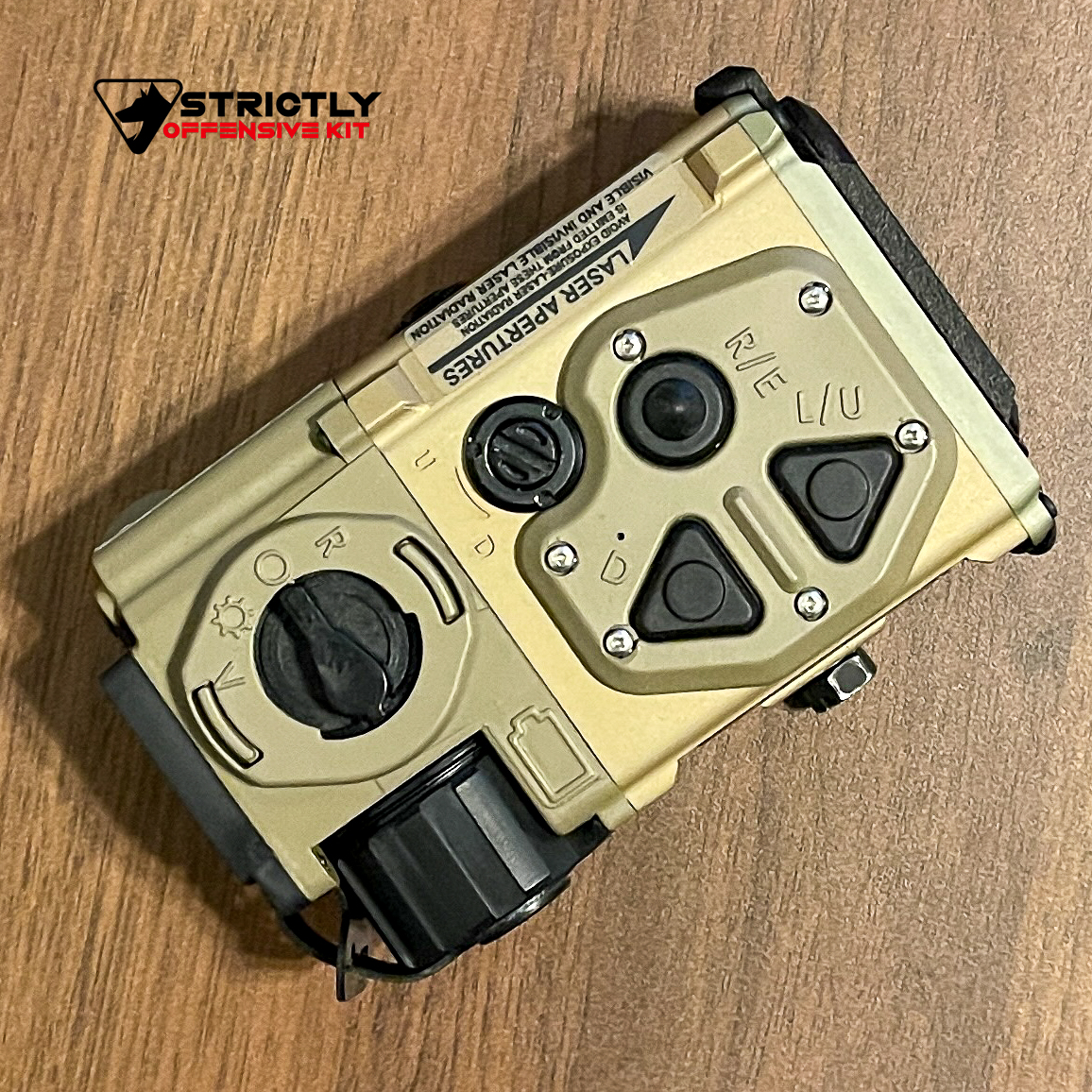

No IR laser?
It seems no IR Laser, if they put was VSCEL IR it could have been another selling point. Is the RAPTAR Edge emiting or VSCEL, I have a short duration looking at a RAPTAR that the owner kindly let me look at the illumination while I was under NODS. It seems like it’s edge emitting. Anyone can confirm if RAPTAR is edge emitting?
There is no IR laser. Just a VIS laser. The MARS LRF is a VSCEL. No idea about a RAPTAR. Can confirm the MRF Xe is a similar VSCEL LRF module.

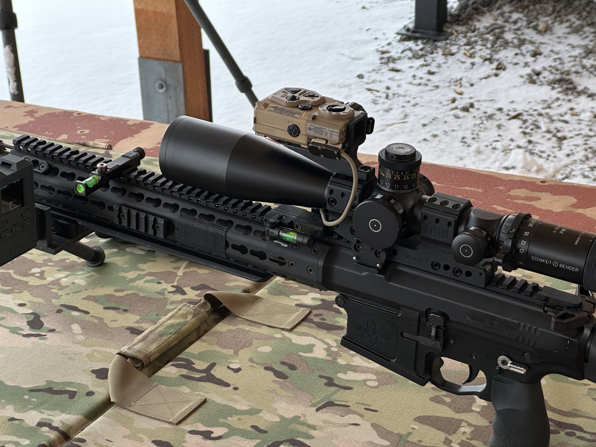

I am remaining optimistic. I believe the divergence of the 21 is .4 x .7 mil. So that's 14.4" x 25.2" @ 1k and 28.8" x 50.4" @ 2k.
Only source I could find on the Raptar says <1mil. So to me that means just under 36"x36" @ 1k. Just under 72" @2k. Assuming the beam dimension is circular. Well over 3moa.
The factor that's unaccounted for with WMLRF is the mount variability. The two best I tested still had a +/-.5mil of flex with horizontal force, vertical force seemed dead nuts. But, both had RTZ with no force. So overall mount variability "can" still be an influence.
