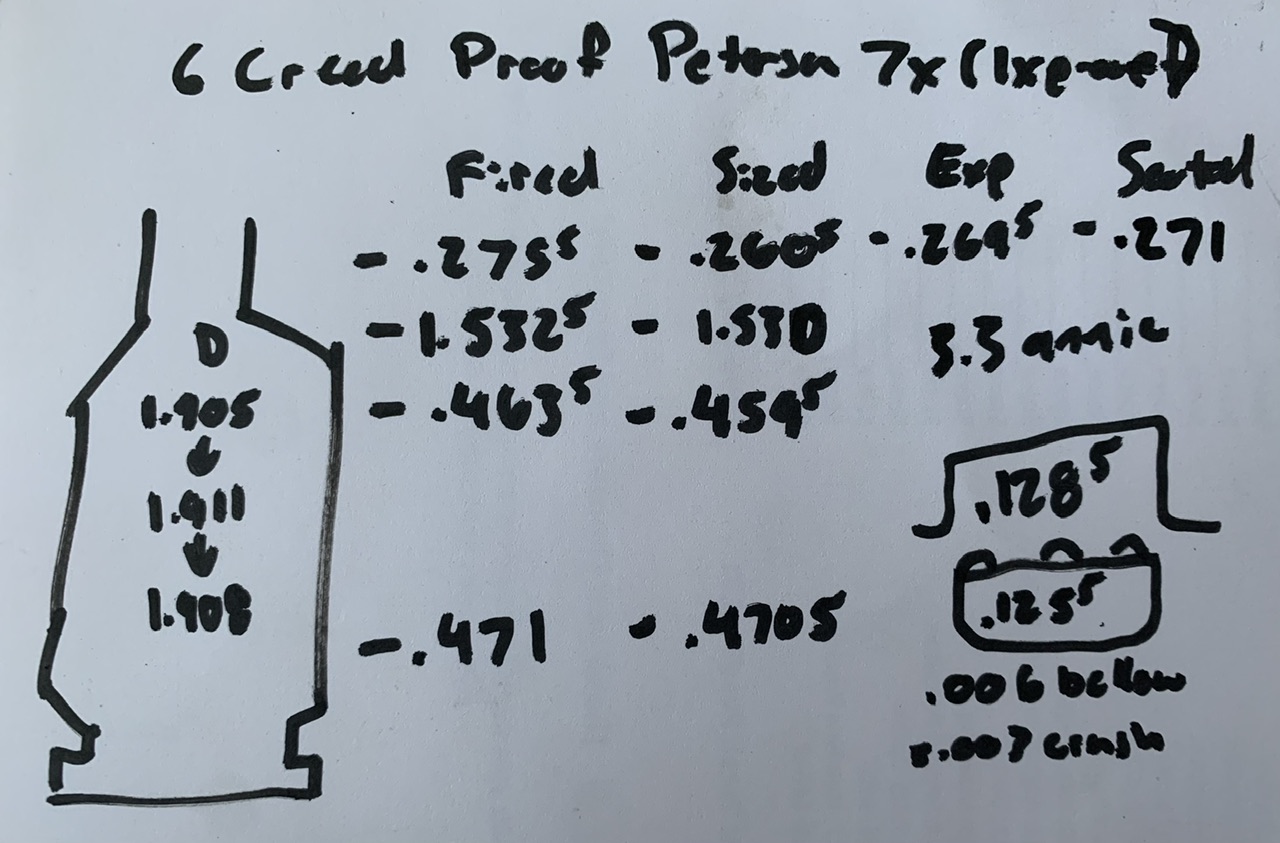

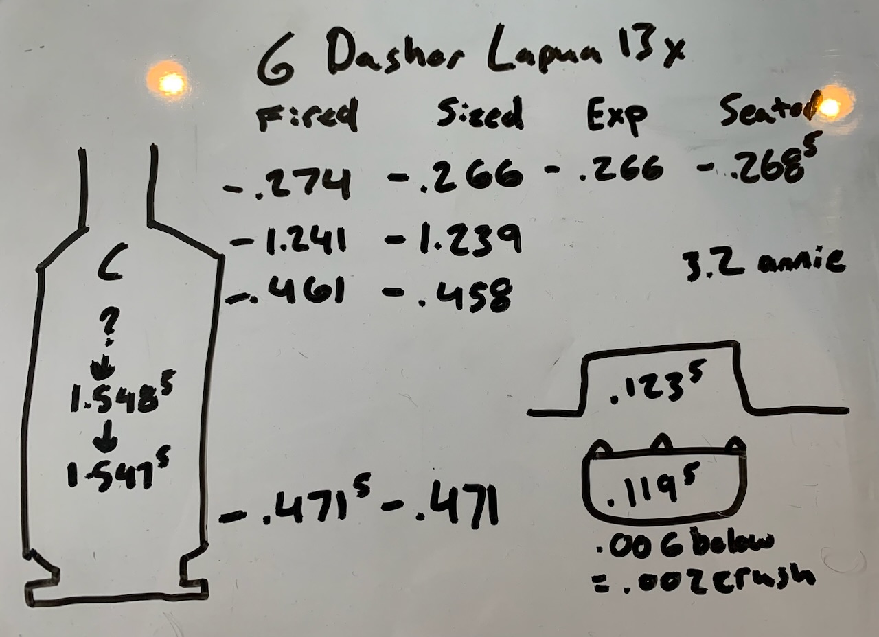

How much is that die sizing the neck, fired dia vs sized dia?
*vs loaded
If his forster dasher matches mine it’s .265”. I sent mine off to be honed without first using it asking for .265 and they mailed it right back telling me that already was their spec on it. Now I check before shipping lol
But what is the fired dia and loaded dia? How much is it moving the brass?
I’ll let him speak for his but here is mine with lapua. In this case, basically none at all. Sometimes the miti calipers will read .2665, I can feel it touch but it’s light and is really just fine for feel good reasons.
But in the case of the 6 creed that came with too much and I’ve failed to send it off yet it makes a world of difference
