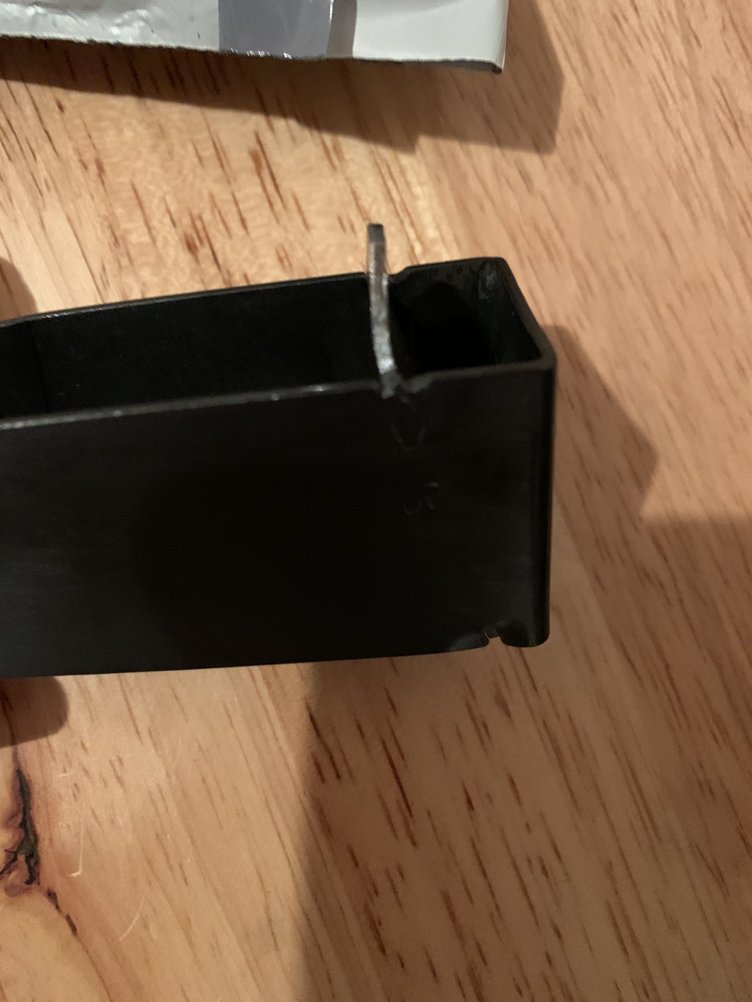

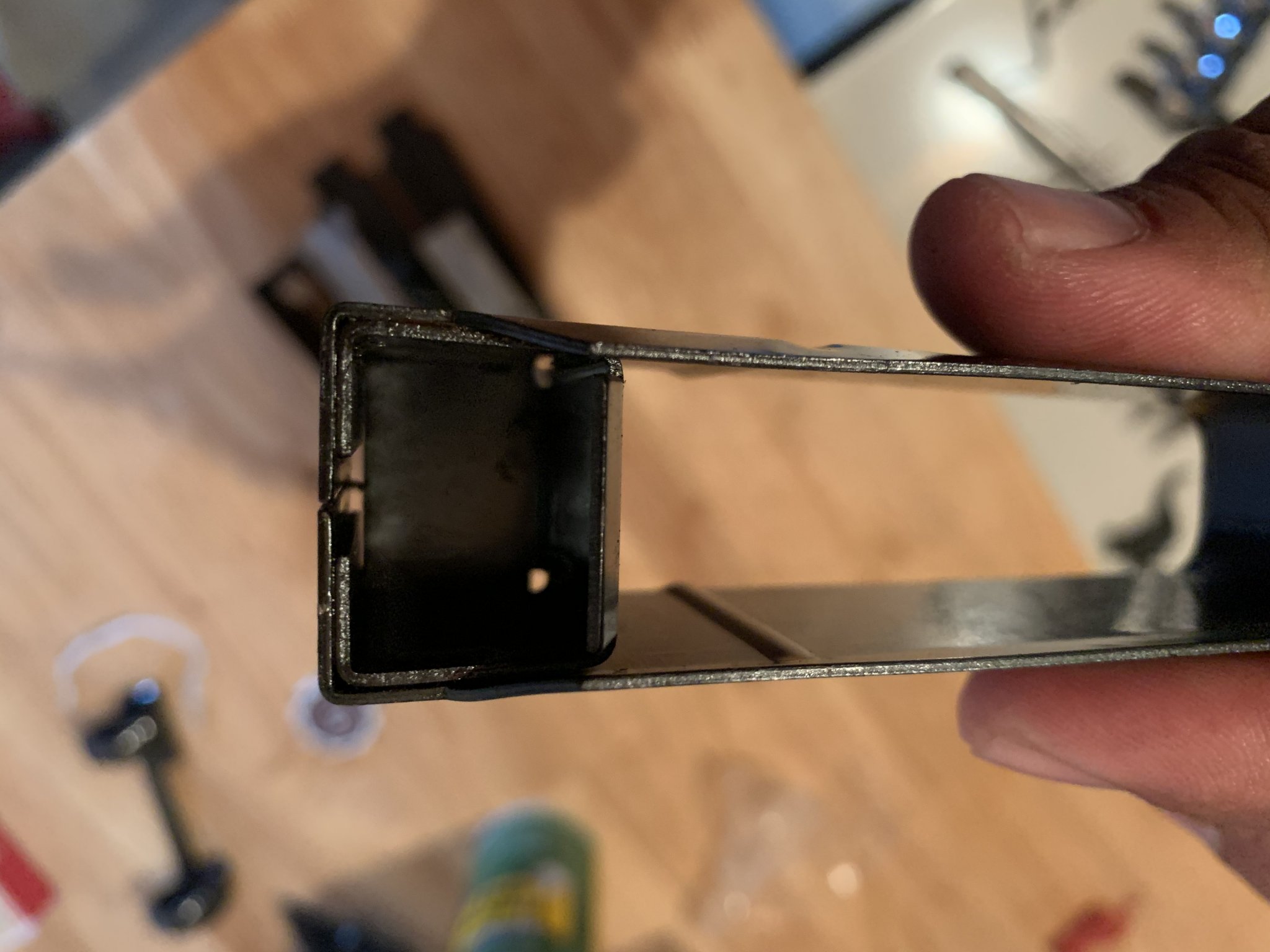

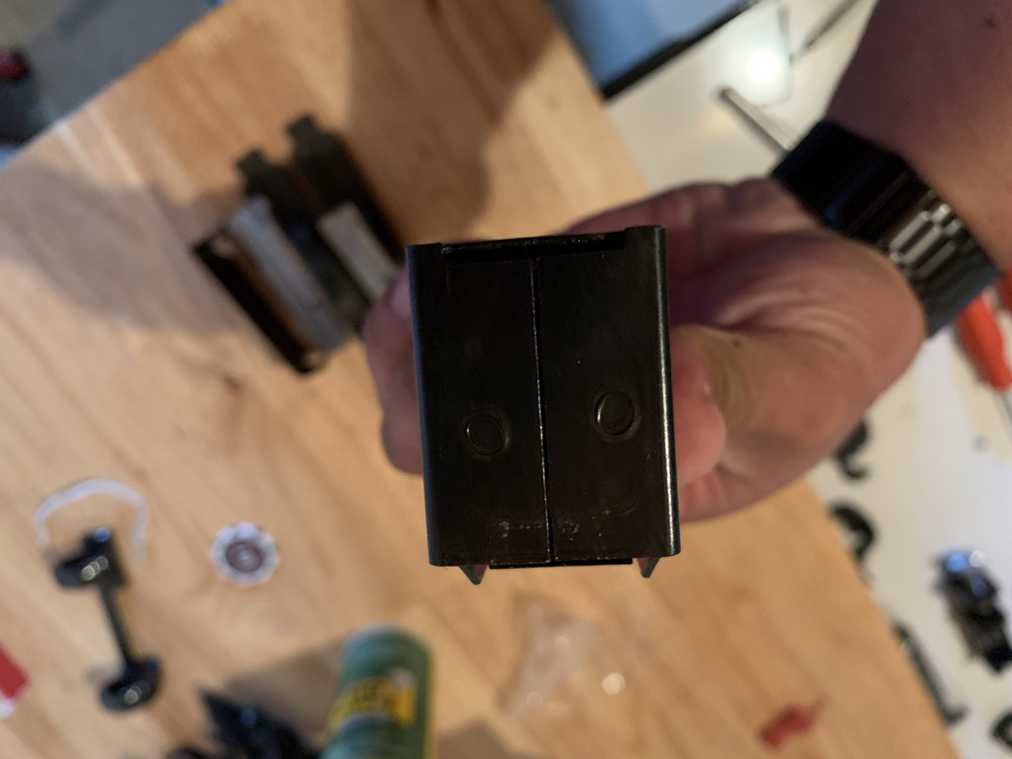

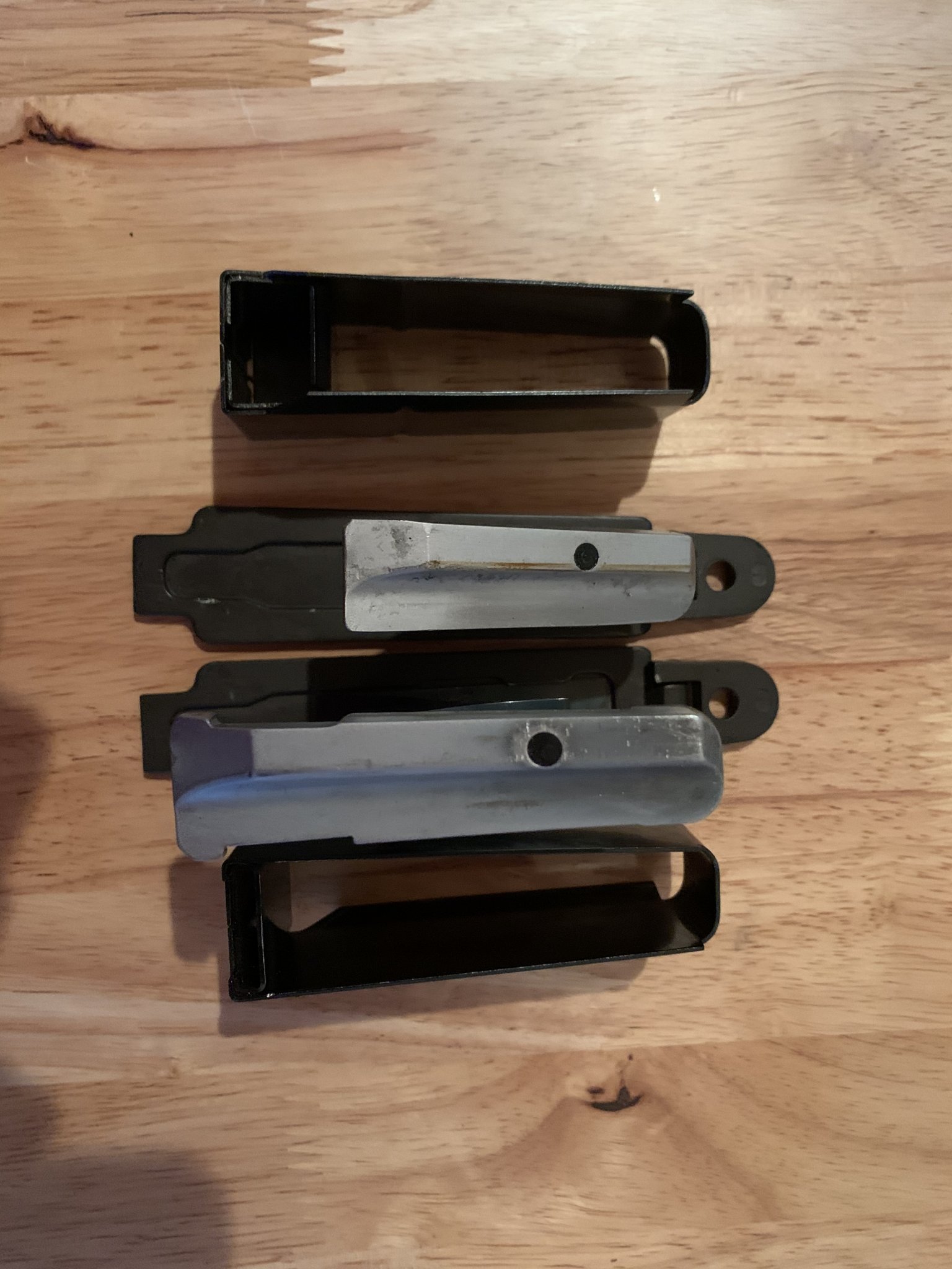

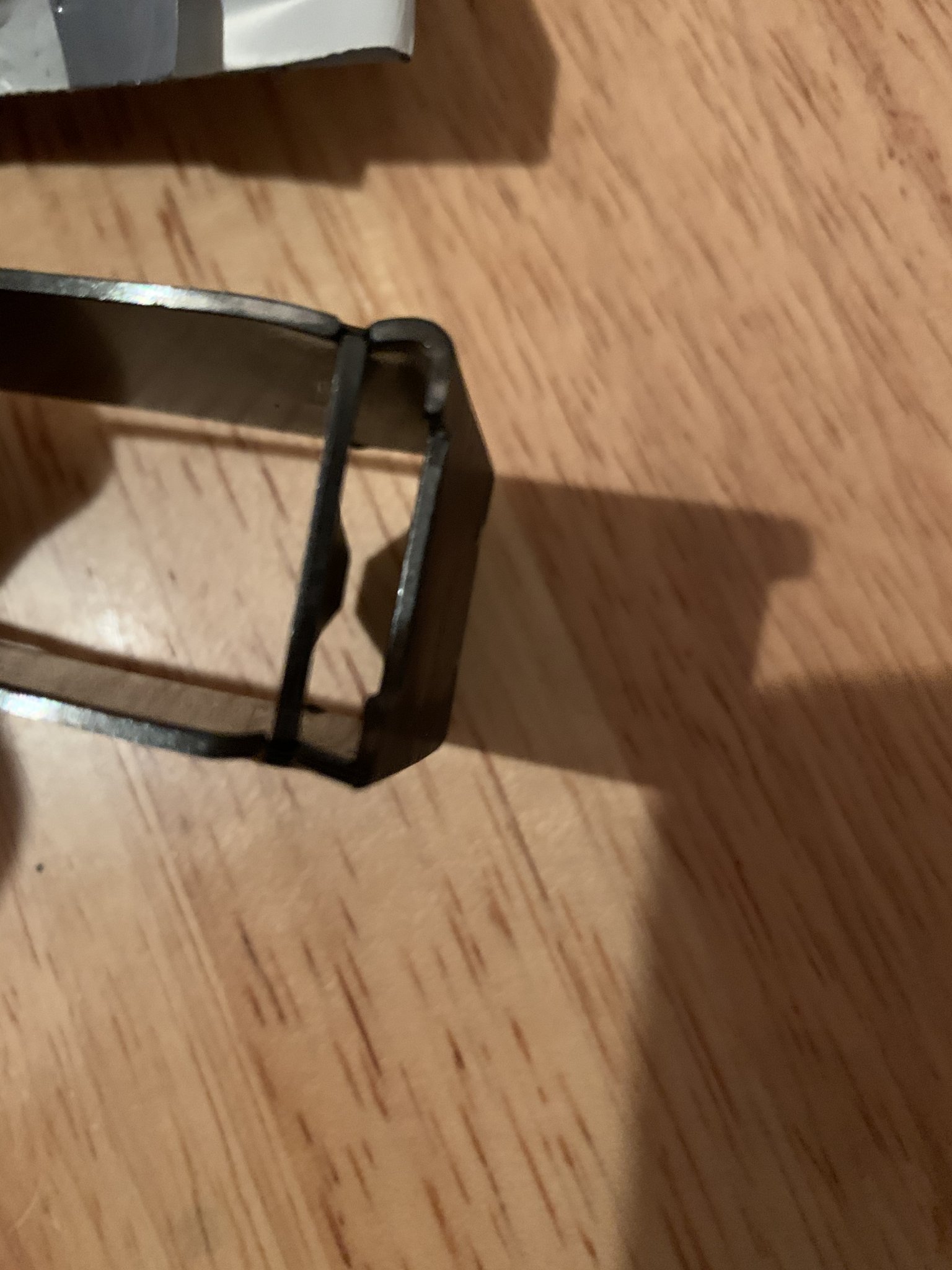

It looks like it’s in grooves, then peened in place.
Reactions: sandwarrior

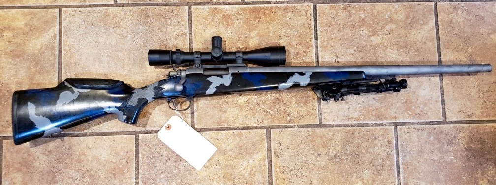

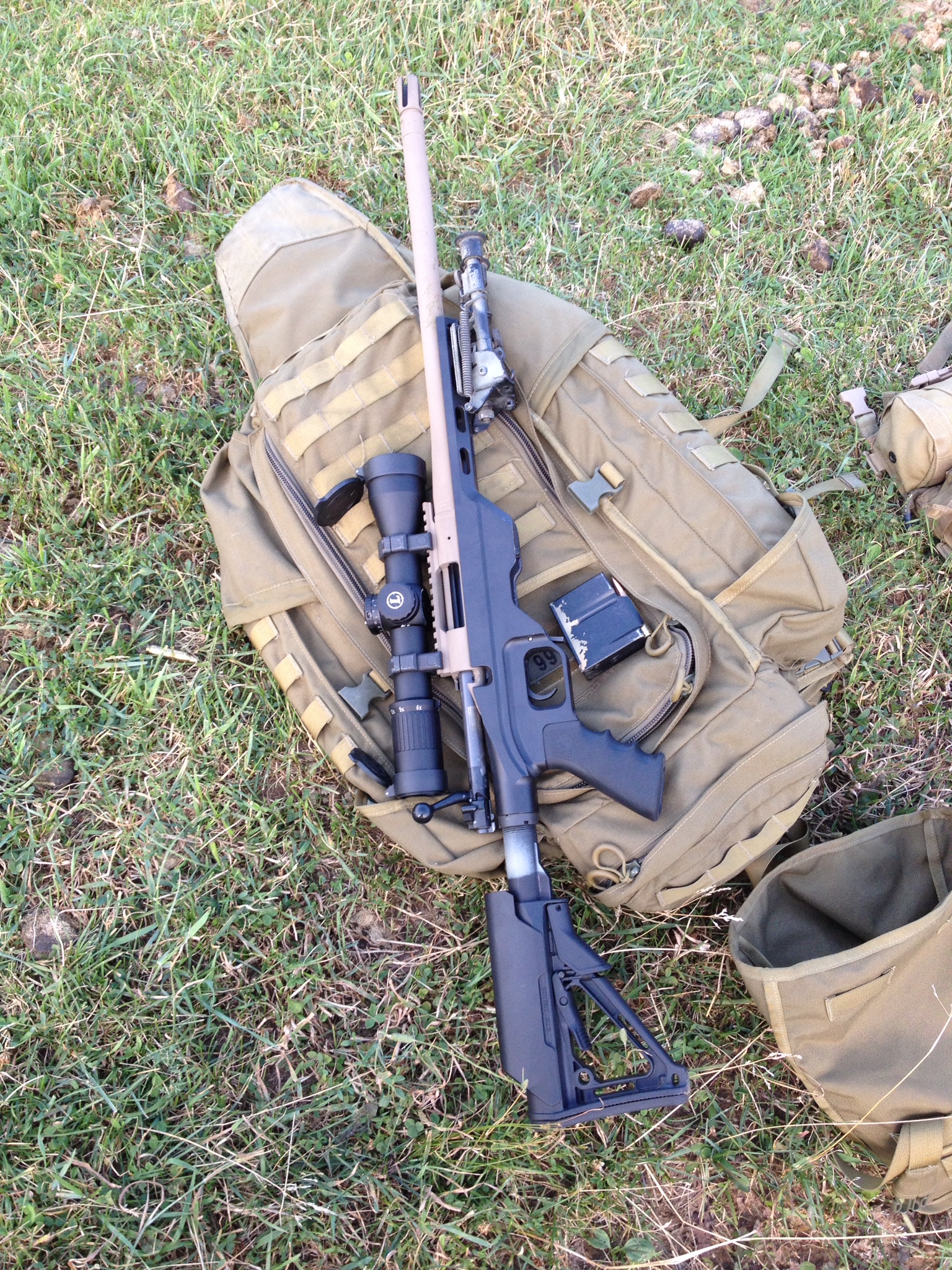

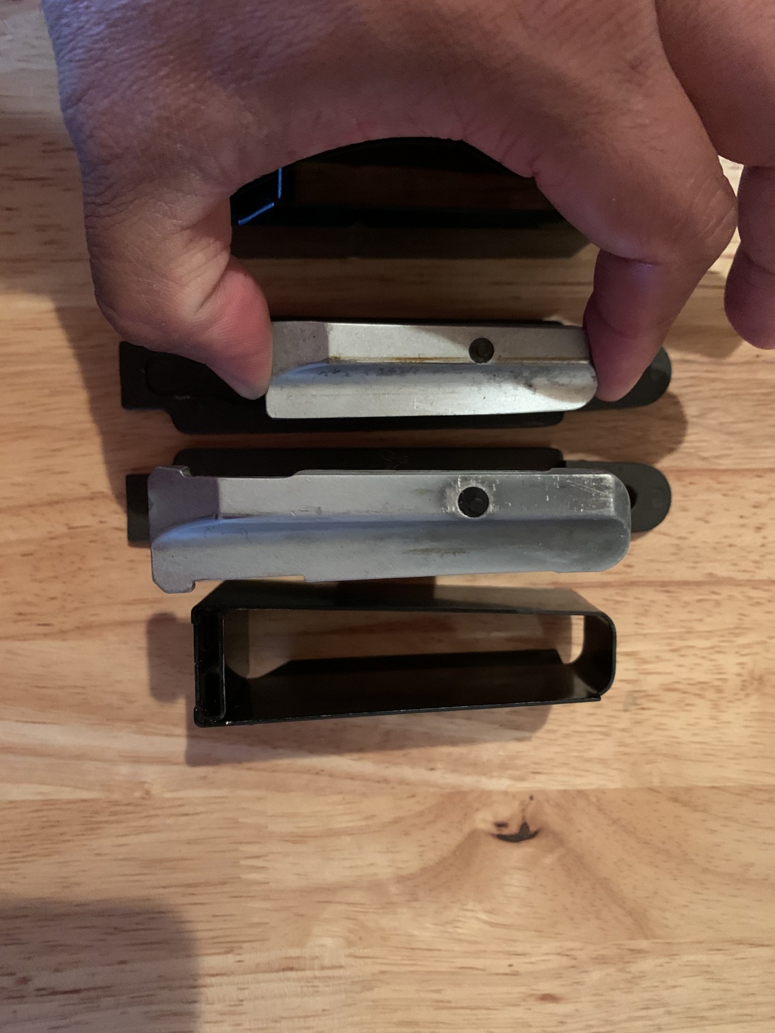

These are out of very early post 1964 model 70’s, they may have been manufactured in late 1964. Anyway, the short cartridge box and follower are from a 243 varmint and the other is from a 3006.
The post has a more box like spacer and is spot welded in place.
They're MDT's, but I'm not sure which model off the top of my head. I ...think... it's available commercially. Pretty certain it's just a Rem 700 chassis because they have the safety cutout for a Rem trigger.

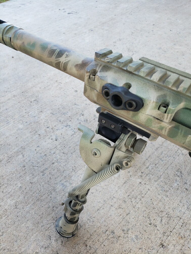

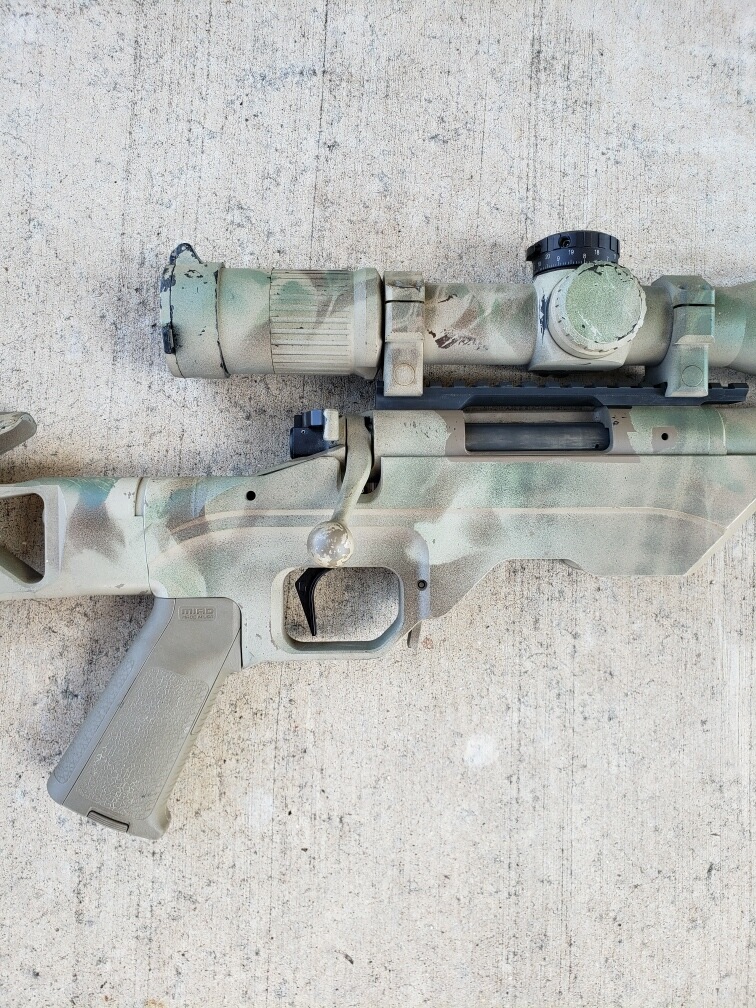

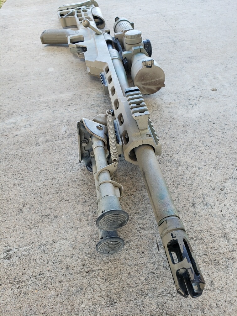

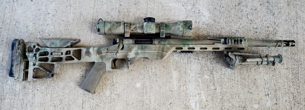

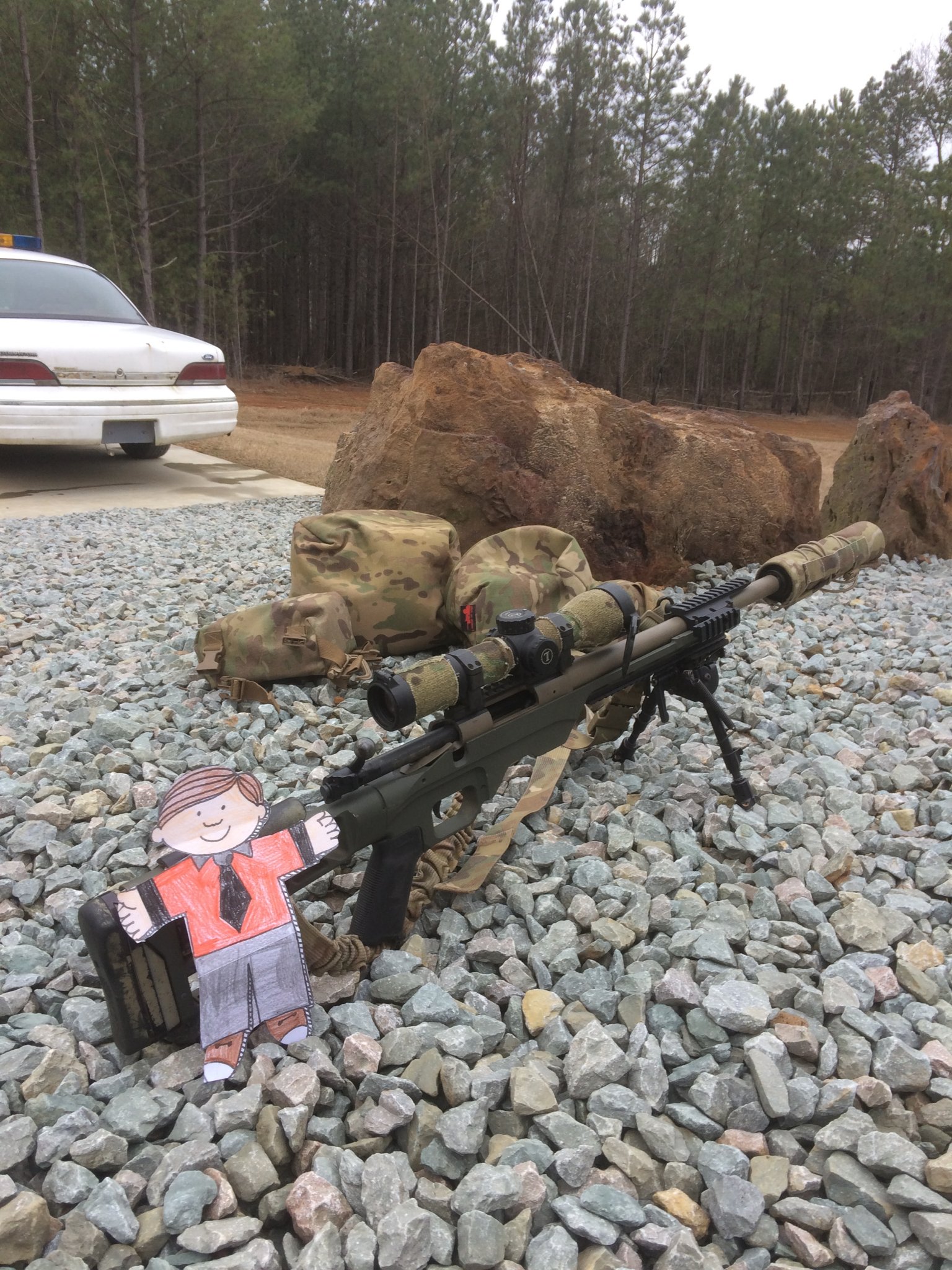

Did they rebarrel the HS when they stuck it in the chassis? Oh any ideas who made the accessory mount?
Yes, they did. 16" 1:8T HS Precision barrels. Marksman or Med Palma contour.
The rings, rail, and forward bridge are Badger Ord. Chassis and Butt Stock are MDT.
That terrible muzzle device was from Great Lakes Tactical.

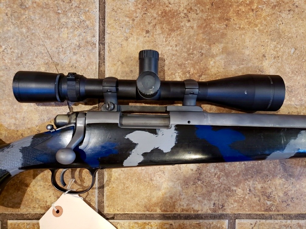

I've gotten several questions via PM regarding the FBI Remington 700. They pre-date me, but in talking with guys I know in Quantico, here's the scoop.
With regard to the Remington: There is a distinction between a SWAT rifle and an HRT rifle.
SWAT:
Rem 700 action
Douglas #6, 12twist, carbon steel
Leupold 3.5-10 Vari-X III with either Duplex or Mil-dot
Leupold or Redfield scope mount, bottom screw rings
HRT:
Rem 700 or 40X action (due to clip-slot for Unertl mount)
Hart #7 contour, 12twist, stainless
Unertl mount and "10X Sniper" scope
McMillan Hunter, A2 or A3 stock for either, depending on timeframe.

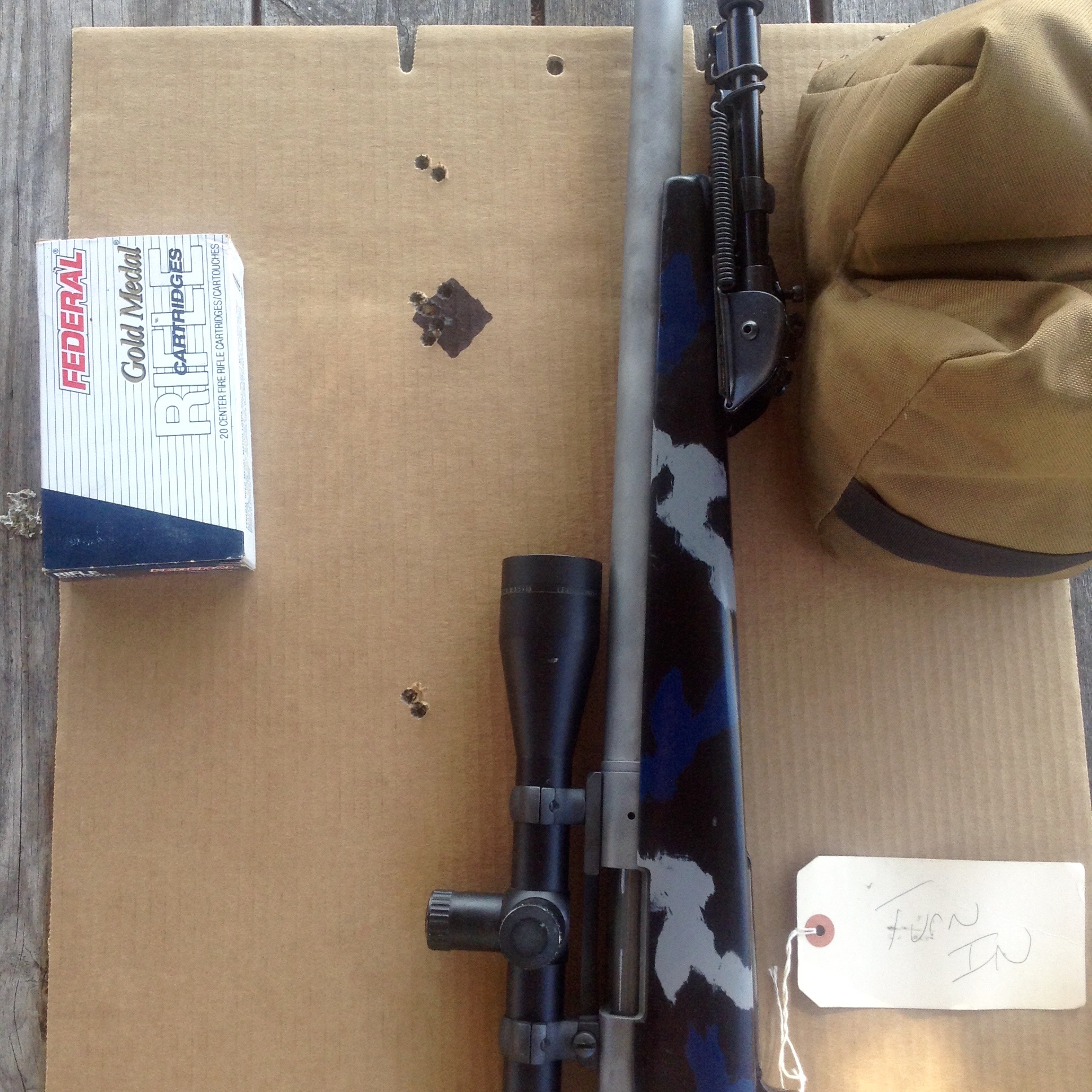

A question, how effective are the shorter barrels? I know we talk on here a lot about how they still keep their accuracy, if just a little velocity loss. It seems to me that would be a small adjustment. And, providing all the precision is put into the rifle, it shoots just as accurate? The gain in manueverability in tight areas plus not needing a really long-range rifle make it worth doing it that way I think. What's your take on that?
Now, me in the field, I'll take the long barrel every day, all day, 8 days a week. Or, use my AR.
The short barrel guns are plenty effective for what LE snipers do. In the case of the 16" FBI gun, the few hundred of them I have seen/helped chronograph run about 2475-2500fps with Fed Gold Medal Match 168gr ammo. And, they seem to all shoot "about" 1MOA. They shoot ok, but not great. And, getting that 1MOA performance takes work. It's an unforgiving rifle to a shooter who's not applying the fundamentals. I've seen more than a few students come through and complain that something is wrong with his/her rifle... "I shoot an AI on the weekends and can stack rounds on top of each other, but this is all over the map!" Give them a new scope/rifle and the same thing happens. If you think think you can do the free-recoil, thumb-on-the-side, gamer crap, this rifle will quickly reveal your weaknesses.
Overall, while I can't deny the size/length of the rifle lends to its mission effectiveness, I don't like firing it. I don't like the chassis, the butt stock, the scope, the muzzle device, or the twist rate. I much preferred shooting the HS in its original form.
Long story short, the size is right...
That's pretty interesting. I picked up a FN PBR a year or so ago, and wow, does that thing wants to fly all over. Load it with light/moderate rounds and I can control it.
Something I've learned from F-Class is when I am not right behind the rifle and it pushes to the left or right, that's where my bullet goes. I'll be right on the X and if it pushes right, my bullet ends up out in the 9-ring. The thing is, this is exaggerated on an F-Class target and 600+ yds. Fundamentals are very important. I used to discount half-moa flyers. Not anymore. When it shows up "big" on the target and no one else is making those "big" mistakes in a no wind shot...it tells you something. :rolleyes:

So if I’m reading this correctly, either redfield or Leupold bases/rings would be correct for my pre64 m70 build? And as far as the mcmillan stock went, I ordered mine June 26th, and received it last week. Fastest I’ve ever had a mcmillan go through, lead time was quoted at 5-6 months.
Bottom screw redfields, yes, per Skunk and what I saw, handled, and shot.
Great news on the stock. !!!
