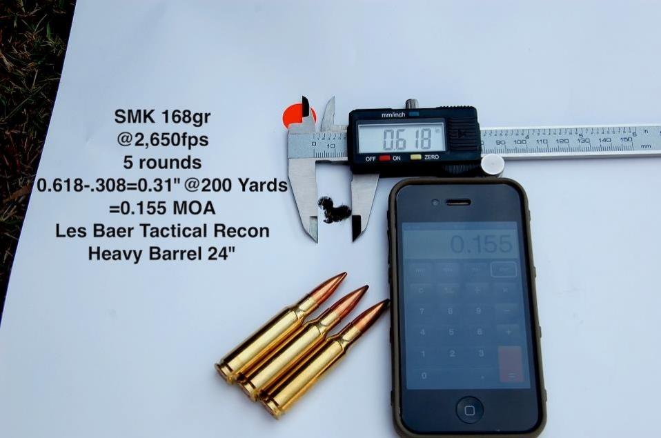

Within 200 yards, I would bet on 168 SMK.
