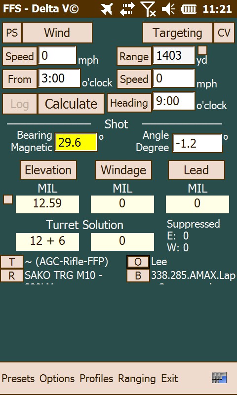

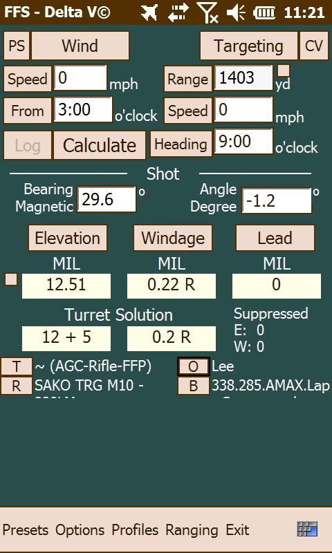

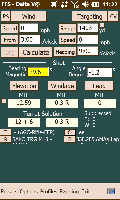

285g Hornady AMAX - 338LM @ 2805 FPS - 1-10 RH twist
Correct firing solution (verified DOPE):
7071429
No SD/CE correction (miss in zero wind):
7071430
SD Compensation Only:
7071431
And Finally, CE Only (no SD):
7071432
Just depends on what your requirements are whether you correct for it or not. We occasionally engage 6" plates at 1400 yards striving for first round hits, accounting for cold-bore, clean-bore, etc. Like everything, it all matters to some degree that only the shooter can assign gravity to (no pun intended).
From the data above, not accounting for SD accounts for a horizontal error of 15". CE alone, 5" at this DoF. 20" POI deviation if not corrected for. Makes hitting those plates very challenging on the first round. Notice there is also a small correction in the vertical as well for CE/Eötvös.

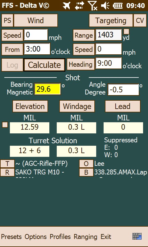

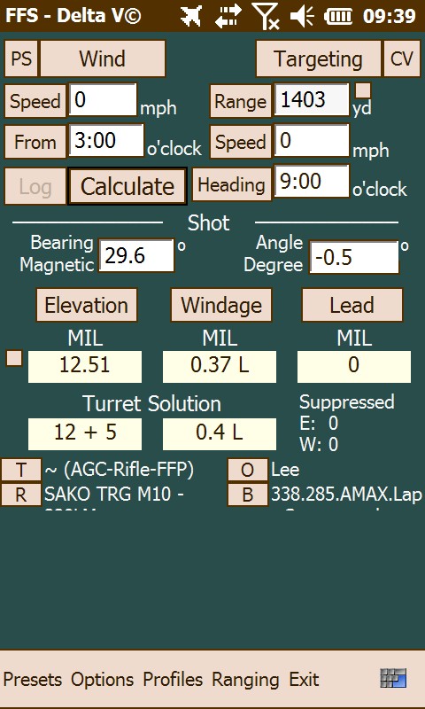

Now show it with a LH twist
Ok, same conditions - LH 1-10 twist.
SD and CE Corrections Enabled:
7071480
No SD/CE correction:
7071481
7071482
CE Only (no SD):
7071485
So when CE and SD enabled it’s .15 less, but the rest is the same (other than it’s R vs L wind holds)? That doesn’t make sense.
Yeah, it can get pretty confusing. What you are seeing is the LH twist cancelling out some of the spin drift and CE (since CE is easterly (right deviation) in the Northern Hemisphere).
There are two components to CE though: A vertical and horizontal "apparent" shift. Assuming Northern Hemisphere, vertical if firing east or west (low POI firing towards the west and high POI if firing towards the east).
The horizontal component is always present, no matter the DoF.
