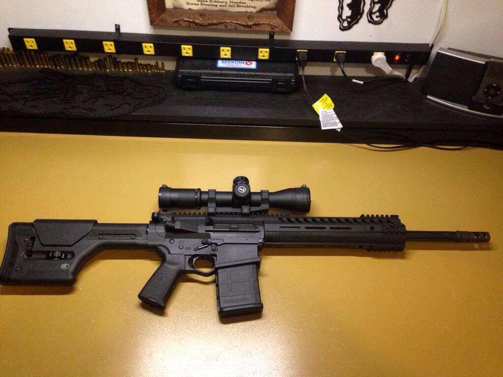

Also, would there be anything wrong with running a smaller/lighter stock, say a MOE, on a GAP-10? Because I plan to get a 22-23" 6mm Creed GAP-10, but also a 16" .308 upper to go with it and would probably switch a lighter stock onto it when I run it like that for hogs/closer faster matches.
Thanks.
The issue is one of balance. A bit of weight in the stock helps. The UBR is ideal for this.
I think the weight is perfect, but haven't done a free hand with glass and full mag yet. Either way, I like my sticks a little piggy like anyway. Breaking it down tnite, and first thing struck me was how tight the upper and lower are. Thought I was missing a take down pin or something.

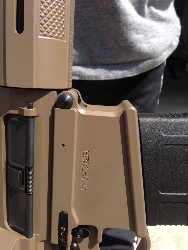

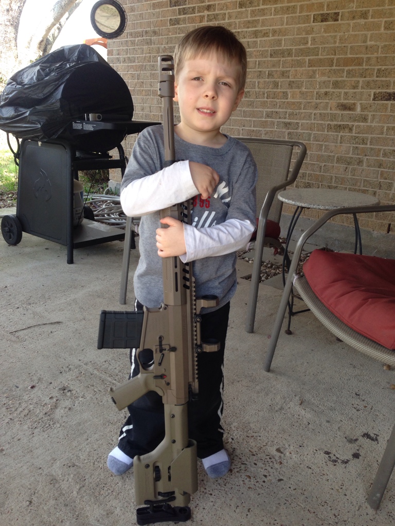

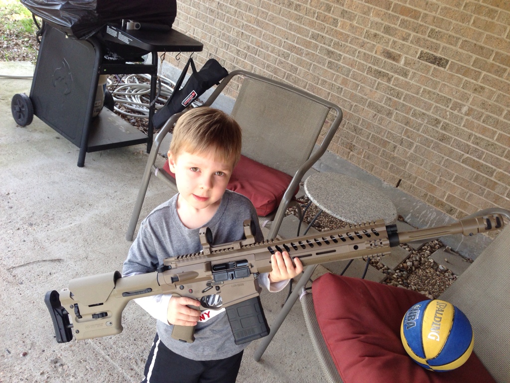

Trust me, he was getting left bicep pump for the photo op. Simply told him, do not drop it, or let me know if you can't hang. He hung in there though. Little turd keeps opening the safe, pointing at HIS rifle. bwahahaha. Daddy's stick till he can bench 300.
Yes...it is a mid length guard. I know you guys are trying hard to get everyones order filled asap. Im just ready for it. Lol

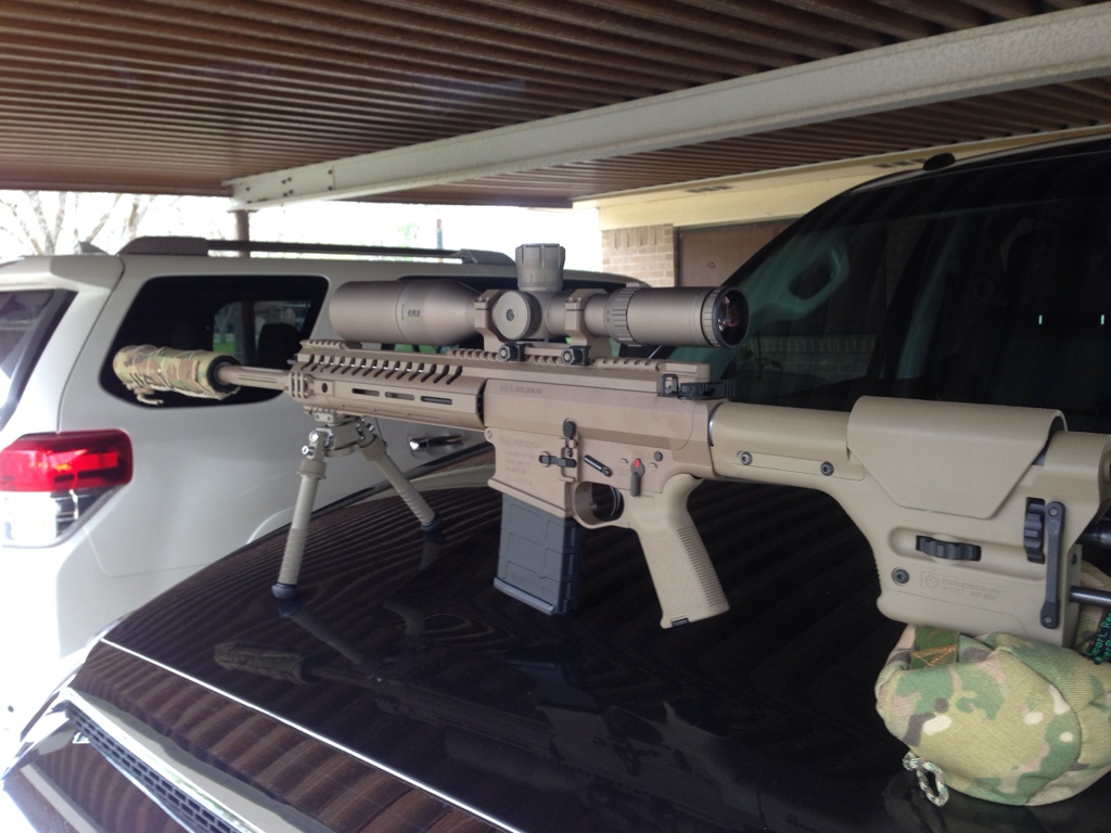

Ok. Dressed up.

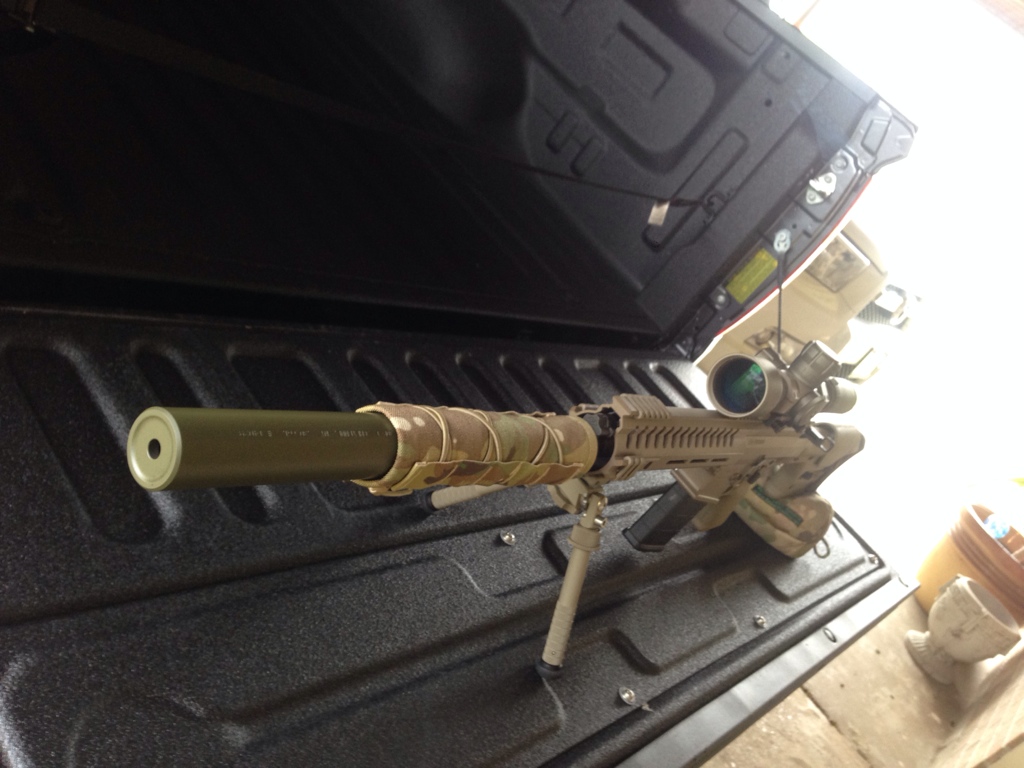

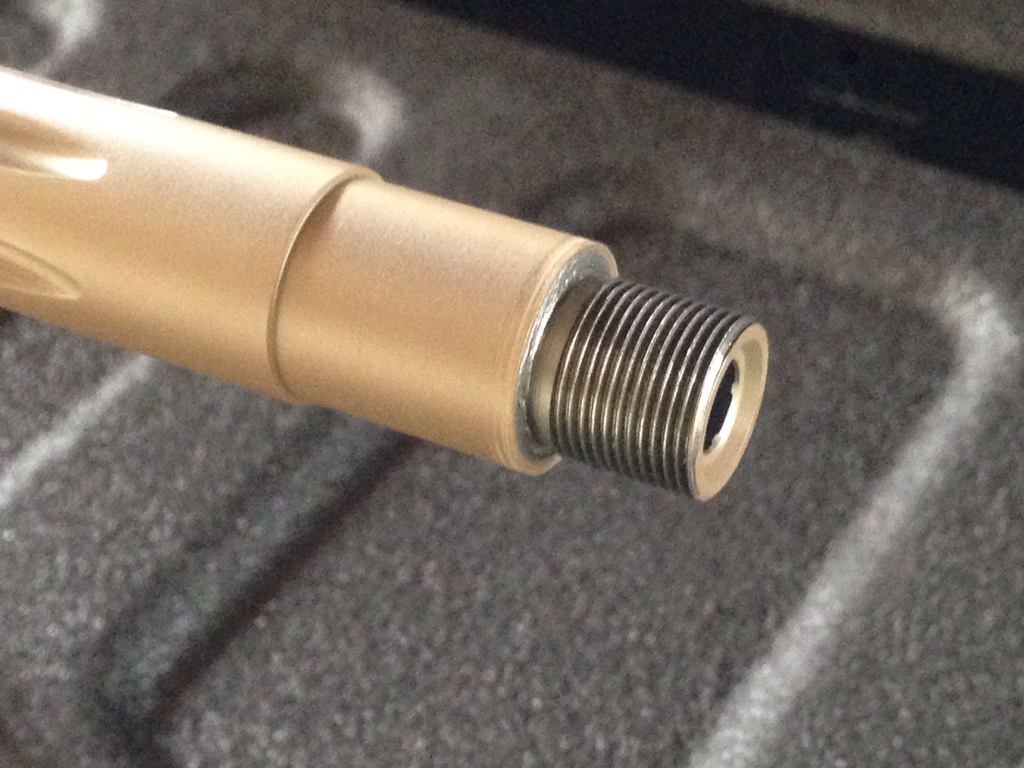

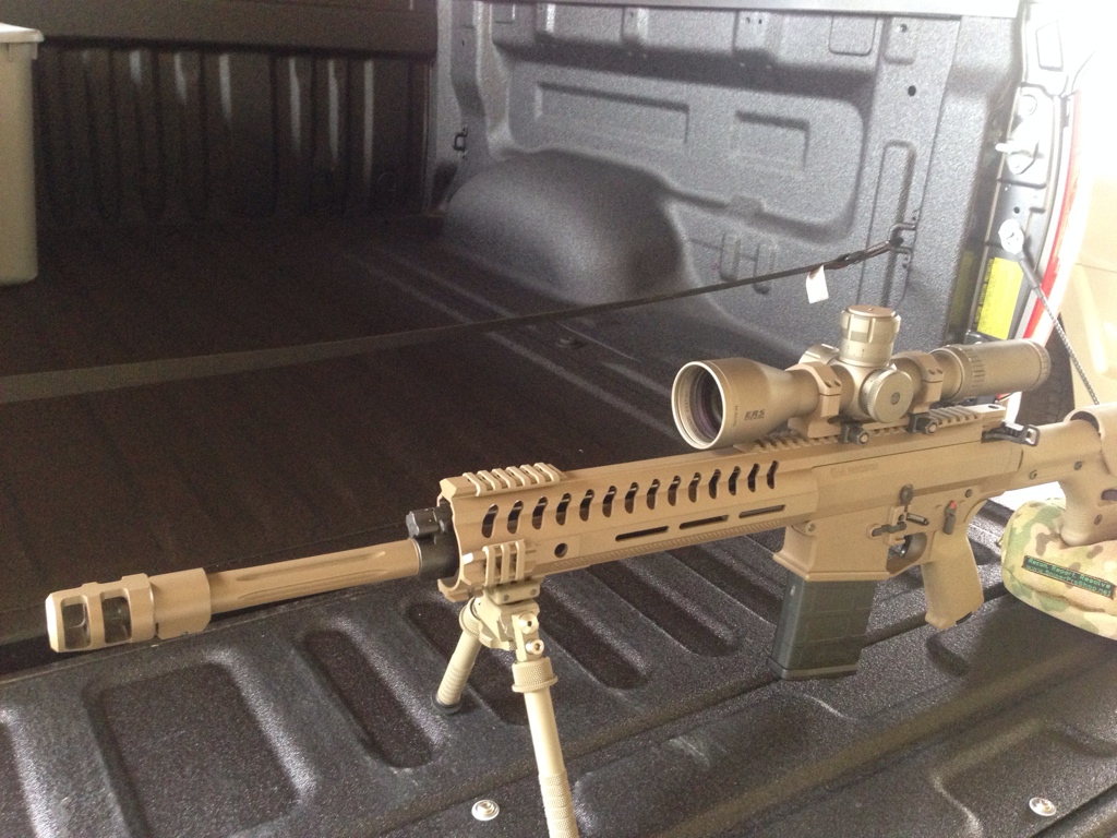

GAP10, 18 inch fluted, switchblock, BO FTE, threaded 5/8x24, Heiselle SSA-E, PRS, all FDE. Glass is Bushy ERS 3.5x21 in FDE, ATLAS in FDE. Noise cancellation via TBAC 30-p. Love it. Mad props to the GA team. ImageUploadedByTapatalk1394488498.897027.jpgImageUploadedByTapatalk1394488518.938166.jpgImageUploadedByTapatalk1394488498.897027.jpgImageUploadedByTapatalk1394488551.758569.jpgImageUploadedByTapatalk1394488567.166524.jpgImageUploadedByTapatalk1394488583.353594.jpg

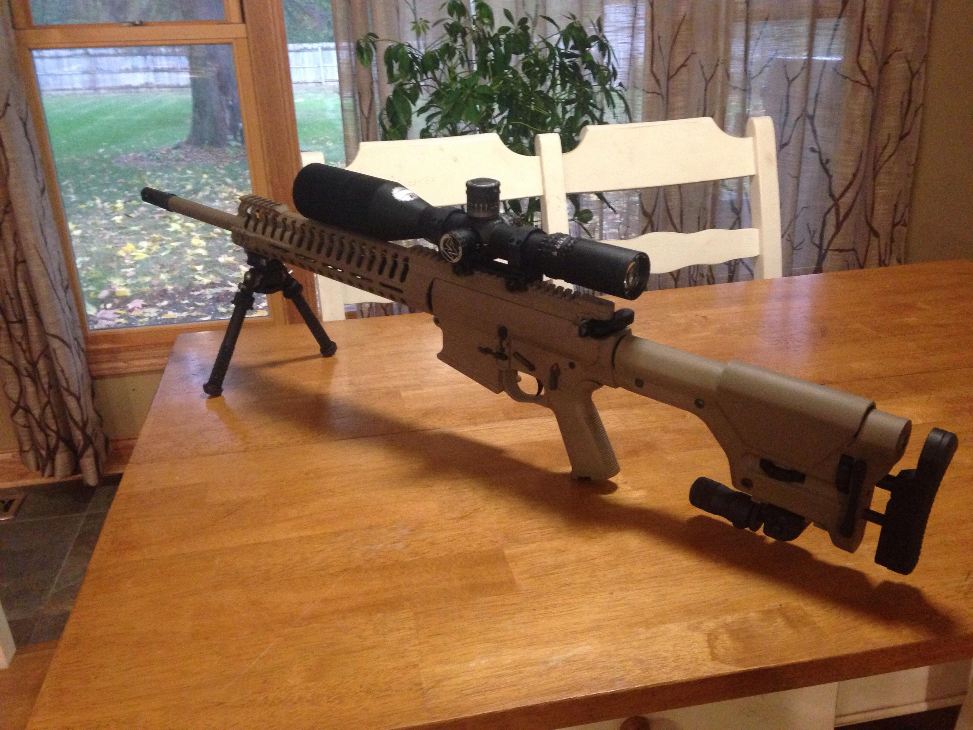

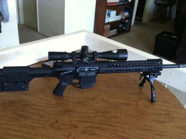

My GAP-10 .308

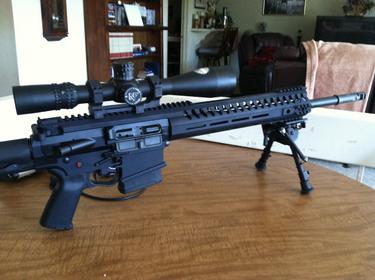

Picked this up last night!! My GAP Bolt rifle will have a friend now!!!! :)
It will have a USO scope on it as soon as it gets here!!!

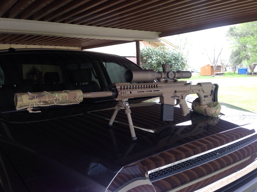

Took mine to range today, put 40 rounds of SW 168 SMK through her. 25 with brake, 15 suppressed. Shot as accurate as my bolts, very satisfied. She's tight, so I imagine a couple hundred more are in order. Broke it down for a cleaning, after following barrel break in during those 40, and it was surprisingly clean. May attribute this to a good soaking in Slip 2000 EWL. As well, gotta say I think she runs great with the can. Had a few failure to feed unsuppressed and suppressed, and one double feed as well. Couple of times bolt wasn't locking to rear on last round. Dunno why, but figure it's due to tight tolerances, brand new, as well as brand new Pmags. Overall, the first round was good, especially with it's accuracy. Did a quick foresight with the Bushy ERS, and was on the ten dot in 4 rounds. My 30P was as predictable on the GAP10 as it is on my GAP bolt actions and DTA. .2 low, .2 left all day. Haven't run the switch block in off position yet, probably while try some subsonics later in the week this way, imagine they won't cycle on suppressed and really don't want to find out. She's a shooter and will only get better, next outing will be all 175 FGGM or SW.
I had the issues that you talk about, only a lot more of them. It's a wear-in thing. There was like a magic barrier at the 150 round mark and it started feeding reliably. The more you shoot it, the better it gets!
