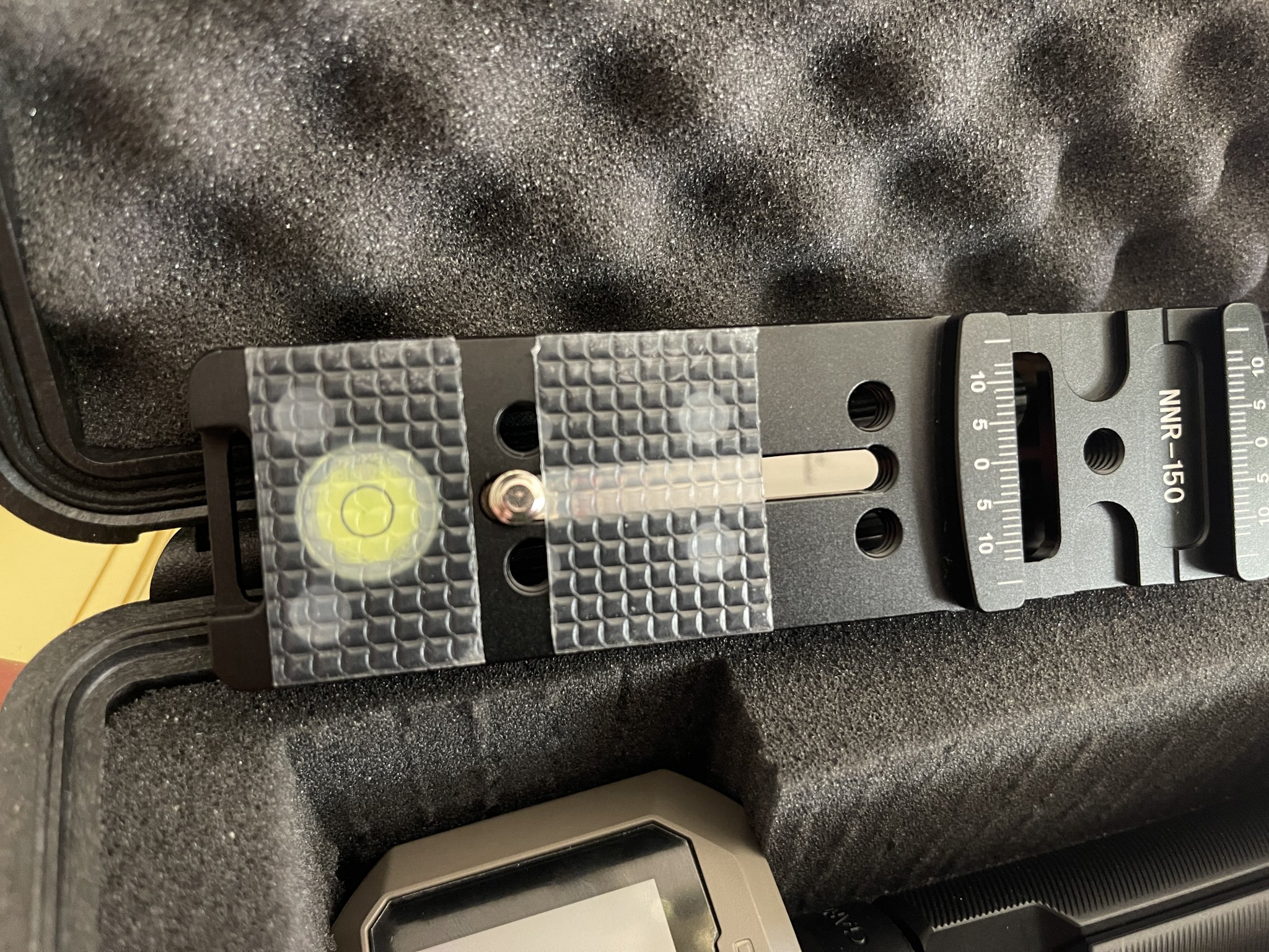

I’m covered for pic rails… I used the rrs clamp rather than the 419 one as it does both pic and arca in one. It’s tripod attach that the extra screw would be super useful for.
Thanks - can you send me a link to clamp you’re using? I’m getting a bit lost on the pages of this thread and various mounting alternatives shown - apologize in advance if you already posted. Owe you a beer.
Mile High has it in stock.

How are we planning to use this? It doesn’t fit the A419 arm, but the RRS knob style BTC clamp does. I’m a little stuck between the only two offerings right now from Gray Ops and A419. Analysis paralysis.
Just use a nodal slide. Use whatever adapter you want on that.

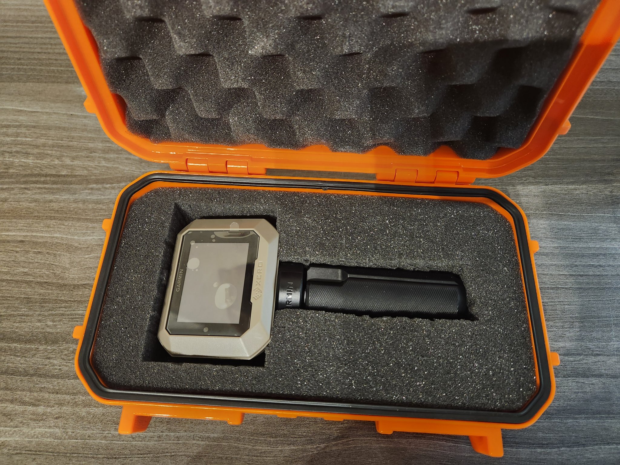

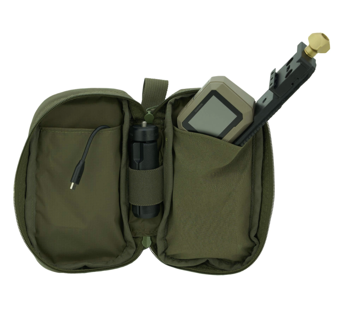

Cole-Tac just dropped a case
Looks nice, but I wish it had a molle option.

New Cole Tac case looks sweet. Especially if you’re running a mount.

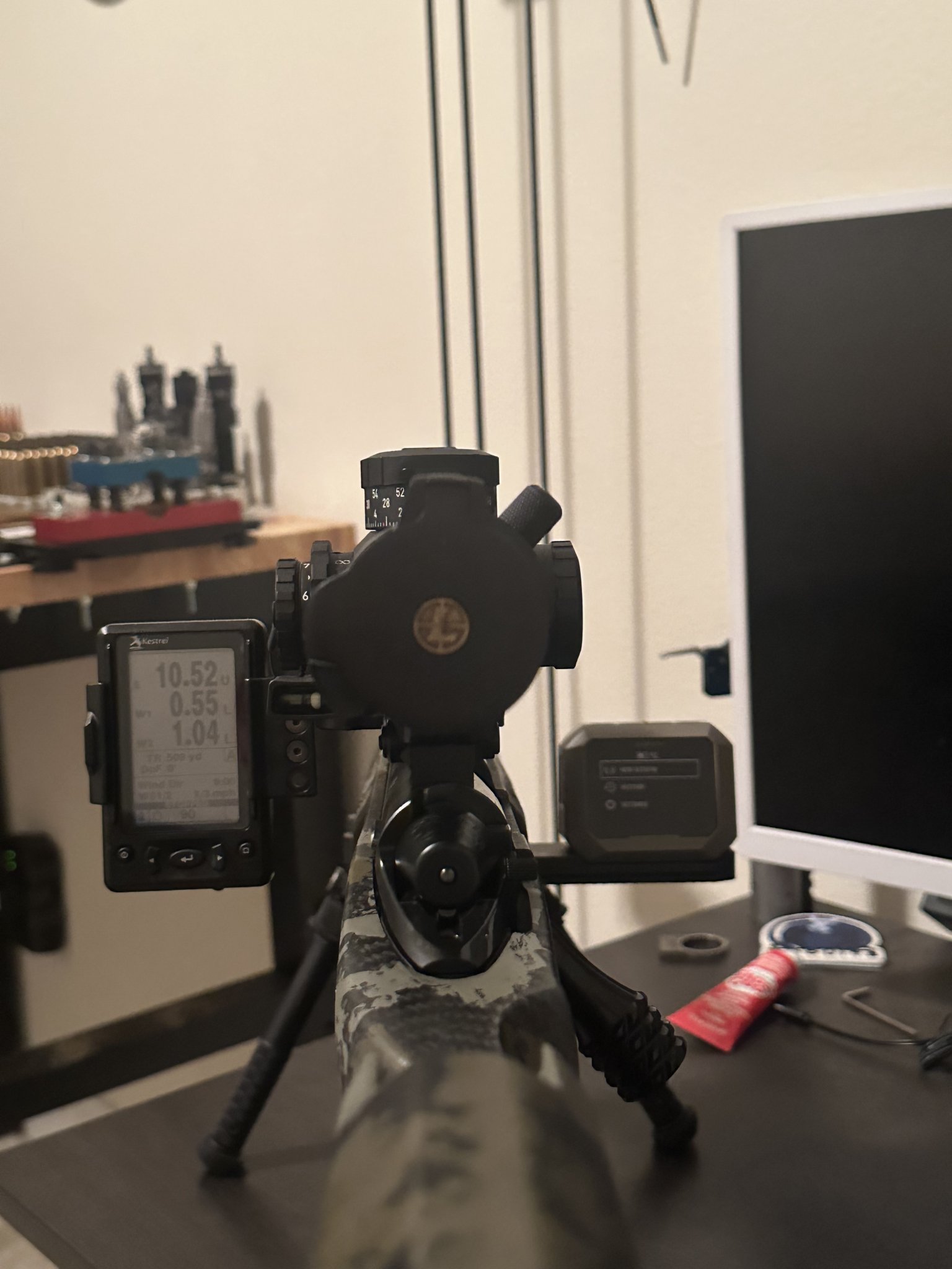

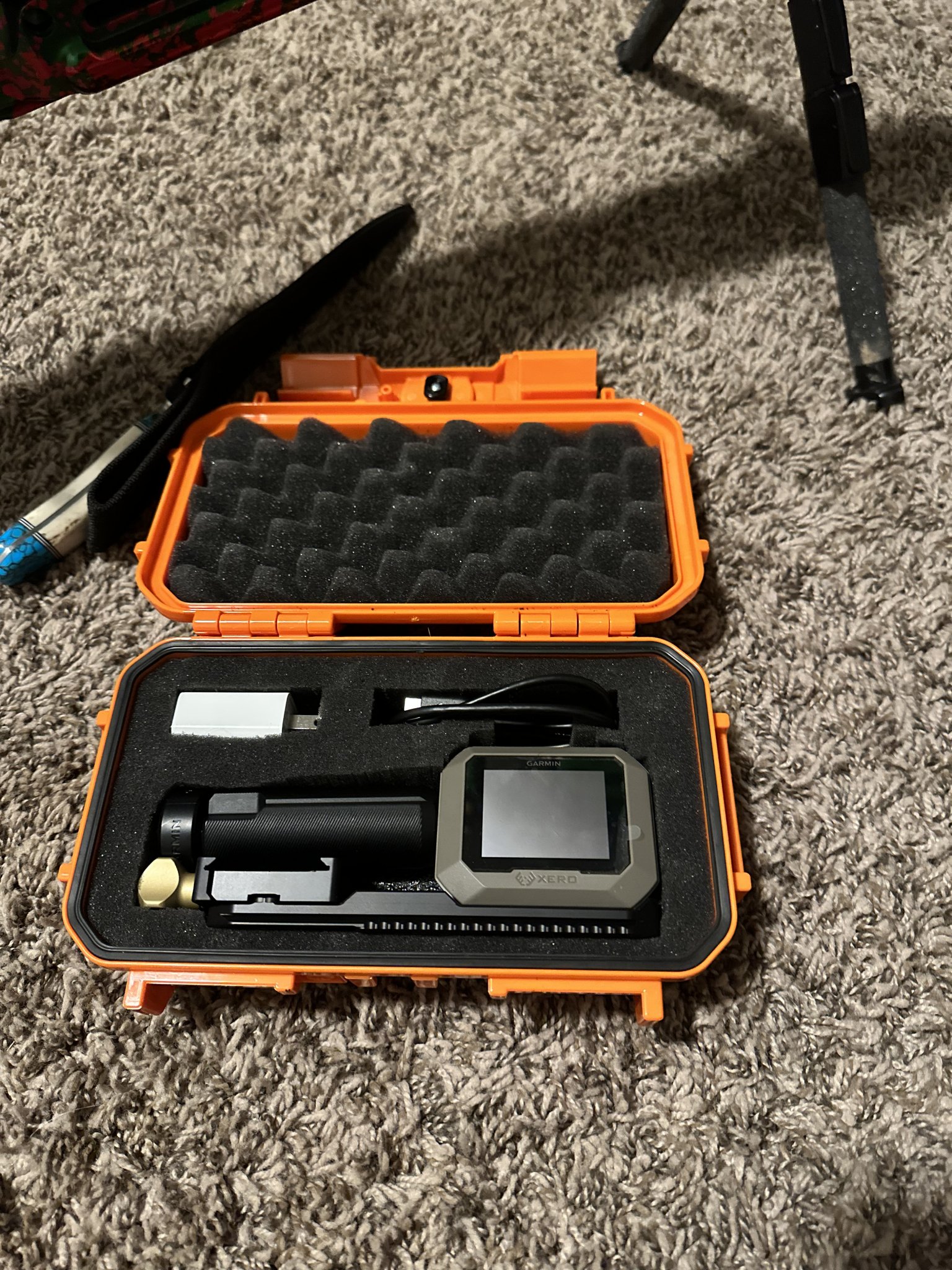

Got mine travel ready. Got the 419 arm in last night.

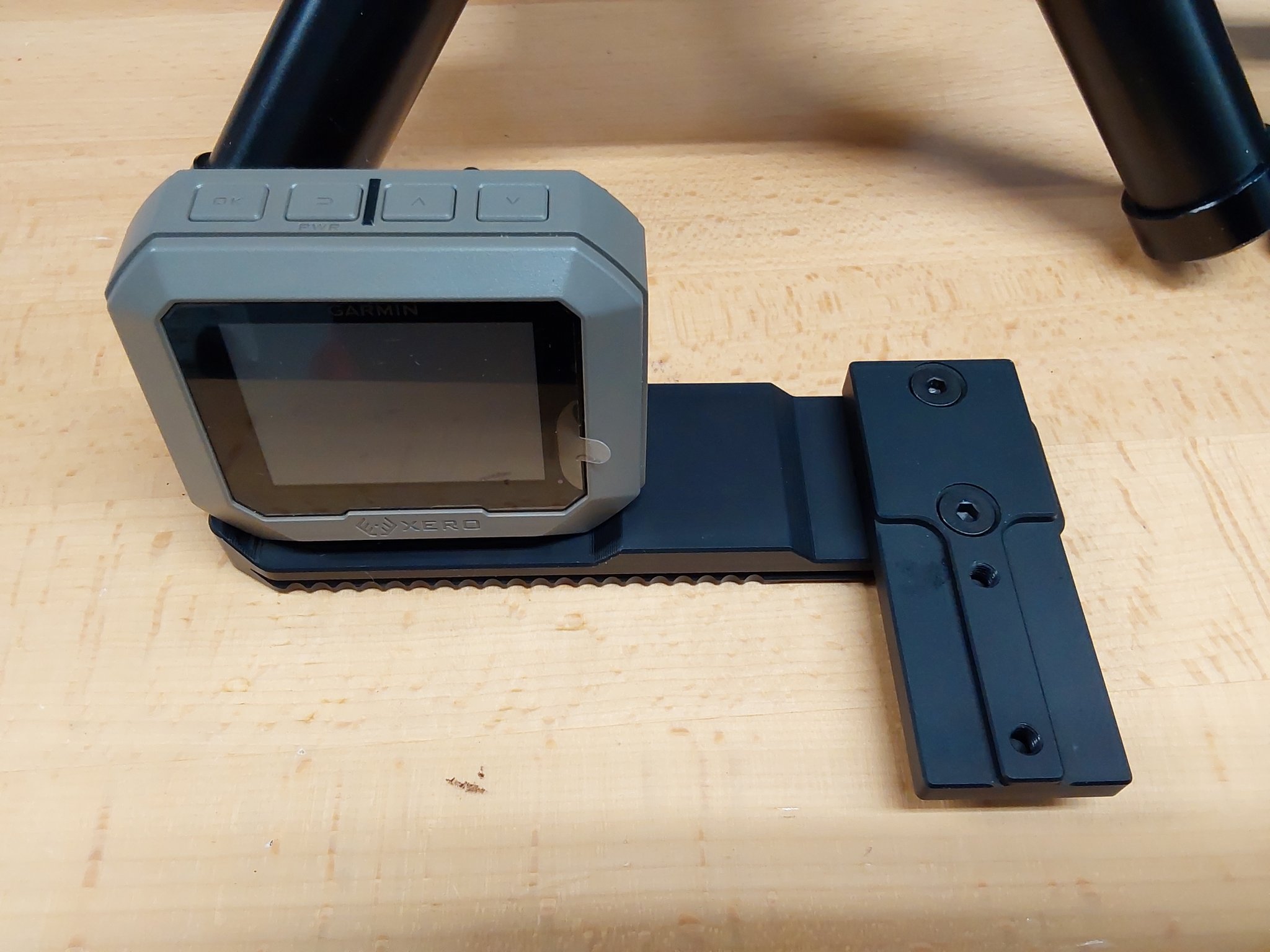

I am using an old Area 419 plate I had for an Atlas bipod. This will also allow me to put the Garmin slightly closer to the muzzle once my RRS clamp arrives. If I don't want to use it mounted on the rifle I can get some use out of my Labradar quad pod.

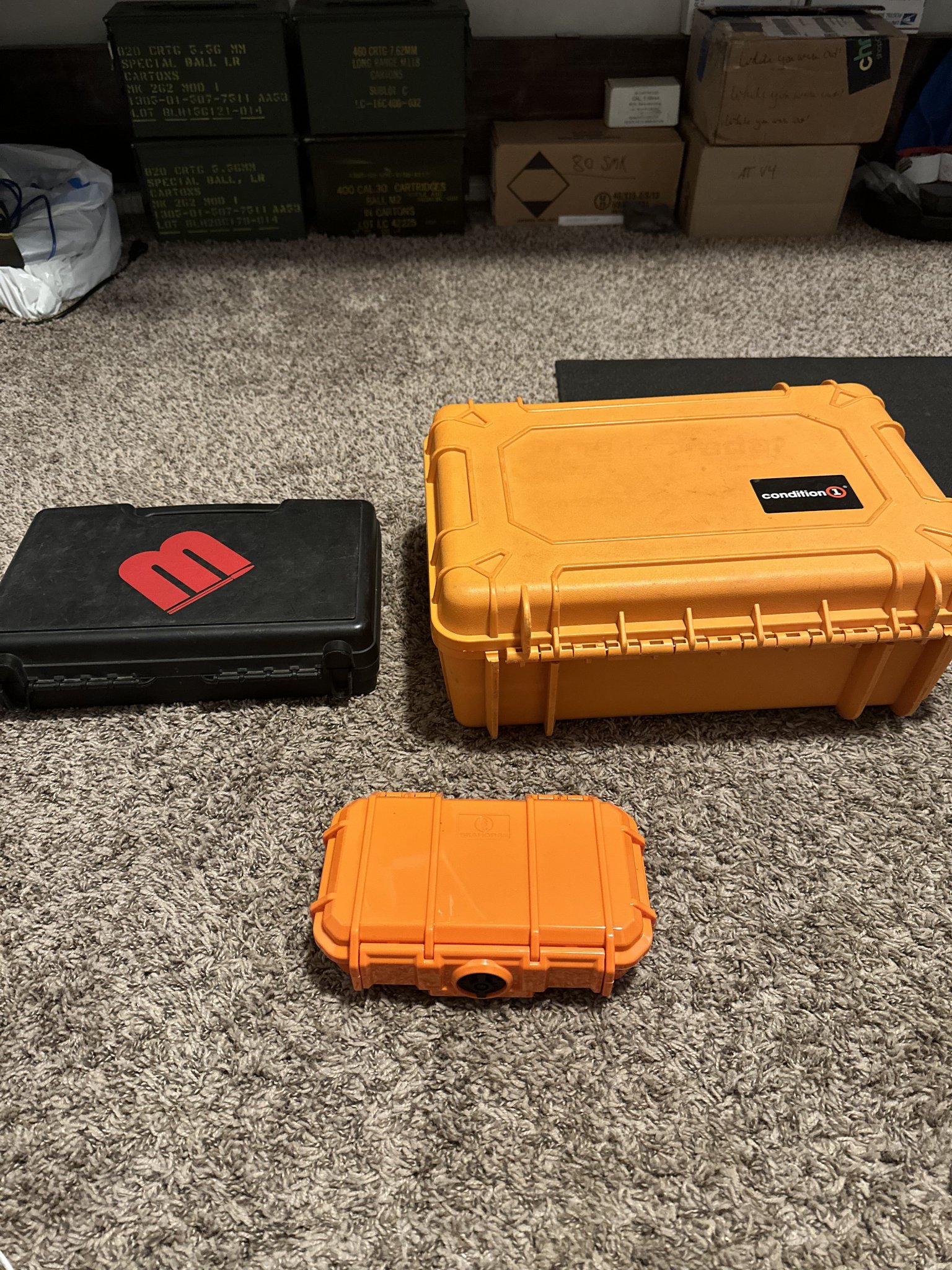

Travel case size comparisons on all 3. Magnetospeed V3, LabRadar and the Garmin Xero. Lol

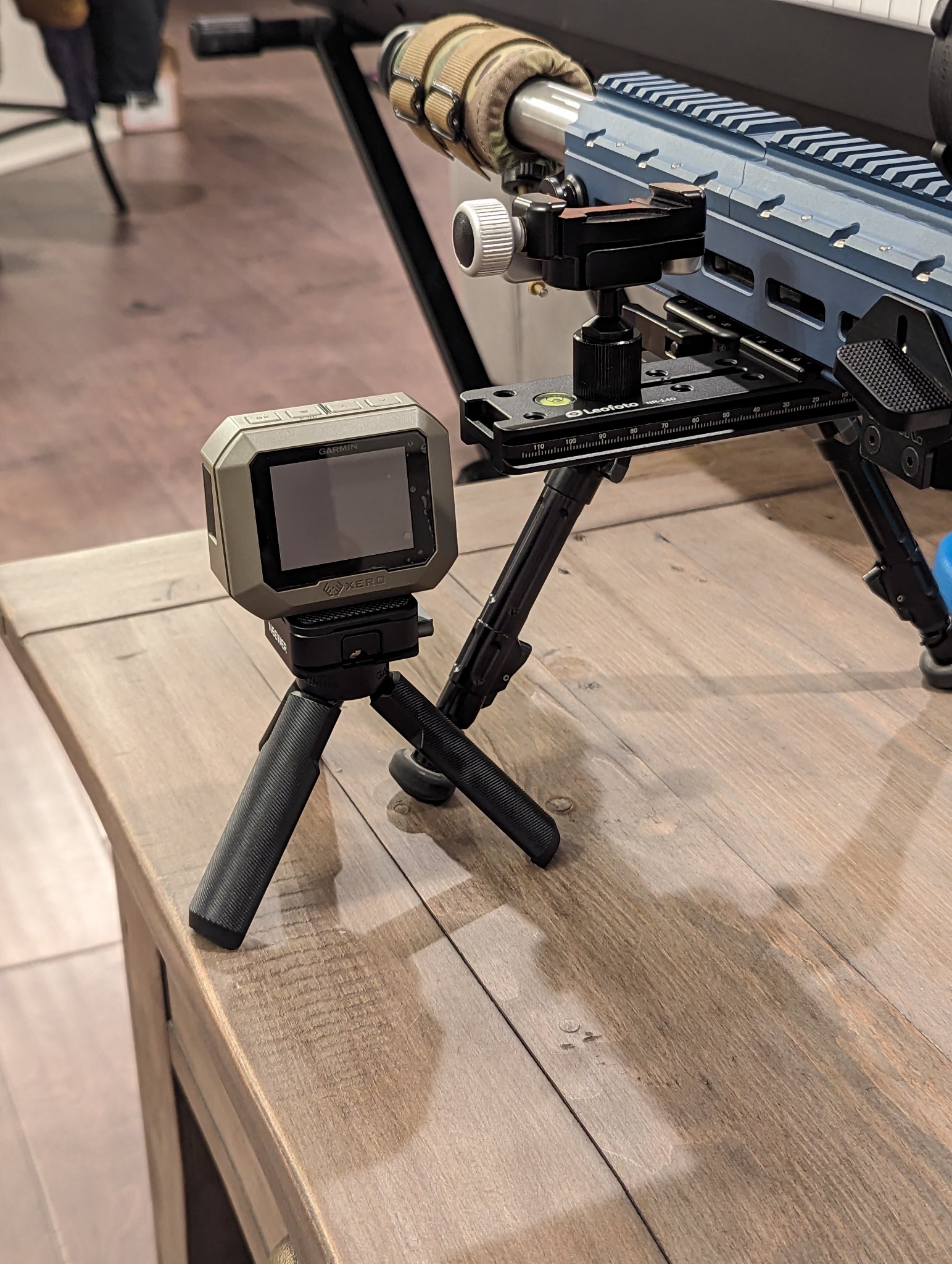

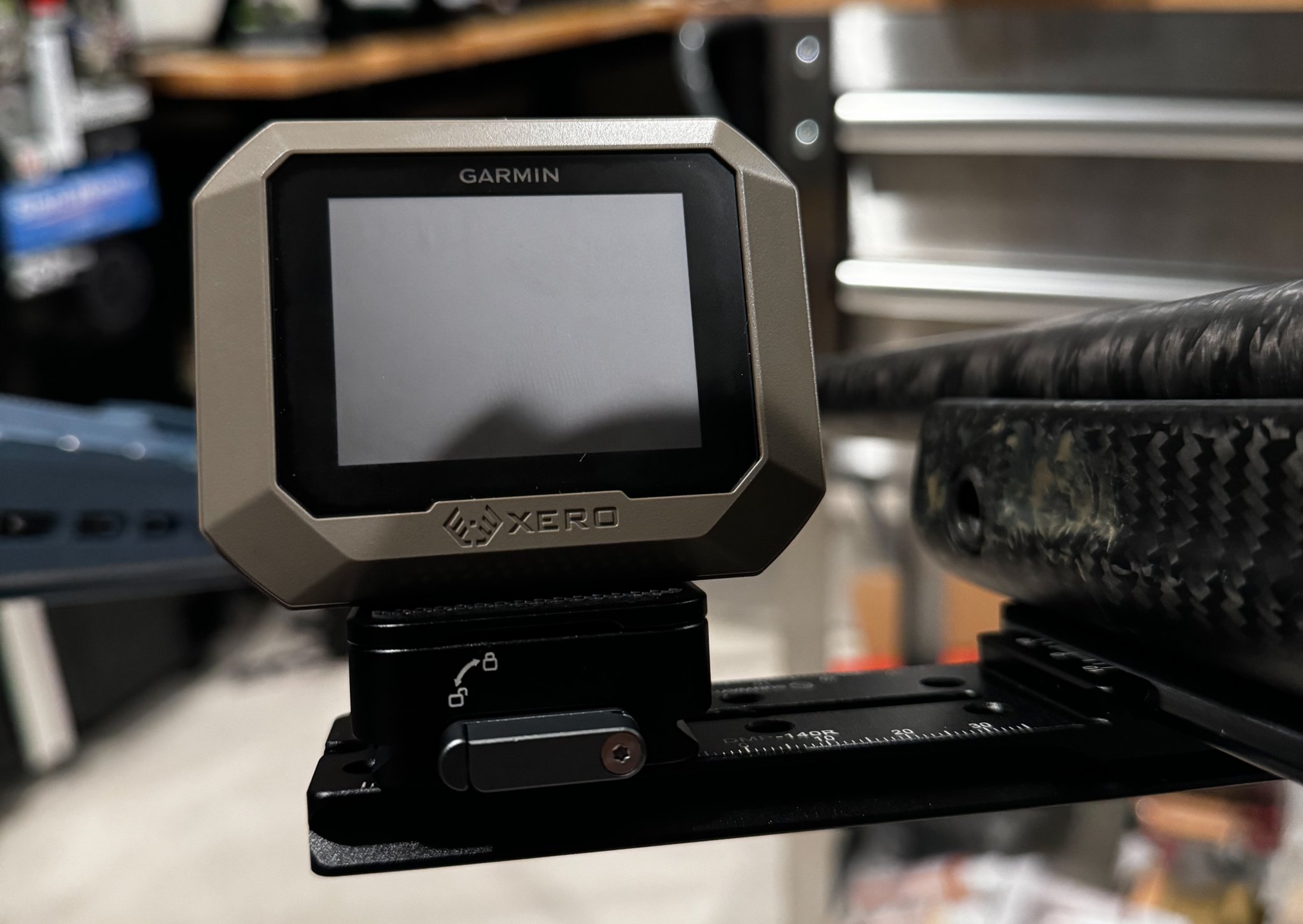

Would anyone mind explaining to me the benefits of mounting the unit to your rifle? Just trying to figure out if I could get any use out of a setup like this. I’m strictly a hobbyist ELR shooter.
For prone ELR it may not be worth it. For a PRS shooter practicing multiple positions it’s absolutely worth it. The only times I’m stationary for multiple strings of fire are load development and chrono. Now I can chrono during practice.

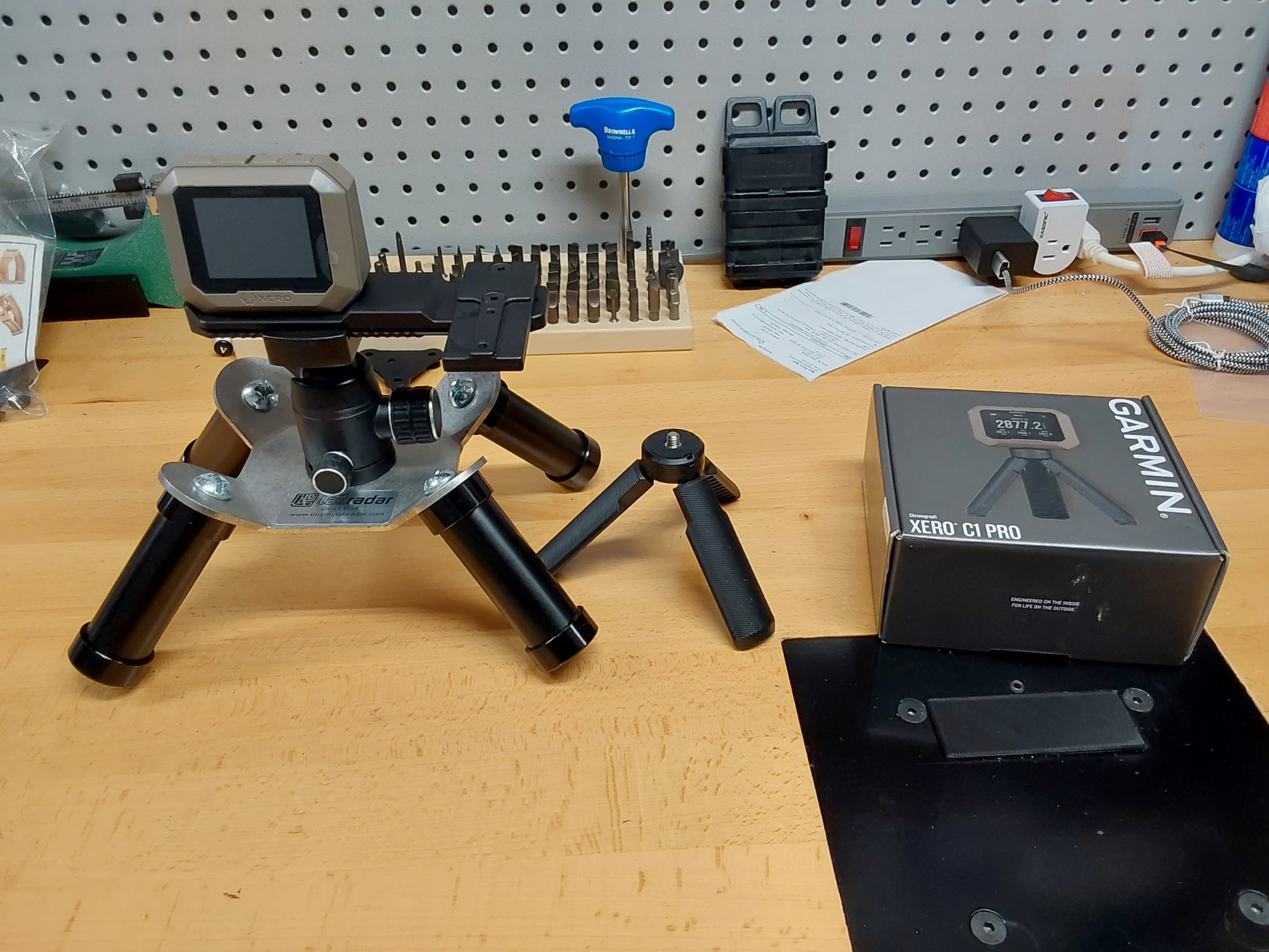

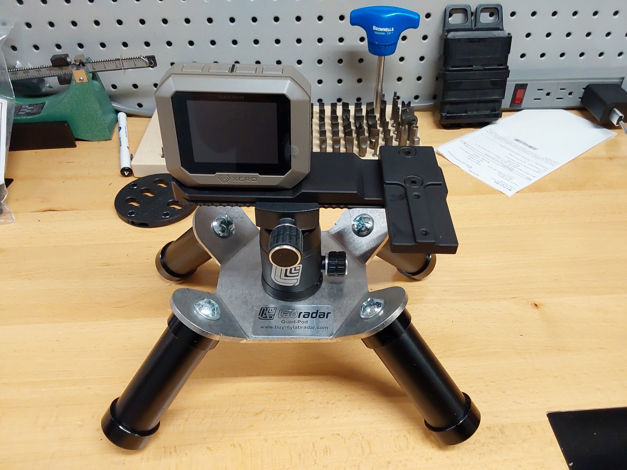

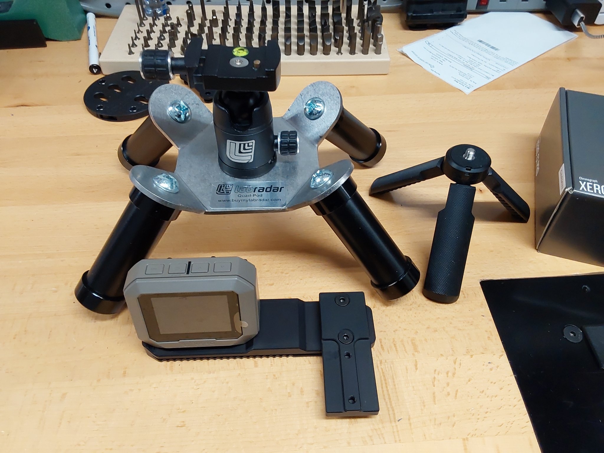

I’m using a nodal slide as a secondary mount. I needed something that would keep the Xero from wanting to rotate. Went on Amazon and came up with this. The grip strips work in two ways. It gives something for the Xero to squeeze against when tightening the screw (tension) and keeps the unit wanting to easily rotate. I initially used strips of loop Velcro but I think this works better. It’s not sticky/tacky but it’s super grippy. The strips also come in black. PS- I have no affiliation to this company. I was just looking for easy solutions.

Here's a metal tripod marginally longer than the Garmin. It can sit very low without blowing over in the wind. That's happening in today's wind with the Garmin tripod. The legs on the metal one have tighter tension and you can set them in any position.
