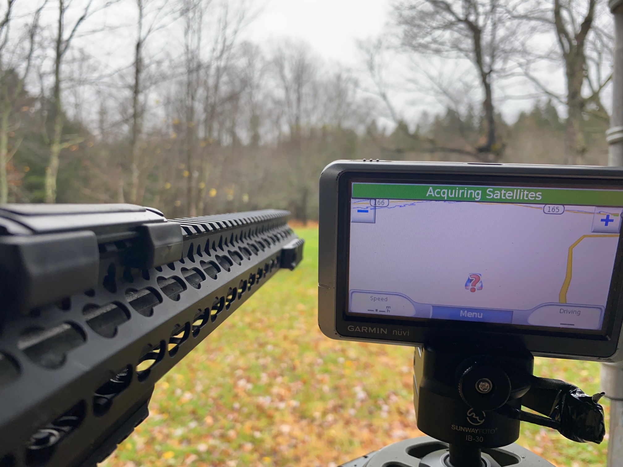

FedEx is still showing my Garmin's delivery as tomorrow. Repeat of a previous pic to stay somewhat on topic.

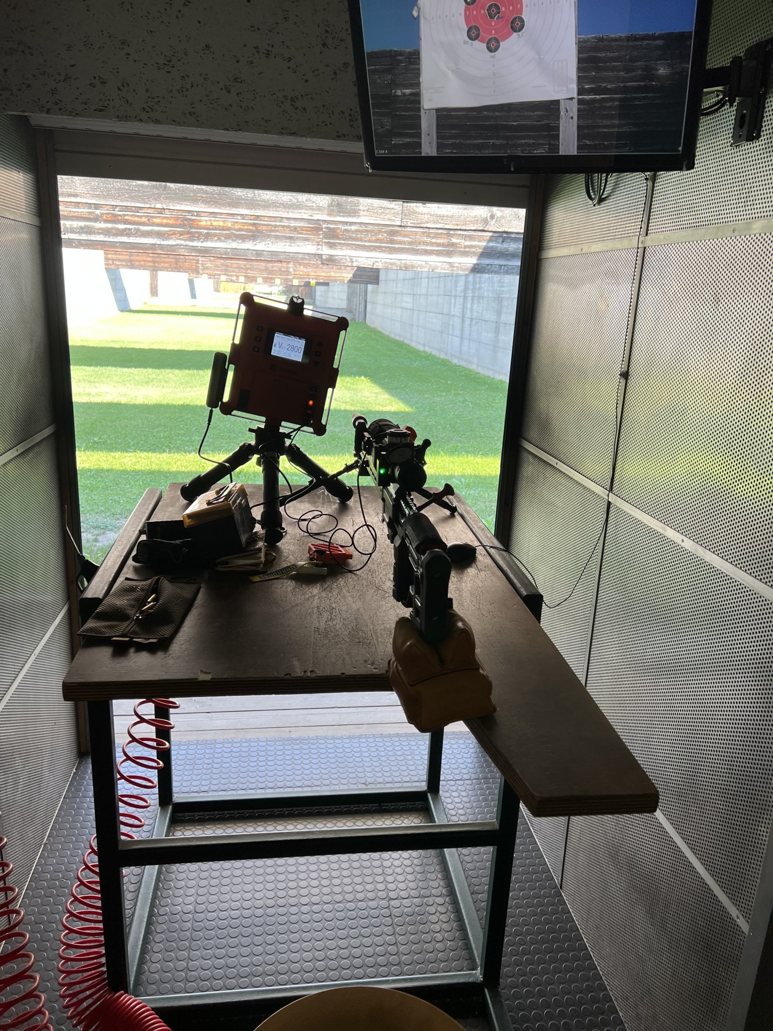

If anyone wanted to see how it does vs a Labradar in situations where another shooter is super close to you I covered that in my video review! Been super impressed with this thing.

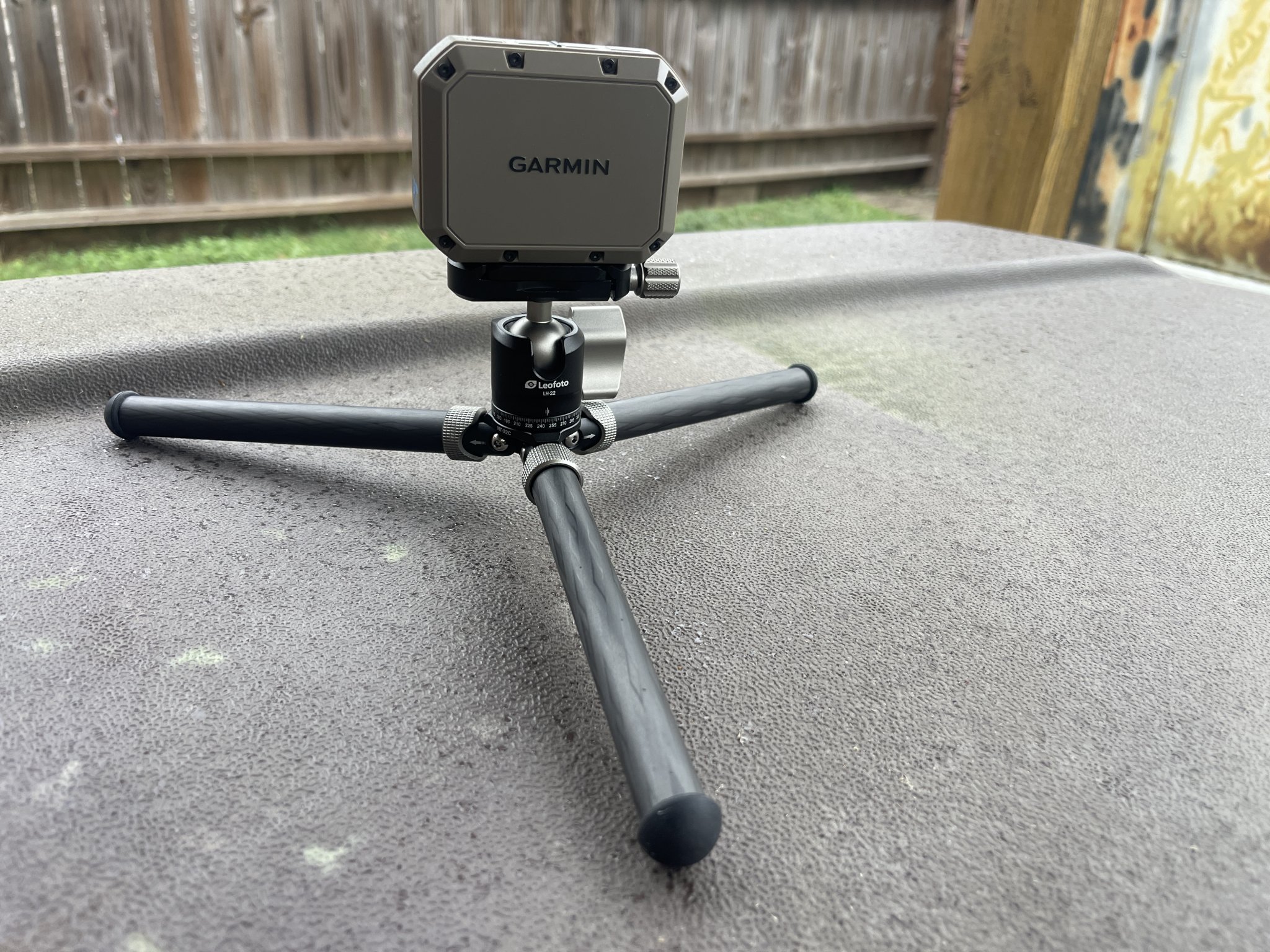

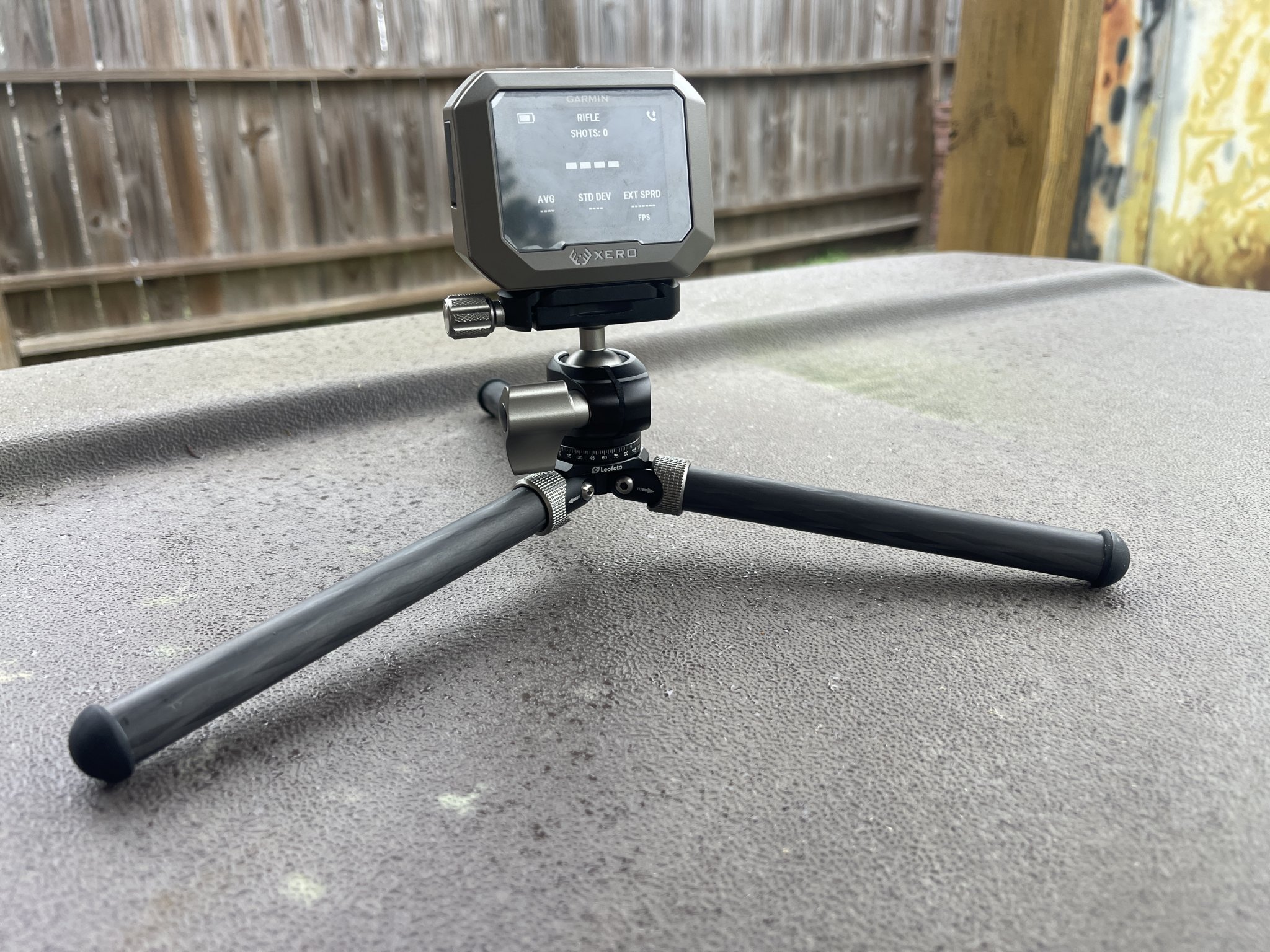

So it begs the question: why even get a ball head when the Xero is so easy to set up (does not have to be exactly lined up) and the added weight and height of the ball head makes it more tippy? It'd be quicker to just pick up the entire thing and adjust anyways.

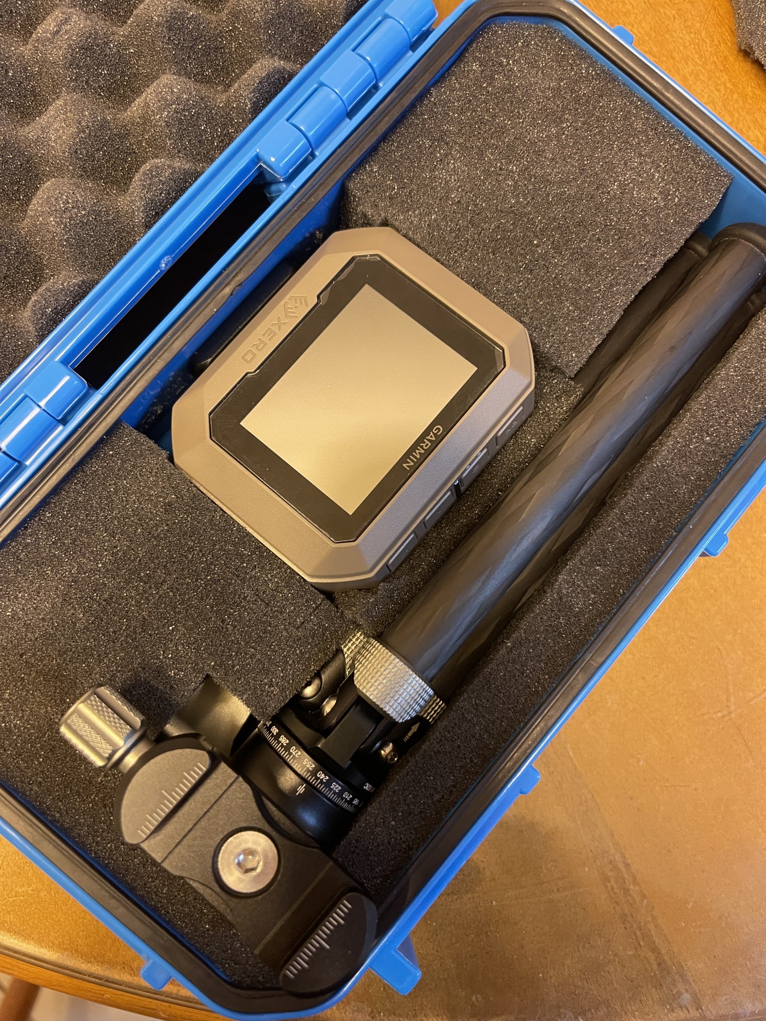

Perfect fitment and not much wasted space. What case please?
Thanks.

Only put it on that ball head tripod to the screens could lineup in the video at the same height. I’ll be mounting my Xero to my diving board or using the oem tripod unless at a match where the zero line is in tall grass.

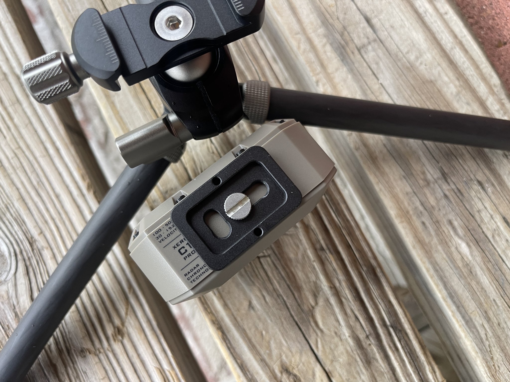

I have this Gitzo mini CF tripod that is pretty damn strong. It came with a nice ballhead but that seems unnecessary for the Xero. I was using it for my labradar but I think the Xero will be a better fit size-wise and I can direct Arca mount it.

I had to make it work. The 56 is just a smidge too small. The lid will close but I have to squeeze it shut. For the purpose of transport and protection it’ll do. It’s not pretty though.
Glad I ordered the 57! Good to see it still fits. I'll prob run my xero vertically, so I can fit a nodal rail in beside the tripod when I get one.

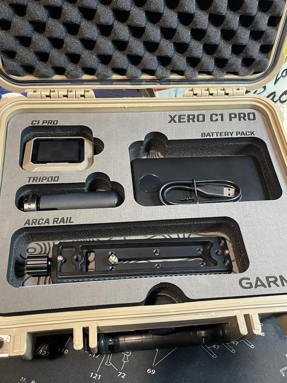

I look forward to a much smaller, lighter unit. Carrying around this large pelican is hopefully a thing of the past
