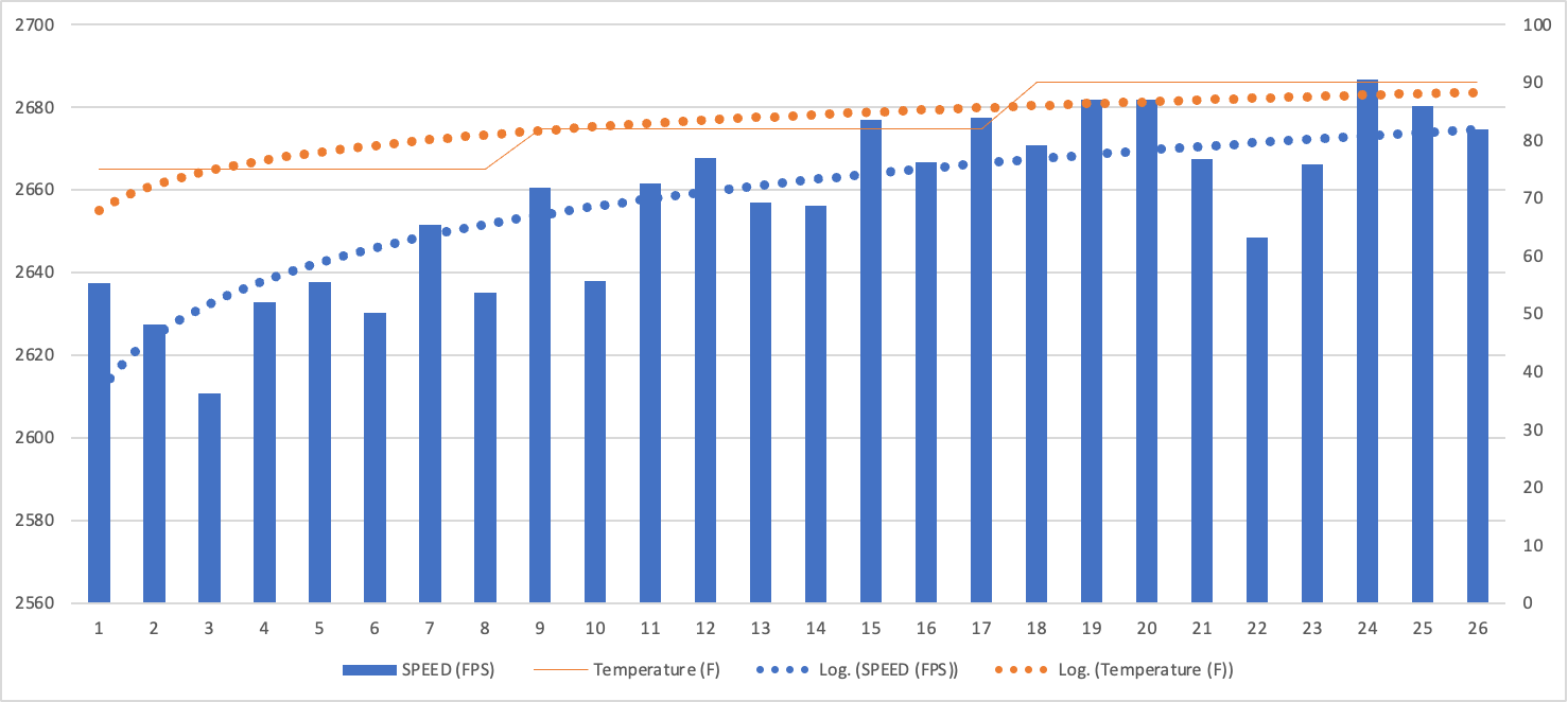

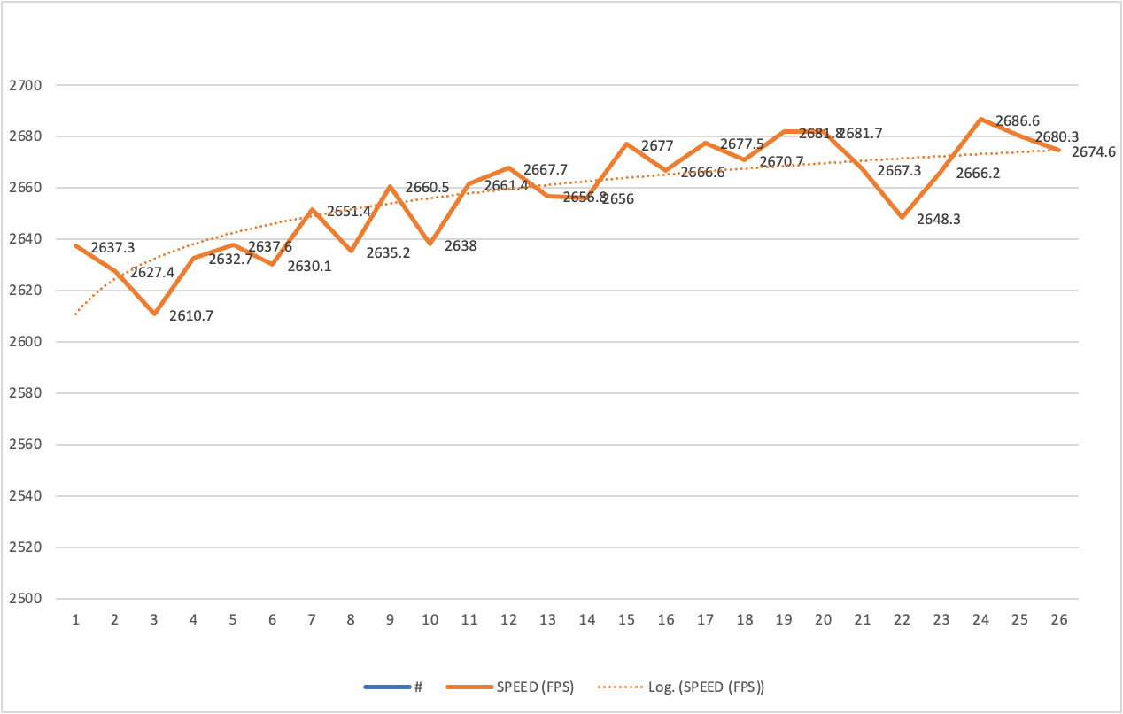

Csv outputs are pretty cool. First trip with it to the range today
Nice graphs.
Where were you pulling your temp data from? Kestrel?
Anway, I haven't gone data mining yet - didn't even look for timestamps on the Xero CSV output for each shot. Assuming it was there?
Yes - Temp data off kestrel. I started in shade then the sun was on us is the reason the temp moved up that much. Going to store temp in my zero notes though for tracking.
The xero records timestamps and delta from average.

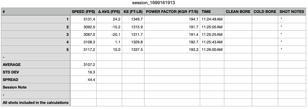

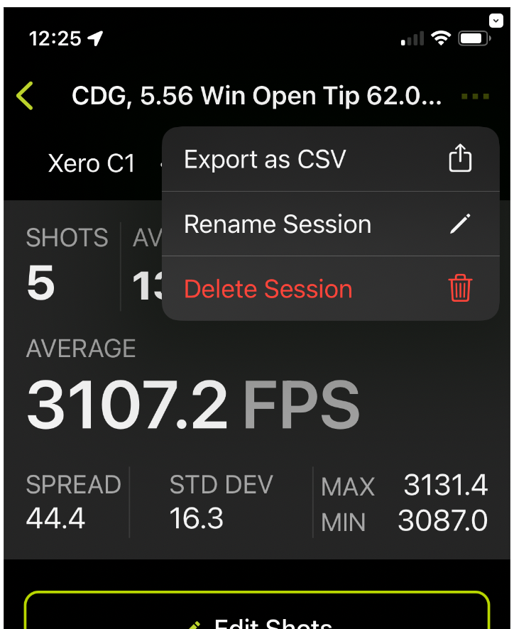

You cannot print the results from within the app.
But you can export the Session as a CSV. Then you will need to open the CSV with another app to view/edit/print.
I haven't had a chance to use mine yet, aside from spacing and changing the color on the top row/first column, did you do any formatting or is this how it spit out the file?

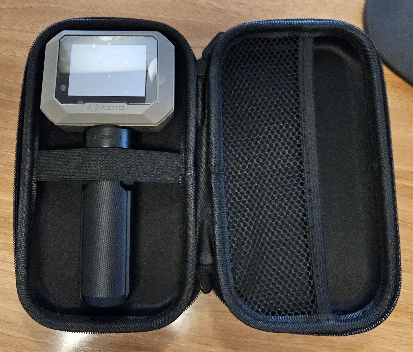

I received mine last week but hadnt opened it I was so busy. Just opened the box and wanted to get it charged up and hot damn this thing is smaller than I thought... I had a spare Pelican 1120 laying around that I thought was small but its huge compared to this little thing. Gonna be so nice not lugging my huge Pelican 1500 Labradar around...

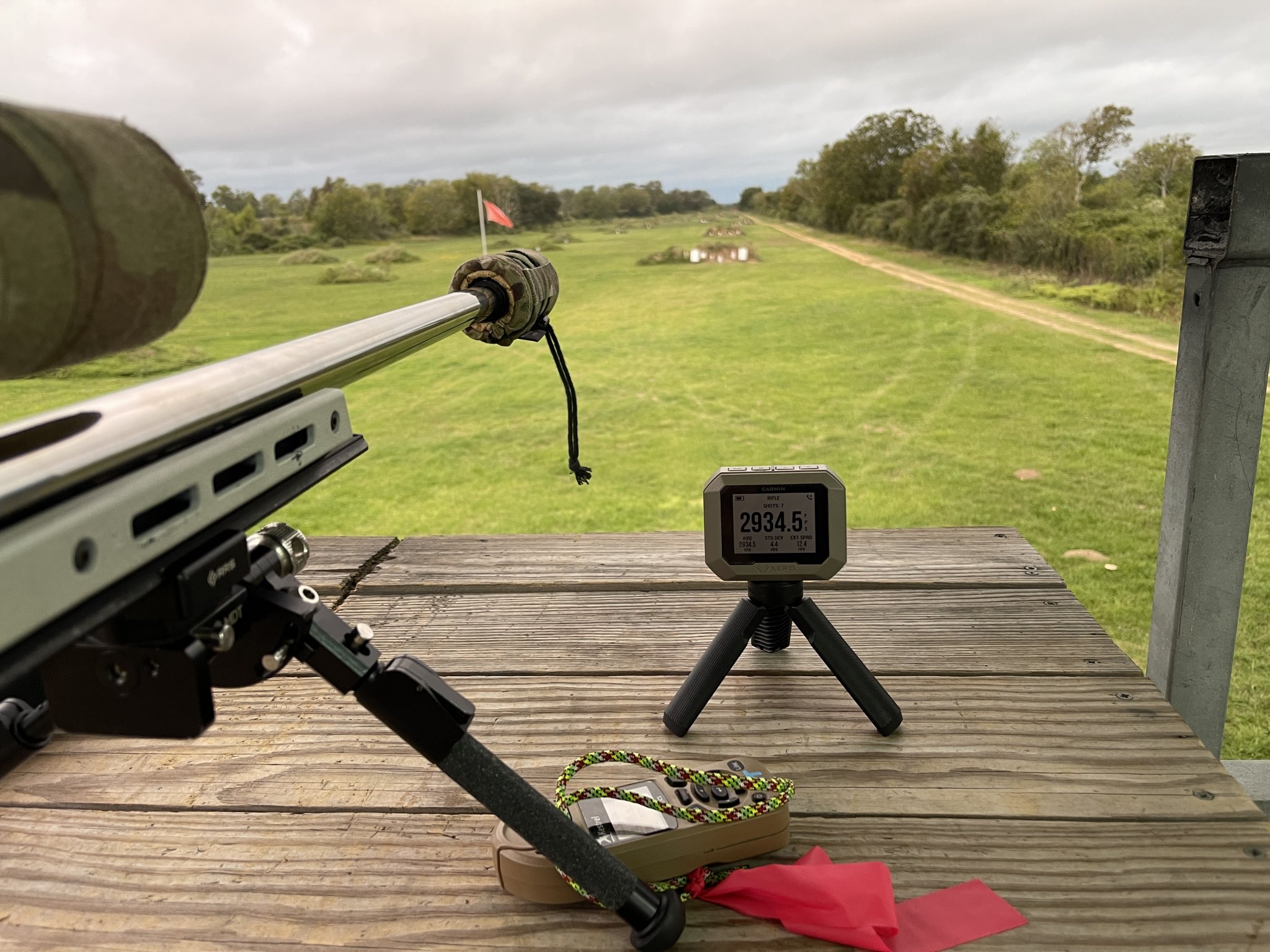

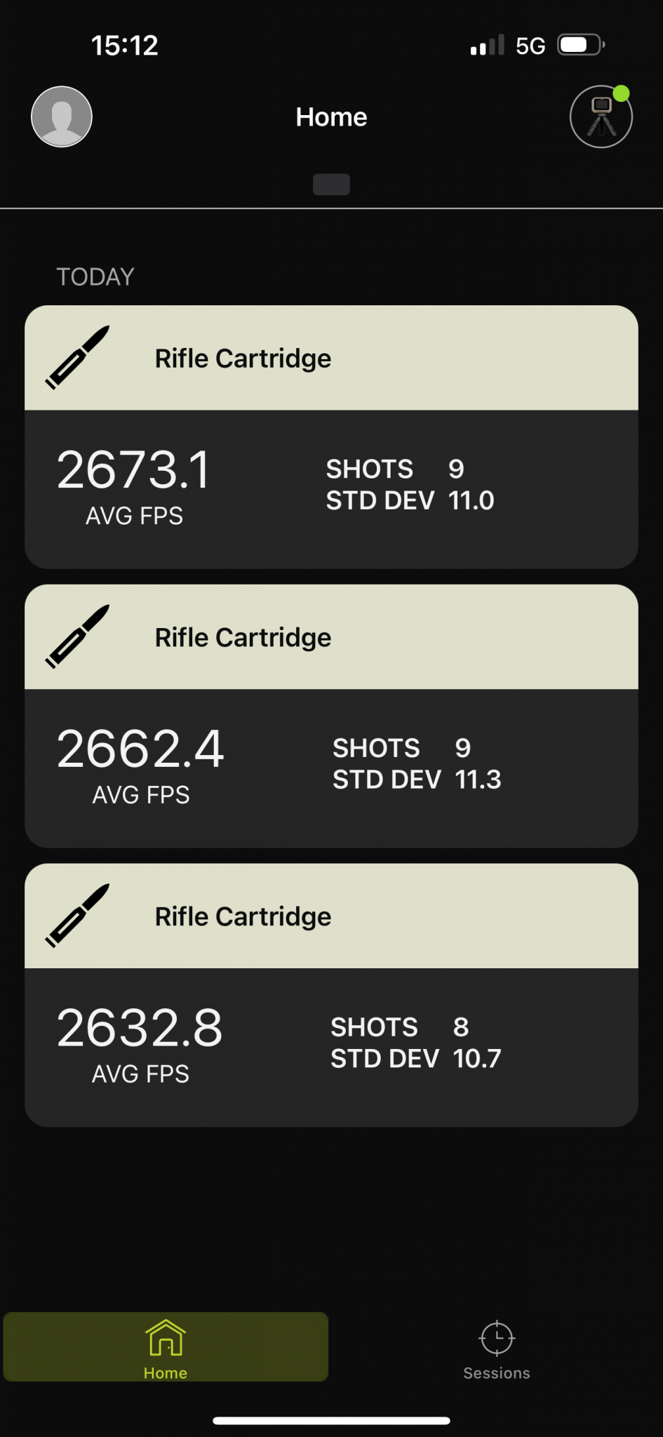

Used it for the first time today. No pre set up practice. Took it out of the case, put on the tripod set it next to the barrel, less than 5 minutes to set up and shoot. Shot a string of 15 at a thousand. Recorded all shots, never had to touch the unit once since the start of the session to end of session. Seamless transition of shot history to phone via the app.
It's so small no one on the line, including non-shooters, noticed that I had it set up. They still don't know, even after finishing and putting it away.

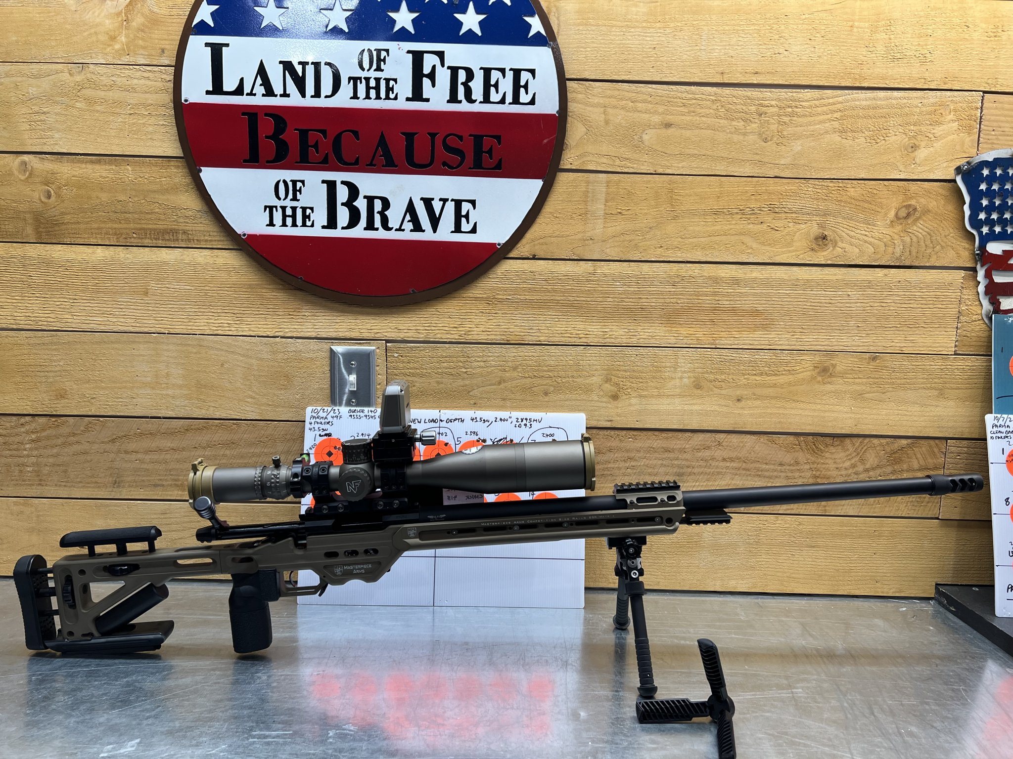

I did some testing today on Quantico's Range 4. It's always a 1,000yd day on Sunday, but I wanted to try the Garmins against the Labradar. Unfortunately, I only captured one shot on the LR, which is the problem and why I looked forward to testing the new Garmin doppler chrono (in fairness, I only tried aligning the LR a couple of times before I just went back to shooting). I shot 10rds of factory Hornady 225gr ELD-Ms unsuppressed and then suppressed with a TBAC Ultra 338. I also chrono'd 3 other rifles on the line, there were no missed shots for 30-06, 6.5 and .223 rifles, as well as my 300PRC.
The Xero C1 Pro is simply a game changer. It was the discussion point for everyone one the line and I hope I helped sell a few more units as shooters were so impressed with the size, ease of use and reliability of the unit.
ETA - A couple of suggestions for @Garmin:
  • Increase the brightness of the unit
  • Add a sequential number to the history in the session summary on the device. Even though the latest session appears at the top of the summary (and has a timestamp in the app), it will become confusing when multiple entries are saved when not using the app.
ETA II - F' daylight savings time, geeeeeezeus, it's 5:30pm and dark...
I positioned the two units to the left and right of my AXMC in 300PRC with a TBAC brake.
I repeated the testing with the TBAC Ultra 338 suppressor, which added some distance back to the units.
The results:
We were shooting steel from 637yds to 1,000yds.
Bonus pictures.

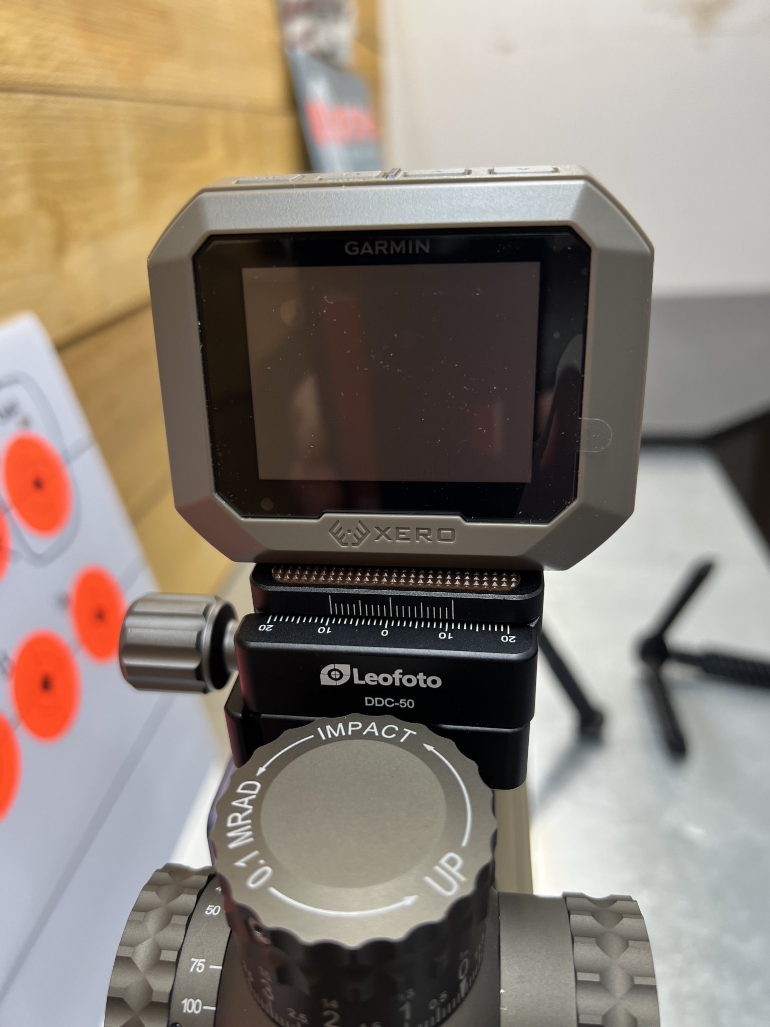

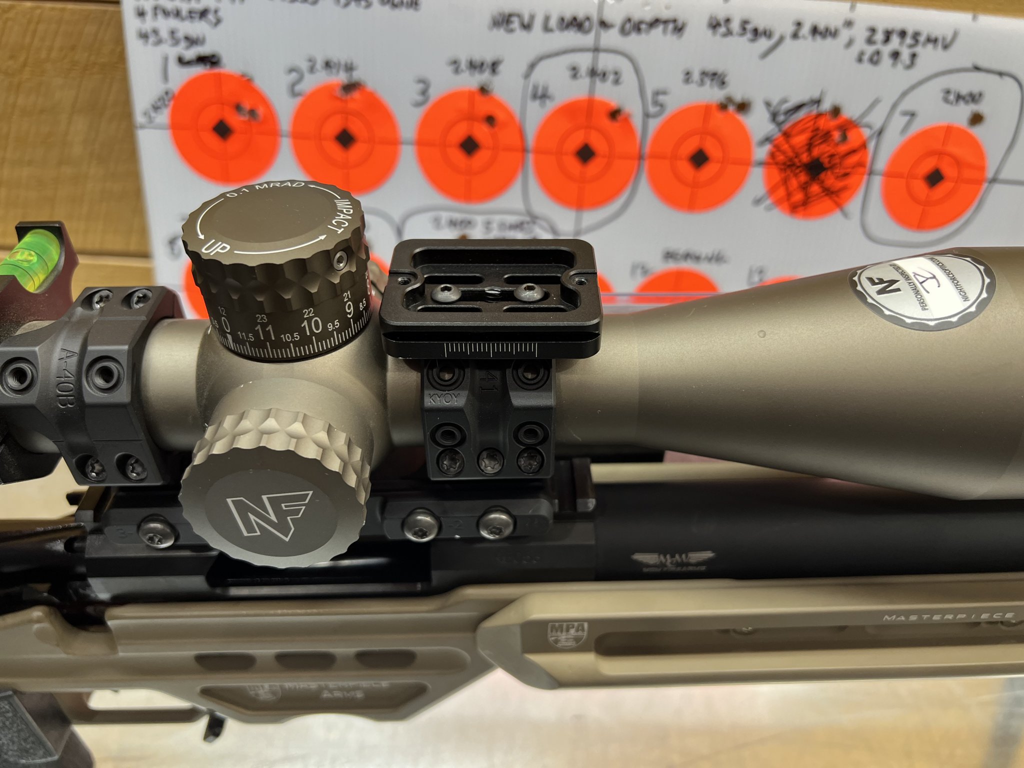

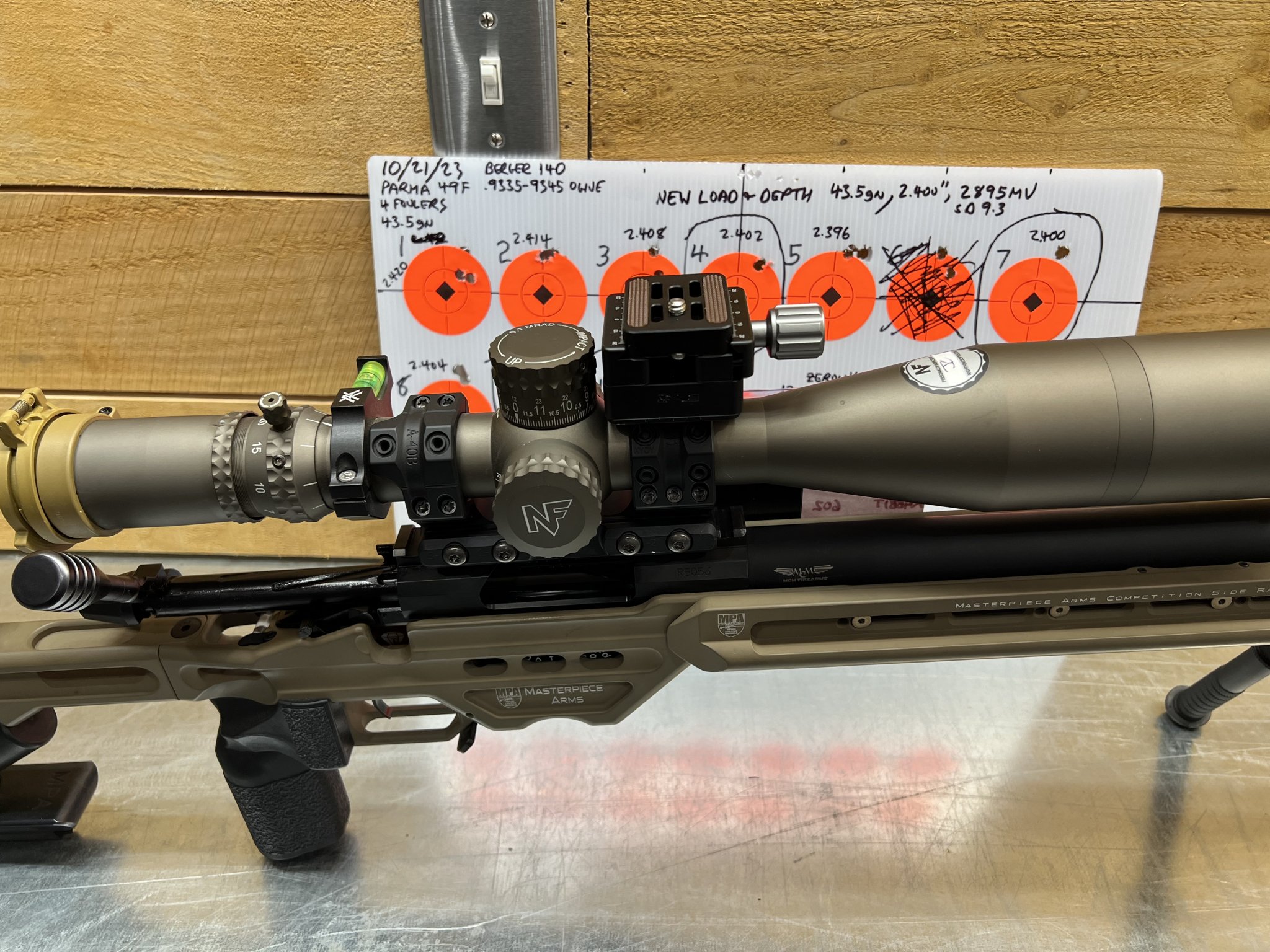

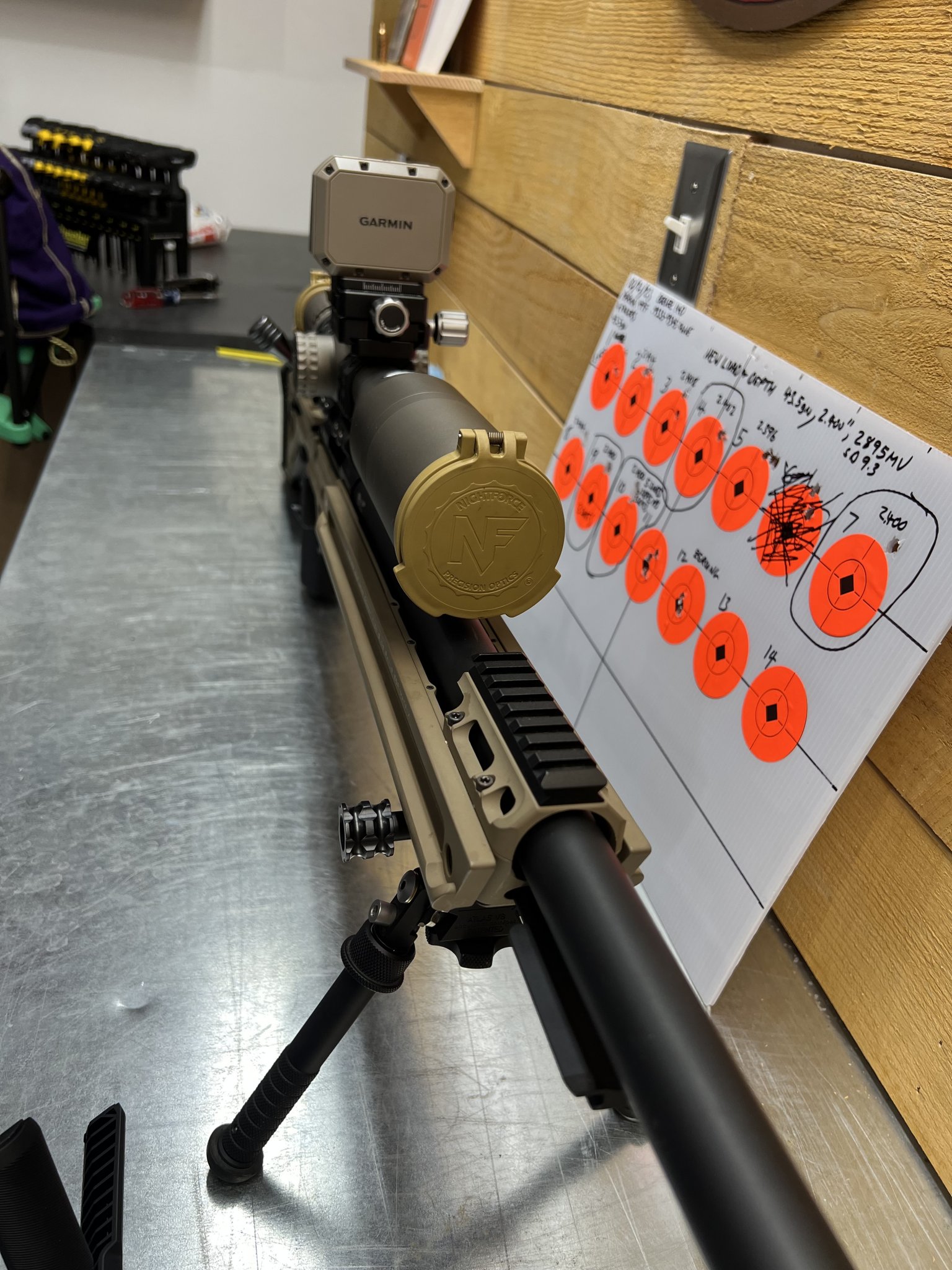

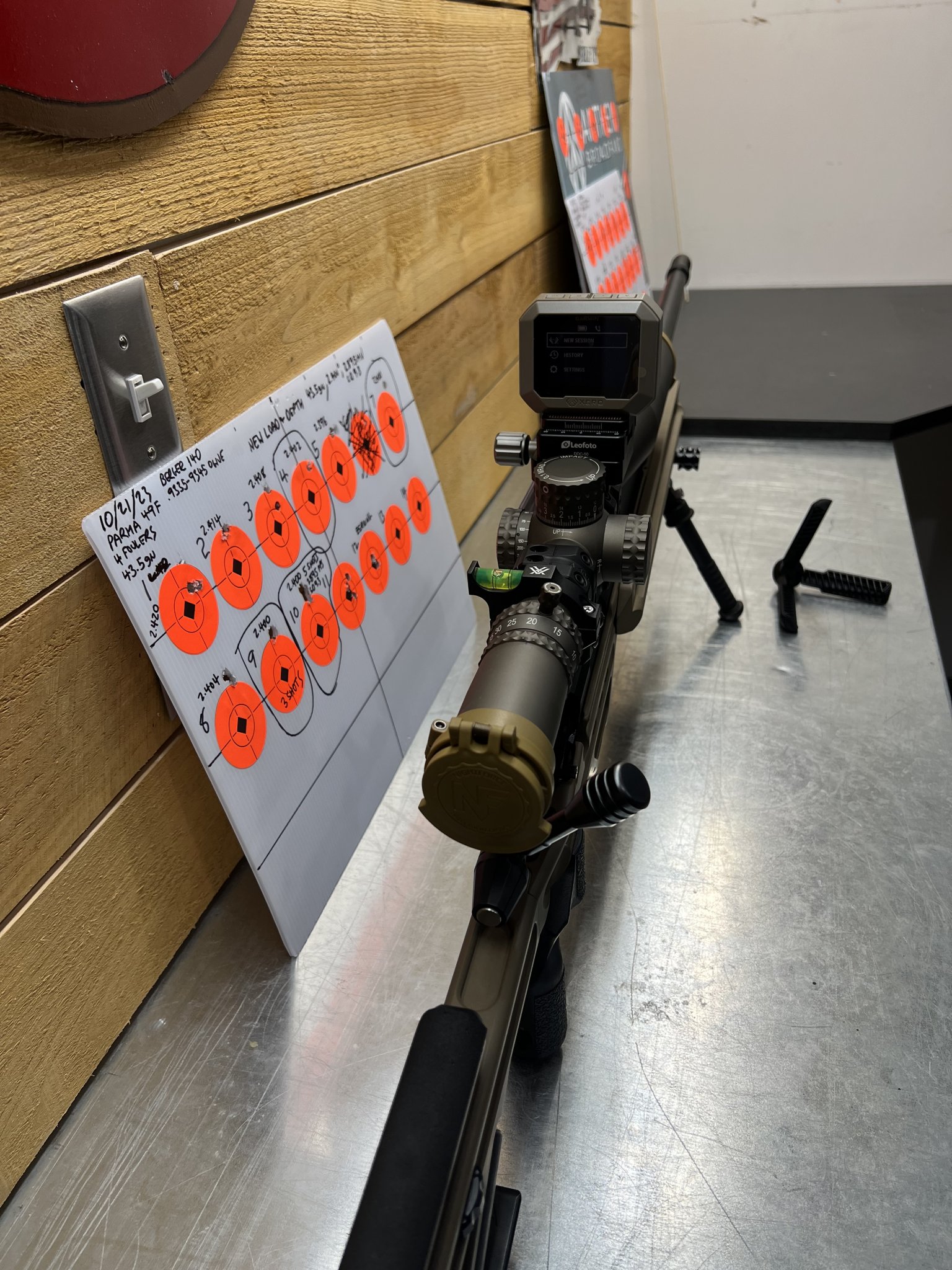

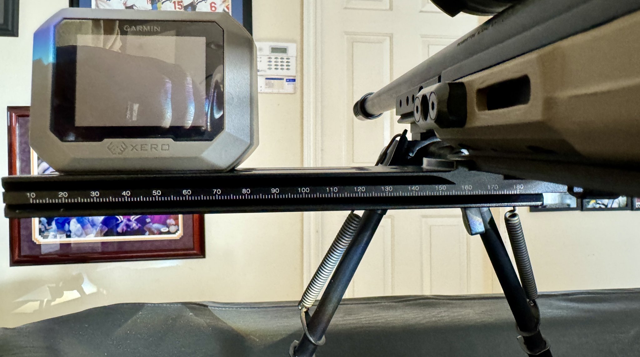

Just got mine today. Really amazed at the small scale and weight. Here is my temporary setup using clamps & QR’s I already had until my diving board comes
View attachment 8265999View attachment 8266000View attachment 8266001View attachment 8266002View attachment 8266003View attachment 8266004
I think you need the new Vortex LRF mounted on your scope, and the Xero mounted on top of that. And then a red dot on top of the Xero for faster target acquisition.

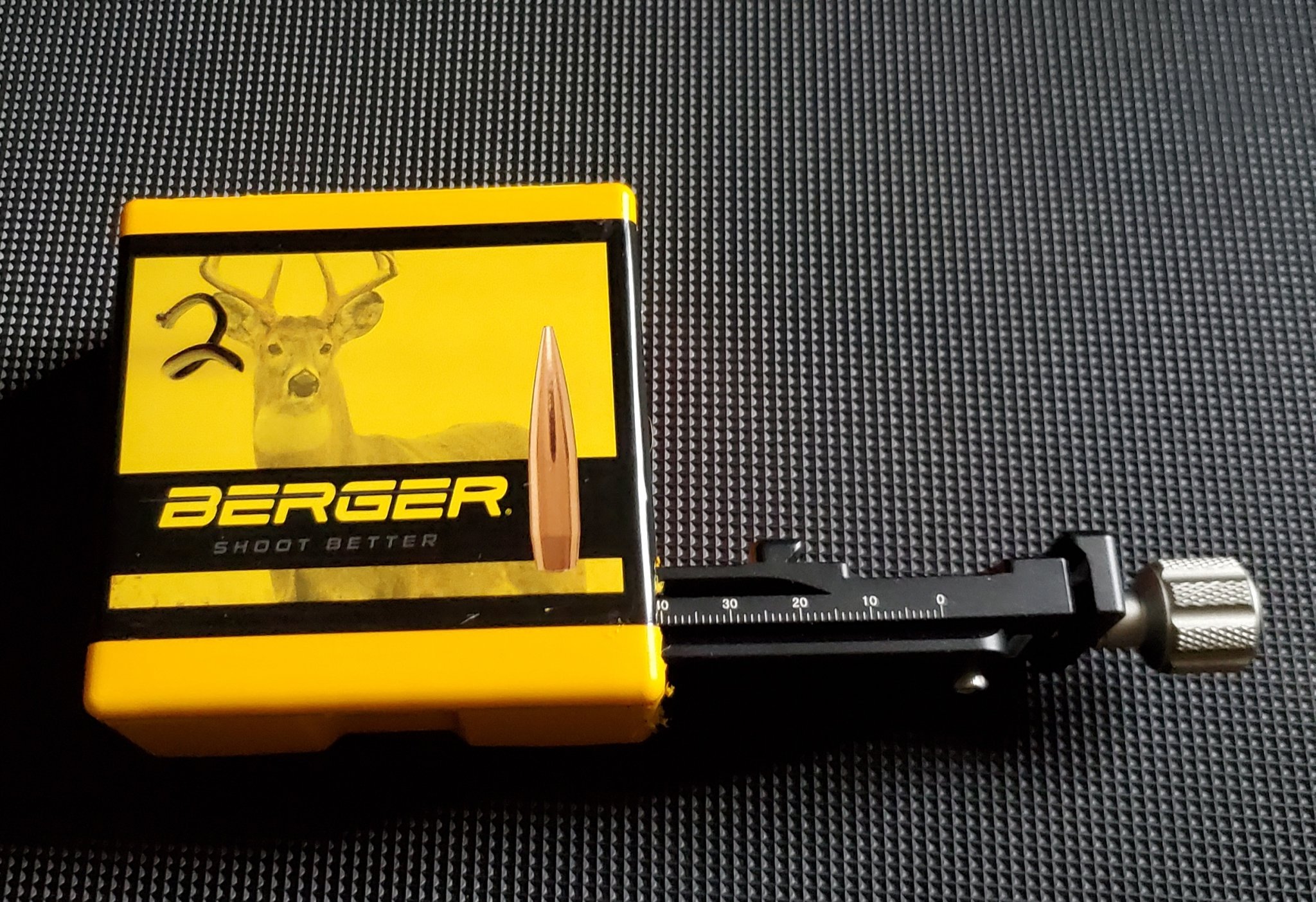

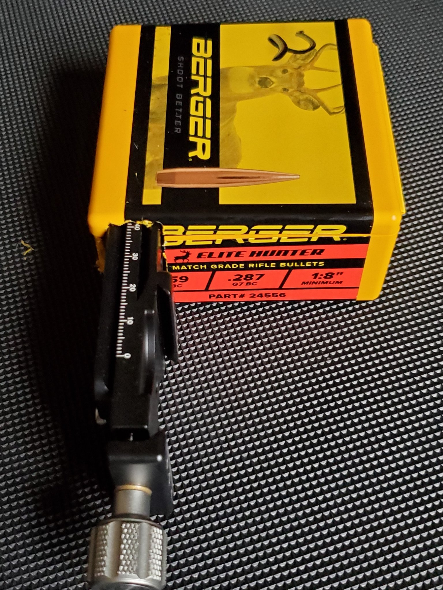

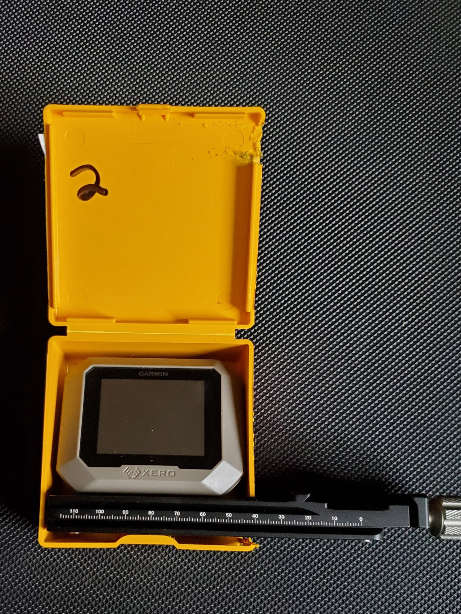

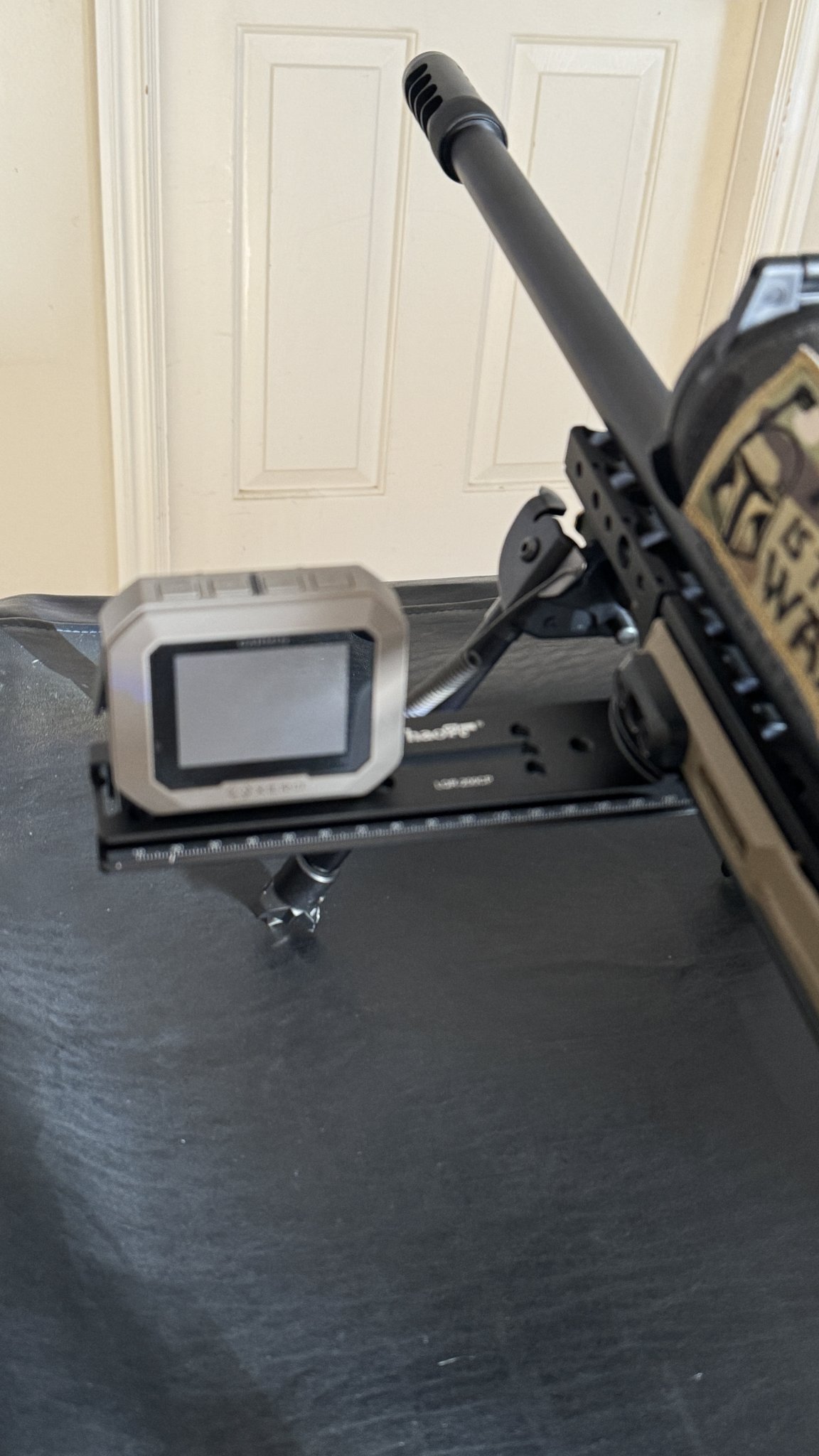

Good use of available items.
My range bag is heavy and packed to the gills.

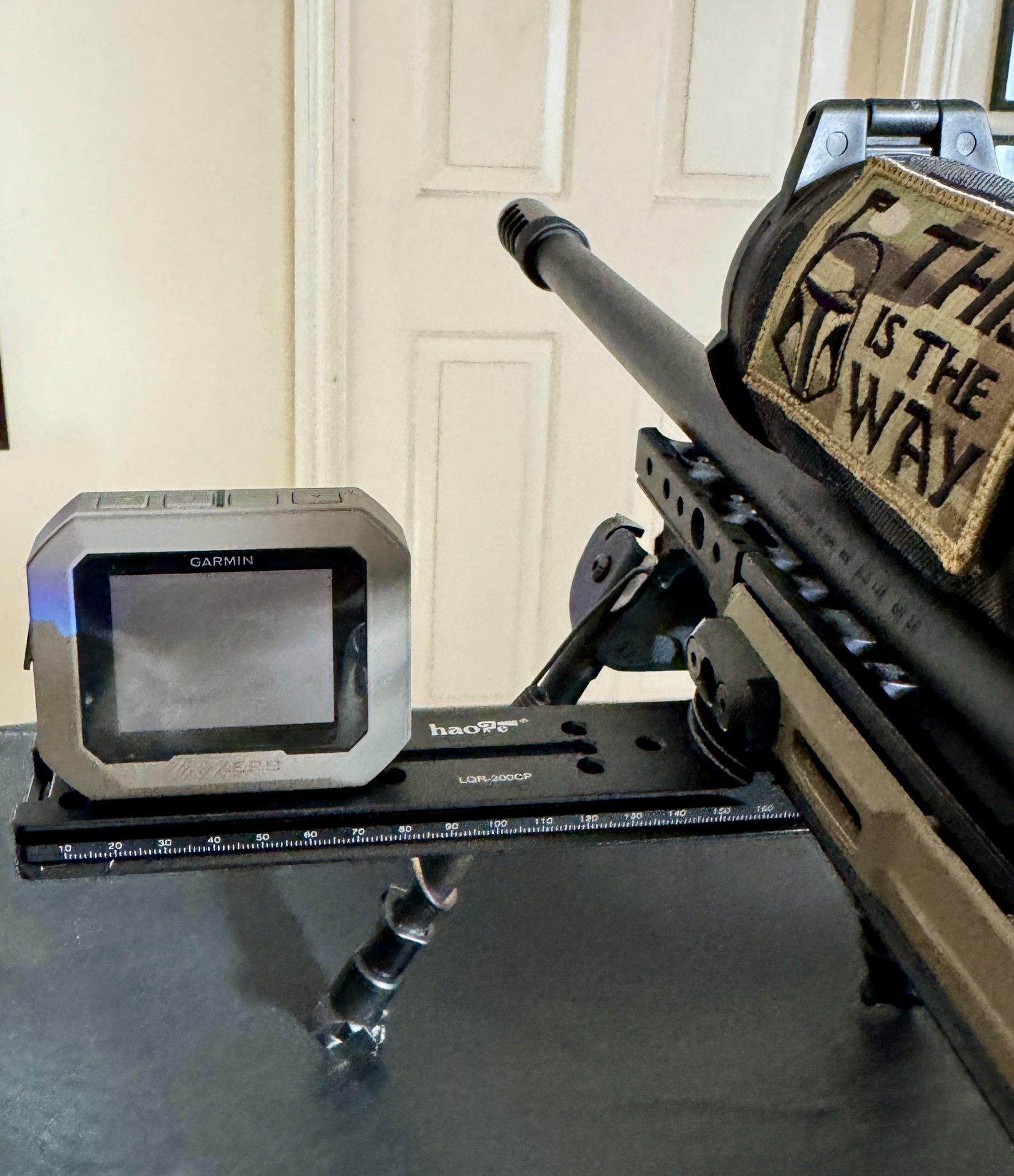

Do you have any concerns that the lever arm might torque/damage/break the Garmin Xero mounting point?
Anything is possible but it's a good fit in the box, I'd say it's much less likely than it would be without the box. That said, if it's a concern, take the rail off and there would be enough room in the Berger box for the foam packing the bullets usually ship with to pad the garmin.
