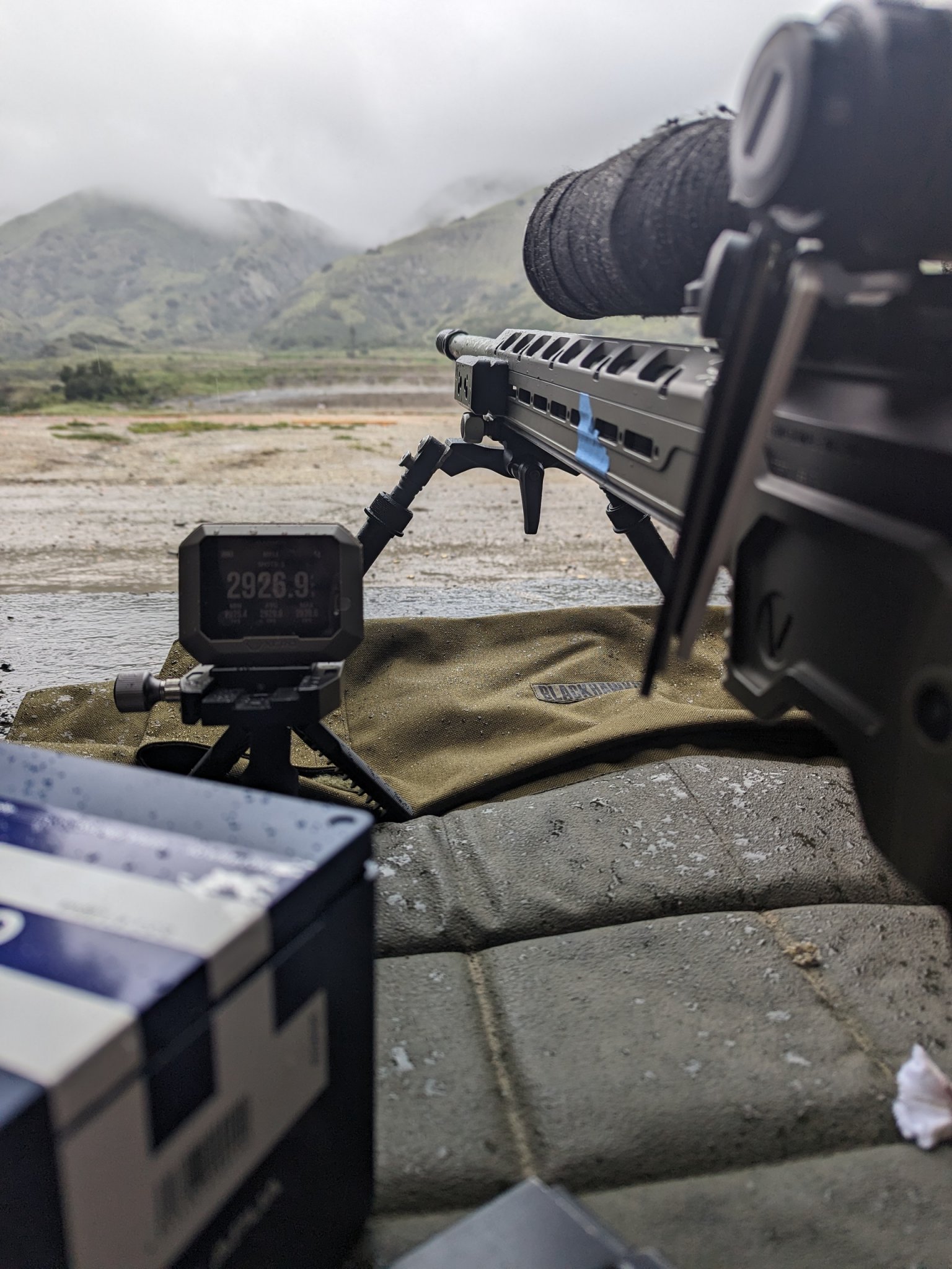

Got mine yesterday and took it to the range today. 66 shots and not a single unrecorded shot. But I did notice something. The OK button needs to be pressed much harder than the rest of the buttons for it to function. Anyone else has that issue or is that normal?
Sort of... You have yours sitting on a padded mat, as do I. The OK button is on the far left. When I press it, it has the effect of trying to tilt the unit by compressing the left leg into the mat, so using the same amount of pressing force on it results in some of it getting absorbed by the mat vs transferred directly to the button. Holding the Garmin solidly in my hand, the buttons all take the same amount of force, but sitting on a padded mat the OK button has to be pressed harder to overcome the compression/absorption of the mat. The buttons in the center don't have this issue because you're putting the force on the center of the unit and all three legs are supporting it evenly (less mat compression). The DOWN button on the far right probably behaves similarly to the OK button if you press it with the unit on the mat, but I haven't noticed that because I rarely press that button when the unit is on the mat recording shots.
Reactions: sgtsmmiii
Thanks. Mine has the same issue even when when it's out of the tripod and in my hands. The OK button is definitely harder to press than the rest. Also the other buttons have a tactile/audible click when pressed but OK doesn't.
And I rechecked all four of mine when I just went and put it on charge. No significant difference in any of them.
It's probably nothing to worry about as long as it functions every time.
