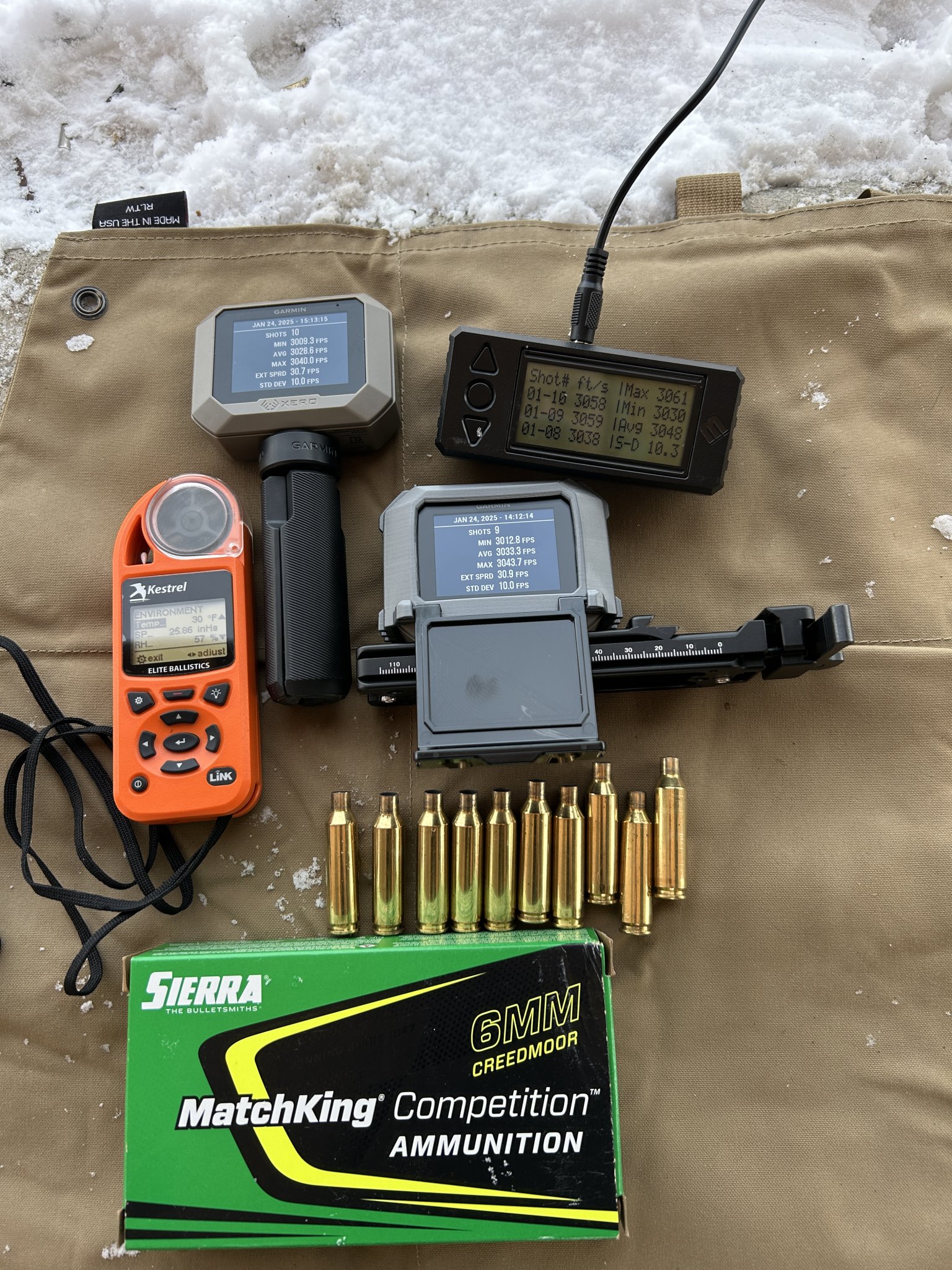

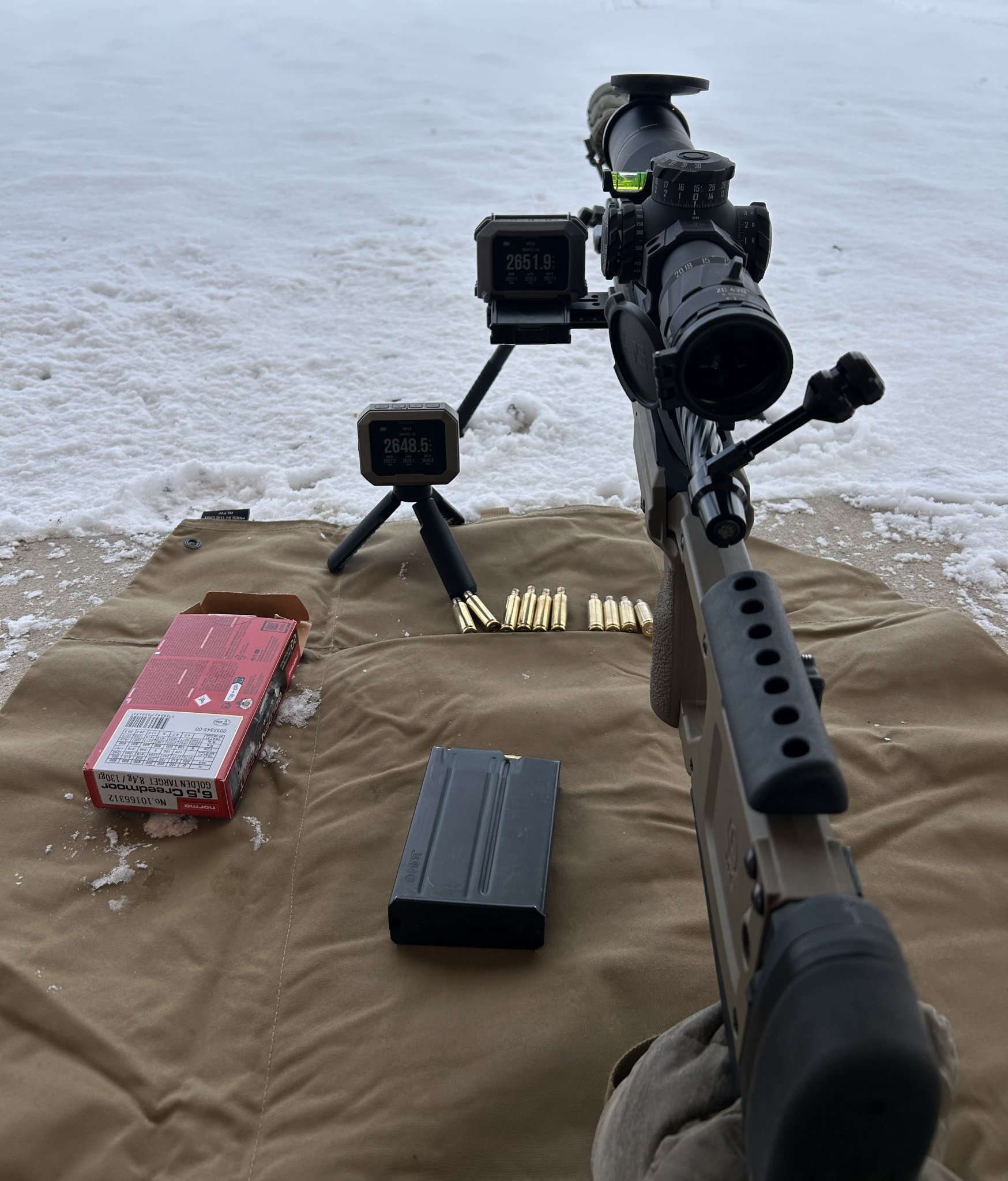

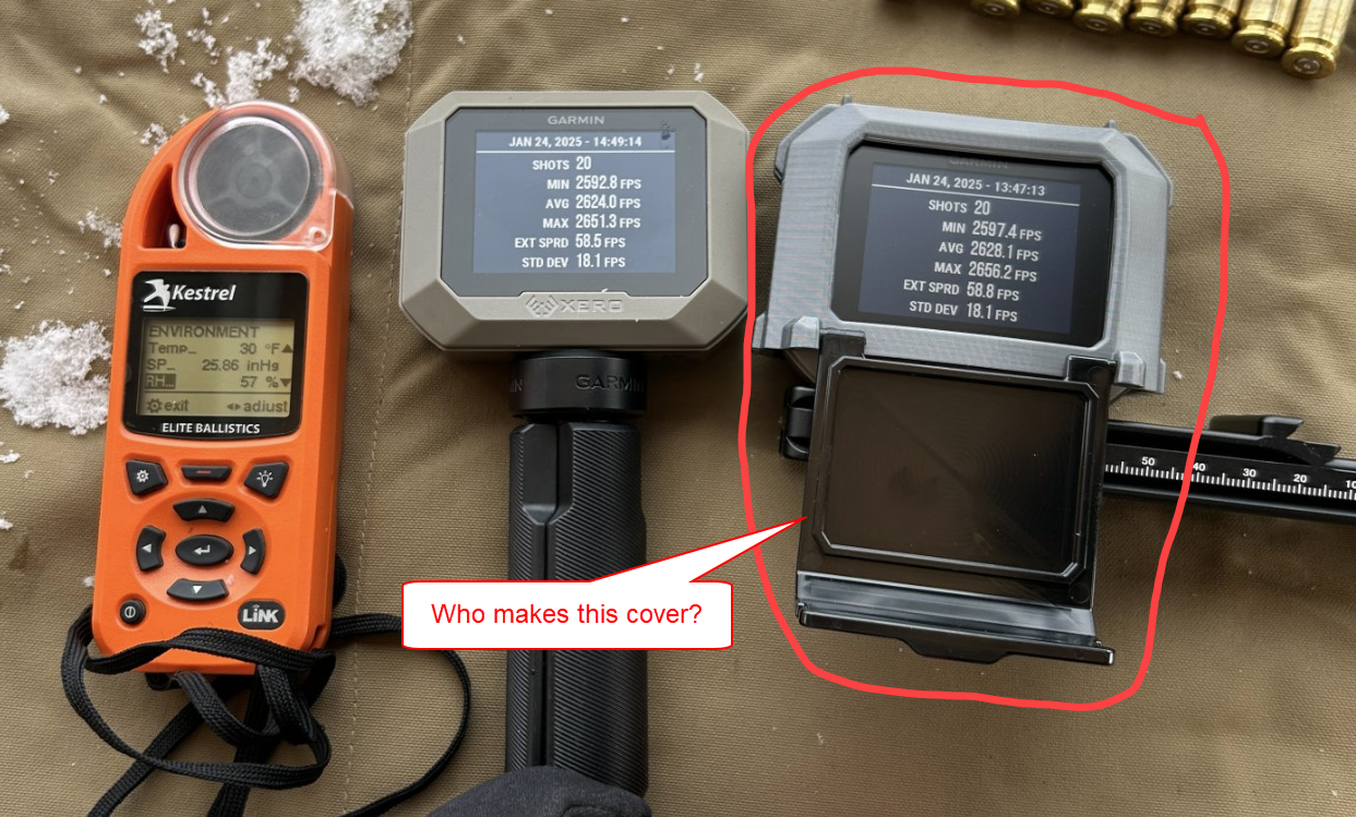

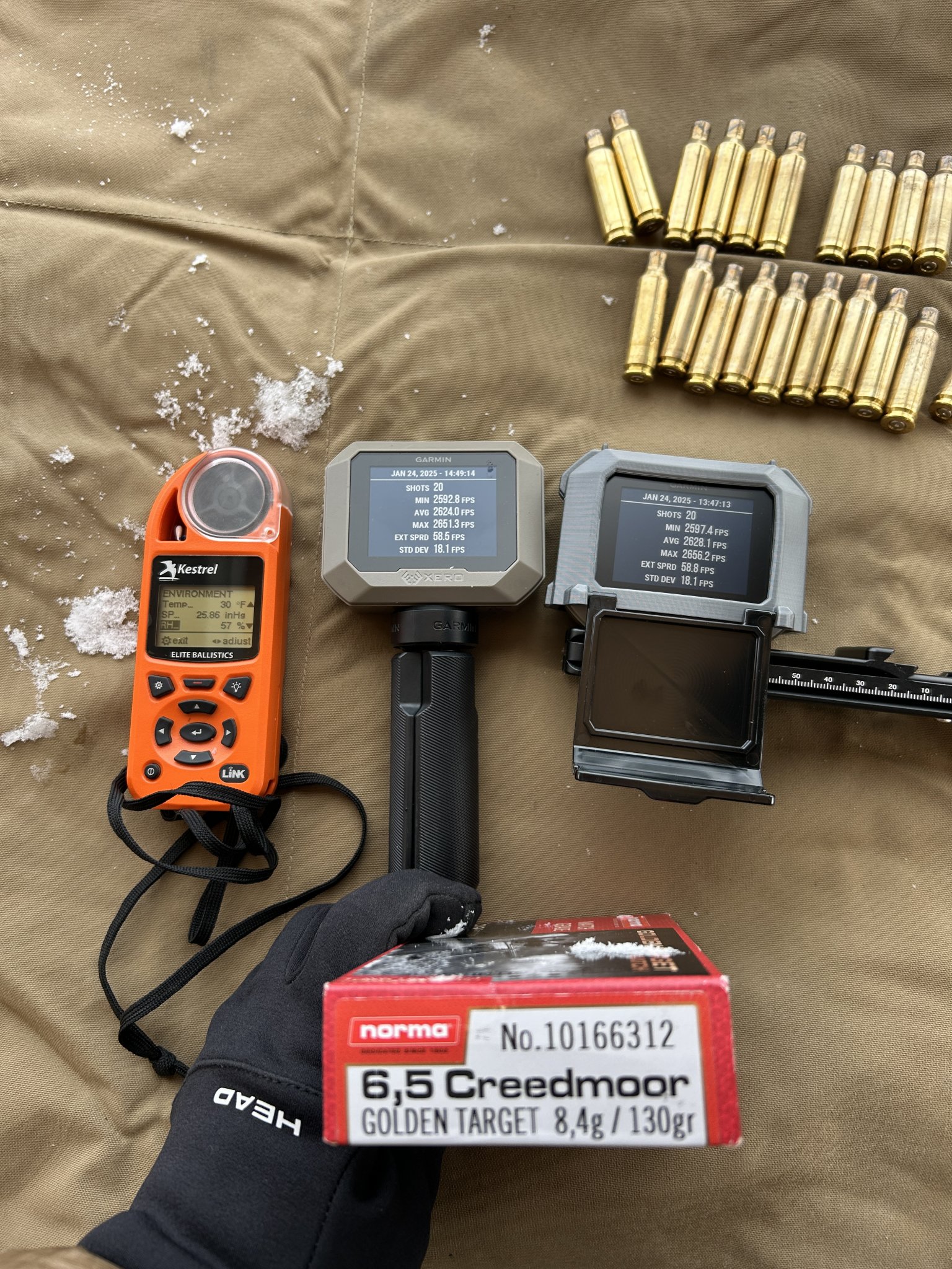

What was the distance the Oehler Cronograph was from the muzzle?
It is dificult to say from the picture, but it seems like around 6 feet (2 meters)?
Skyscreen chronographs measure velocity midway between the "start" and "stop" screens (no offense intended, you probably know this but there may be some readers that don't).
I think the start screen was 9.5 feet. I was using a 9 foot spacing so the point the Oehler was measuring velocity would have been 14 feet in front of the muzzle (that is also the location of the "proof" screen...the Oehler makes two velocity measurements on every shot).
The Oehler measured velocity at 14 feet and I had two Garmins at the same distance from the muzzle. Therefore, my conclusion is that the Garmin measures velocity somewhere in front of the unit and uses interpolation to calculate the velocity at the unit.
Since they recommend you place the unit between 5 and 15 inches behind the muzzle, the only question would be "How much velocity difference is there between muzzle and 5 - 15 inches behind the muzzle.
I call the reading "Muzzle Velocity" and go from there.
(edited to correct the distance at which the measurement was taken. 1/2 of 9 is 4 1/2. so, 9.5 plus 4.5 = 14. DUH!)
Reactions: LRCampos
Hmmm…interesting results. While not conclusive, that seems to imply that the Xero is measuring velocity somewhere beyond the muzzle and that mounting the Xero gives somewhat faster velocity results. Though some of that might be within the noise of testing and instrument accuracy.
I saw better agreement when running a Magnetospeed at the same time as a Garmin. Don't know what caused the disagreement in the photos.
That can happen with any instrument. It is the reason I run two whenever making important measurements. IF they are in good agreement, everything is probably good. If not, I've got a setup issue and I adjust to fix it.
I've heard mounting one on a rifle may influence the velocity reading due to backward movement of the rifle at ignition. I've not tested for it, though.

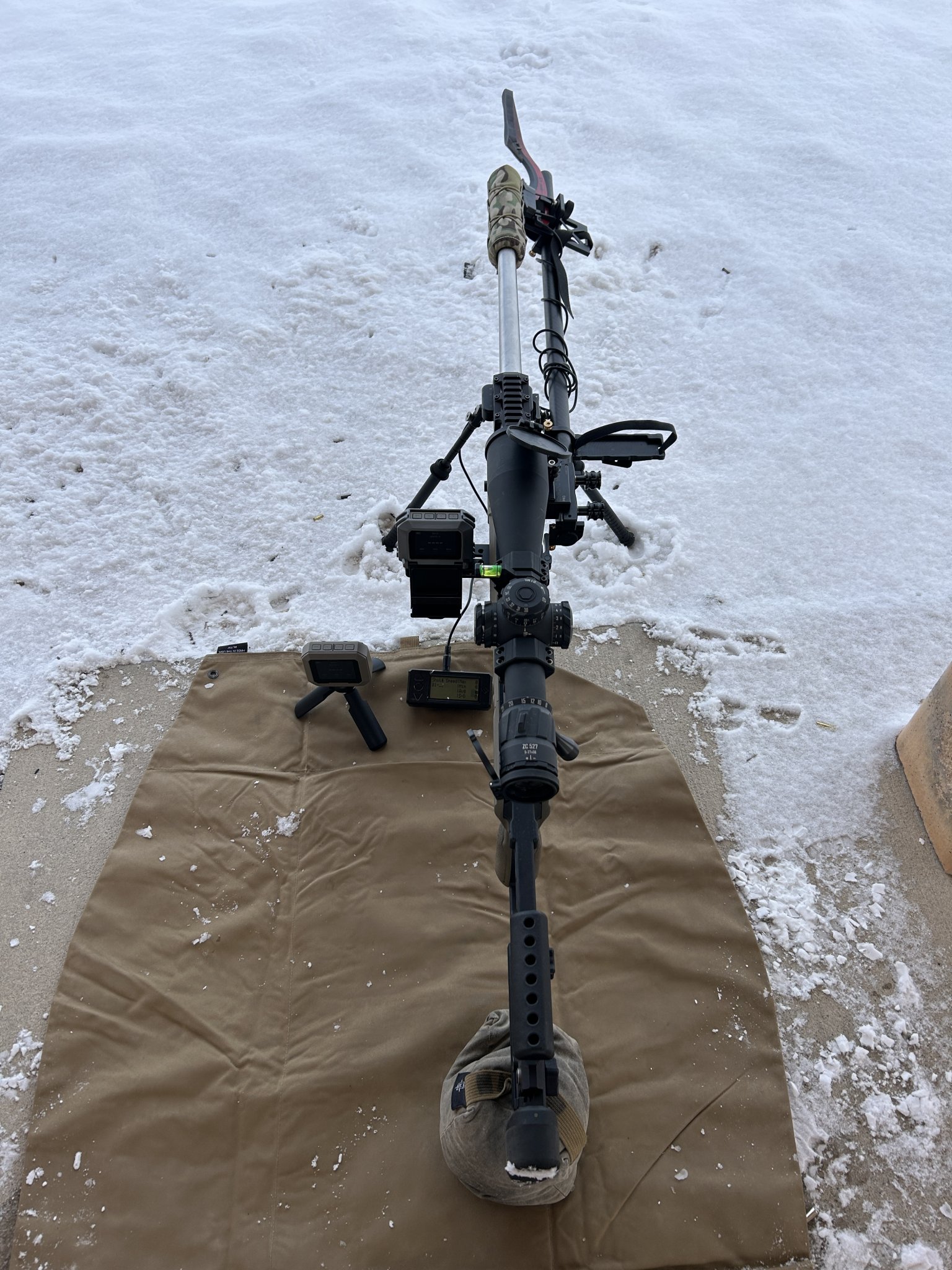

How far back from the muzzle is that mounted Garmn?
Rifle #1 is +/- 16"
Rifle #2 is +/- 13"
Rifle #3 is +/- 15" (not shown)
I wasn't setting out to perform any sort of 'test'. I was just grabbing quick MV before a match, and I had a couple Garmins on hand. I'll set-up next time with garmin mounted forward (closer to muzzle) and compare with the MS. I'll probably only have 1 Garmin though.

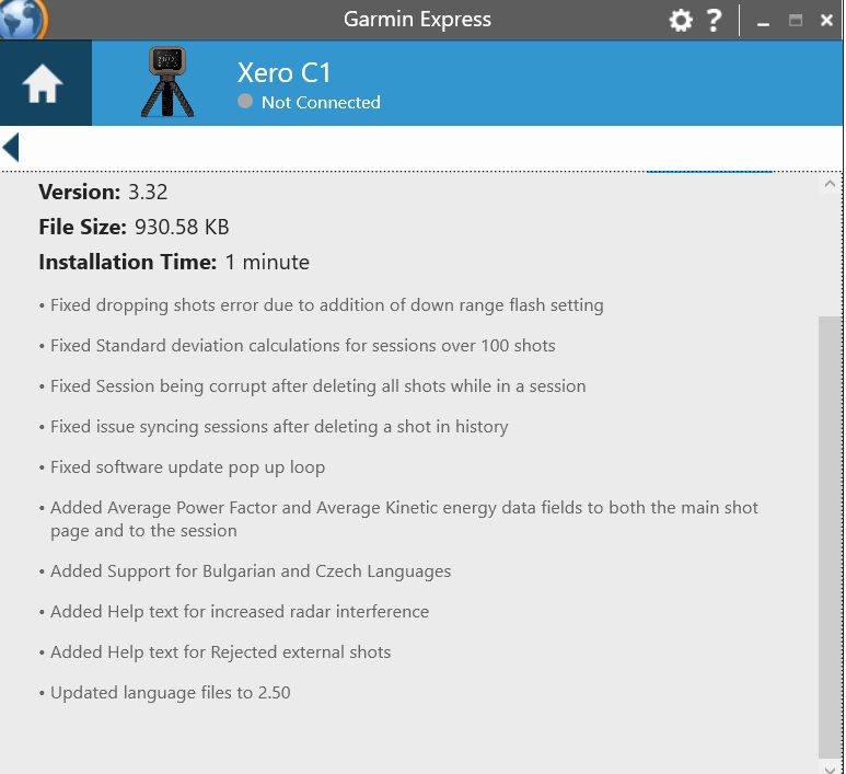

My garmin updated today at the range, missed on average 1 of every 5 rounds after the update installed. It has rarely EVER missed rounds prior to this. F'n GAY garmin! Was just at the range two days ago and it worked perfectly......as it did for 20 rounds before the update installed today.
  • Angry
Reactions: johnnyvw
What is the version number?
Reactions: Holliday
Mine updated at the range yesterday as well. Has not missed a shot.

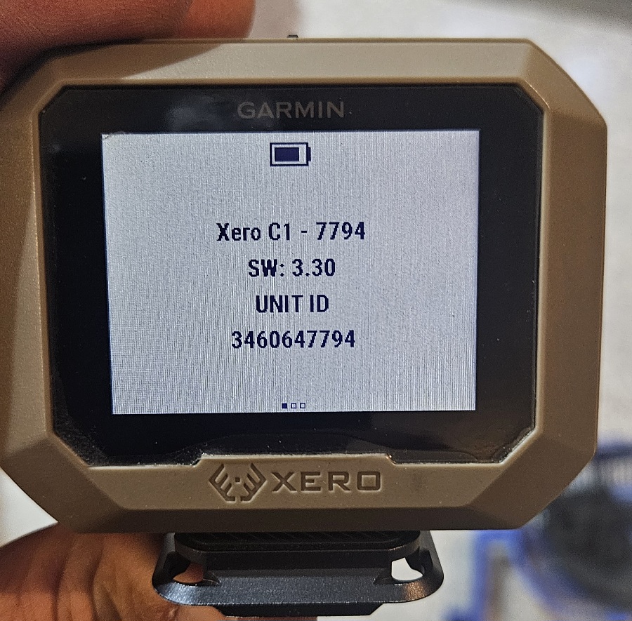

Both mine and my friends updated earlier this week. I shot (8) 5 shot groups, 6 of the groups only picked up 4/5. He had similar issues and neither of us had an issue before. Both are running 3.30.
Damn,I will be refusing the update. Hopefully @Garmin is getting this. Thanks for letting the rest of us know. Sorry you had to take a hit for the team……
ETA: Just synced with my phone and now it’s bugging me to update when I turn it on.
Definitely don't update to 3.30. There is for sure an issue. Just got back from the range and it missed about 30% of all shots from my .223's. I also had my 22lr with me and it picked up every one of those without issue. This thing missed about 5 shots total in its lifetime, but today alone it missed at least 20. The update was the only change.
Reactions: Genin
I experienced the same exact thing this weekend. Super annoying.
Garmin was attached to rifle via the arca rail so position was fixed. All fired from a bolt action so plenty of time between shots IMO:
String 1 - 30/30
String 2 - 30/30
String 3 - 27/31
String 4 - 9/10
So it started falling off and I don’t know why. Better than it was before the most recent update, but not perfect.
Reactions: lash
String 1 - 30/30
String 2 - 30/30
String 3 - 27/31
String 4 - 9/10
You guys are definitely convincing me to make sure not to update my software. I'm looking to keep the 1k+ round streak alive of never having the Garmin fail to capture a rifle shot. It has even done well enough with pistol rounds given that I never have it positioned within it's recommended alignment window when using it on handgun as the little shelf at all the pistol ranges is well below bore level.
I wonder what they changed to cause this issue with dropped shots? Did they change something in the units determination of whether a shot is from the intended shooter or an adjacent lane? I don't think those settings needed to be messed with. I have had a lot range sessions with dudes shooting in adjacent lanes and have not had any of their shots mistakenly read as one of mine.
Yeah leave yours alone. I will add I had no other rifles around me, I was shooting in a giant bay all alone. @Garmin please fix this.
