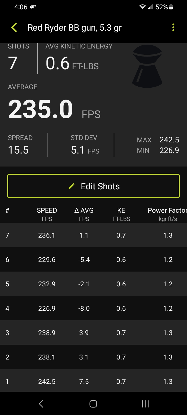

It shouldn’t be a problem if you use the pistol/low velocity setting. I cross checked the velocity of a single cock bb-gun and was registering velocities in the 300 fps range.

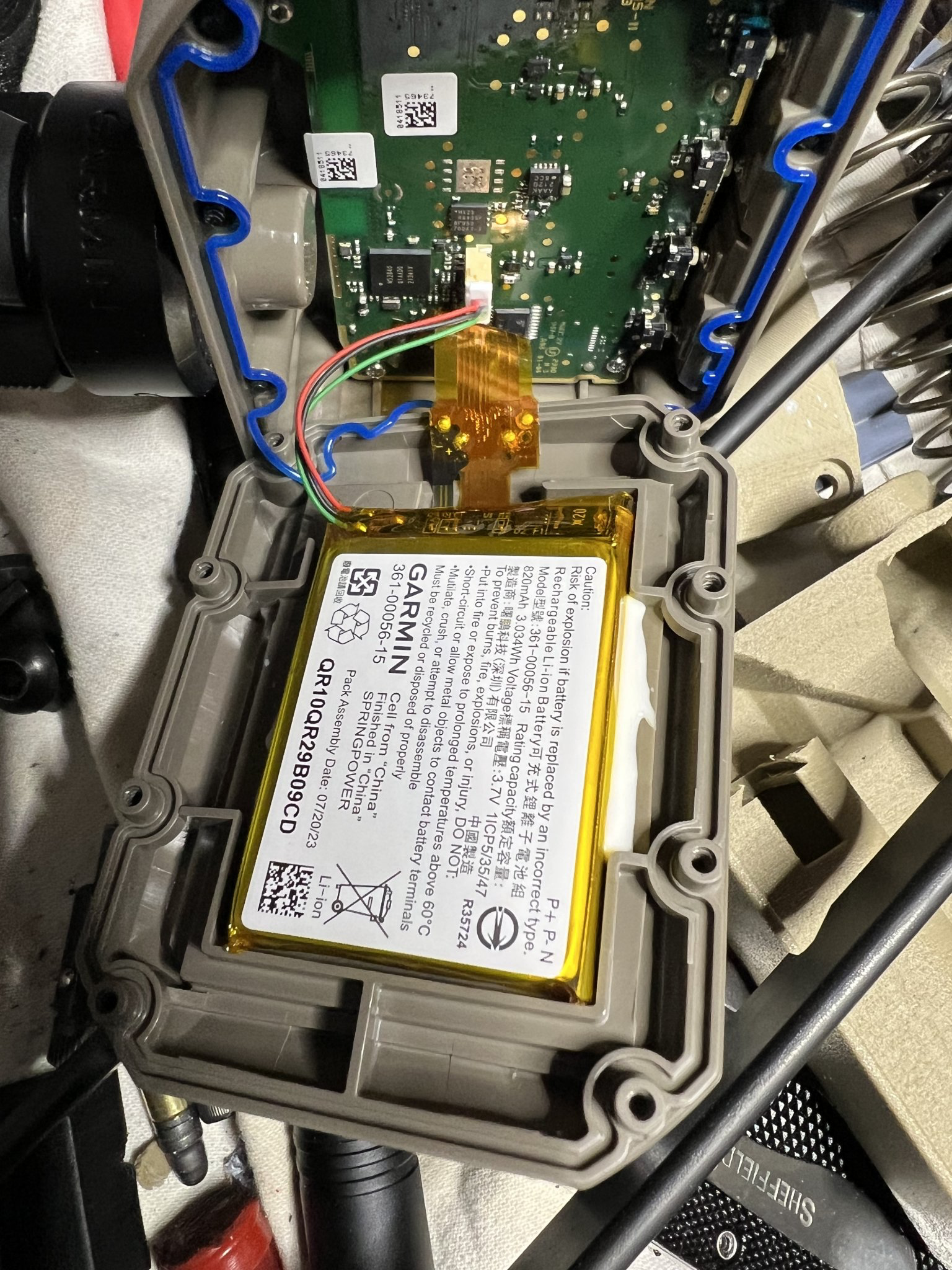

My battery has degraded a bit since new. I can still get a solid four hours but I've resorted to charging it in between range sessions just to make sure it's topped off. It didn't seem to charge to 100% for a bit there either. Haven't checked it lately but I plan on bringing along a battery pack for longer sessions in the future.
I wish they’d have made it with regular batteries vs rechargeable. But of course that’s the future with everything. A battery pack can be had though, but as I stated it lasts enough for how I use it. I mean you shouldn’t be having to use it continuously e every time you go shoot. It’s good for load development and for ballistics calcs.

The internal battery only has a 820 mAh capacity so even the smallest power bank with extended the battery life 500%.
You could even get one of the 18650 battery holder/chargers, the capacity of most 18650 cells is at 2000-3000mAh.
