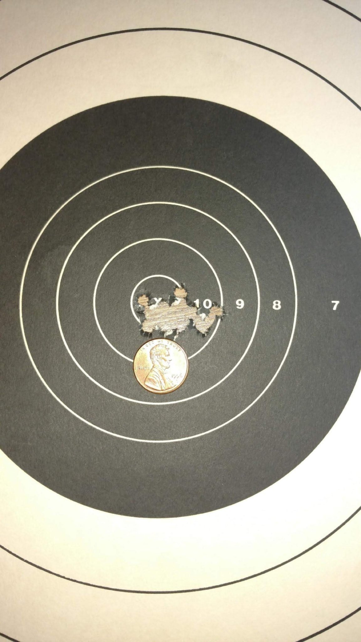

    Thanks for the load. 4moa red dot at 50 and i could cover a 30rd group with my thumb. Going to have to try this is other stuff!
    This load gets about 2750fps out on my 20" service rifle barrels. At that speed it has been super accurate and consistent in my service rifles which see alot of rounds, mild and smooth cycling- definitely not the ragged edge of pressure. I've shot 10shot ~1moa groups off a sling with this load at 100yd reduced target matches.
    Glad it worked out for you!!!
    Here's a good score
