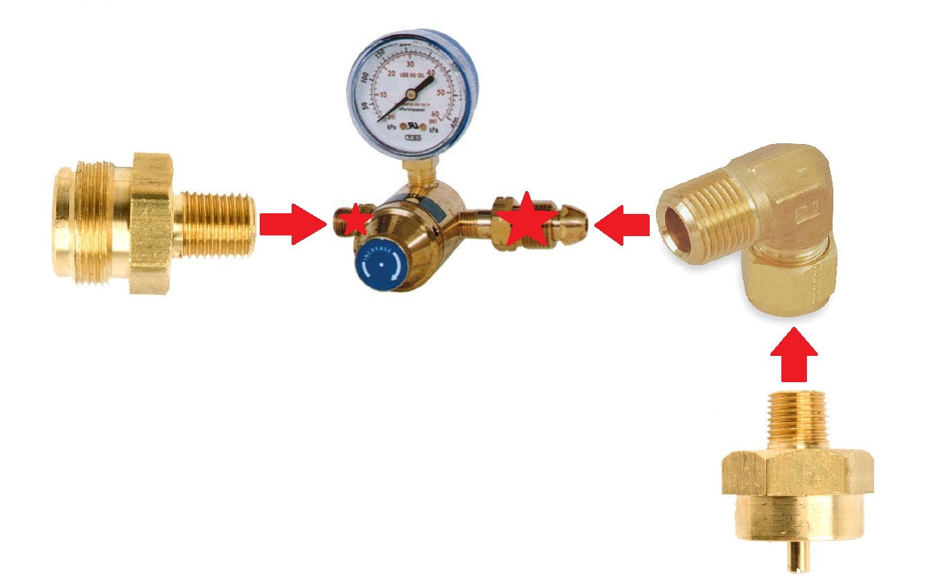

I just wanted to summarize what I read from this thread, and wanted to ask for clarifications in case I misunderstood something:
http://www.snipershide.com/shooting...60-giraud-annealing-machine-observations.html

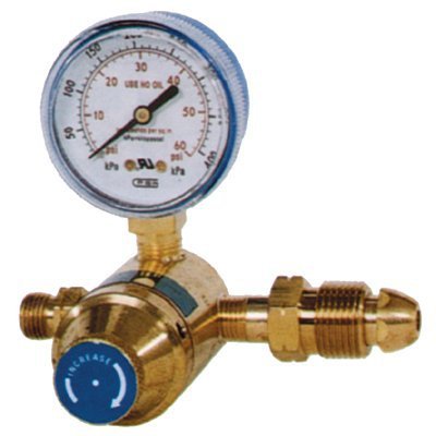

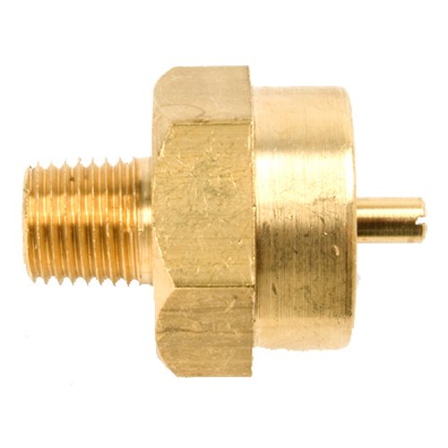

To hook up a Propane Regulator to the smaller Throwaway Propane Tanks one normally gets at Lowe's or The Home Depot, one needs the following:
Propane Regulators - regulator lp cga-510 w/o gauge b hose - Air Compressor Accessories - Amazon.com
Amazon.com - Mr. Heater F273754 1/4" Male Pipe Thread x 1"-20 Female Throwaway Cylinder Thread Fitting - Mr Heater Hose
Amazon.com - Mr. Heater F273755 1/4" Male Pipe Thread x 1"-20 Male Throwaway Cylinder Thread Fitting - Laptop Computer Chargers And Adapters
Is it a straightforward matter of changing the connectors in the following fashion?
I have never dealt with gas fittings before, so I really have no idea.

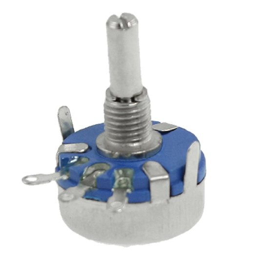

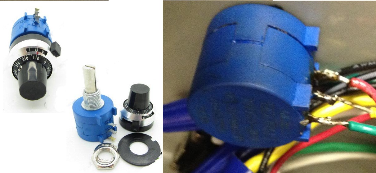

Now, I'm curious if Doug has changed the color of the wires, as I intend to carry out this modification as well...
Amazon.com : 20K Ohm 3590S-2-203L With Turn Counting Dial Rotary Potentiometer Pot 10 Turn : Office Products

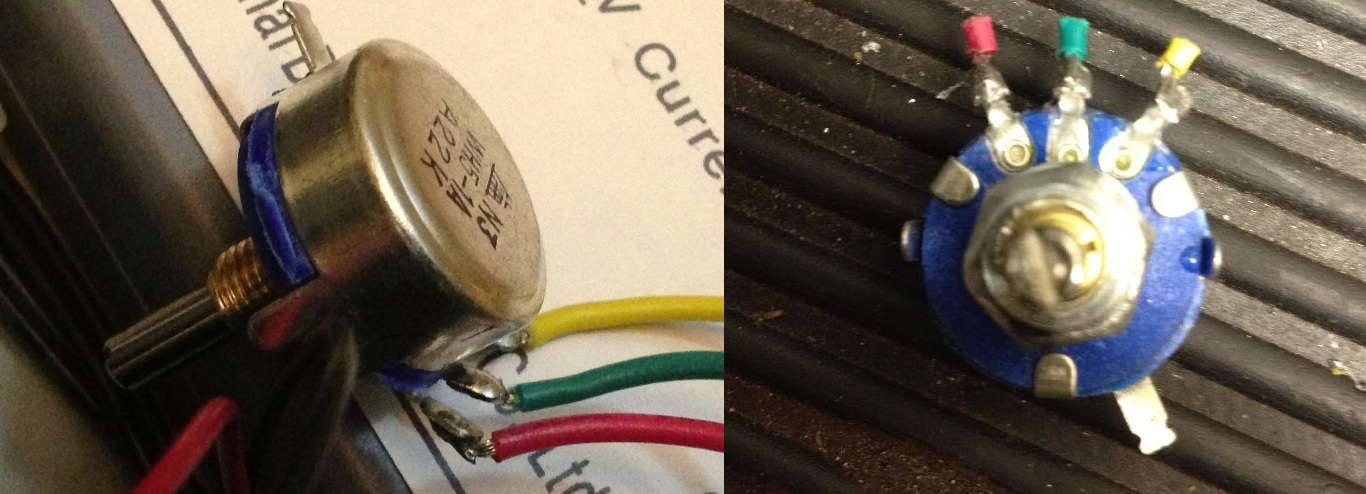

Just take a picture of the colors on your potentiometer and post it and I'll tell you which way the wires go.
This is how my potentiometer was wired from the factory.
(1)Yellow
(2)Green
(3)Red
The way a potentiometer works is that there is a wiper arm that moves along a resistance, in this case 20,000 ohms.
In a normal single turn potentiometer the wiper is in the middle.
In this case the wiper is at the rear position of the new potentiometer.
Here is the technical data sheet for the potentiometer including the schematic on page 2.
http://www.bourns.com/pdfs/3590.pdf

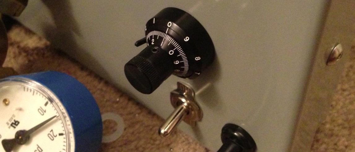

Finally a picture of the finished product.

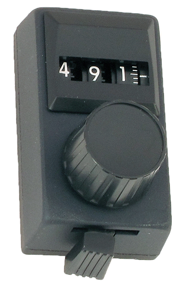

What does the blue dial thing do for the annealer?
The original potentiometer or speed control dial has no fine adjustment with its useful adjustment range being between 5-7.
This does not allow for precise or repeatable settings to be established for a particular cartridge case.
The new potentiometer has 10 complete turns instead of 270 degrees of rotation.
It has a dial which includes a turn counter and each turn is divided into 100 segments so for all intents and purposes you have 1000 repeatable settings with about 300 actually useable settings.
For example in my case I can now set my gas pressure regulator to 15 psi and my speed controller to 595 and I know that my .308 Lapua cases with 0.016 thickness necks will be perfectly annealed every time.
The assumption being that I'm using the same gas every time.
This allows for much quicker setup and much better results.
I am now keeping pressure and speed settings for all my different cartridges in a log book.
This way it only takes seconds to set up. I then check the first cartridge case with Tempilaq then run my batch.

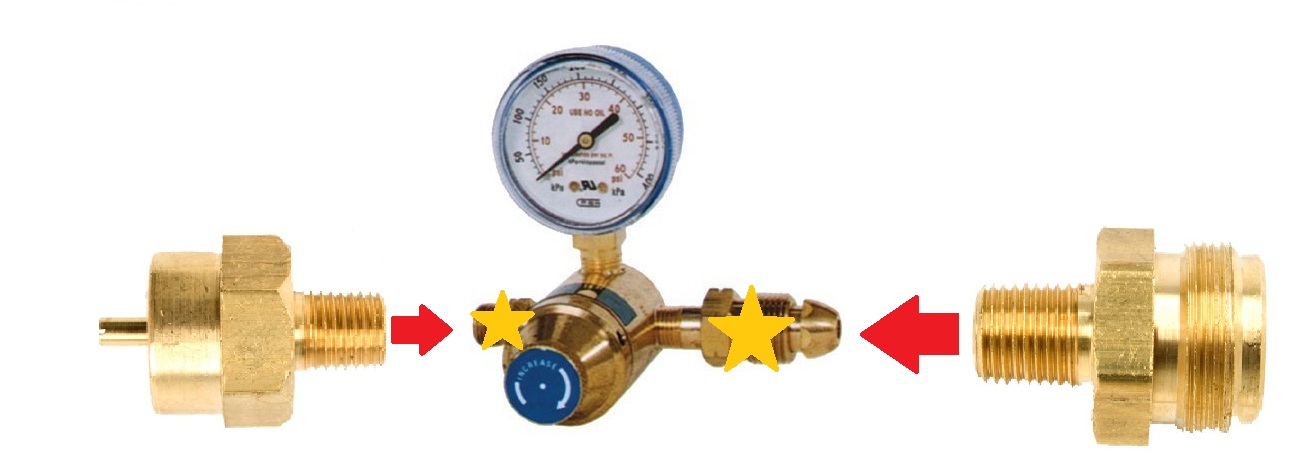

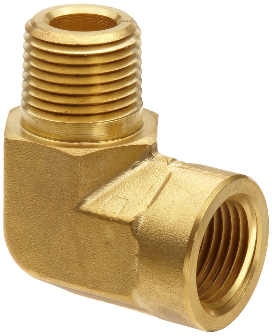

As I mentioned in the other post, you have the 2 fittings reversed.
I also added a male/female 1/4"npt 90 degree elbow at the inlet of the regulator so that the regulator faces right side up when connected to a throwaway bottle.

Thanks! I'll photograph the wires on my potentiometer this evening when I get back from work.
39453d1401583489-giraud-annealing-machine-modifications-giraud-annealer-potentiometer-resized.jpg
Looks like Doug hasn't changed the wire colors.
Hm...
I wonder if there are some other fancier potentiometers in this size range that'll fit.

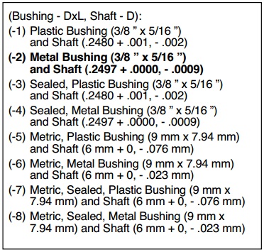

39455d1401586149-giraud-annealing-machine-modifications-potentiometer-bushing-size.jpg
@Thump_rrr
Did you have to enlarge the hole for the potentiometer to fit?
My annealer has a 0.24" diameter hole for the potentiometer bushing.
If I'm reading the Data Sheet correctly, that potentiometer you suggested has a 3/8" or 0.375" bushing.

If your looking for a high quality potentiometer take a look here.
If you don't see your exact model they will make it for you.
Precision Electronics Corporation: Potentiometers
Unfortunately these are all 300 degree potentiometers.
They do not seem to have any 3600 degree potentiometers listed.
No matter how good a potentiometer they may be they are going to have the same coarse adjustment the original potentiometer had.
It is by spreading the 20,000 ohm resistance out over 10 rotations that we are able to get very fine adjustment.
You can go spend $40.00 for the exact same potentiometer and knob at McMaster-Carr if it makes you feel any better.
I have these parts inbound.
The first one's a Bourns 3549 10 - Turn Potentiometer (20k), and the other one's an antique Beckman 10 - Turn Counter...
I decided to get them just for kicks.

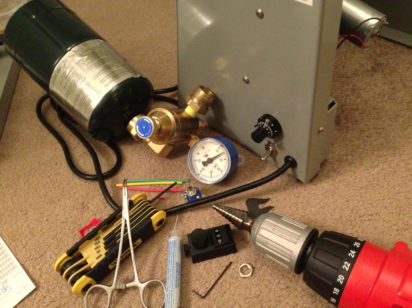

Progress report!
We had some fun this evening!
I had to use my backup Turn Counter... I had fitment issues with the original candidate.

I'm no expert (believe me), but my take on this is that from, say, 10%-80% full, the tank pressure won't change as long as the temperature stays constant.
Propane, contained in a tank, at moderate room temperature remains liquid at around 110-140 psi. I believe the often stated observation that the pressure drops as the tank depletes is due to the drop in tank temperature as the gas is used due to decompression.
A couple of thoughts about this - Developing more efficient burners, so reducing gas use/waste will result in lower temperature drop. The current commonly used burners appear to use only a small percentage of the available energy to actually heat the case, most blows by and is wasted.
A two burner set-up will result in more temperature/pressure drop.
MAP gas burns at a higher temperature, should use less gas.
Keeping the gas cylinder at a constant temperature will help, Maybe "cooling" fins round the cylinder would absorb ambient heat and keep the pressure stable.
Gentle heat, something like a heated seed tray might be enough to stabilize the temp/pressure.
I think an efficient burner could use about 1 oz of propane an hour - say 12 hours or more from a small 1lb cylinder. say 400 cases an hour or 4-5,000 cases. That's a lot of shooting for the average weekend shooting guy. Do you really need a 20lb cylinder if you can sort the temp/pressure issue?
I think we are at about the Ford Model "T" stage when it comes to annealing, we'll look back in a few years and be amazed at how crude it all was back then.
Hi all,
First of all, thanks for posting this info. I have been a little bit disappointed with my Giraud annealer because I have been getting inconsistent results so I started looking around on the web and found this and the other thread. I got all the parts together to add the regulator (and I have the Potentiometer on order) and put it together tonight. The original fittings in the regulator were really hard to get out but with a lot of work I got it done. I put everything together and it seems to look right. I used pipe thread sealant on all of the 1/4" male fittings. Was that necessary? When I got it all together I lit the flame and it is really tiny, even at 60 psi. Is that how it's supposed to be? It's surely less than 1/2" long. I'm not sure it would even stay lit at 30 psi. I had the valve on the torch head all the way open and the flame is still really weak. What did I do wrong? Thanks again for posting the info. I'm a frequent lurker here and really enjoy the site even though I don't post much. Thanks in advance for your reply.
J
Could any tell me it the screen on the input side of the regulator could restrict the propane to flow ? With my regulator connected as above I can't get any gas to the tourch but if I connect the tank without the regulator I works fine.
