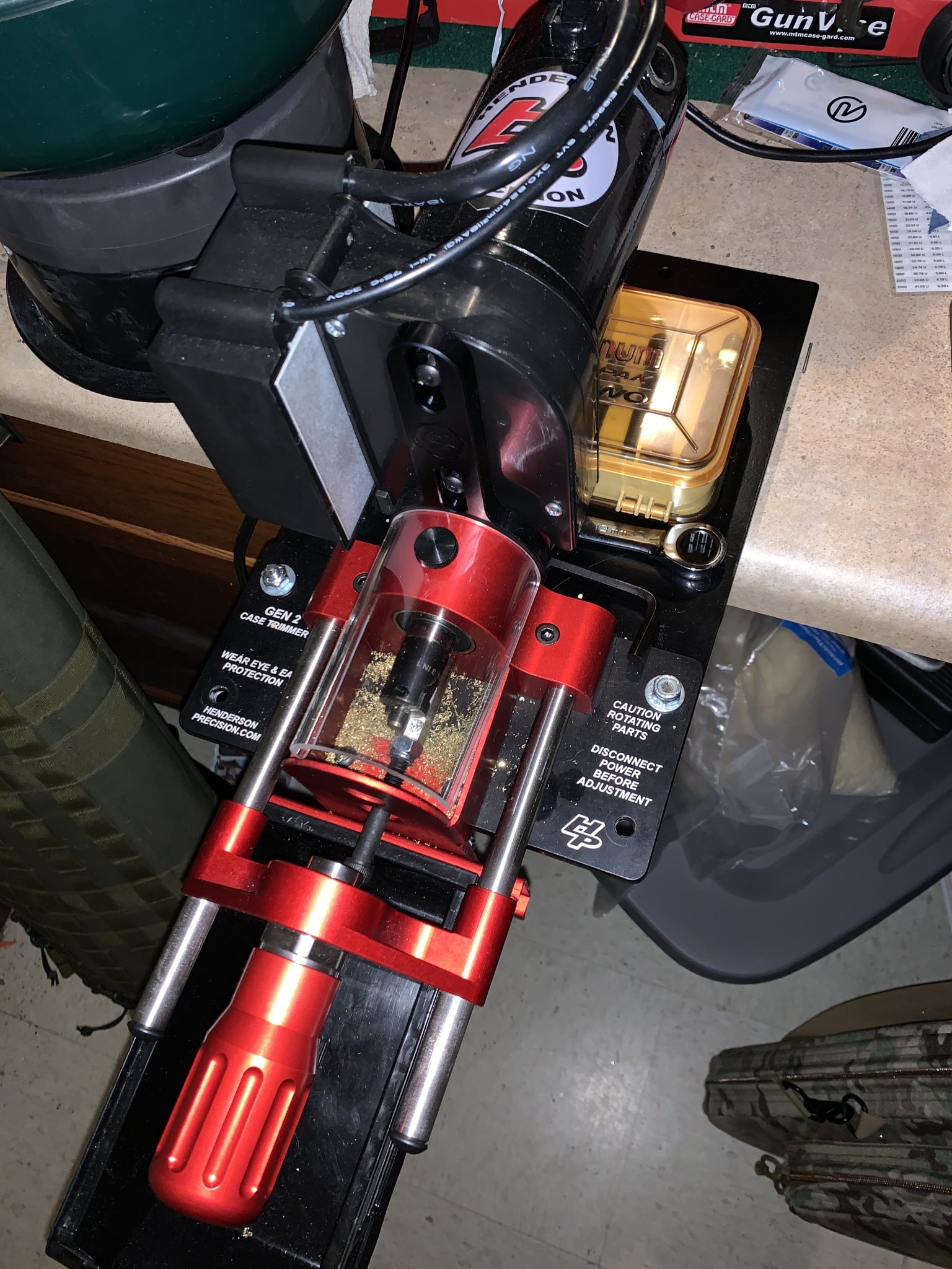

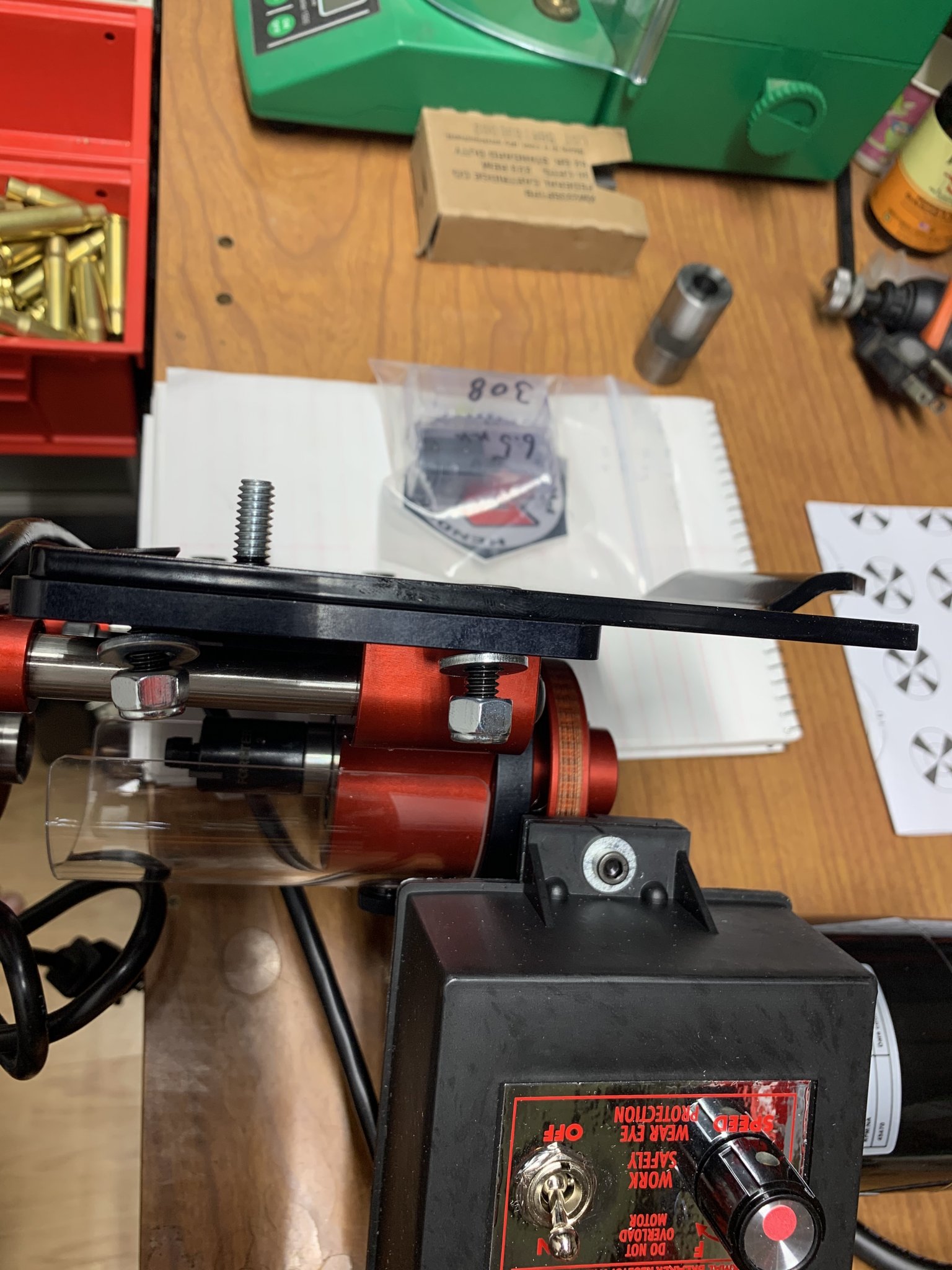

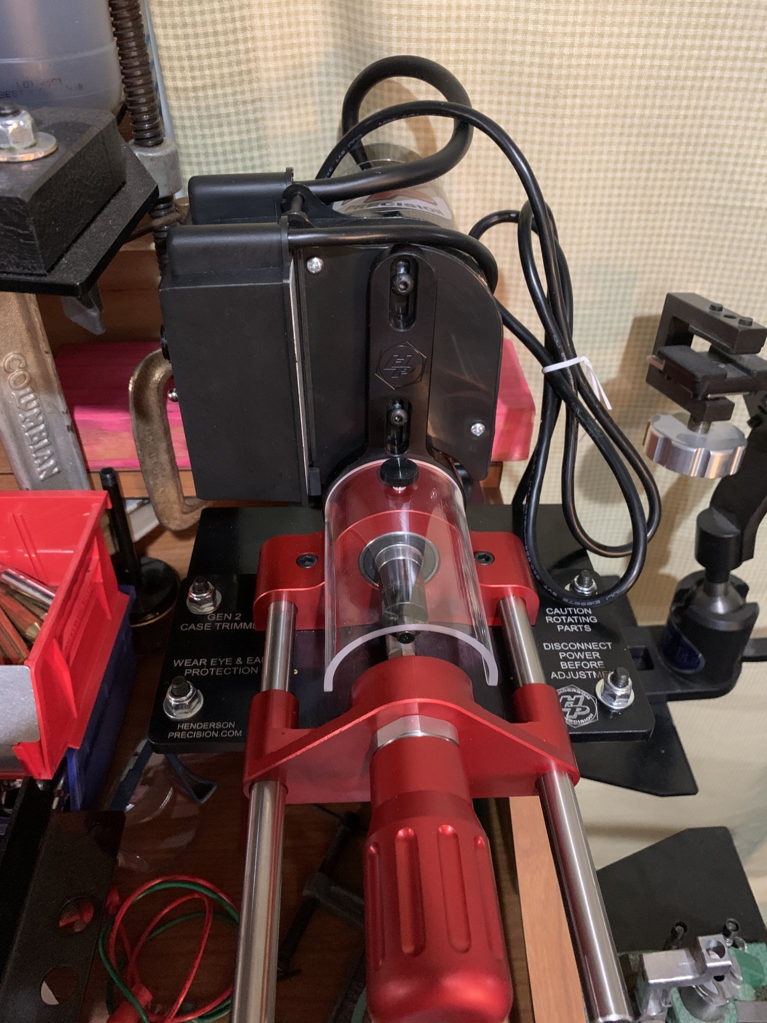

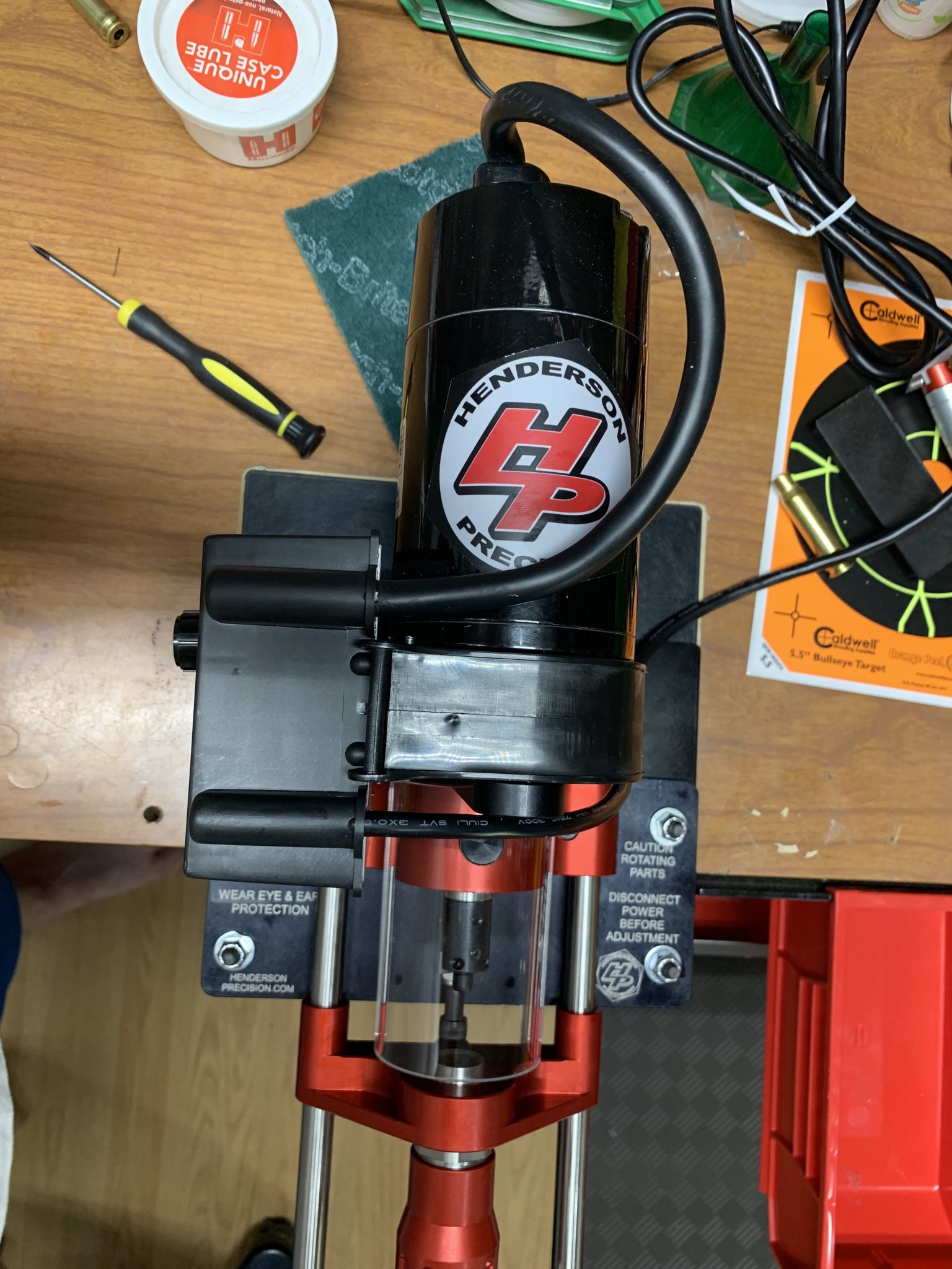

Can you share a picture of how you've got that setup with the Inline plate/mount?
IMG_0622.jpgIMG_0623.jpgIMG_0624.jpg61931636000__CDA08F9B-8159-4FF0-B8B3-2DDE0F1ED4F6.JPG
The last picture it is sitting in its storage spot on a storage dock. Because of the motor, you will need the dock 6-8 inches off the wall for clearance. I have a small shelf on the back of my bench, so I just screwed the dock to a 2x4 and then secured it to the shelf.
