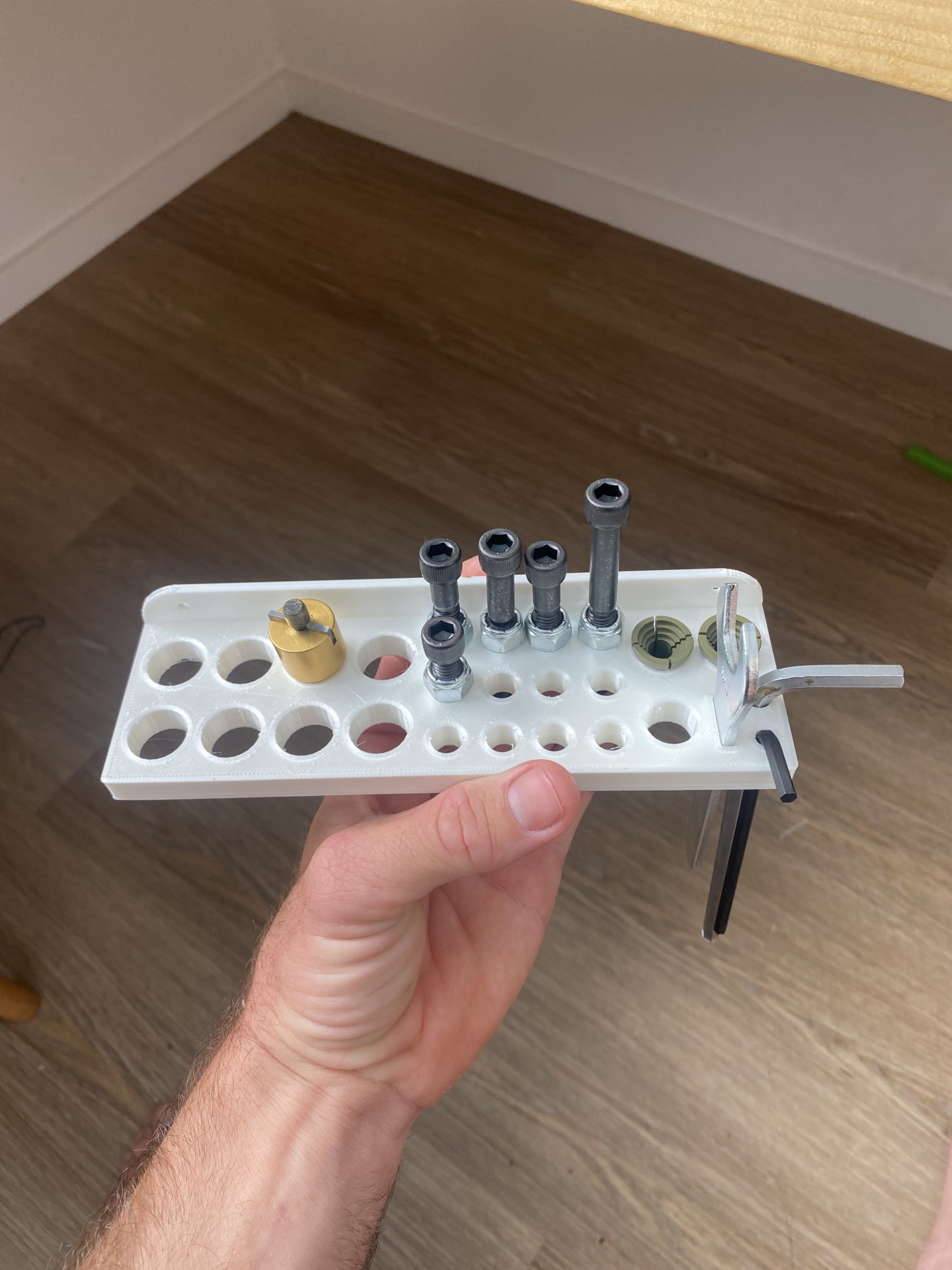

Got mine a couple of weeks back, and have been loving it. Ive done a quick prototype of an organizer for anyone with a 3d printer. Ill finish tinkering with it and slap the STL up on thingiverse if anyone wants one.
I know one of the lads on here sells a similar thing - but mine is much more rudimentary in design… but also free 😁
Reactions: iceng and Conqueror
