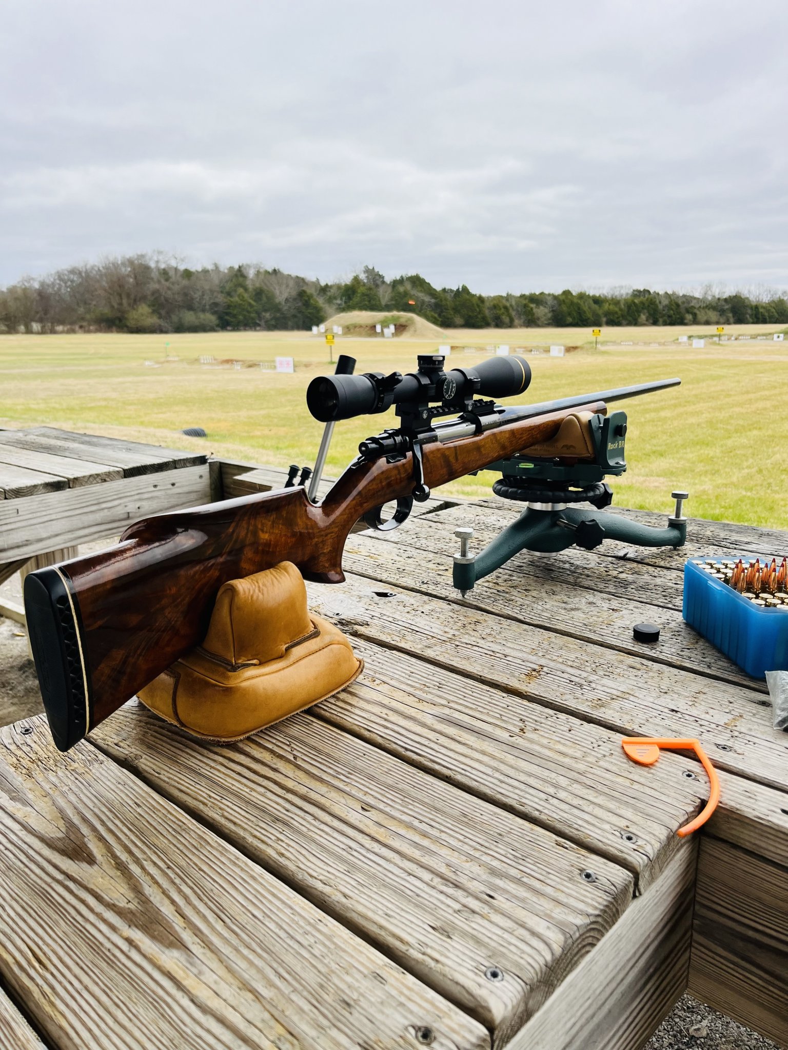

Here’s my dad’s Interarms Mark X 1:10 twist 30-06 with custom stock. He got it from a TX gun builder in late 70s.
Shoots sub MOA groups with 178 grain ELD-X Handloads but…when it starts to get hot it opens up. Action is bedded but it’s just this rifle’s personality.
That's a beautiful classic.
That looks like one of the butt pads from back in the 70's.
They were hard but better than those plastic plates. The newer pads are much better and look good.
Big Dave in Fort Worth Texas could fix you up and not mark up the stock.
