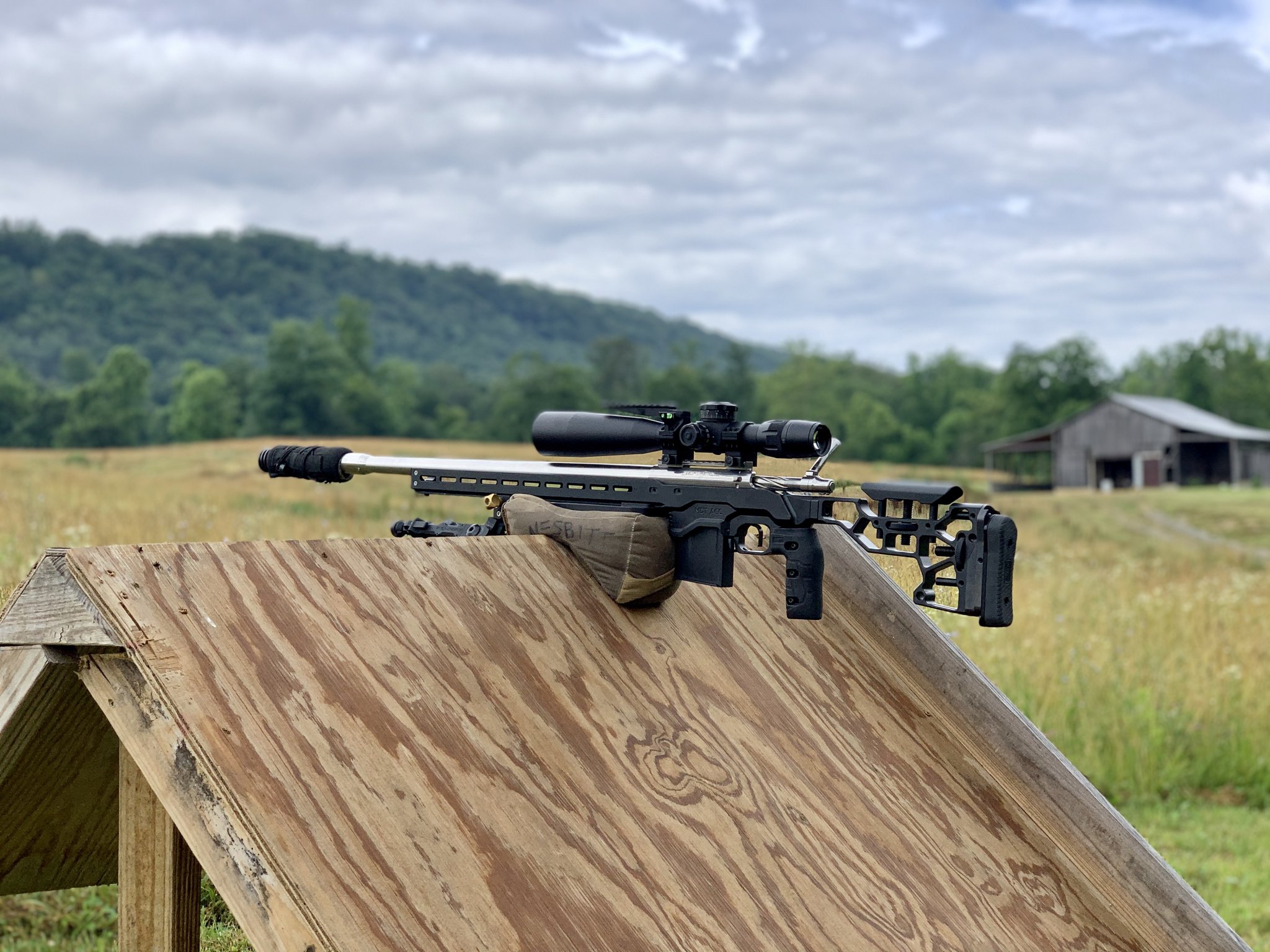

The Kenetic Security Solutions tuner looks pretty interesting. @bohem told me about some experiences with them and left me very interested as I shoot a lot of factory ammo. Being able to be used on any standard threaded barrel without having to have additional machine work is a huge advantage.

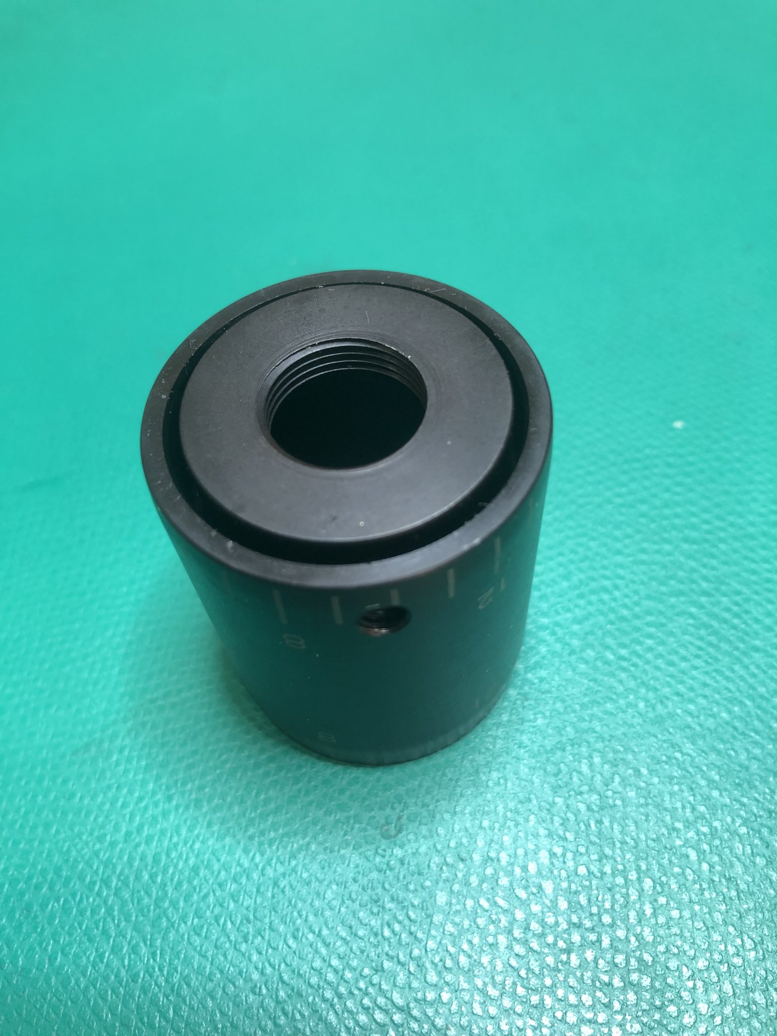

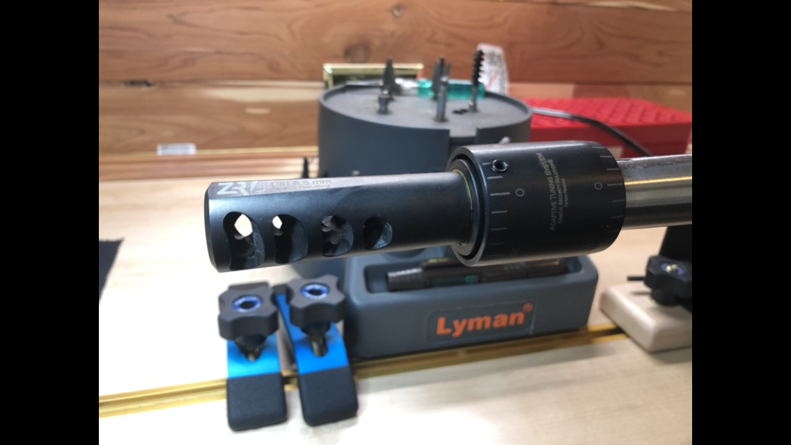

Ordered the Adaptive Tuning System (barrel tuner) a week ago, it arrived yesterday, and got it mounted on my MPA rifle in about 30 minutes.
Standard (edit) version 1 MPA DN3 self timing brake is a no-go, not enough thread left over (lock nut is too long). Swapped it out for the ZRO CIB 6.5 brake which uses shims, and that was a very good fit. [Mr. Aaron Hipp was helpful and responsive, and indicated they are working on additional versions that will work with different brakes and larger diameter barrels.]
Edit: Aaron indicated that the version 2 MPA brake works fine with his tuner. As Rob indicated below, many/most other self timing brakes also work well.
Shot the rifle today at 200, and confirmed that i could get a random non-optimized load to shoot relatively well, around 0.35 to 0.4 MOA, which is typical for an optimized load in this rifle. Zero load development so far, no ladder test yet, just trying to use up old 142 gn SMK bullets that i have been hoarding for 7 years. H4350 and a long 45 thou jump. Influenced by Cal Zant’s article on the topic of bullet jump.
Of course, if you turn the tuner the ‘wrong’ way, it might double your group size, but you keep turning the tuner 2 hash marks at a time, shooting 2 shot groups until POI stabilizes and group size get relatively small and stable (fairly constant group size), then do 3 or 5 shot groups in that ‘good’ range with smaller adjustments.
Rain storm interrupted the fun, but i have to say it seems to work as advertised. Will repeat next weekend and see if group size and POI follows a pattern...
Can confirm: No additional machining is required. Standard 5/8 x 24 threads work as-is. As long as you don’t try to use an incompatible self timing brake, all is well.
Downsides? Not many: Set screw needs to be tightened and loosened every time you adjust and shoot, which slows you down by 15 seconds. You should take care not to over tighten and strip the set screw. And no i did not strip it (yet!), just repeating what the manual advised. They provide a spare set screw. Edit: There are some brakes that will not work, my V1 MPA brake being one of them. Many / most self timing brakes work just fine it seems, see post lower down from Rob.
So in summary: I think Eric’s tuner looks more attractive and is more aesthetically pleasing, and because the barrel is cut to fit the tuner, there is much less of a gap between tuner and barrel. Less chance of the tuner hooking on a barrier. But of course that costs extra money. Gucci solution.
l plan to add a piece of black plastic plumbing pipe to close off the big gap. Red neck solution. 😊

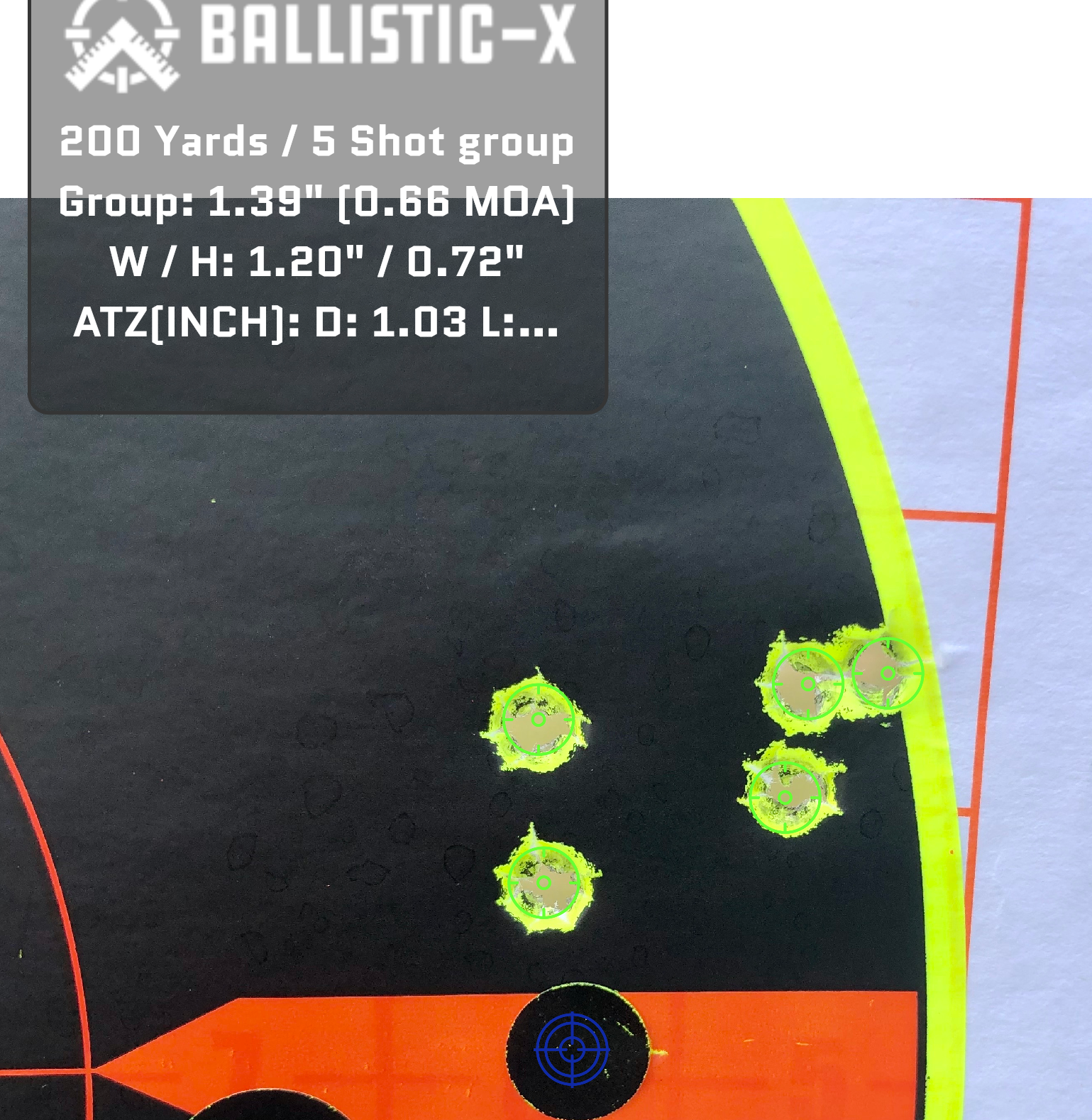

Group got worse when shot the first time at 200 yards, with the tuner installed:
Then turned the tuner, got slightly better:
Then two more hash marks, and it tightened up nicely:
Wind was switching from 7 o’clock to 5 O'clock and i missed the change in wind direction. I like the low vertical spread. Could have been a 0.35 MOA group if i paid attention to the wind, so the horizontal is on me. Three shot cluster on the right is 0.24 MOA according to Ballistic-X.

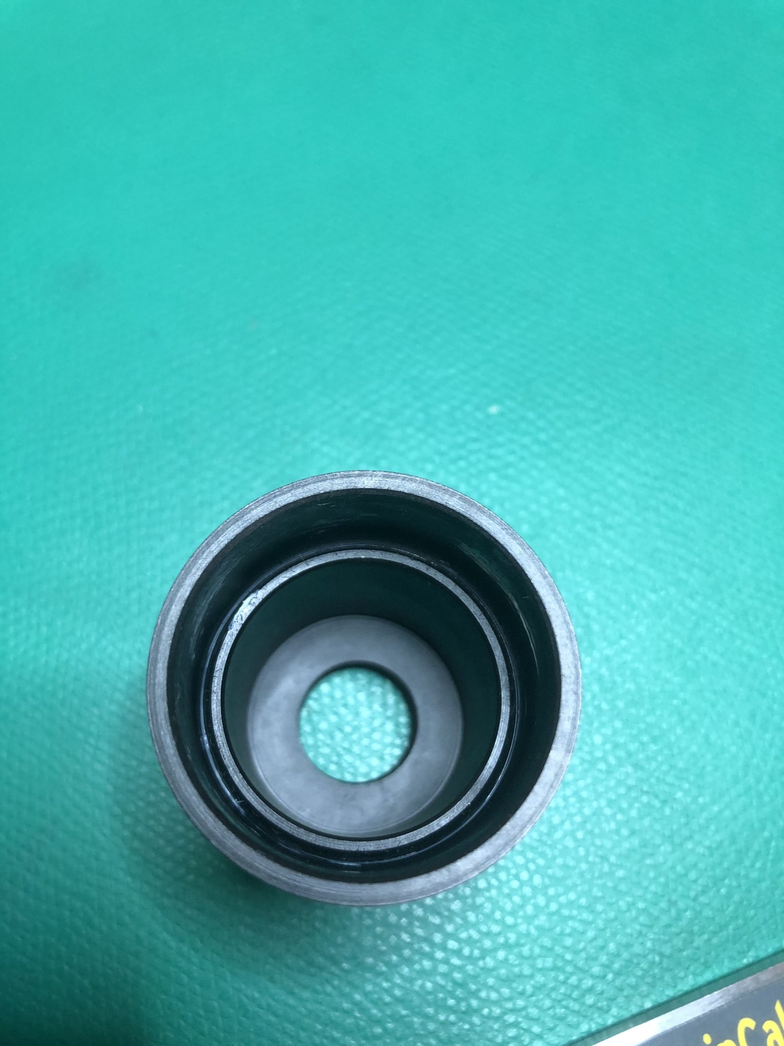

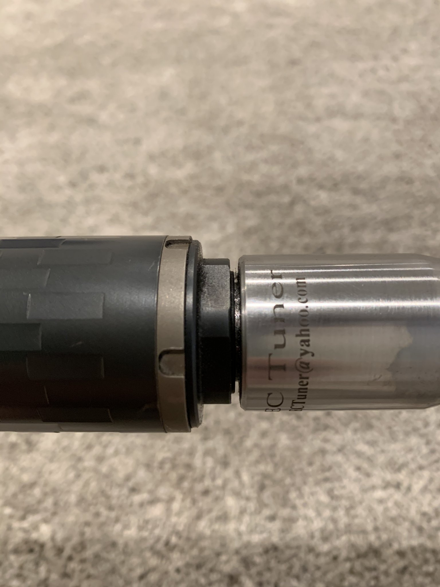

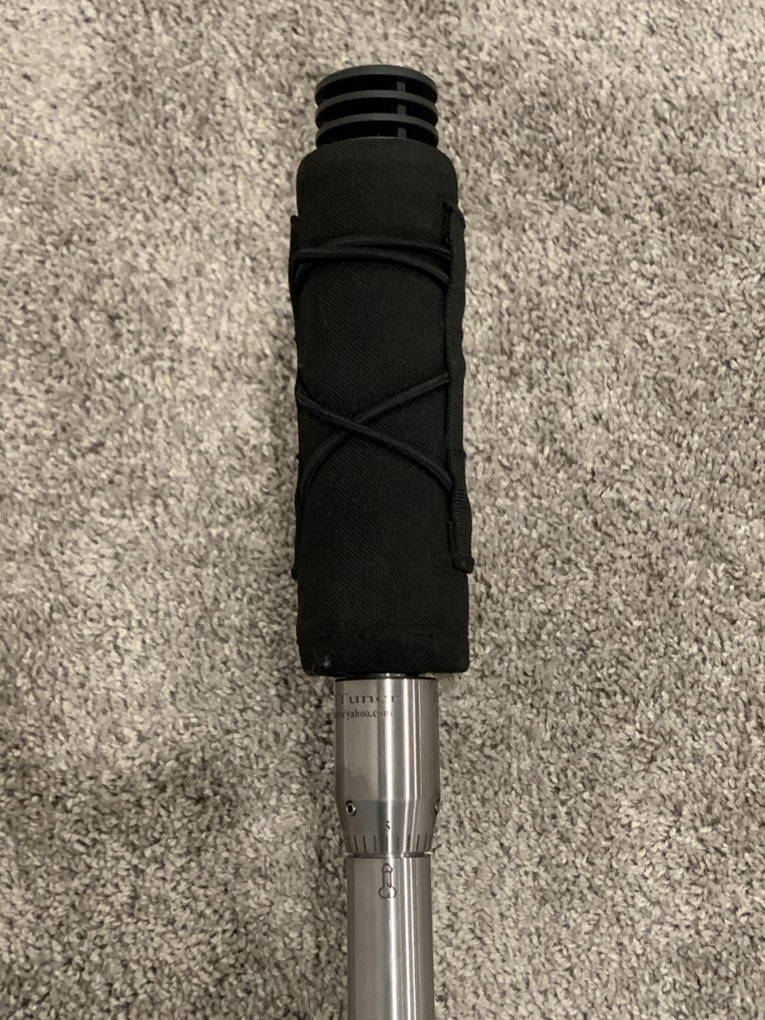

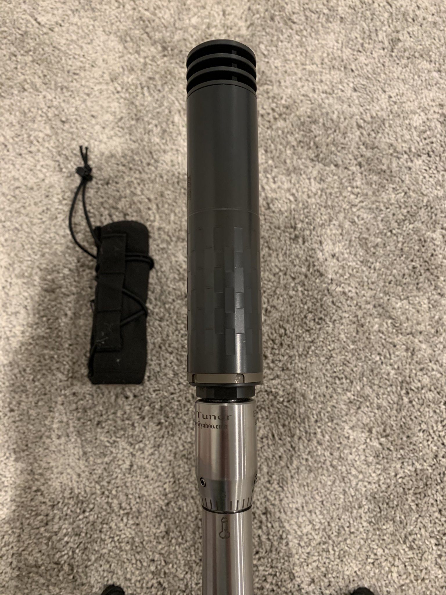

Got the EK tuner installed on my 223. Barrel is a 25” Brux MTU, and I’m using a SiCo Omega w/ Area419 Hellfire adapter. There is a slight gap between the tuner and back of the adapter, but Erik recommends that you leave one.
Installed - mind the indicator mark:

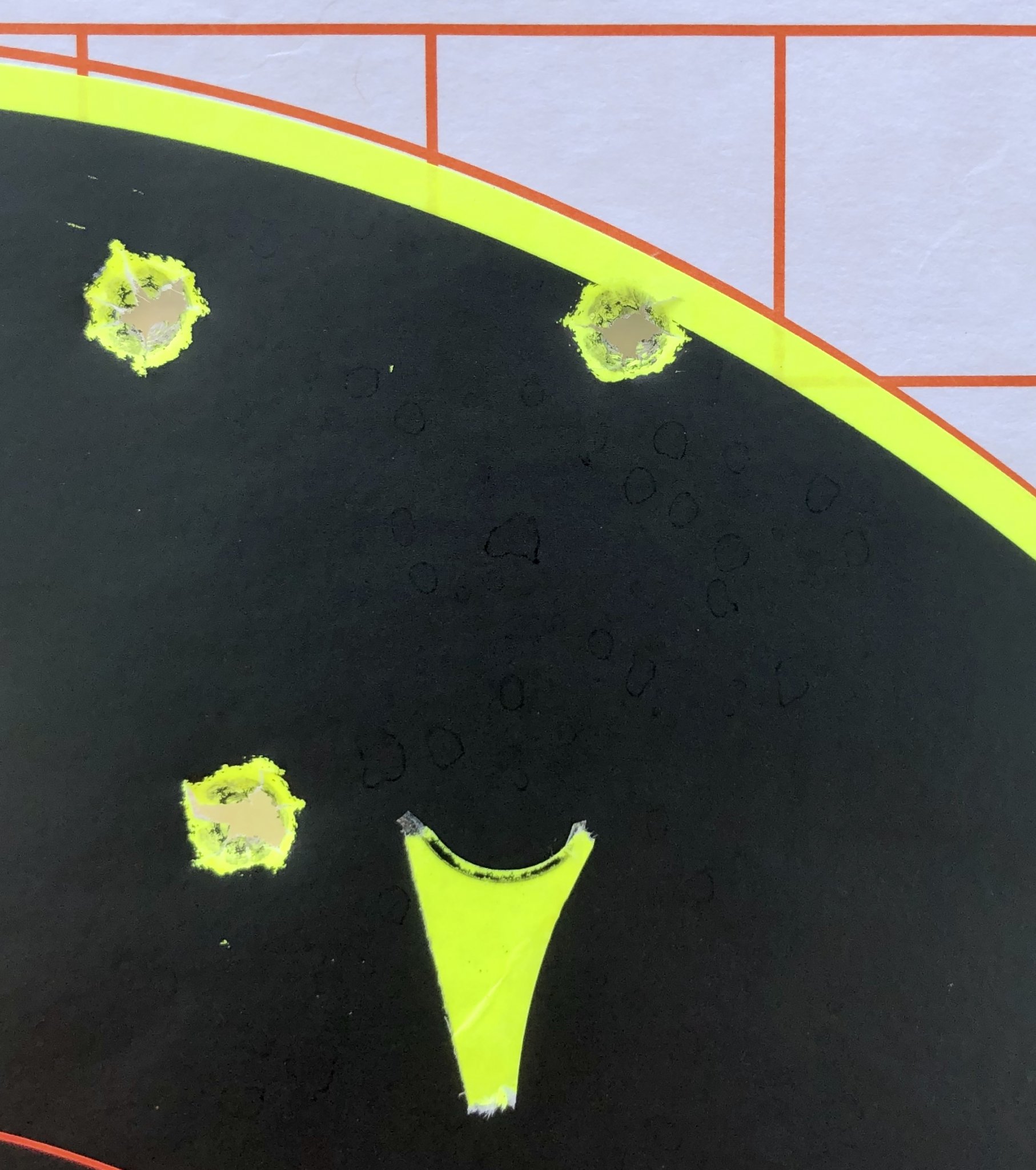

Tested with factory Hornady Black 75gr BTHP for effectiveness sake. Actual load will be with 80gr ELDs. All 3 shot groups at 100 yards. Please excuse the terrible target pics, that’s all I had to shoot at.
Shouldered (0 @ witness):
10-15 @ witness:
Full rev +5 @ witness (with confirmation):
In short, tuner works great.
10-15 @ witness:

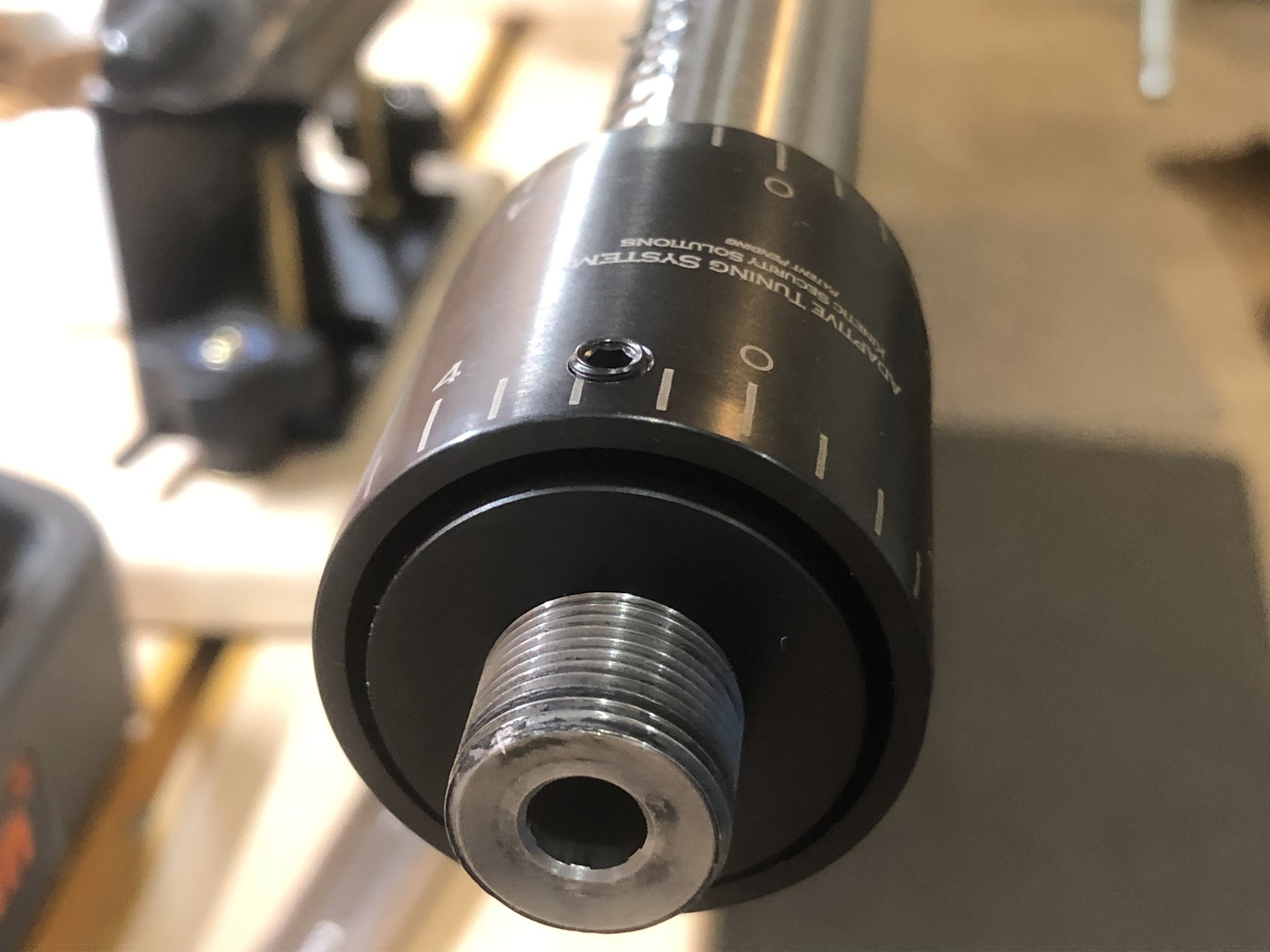

Standard MPA DN3 self timing brake is a no go, not enough thread left over (lock nut is too long). Swapped it out for the ZRO CIB 6.5 brake which uses shims, and that was a very good fit. [Mr. Aaron Hipp was helpful and responsive, and indicated they are working on additional versions that will work with self timing brakes and larger barrels.]
Shot the rifle today at 200, and confirmed that i could get a non-optimized load to shoot relatively well, around 0.35 to 0.4 MOA. Which is typical for an optimized load in this rifle. Zero load development so far, no ladder test yet, just trying to use up old 142 gn SMK bullets that i have been hoarding for 7 years. H4350 and a 45 thou jump. Influenced by Cal Zant’s article on the topic of bullet jump.
Can confirm: No additional machining is required. Standard 5/8 x 24 threads work as is. As long as you don’t try to use a self timing brake, all is well.
Downsides? Not many: Set screw needs to be tightened and loosened every time you adjust and shoot. You should take care not to over tighten and strip the set screw. And no i did not strip it (yet!), just repeating what the manual advised. They provide a spare set screw. Does not work with all brakes.
Group got worse when shot the first time with the tuner installed:
