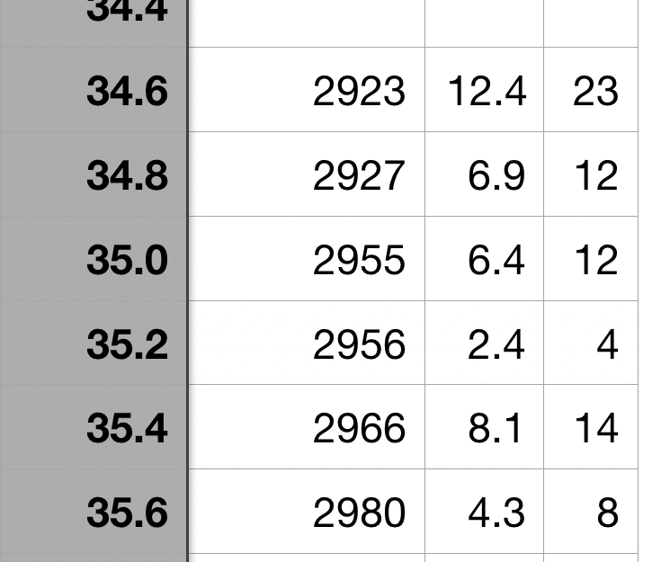

Here’s what I would do (with a barrel that has sped up. So 100-200 rnds on barrel). I’m also assuming you have a primer you want to use, so I’m not including a primer test.
Decide what speed you want to run. Then look up known data and powders for this speed. With so much information online, it’s easy to say “I went to run 2950 with a 109 in my 6x47.” We find that 35.0 varget gets us in the ball park.
So, I’d start at 34.0 and load in increments of .2 grains up to 36.0. Three or five shot strings. Whatever your load process makes you comfortable with. If you are very particular in your brass prep and loading, you can easily get the info you want with 3 or 5 shot strings.
Shoot them all over a chrono, don’t worry with group size. You’re looking for something like this:
Notice the 35.0 and 35.2 have a close velocity, and a low ES?
You can load 35.1 most anytime. Or you can use 35.0 in summer and 35.2 in winter.
Now, let’s say we went with 35.1.
You have two options here since it’s a prs rifle and using a tuner:
1: load .020 off and adjust tuner to the proper settings using three shot groups like Paul did in the video (if first two shots don’t touch, don’t waste a third).
2: Start .005 off lands and shoot groups moving .003 back off each time (again, don’t waste third shot if first two don’t touch). Find your seating depth node and load on the long side. Then use that seating depth and fine tune it with the tuner as normal.
Thats it. Done. That’s your load. 35.1 with either .020 and tuned, or your seating depth and tuned. Should take less than 100rnds to do. (55 for five shot strings over two grains in .2 increments). And easily less than 50 to tune the rifle.
