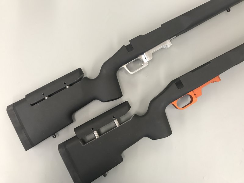

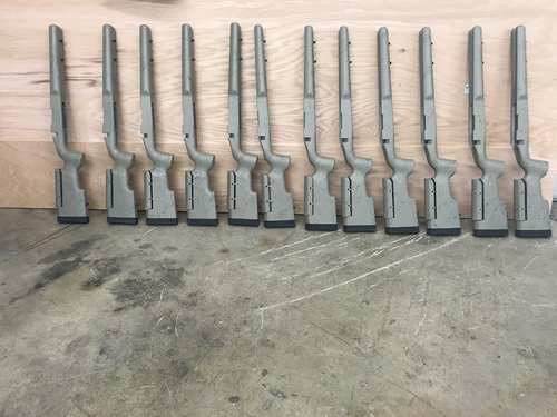

I am waiting ing for a few to come in so I can mess with them. The location of that rear flush cup doesn't seem to be ideal for cutting a riser piece in. The Terrain has the cup "holes" molded into them. If it doesn't work out for the cheek riser, I will fill that hole and relocate the cup a little lower and then refinish the stock.

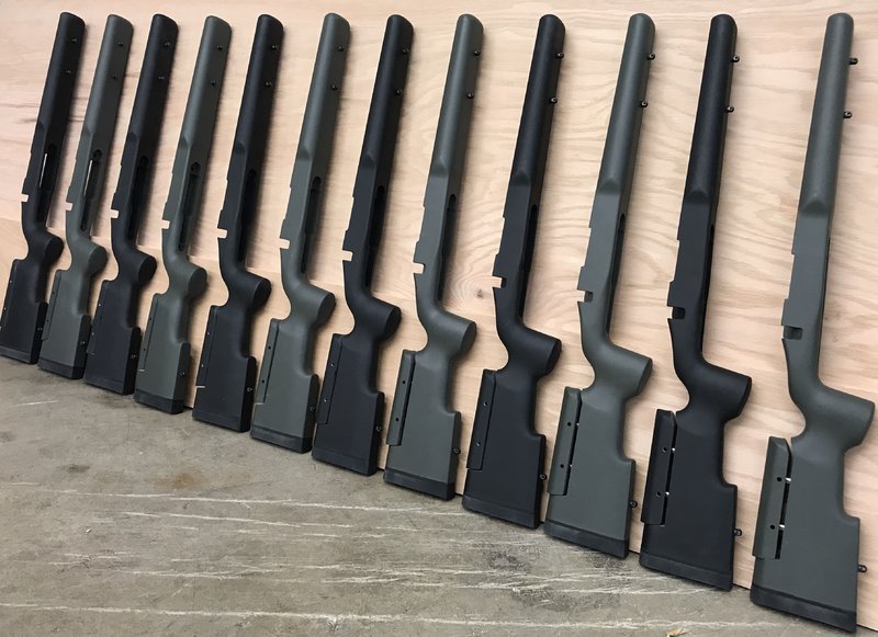

Here are the Renegades I finished yesterday.

Looks like the Terrains do not have the drop at the comb like the HTGs, which is a welcome revision. The comb is much more like a Manners MCST. Should make shooting behind one, especially with larger objective scopes, much more comfortable.

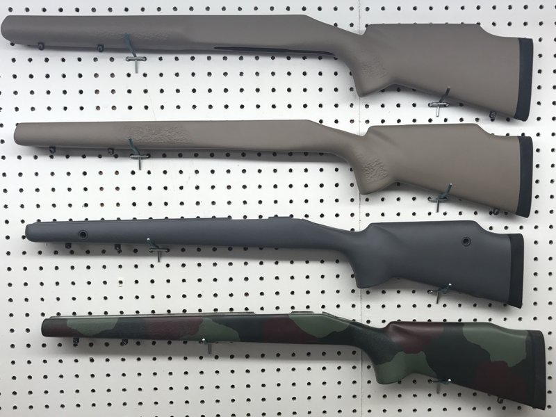

Hopefully this helps a little. From top to bottom, they are:
Manners MCS-T3
Manners MCS-T
Grayboe Terrain
Mcmillan HTG
From a quality standpoint, Grayboe is right there with Manners and McMillan. It is a lot of stock for the money.

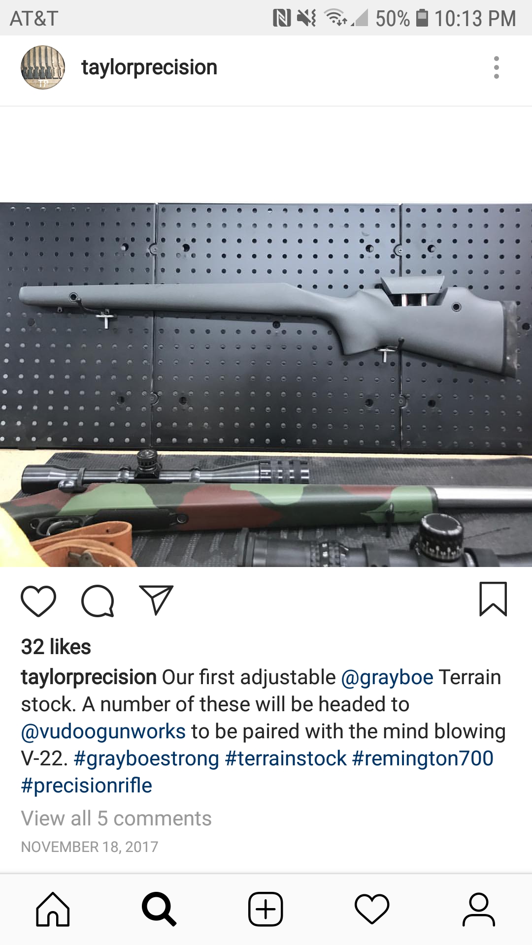

Sent the stock to @ktaylor over a week ago, they’ve had it since Monday 2/11 last week according to my tracking. Multiple attempts to contact and confirm delivery with no response. Hopefully they’re just busy. Mostly just wanted to make sure the stock arrived in good condition and wasn’t damaged in shipping. I was told it would take 2-3 weeks to complete the stock. If I hear anything I’ll report back.

Just as an update I still haven’t received my stock. Although I was able to receive a response from Taylor Precision on Wednesday 2/27 regarding my stock after two weeks of nothing, I have since not been able to reach him for an update. On Wednesday he had told me my Terrain was on the schedule to be cut that day for the cheek riser. I’d asked him to keep me updated. No word yet from him on when it might ship or if the cheek riser was cut.
Also, another one of his customers reached out to me with similar (albeit worse) issues with communication. He bought and paid for a complete Renegade stock from Taylor with his cheek riser set up, in January. He still has not received the stock, nor has he been able to get in contact with anyone from Taylor Precision.
I’m not trying to disrespect the guy or his business, but people need to know these issues before making a decision to use his services. I don’t care what the “norm” is in the gun industry, leaving your customers hanging for weeks and even months is unacceptable. Especially when you’ve already taken their money, in the other gentleman’s case.
