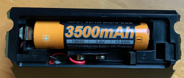

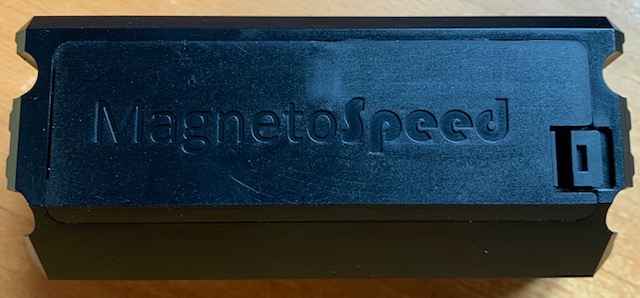

    I was at the range Sat. to try out a new to me V3 magneto speed. Bought in the PX here. Battery was dead, put in spare 9v and it lasted 10 min. F%$k!!
    Now the spare may not have been that fresh, but still 9v's suck and CR123 are expensive.
    Disassembled it and milled it with a ball mill .025 per side, .025 deeper, & .025 out of lid.

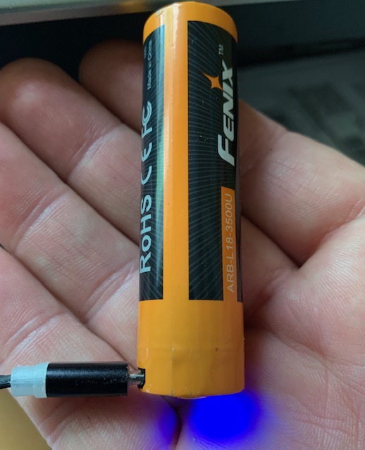

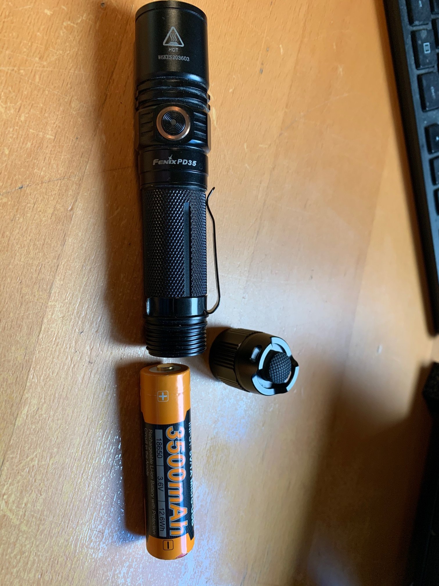

    18650 rechargeable Li-ion is the way to go. It'd be great if Magnetospeed would rethink their choice of batteries for these. It makes no sense to stack 2 x CR123's. If you have that much room, then go single 18650.
    I'll never have a dead battery again. If it does die I can just plug it in my car. Plus I run the same in my flashlights.
    These rechargeable 18650's are great and like $23 with free shipping from Fenix or Nitecore.

    Good point and I didn't fully explain my thought process on this hack. I will disagree on one thing though. CR123 are 3.0V so 6.0V for the series.
    Per the Magneto manual, it will operate normally down to 3.4V, Doesn't say what cut off is.
    The 3500mah Fenix and all my other 18650's charge to 4.2V, I charge them when they get down below 3.6 & that is about 60% charge.
    Since mah does not double with cr 123 in series you've got 1400mah available on a fresh set. 40% of 3500 is still 1400 with room to go before reaching 3.4V.
    I like having the option to plug a single battery into my car for a couple minutes to get back up and running.
    I thought about running 2 x Fenix mini USB rechargeable 16340's in series. They will fit without modification.........but = 7.2V vs 6V for the CR 123's. Didn't want to risk over voltage on the Magnetospeed when set for CR 123's
    It would be an easier drop in option but we'd need Magnetospeed to confirm 7.2V is GTG for the CR123 setting????
    Reactions: TACC

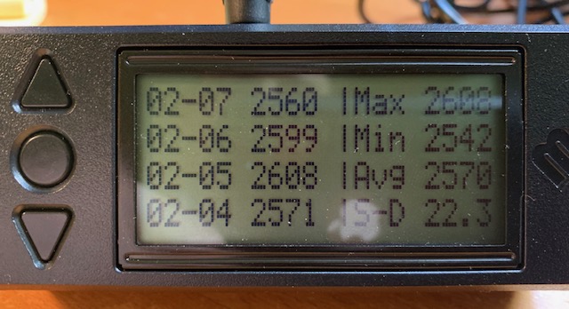

    So just as a follow up I ran one of these 18650's from a full charge 4.215V down to 20% in another device that has good battery monitoring info. At 20% charge it still had 3.1V popped it in Magnetospeed and it still worked albeit with a low batt warning.
    3500mah x 60% (should still be above 3.4V) = 2100mah available or 50% more then a good set of CR123's @ 1400mah.
