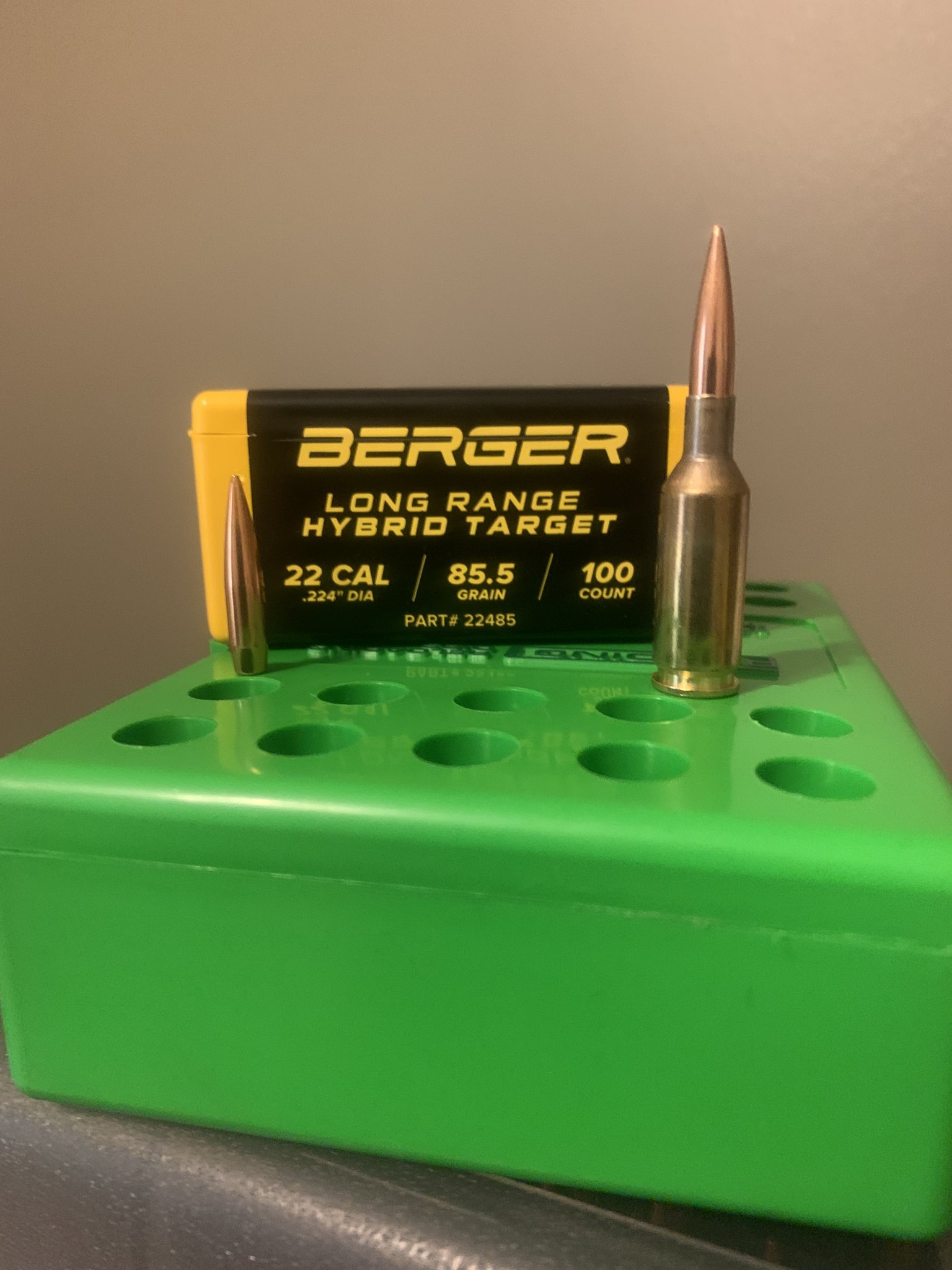

Has anybody tried the new Berger 85.5 .224 Hybrids?

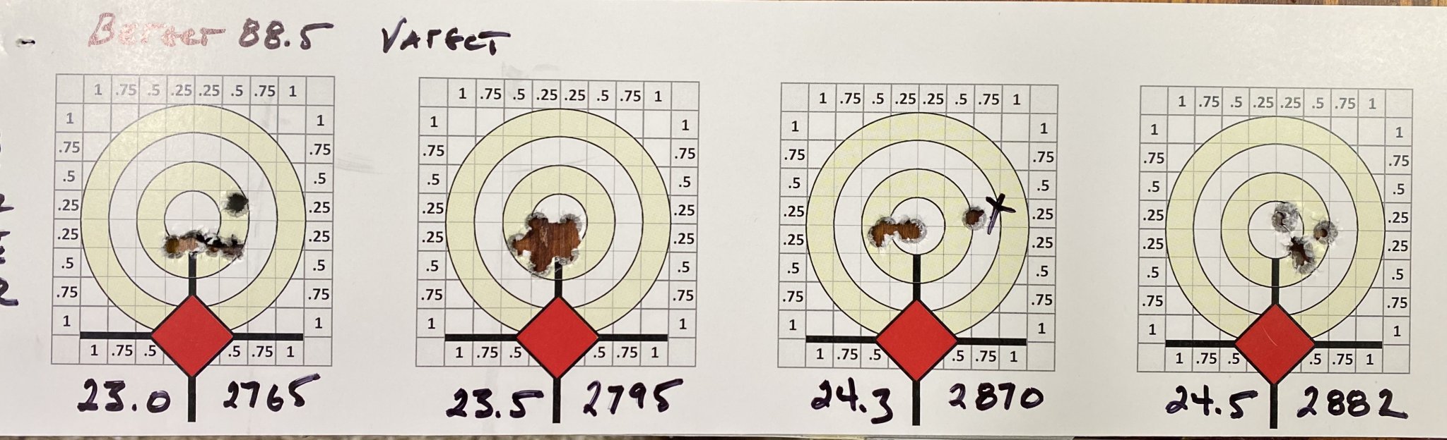

Headed to the range with 223 loaded with 85.5 Varget 24.5 set to .010 off lands. 22.5" barrel and Ultra 9 30 cal. Will post results
Not bad very windy. 2826 FPS for the most part. Groups? You tell me. 100 yards

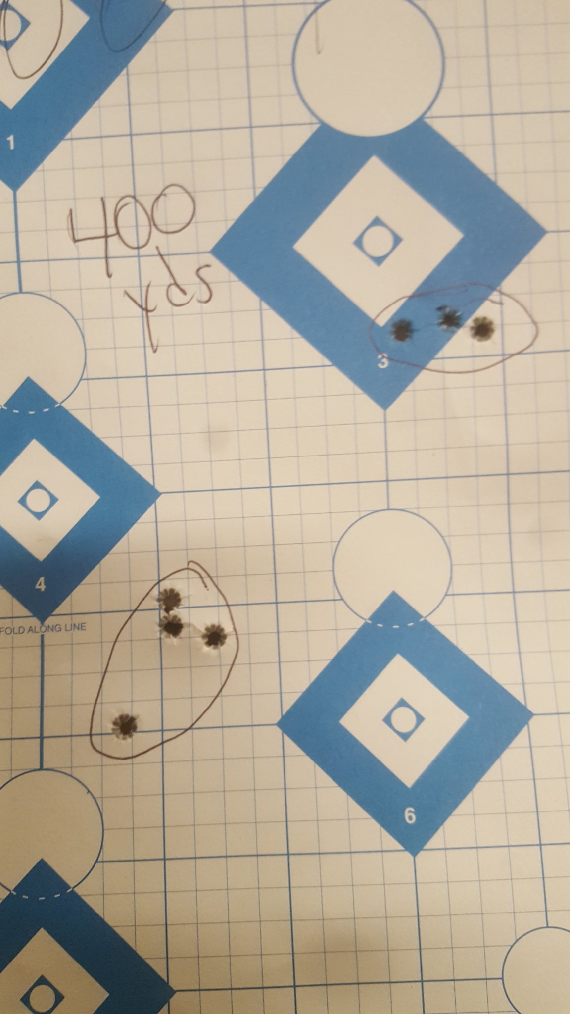

Tried cfe223 and varget today in my 223. Very promising.
Rem 700
7 twist Bartlien 24in
.092 fb reamer
Lapua brass
Cci450
I'm going to load up some to try at distance of the 25gr varget and the two highest charges of cfe. Had zero signs of pressure on any of these loads. Might try going higher.
The 26.4 of cfe223
is probably the load to use. I was shooting into the sun this evening and the group may have been me.

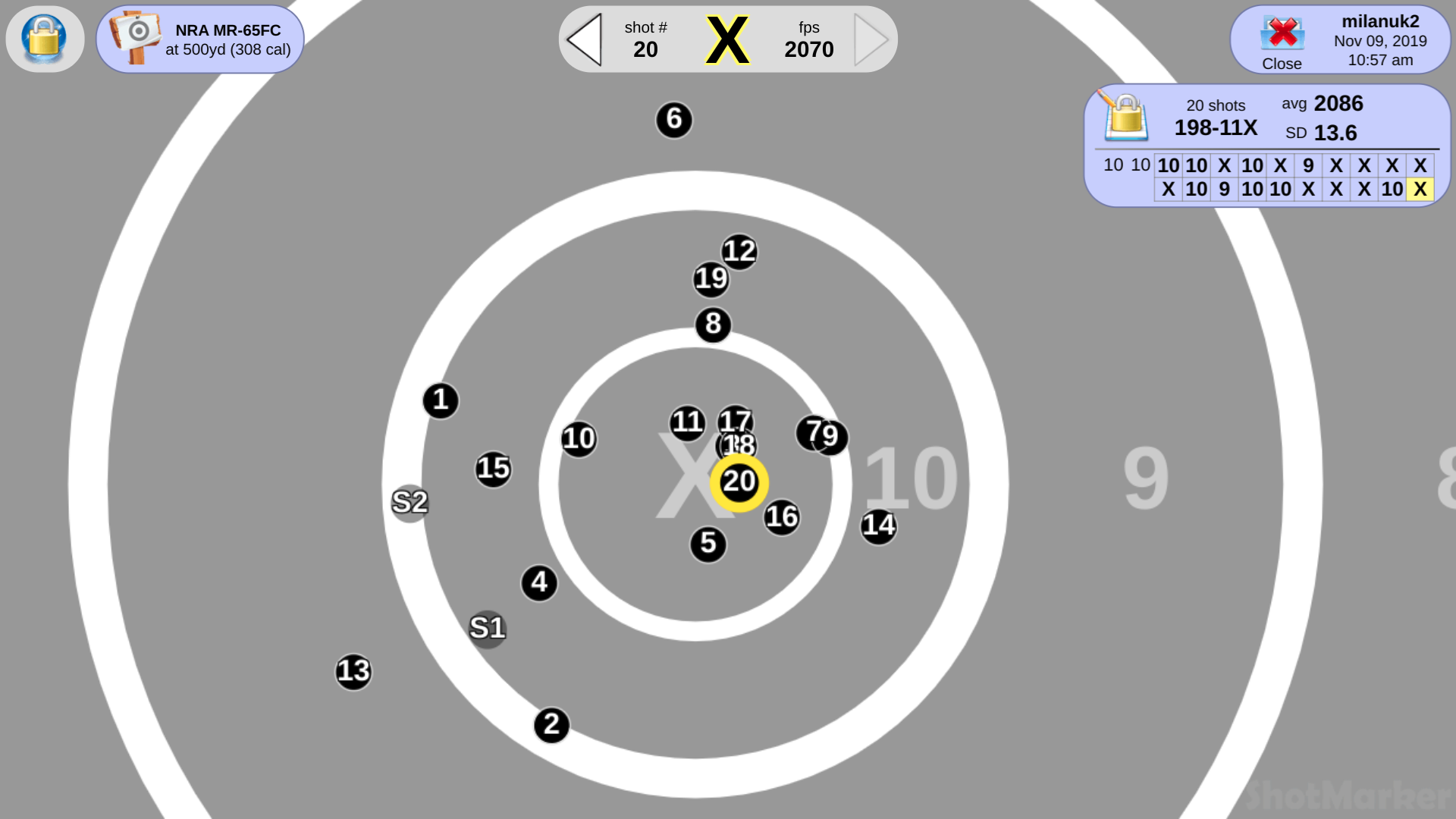

Well, got a couple MR matches under my belt with this combination.
The short version... it shoots. At least as well as I can hold, probably better. It'll probably take a better shooter than I to really wring this out properly.
Unfortunately, my 'history' with the .223 Rem in FTR is that it seems to 'punish' me for gun handling that I would otherwise 'get away with' using a .308 Win. So a lot of the 'stray' shots are all me, for one reason or another.

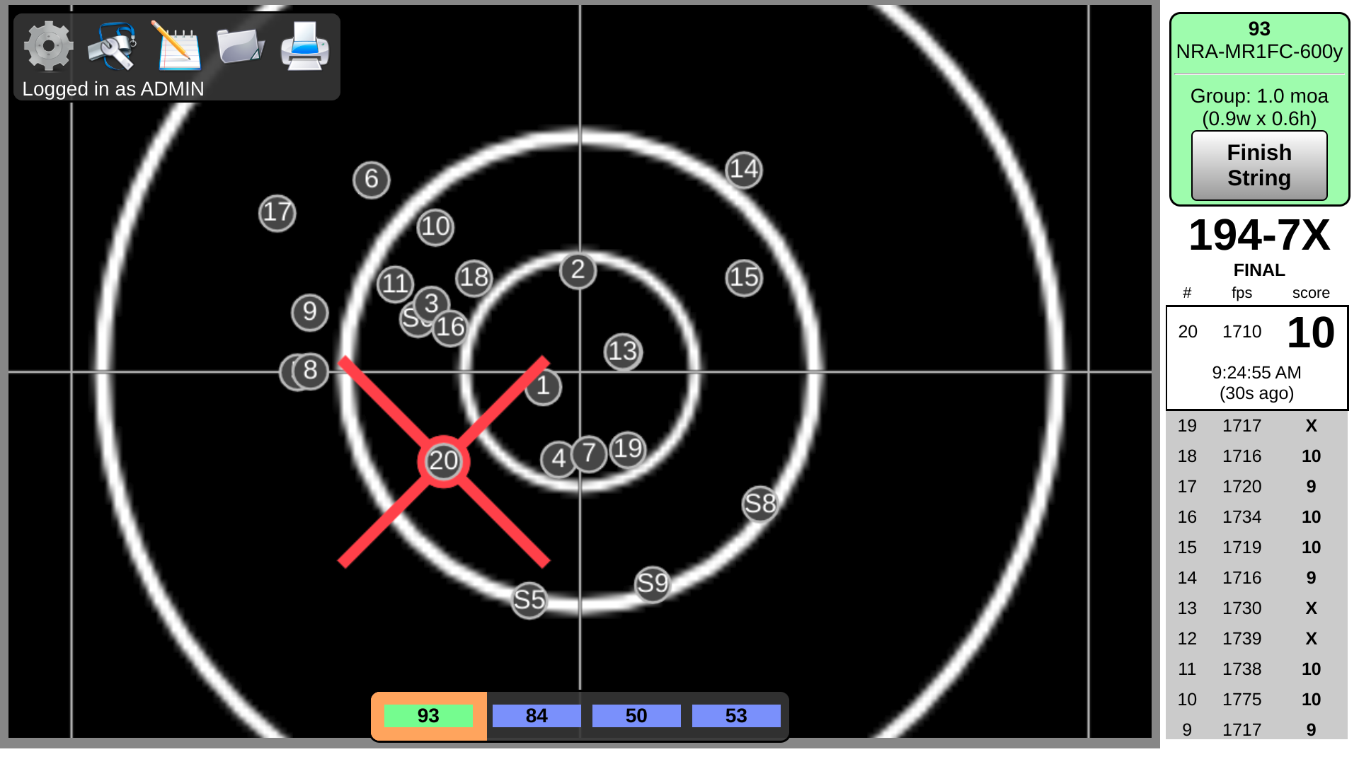

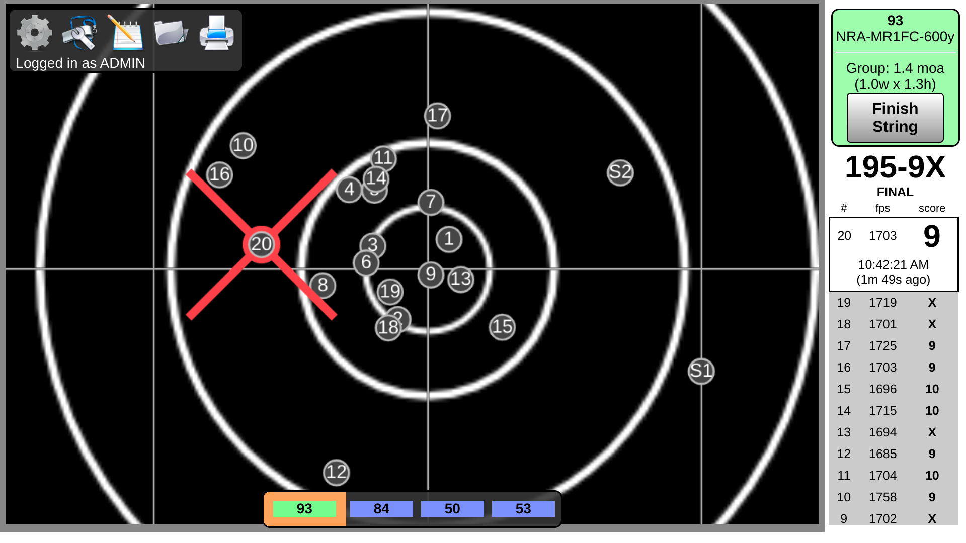

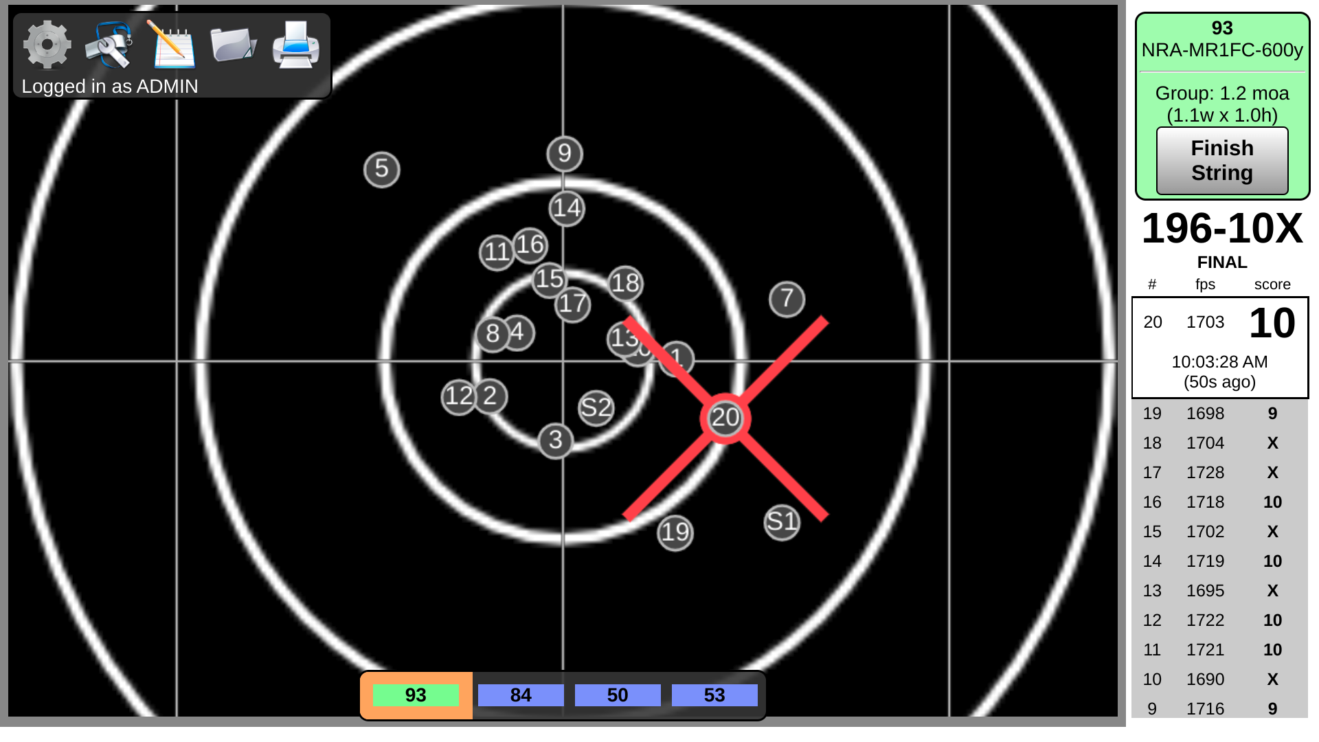

Saturday, Nov. 2nd 600yds @ NCWGC (East Wenatchee): winds were light and variable - no visible mirage, flags moving just enough to show there was *something* going on. Downwind shots were the wind; vertical... bad gun handling.
Relay #1
Relay #2
Relay #3

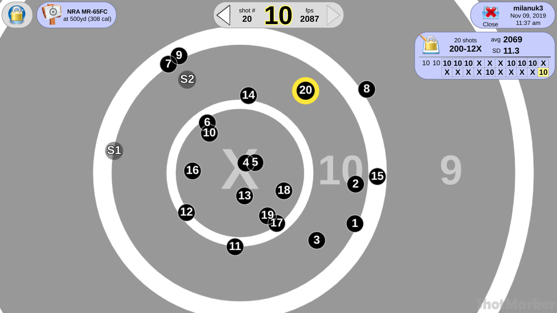

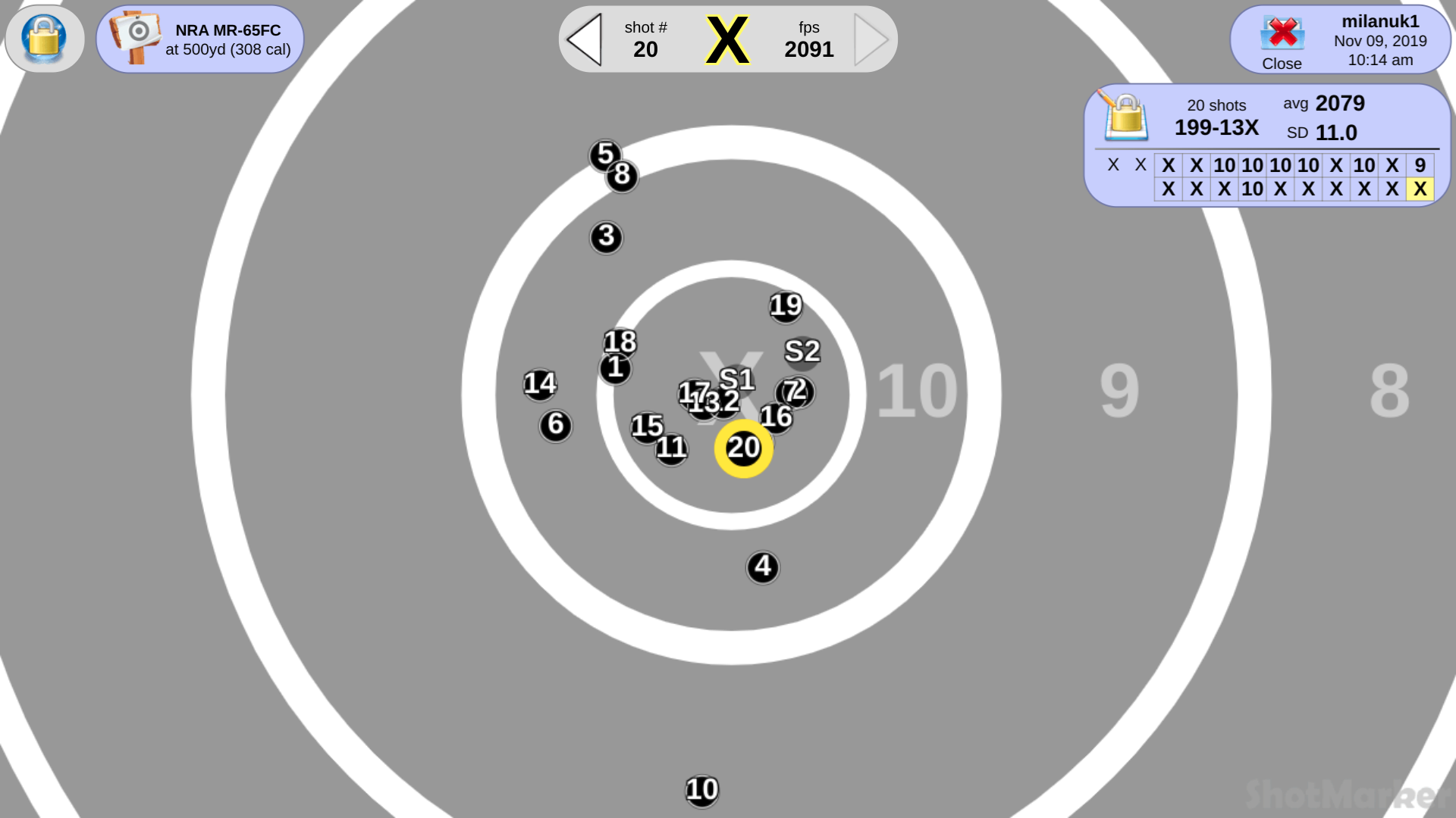

Then again today on November 9th, 500yds @ Machias. Conditions looked dead calm, and pretty much were for the first string. Second string, definitely had some push from the right, and third string had more of the same, plus some vertical movement going on down range. FWIW, this was actually three different loads being tested: 24 gn N150 w/ normal (3 thou) NT, with lighter (1.5 thou) NT, and then 23.9 gn. The original 'control' load actually shot the best, in my opinion... little bit of 'me' going on in the middle of the first half, and then had one round that chambered funny (had to force the bolt closed). Debated whether to extract and use a 'spare' round, but was concerned that I'd end up with a stuck bullet and/or powder everywhere, so I opted to send it - straight down @ 6 o'clock, as it turned out >8{(}
Otherwise the control load shot pretty well ;) The lighter NT load... was 'all over' the place, relatively speaking, and the two leakers were very much not on call. The last string was actually clean, but I had to work my behind off for that one - it felt 'looser' on target than the first load, for whatever that's worth.
Relay #1 (24.0 gn N150, 3 thou NT, control load)
Relay #2 (24.0 gn N150, ~1.5 thou NT)
Relay #3 (23.9 gn N150, 3 thou NT)
Also... not sure quite what to make of it, but the same charge seems to have sped up a noticeable amount from before. Whereas 23.9-24.0 gn was clocking @ 2780-2790 fps @ ~30-35F during load testing, the same charge weights are now running more like 2830 fps, based on 1) my LabRadar on Friday, and someone else's set up today on our firing point.
Either this lot of N150 (8.1.2014) isn't as temperature stable as I thought, or this barrel (Krieger) took an insanely long time (>400 rds) to 'speed up'. Definitely 'odd'...
Any difference in your brass or process for the last string? Number of firings on brass, etc?

Started load development with all the brass weight-sorted, neck turned, 1x fired. Annealed, F/L sized, expanded, ran thru the Giraud trimmer and RCBS case prep center (primer pocket), and tumble the lube off for ~15-20 minutes.
By the time it was all said and done (two different powders, testing at 100 and 600 yds) I was well into the 3x fired. Had 40 rounds left from that cycle that I shot up on Friday, and started on 4x on Saturday.
3" X @ 6, 2.5" @ 500.

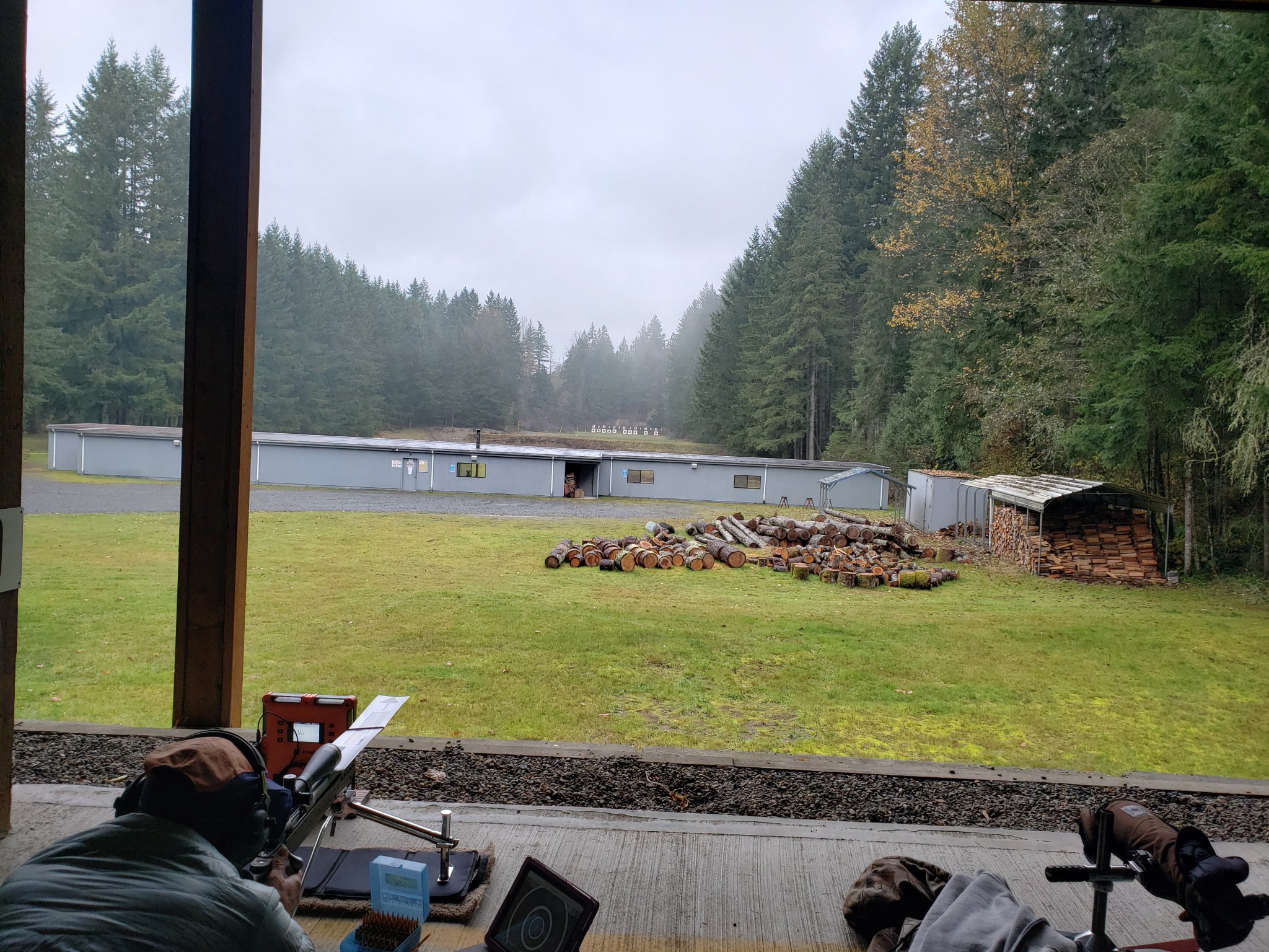

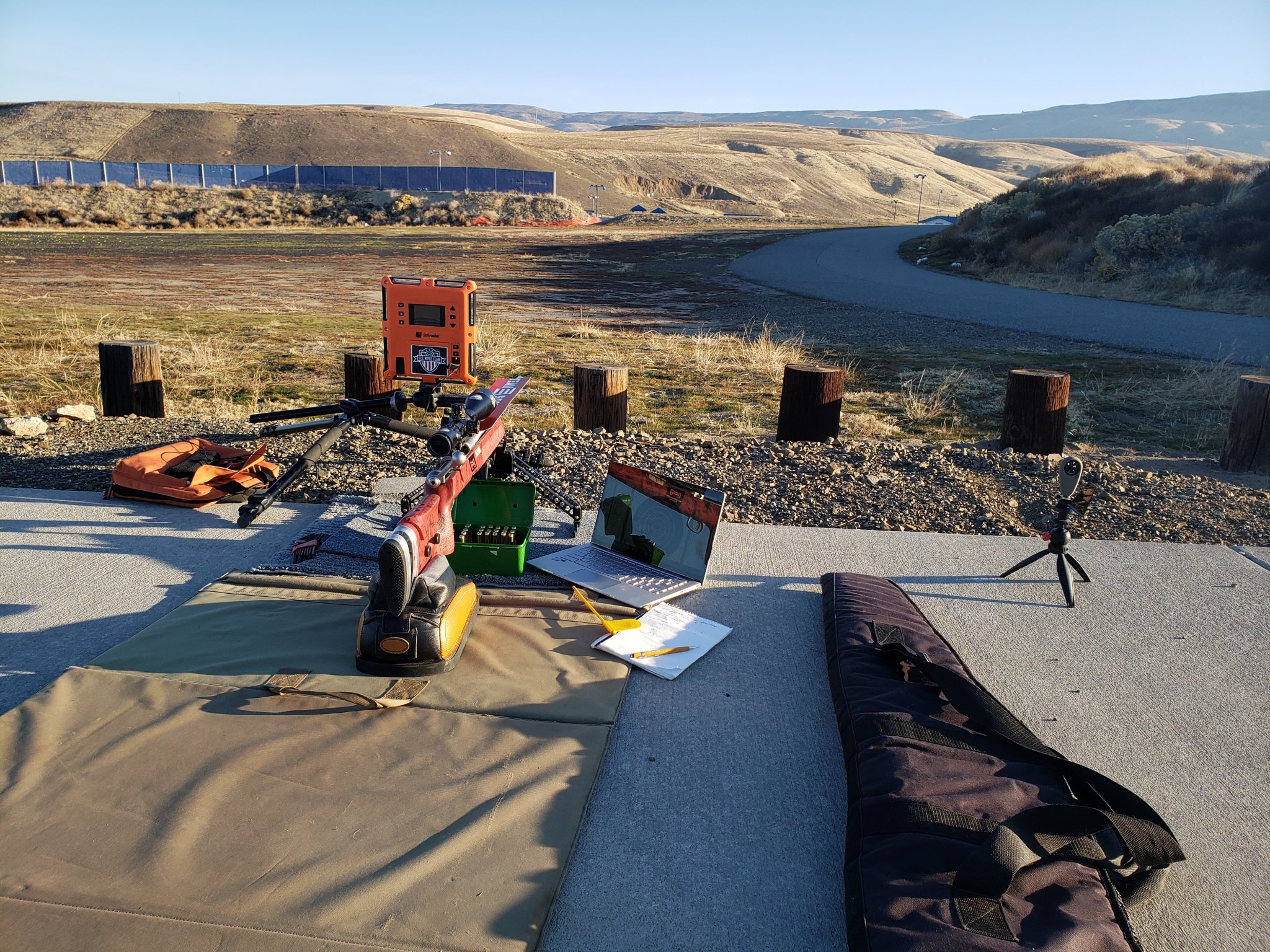

Conditions & range @ 600 Friday
Conditions & range for Saturday

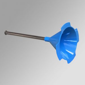

I use this to help and it seems to pack it in.

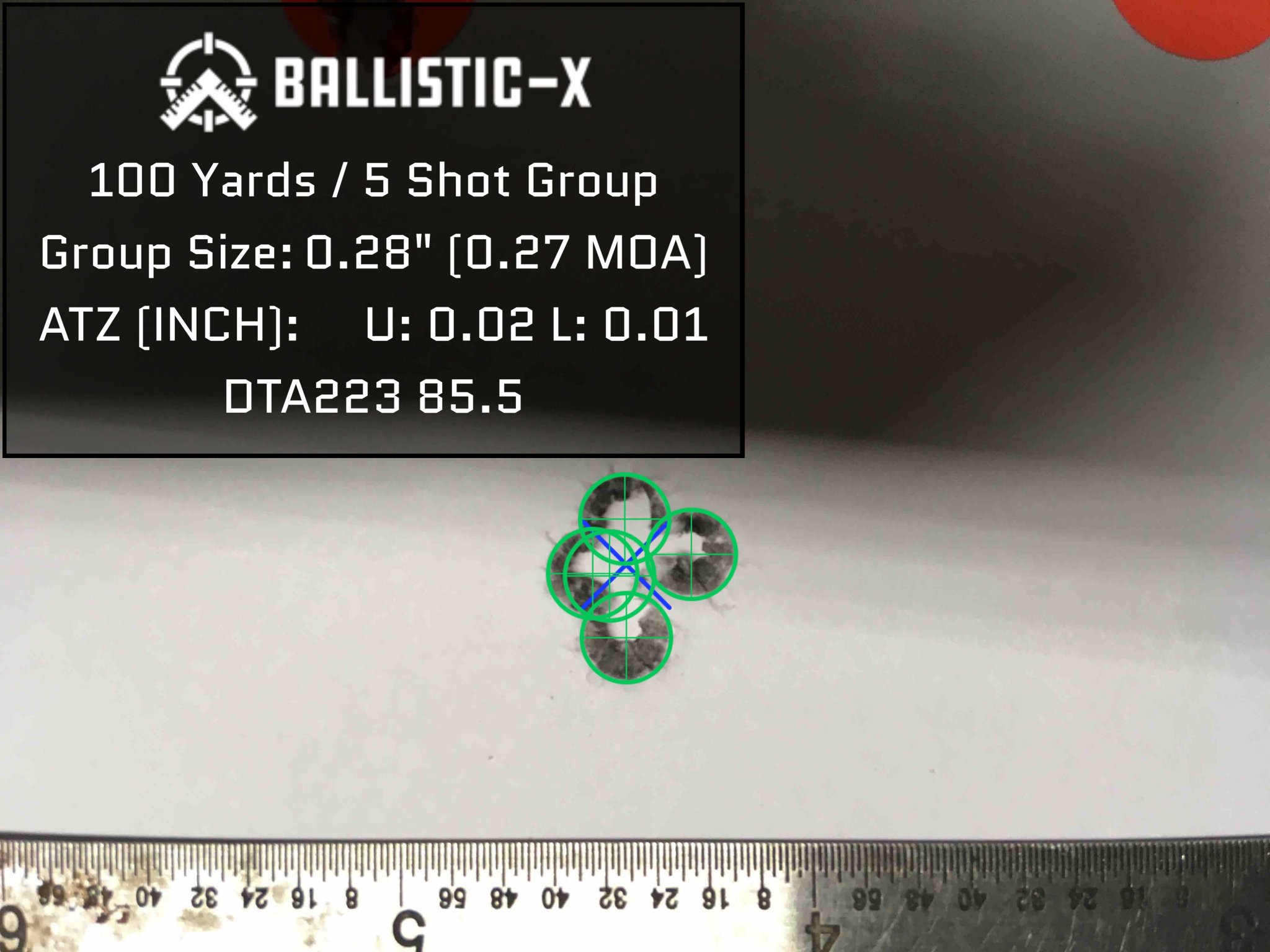

I am running a Desert Tech with SAC conversion. Very strong system. I am not seeing any signs of over pressure. The primers are still have some rounded edges and are not flat. No ejector or bolt marks on the brass.

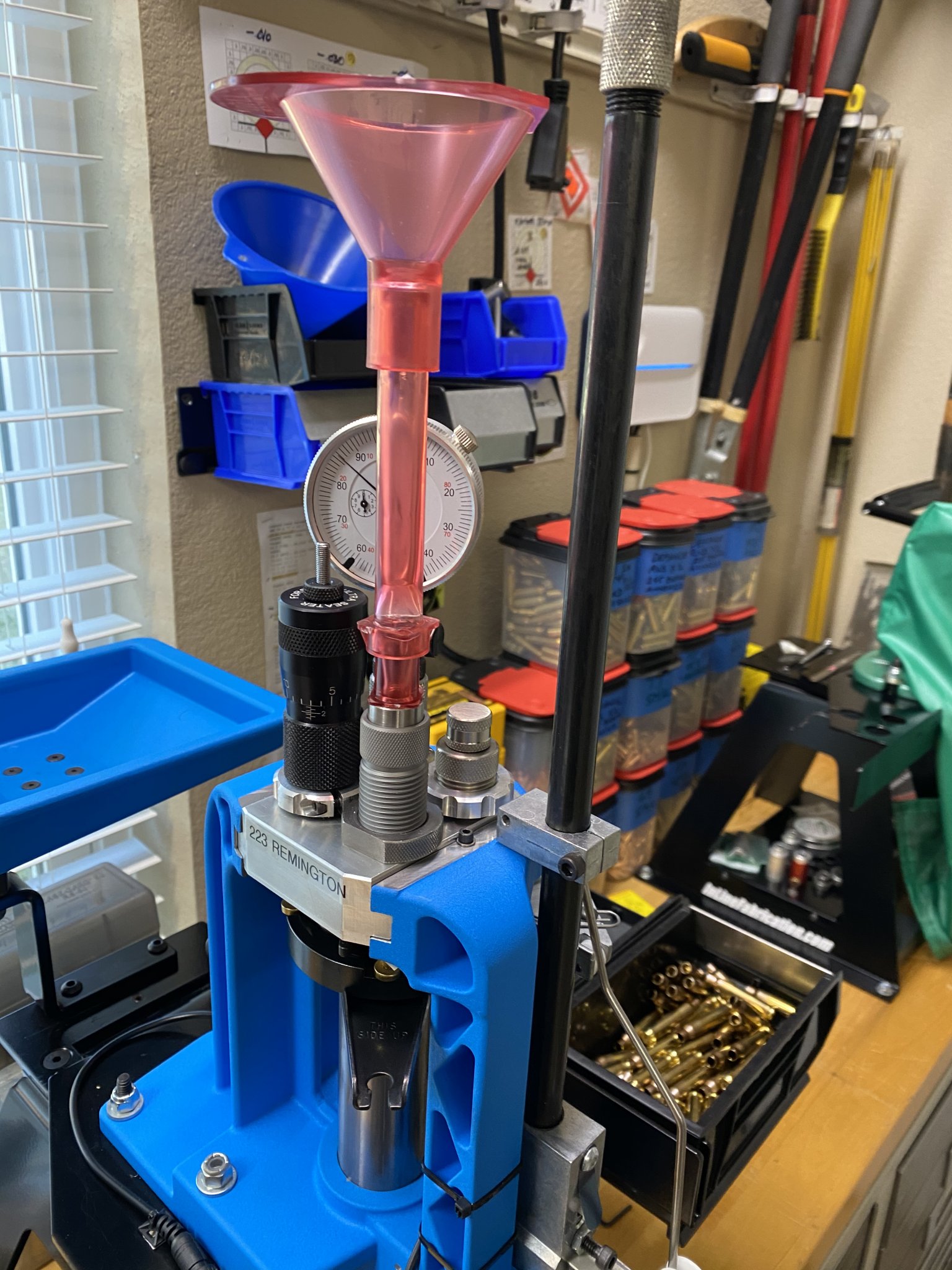

Also found the solution to a bridge free, transparent drop tube on the 550. Hornady powder die with MTM drop tube, packs it in nicely and not a single bridged drop. A much snugger fit than the Area 419 solution.

Just loaded a batch for testing. The new V3 Bluetooth Autothrower is perfect for bumping charges .3 grains per, the widely spaced markings on the micro die are ALOT easier to read than the original Redding seater I was using.
I’ve tried every combination of powder drops, Dillon, Area 419 and Hornady. They ALL bridged, 419 the most (and you’ll never know till its too late because you cant see it) - until I added the MTM kit to the Hornady powder die. The tunnel in the tube is wider & fits snugly in the Hornady powder die (unlike the wobbly Dillon die)
Expand, pour, seat and measure. Every round is measured in station 4 (Redding Instant Indicator) & is generally +- .001. If the occasional tight neck leaves a round .003 long, I back it up, dial in exactly .003 on the easy read Forster, reseat and measure again.
I think I’m as close to perfect and progressive as I can get.
(My only wish is for Redding to come out with a 6BRA Indicator die body)
