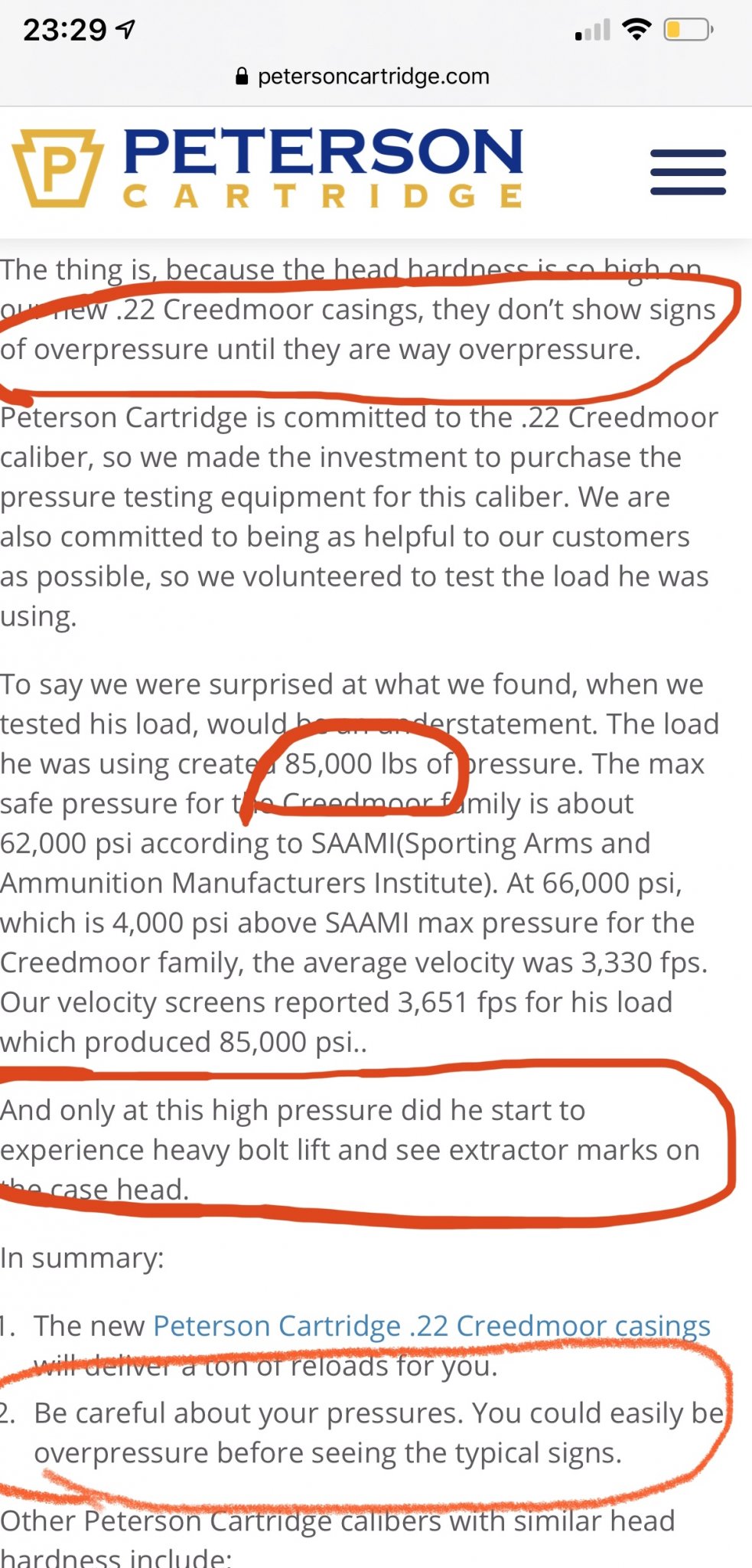

You don’t know what you don’t know.
Just like you have no idea what the pressure is in that rifle without properly testing it. Could be 50k, could be 70k. Could be running it just under catastrophic and something in the system or the environment changes. Then you have a problem.
On the other hand, you could have ejector swipes because of the polish or finish on the brass (alpha is a prime example. You could have flat primers because of excessive headspace and not actual pressure.
Again, you don’t know what you don’t know.
@THEIS
Your right , I don't know . I came on here to share what works well in my rifle and here you come like a fucking hall monitor looking to scold someone and turn them in to the principal for not following your guidelines . Well if actual hands on experience doesn't count for anything, then im glad im not educated according to you Mr Professor .
I actually just made the post in case someone else who doesn’t know saw your post and thought they can make an absolute determination of pressure just based on signs that may or may not show up immediately or ever.
I won’t even go into why your air compressor example is not a good one.
Sometimes experience is valuable and other times not as much. Was not scolding at all.
When we think we know too much and can’t learn anything, that’s when bad things happen.

And would anyone care to guess what the "Proof" round pressures are for the 22CM?
Well, I do not guess, so the answer is: Certified proof ammo operates at about 1.5x the SAAMI operating pressures.
And would anyone care to guess what a firearms manufacturer does to "Proof" their design in regards to pressures capabilities?
The answer is: 2 shoots of certified proof ammo. That is IT!!!

Hi,
Nice article but rather old (15 years or such).
Pressure testing has advanced greatly from those days. Conformal ballistic pressure sensors along with their calibration techniques, their mounting techniques, etc etc have progressed past a point of what Hart could have imagined decades ago.
The timing of me being tagged into this thread is rather ironic; as I just had a meeting yesterday with NTS engineers on this very exact subject because of some testing I am having them do for me.
Here is a highlight of what/how they do thing:
For SAAMI pressure testing, a conformal sensor (conformal, in that the face of the sensor is curved to match the contour of the cartridge being measured) is used to measure the pressure near the mid-point of the cartridge. The sensor is a piezoelectric transducer; we use this coupled with a voltage peak meter to measure the pressure during each firing event. The pressure is measured to the single psi unit for most tests.
There are variations from cartridge to cartridge as you pointed out. SAAMI attempts to negate these variations in 2 ways:
  1. Each time a new lot of brass is introduced to the testing process, the transducer is calibrated with that brass using an oil calibration system. This allows the transducer to be ‘calibrated’ for each unique lot of brass that is used.
  2. At the start of each test day, SAAMI requires that reference ammunition be fired, of the same type being tested that day. This allows for corrections to be made to the velocity/pressure measurements that are actually obtained, and are based on published ‘nominal’ values that are periodically released by SAAMI, for each caliber.
For some light bathroom reading on this subject from within the last 2 years.
Sincerely,
Theis
  • BallisticPressureGuide_LowRes.pdf

So here we are going in circles.
Using COMMON SENSE ,load manuels ,and the method of looking for signs is all most of us have and has worked out just fine for me. I Have yet to get hurt or hurt anyone else with my reloading methods.
If making a statement like “remember, pressure signs don’t always show up when there’s pressure” makes you feel like you’re being insulted......
I suggest looking around the reloading room floor or online for thicker skin.
Also, keep in mind that “common sense” is different for everyone. And is based on a totality of your education and experience.
Common sense to me is “I don’t know what my pressure is without the proper testing and equipment, so I’m not going to push my luck. I’ll just get a more appropriate cartridge.”
Common sense to others may be “I don’t see pressure signs so I must be operating at a safe pressure.”
“Common sense” is another wives tail. It’s not that common at all most times as people’s education and experience vary wildly. That common sense someone doesn’t have can be developed over time. Which negates the term common.
Interestingly enough, most people who like to toss around that term usually also toss around how many years experience they have without being able to produce any concrete facts on subjects. This is a general observation and not directed at anyone specifically.
Hornady lists max charge of H4350 with a 140 at 40.9 for the 6.5 Creed add 10-20% to that. Umm, no. Or is anyone loading 45-49 grains of H4350 behind a 140 in the Creed?
Actually if you go to the 6.5 creedmore load thread , there are several running way over 40.9
have 3565 down for 25.8 of 8208 with a 53 v max in LC brass, from a factory 700 26" 1 in 9. My chromo is broken, so I can't reconfirm that, it seems really fast, but it would have come from my magneto speed. 3 MIL in a prairie dog town puts me, at what i
would guess is about 500y. I have never confirmed the dope in calculator on it. When I get to my ammo cabinet, I can a a coal.
Wow, looky there Mr hypocrite. your running .4 grns over max according to hornadys load data, Better watch out , you never know when them pressures are gonna get ya.!
I have possed the question " If signs aren't a viable method of reading pressure , then what is. ", And the only answer I got was You don't know what you don't know and we do. Glad to know my practices are wrong and yours are infalable.
At this point I could care less what you guys think of my methods or practices . Please get the stick out of your eye before you worry about the splinter in mine.
Other than the post that Theis made there has been no discussion on methods or how we should determine pressure for the load were using.
Although I have learned one thing and that is I have a sudden craving for a corn dog from SONIC drive thru.

Still missing the point.
No one has told anyone here not to run their pet load. No one has told anyone they are running over pressure (because we don’t know if you are or not).
It was just a simple correction that not seeing pressure signs doesn’t mean you are running in a safe pressure zone.
That’s it. Nothing else. Just a simple correction to make sure some bad info wasn’t passed along to unsuspecting current or future reloaders.
Run the load you want. Just don’t let something that may or may not be indicative of safe pressure give you a false sense of security.
