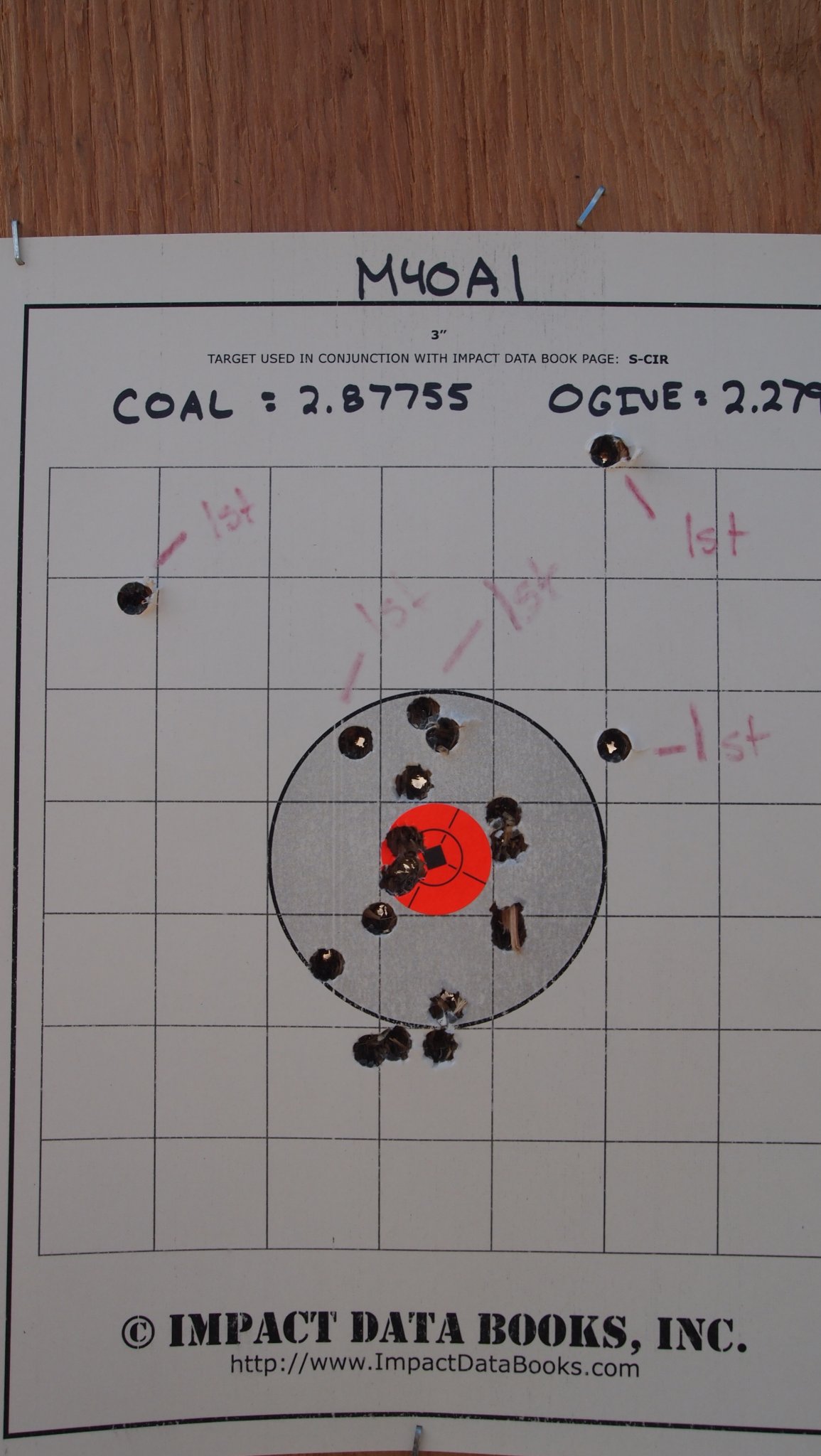

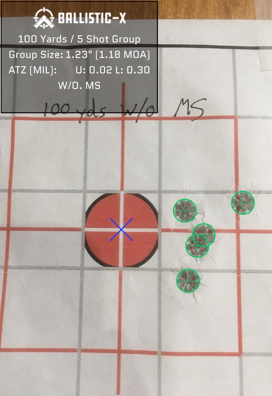

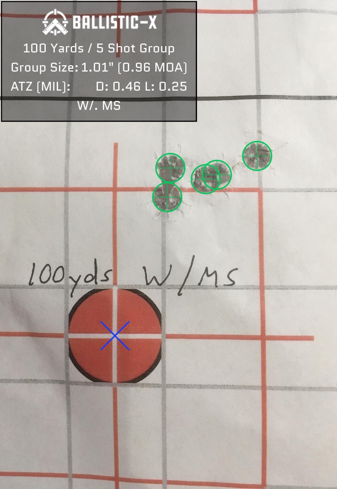

Shot this just for you today.
Without the Magnetospeed:
...and again with the Magnetospeed.
This is consistent with every other time I've done this with this rifle and load. It not only exhibits the typical POI change, this particular load actually shoots tighter with the MS attached. Also, the shape of the group has totally changed.
So all your data amounts to "fuck all" in my case....and possibly the OP's situation as well.
1" vs 1.23"??? Lmfao amateur hour over there
Your load and your shooting skills suck a fat one. Your horizontal dispersion is all the idiot behind the trigger not the MS. Bud. Dont quit your day job
You're preaching fake news like you're shooting 0.25" groups vs 1" groups.

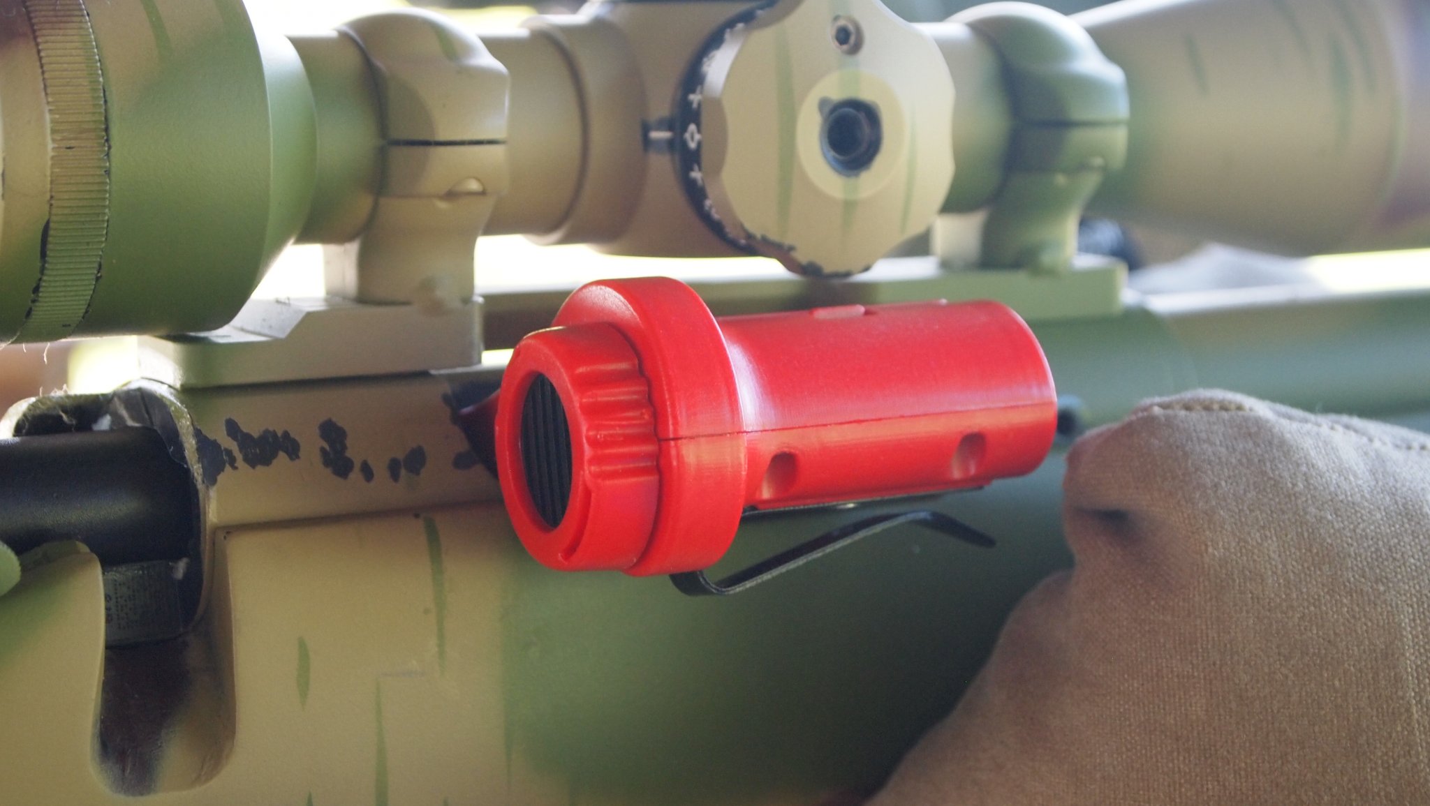

Could you provide more details about your load, your rifle, and how you secured the MS to your barrel?
Rifle:
Trued Rem700, 308 Win
24" Bartlein barrel, Sendero taper, 1/10 twist
McMillan A-5 stock bedded to action
Vortex HST 4-16 scope
Load:
175 Sierra
41.5 grains IMR 4895
Fed GMM brass twice fired weight sorted, annealed.
Fed 210 primer.
Environmentals:
60*F this morning at time of firing
Overcast
wind 0-2 mph
As much as some seem to agonize over 1/4 MOA, seems you usually believe it is significant, just not when it is in disagreement with your arguments. 1/4 at 100 yards is a 25% difference.
This is a load I used to illustrate the point, not my best load.
Why does my shooting always get better with the MS attached? Is it magic?
The change from a group that is almost completely vertical, to a group that is obviously horizontal means absolutely nothing to you? That says volumes about your interpretation skills.

The reason I asked about how you attached the MS to the barrel is because MS slides forward under recoil and this changes poi. So your test is invalid if the MS was not kept from sliding forward by a hard stop of some sort.

Your 1 single group is far from factual data. As someone else noted, we know nothing about your rifle, load, loading skills, shooting skills. Go shoot a 6x5 with it on and a 6x5 with it off. State your rifle specs, load details, loading process. That will be more factual data then you showing us 2 magical 5 shot groups with ZERO information. To answer your question, yes it means nothing to me. Not anywhere enough data to draw any factual conclusions.
This rifle has no muzzle break. I have a strip of tape on the barrel. The MS was checked for position after every round.

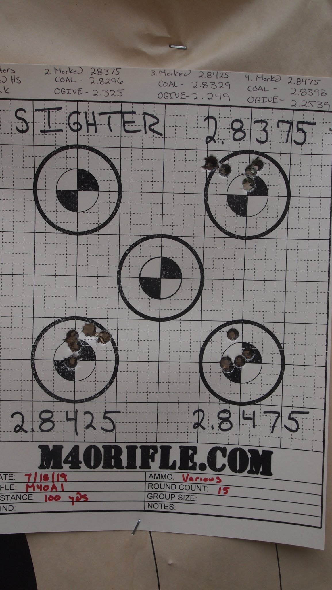

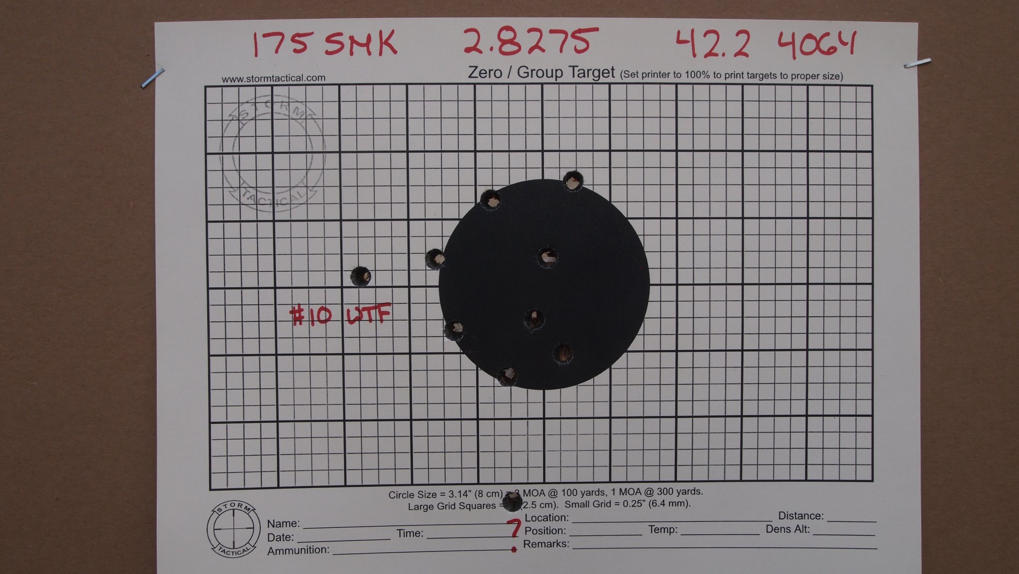

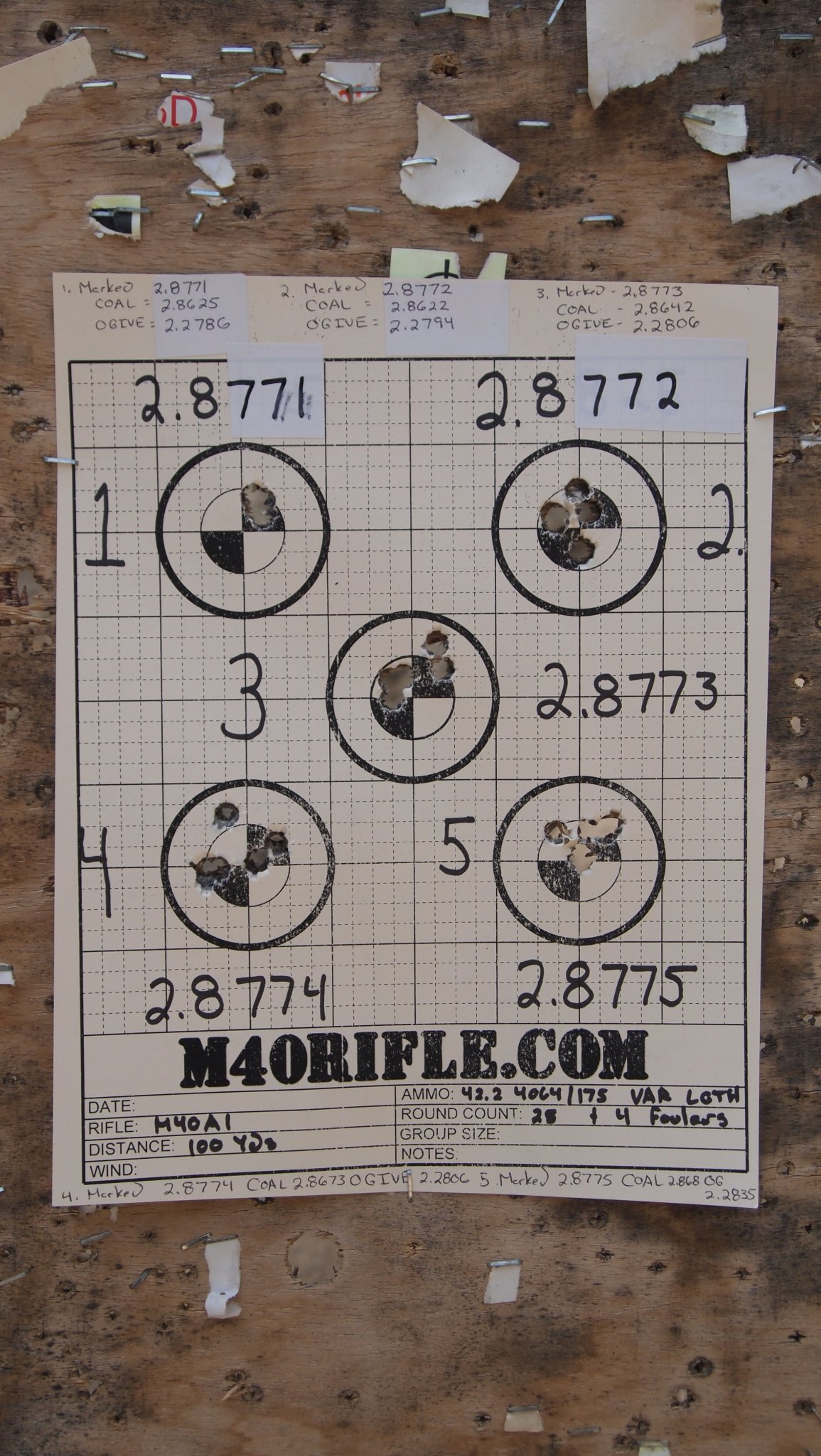

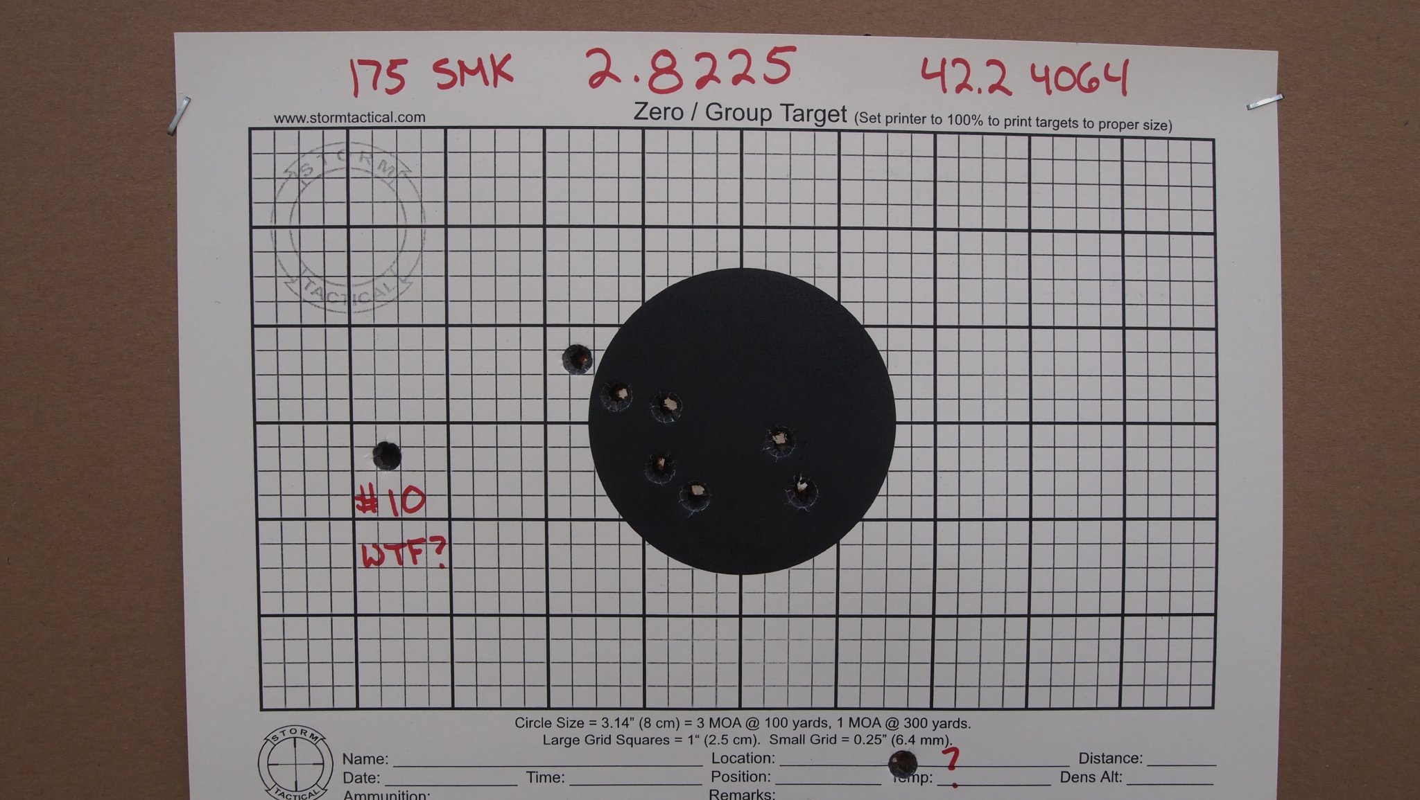

Decided not to mess with the Magnetospeed this weekend but I did say "What if longer but just under 2.83 is where I want to be?"
Tested 10 2.8225 and 10 2.8275
Noticed 1 of 10 was low off of paper after taking down the target, hence only 9 on the target.
The short guys seem to group better save the wild flyers.
I know Im not super shooter but Im questioning if my Dillon beam scale is repeatably accurate.
I got this same sample loaded up that Ill check over the magnetospeed to see if velocities are staying consistent.
With return of warm weather Im thinking these will be going faster than my earlier tests.
Rather have them be slow in the cold and safe in the heat.

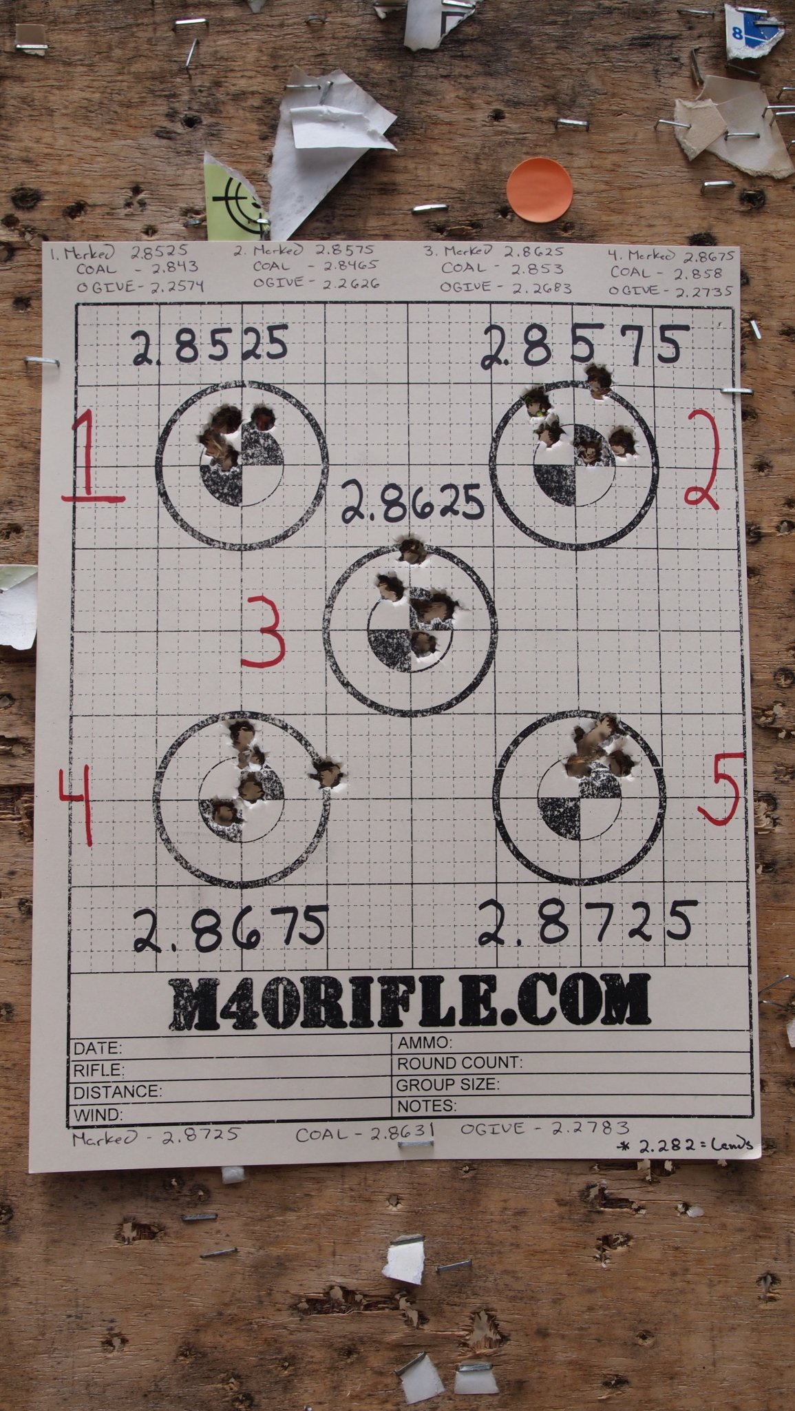

2.8475 looks pretty good.
Note that the "theoretical" OAL as used to label the rounds and the actual, as measured differ significantly.
I am using a Redding micrometer seater die to seat my bullets.
Supposedly each tic on the micrometer head is supposed to be .001 of movement.
I labled my rounds based on the "theoretical" supposed to be measurement.
Reality I found that the micrometer does not move the amount the tic marks show, likely compounded by differences in the bullets themselves.
At the top of the targets I listed actual COAL and OGIVE as an average of the 5 rounds measured individually.
Im getting screwy numbers. Some rounds were actually shorter despite adjusting the die for greater length.
I measured to the lands in my rifle. Despite being chambered by PWS in Quantico it still shows significant room to move before I hit lands.
Ive got another 5x5 to shoot before the rounds become to big for the magazine.

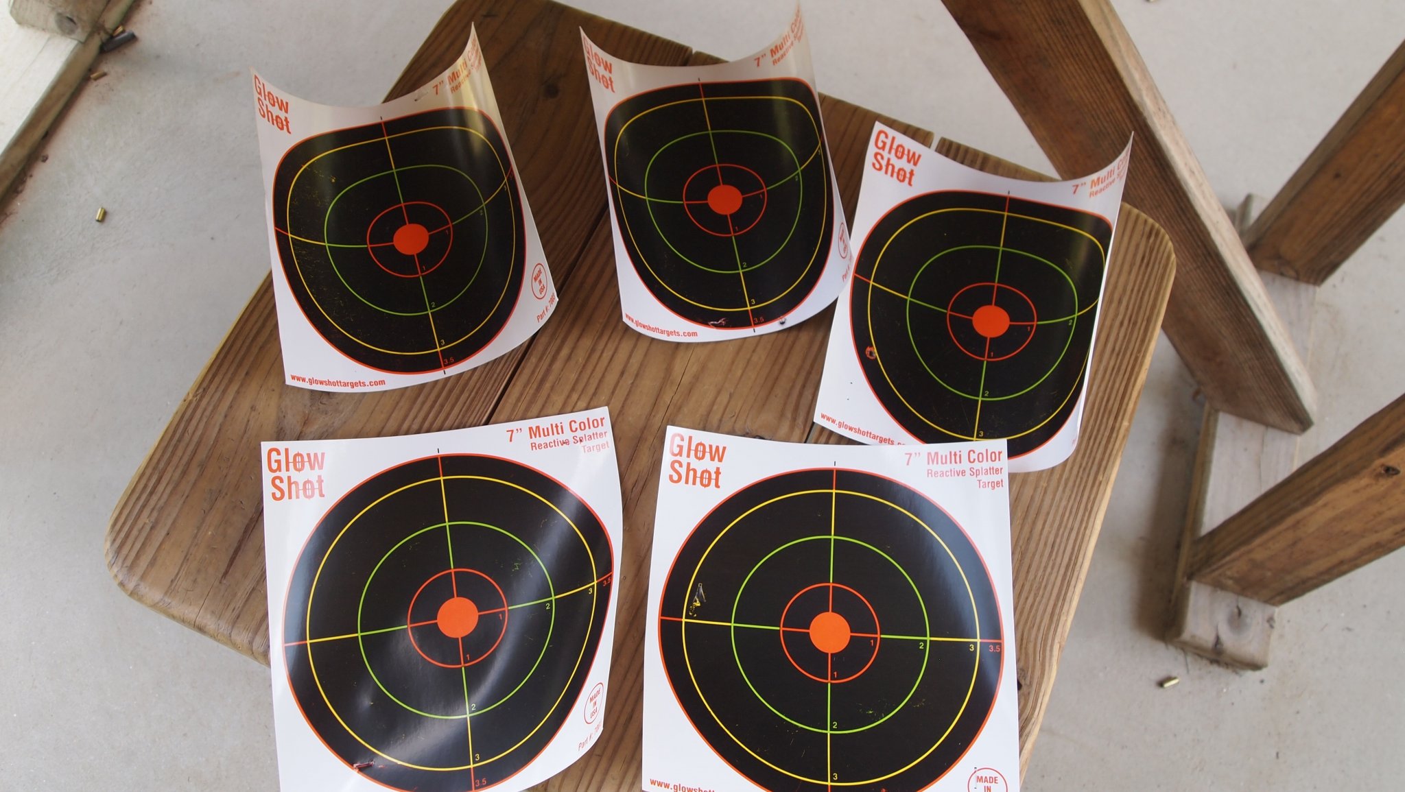

While I'm a little late to the party I'll give you my take on these targets.
Target one:
Mostly breathing with one trigger crunch
Target two:
Verticle is fairly tight but trigger crunch is causing the horizontal
MS is going to be hard to blame until you are punching 5 inside a .5 circle or better.

I must add that I relatively new to precision rifle?
SMK vary about .010” in length within the lot. So you can get a shorter coal even though you set the micrometer to make them longer.
Today.....
These are the last of the rounds I have loaded that will feed from the magazine.
Number 5 is 2.8631 COAl and measurement to OGIVE is 2.1783.
Using a Hornady/Stony Point tool I measured the "to lands" OGIVE of the rifle at 2.282".
I have more ammo made up getting me out to just under the 2.282" measurement and I will likely shoot it next range trip just to see what it does for accuracy but I dont want to have a single shot rifle.
Right now Im inclined to go with the length of cartridge that produced target 5.

I think I am the worlds worst reloader.
My next plan........
I have 25 more rounds 5 X 5 at increasing lengths.
All of these rounds exceed the length to reliably mag feed as well they are getting close to jammed with the lands.
First two longer length groups of 5 And ve colored the bullet OGIVE with Sharpie to chalk for jamb.
Other three I will crawl them up to just within the point they contact lands and see which will reliably feed.
Rather than shoot the next target round robin I'll shoot in groups of 5 to check for feed.
Should produce better groups. I tend to shoot better groups when I stay on one target and just fire the mag.

I was rewarded with some unshot distance targets for my perseverance....
Cant figure why people buy shit, staple it up than leave it unused. Whatever I hope they dont stop. I love these at distance.
One of them was actually "shot up".....3 holes - 2 in the white, 1 in the black - I used it as my warmup....
Cold bore fell all alone and 4 together below.

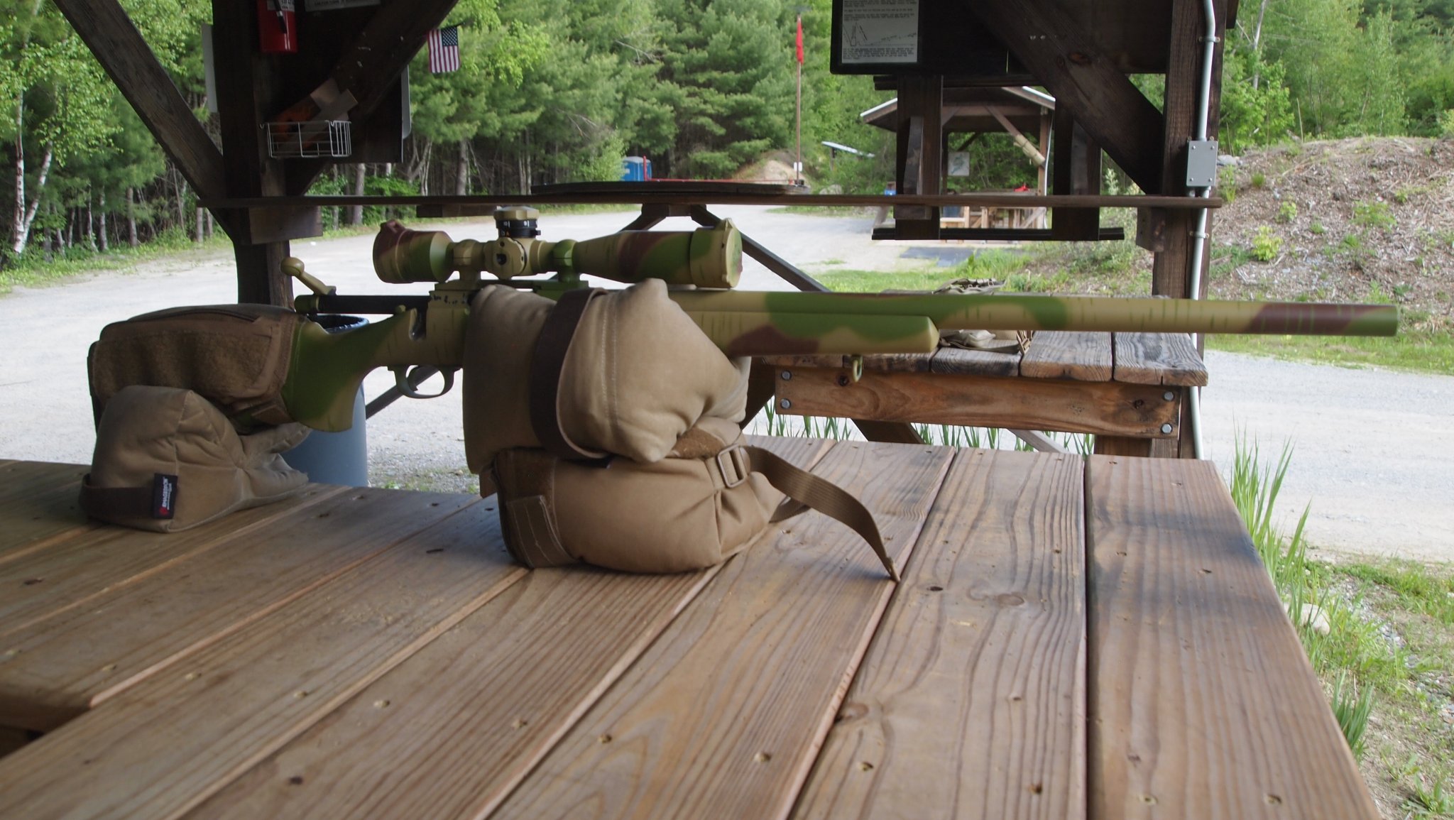

Forgot to get a picture of the rifle only a target to show......
Im going 2.8771. That is only 4 rounds. 1 wouldnt allow bolt close yet all other 29 shots did. Im thinking that one round may have been the last round seated (I went from high to low because that was where the seater was at) and with the empty shell plate it didnt seat all the way.
Three hundred yards with the 2.8771 load.
I did adjust the seater in a CH to see if I could get that one round that would not allow the bolt to close to now close.
It fit today and I fired that round as my cold bore. I used 4 rounds of "Team Never Quit" (FGMM 7.62X51) to warm the barrel and shooter.
"Team Never Quit" approximates M118LR so my scope zero seems to be dead nuts. My starting dope on the MST was 3/+.5 E - 0 W.
I held the same dope and moved over to my second target.
I went spastic on my first five because it was for record. Looks like I need to reload my Sharpie.....how many grains of red ink?
I dialed off the +.5 on the scope and shot the next 15 rounds at 3/0 E - 0 W.
Pretty happy with that but Im getting at best three in the magazine. The rounds are too long.
The way I measured to Lands (Hornady Tool) Im probably actually jamming the bullet.
I have 25 more rounds of this made up and I am going to seat each group of 5 - .001 - deeper and see if I can get the longest round to feed five from the magazine.

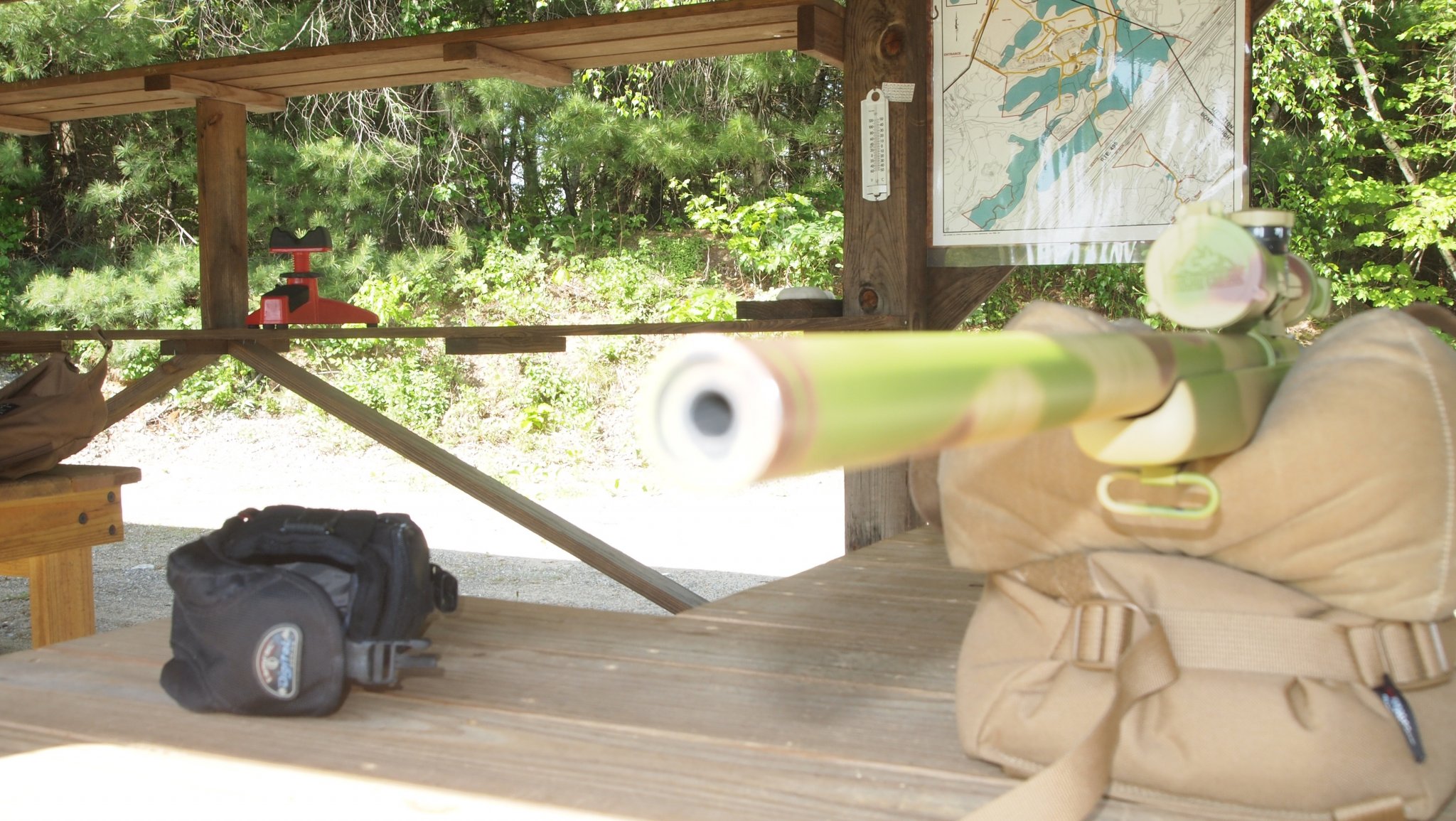

Shot my target in groups of 5 which I prefer to do.

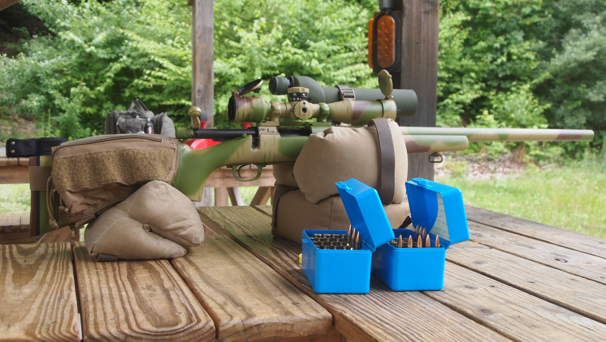

Used my new Rifle Kuhl to give the barrel a five minute fan session between groups....
Seemed to work good.

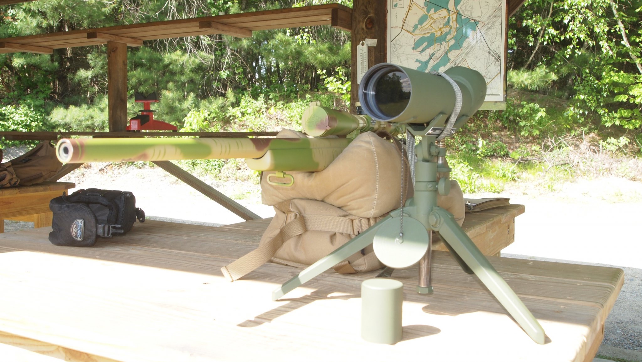

Brought my new to me 70 plus year old cover to the range too.
