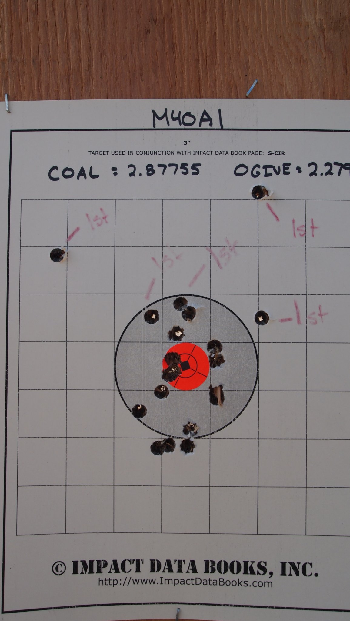

I might have missed it but how far off the lands are these currently loaded?
I measured 2.282 to lands using a Stony Point/Hornady tool.
From what I understand that tool probably measures an ogive to lands touch likely to be .002 "jammed" unless you are real careful with the touch.
But anyway its the number Im going with 2.282 and these are 2.2795 or so.
I got the lands measurement as an average of ten measurements and I got the 2.2795 from the average of 5 of my loaded rounds.
Possibly .0025 off the lands.
Three hundred yards with the 2.8771 load.
I did adjust the seater in a CH to see if I could get that one round that would not allow the bolt to close to now close.

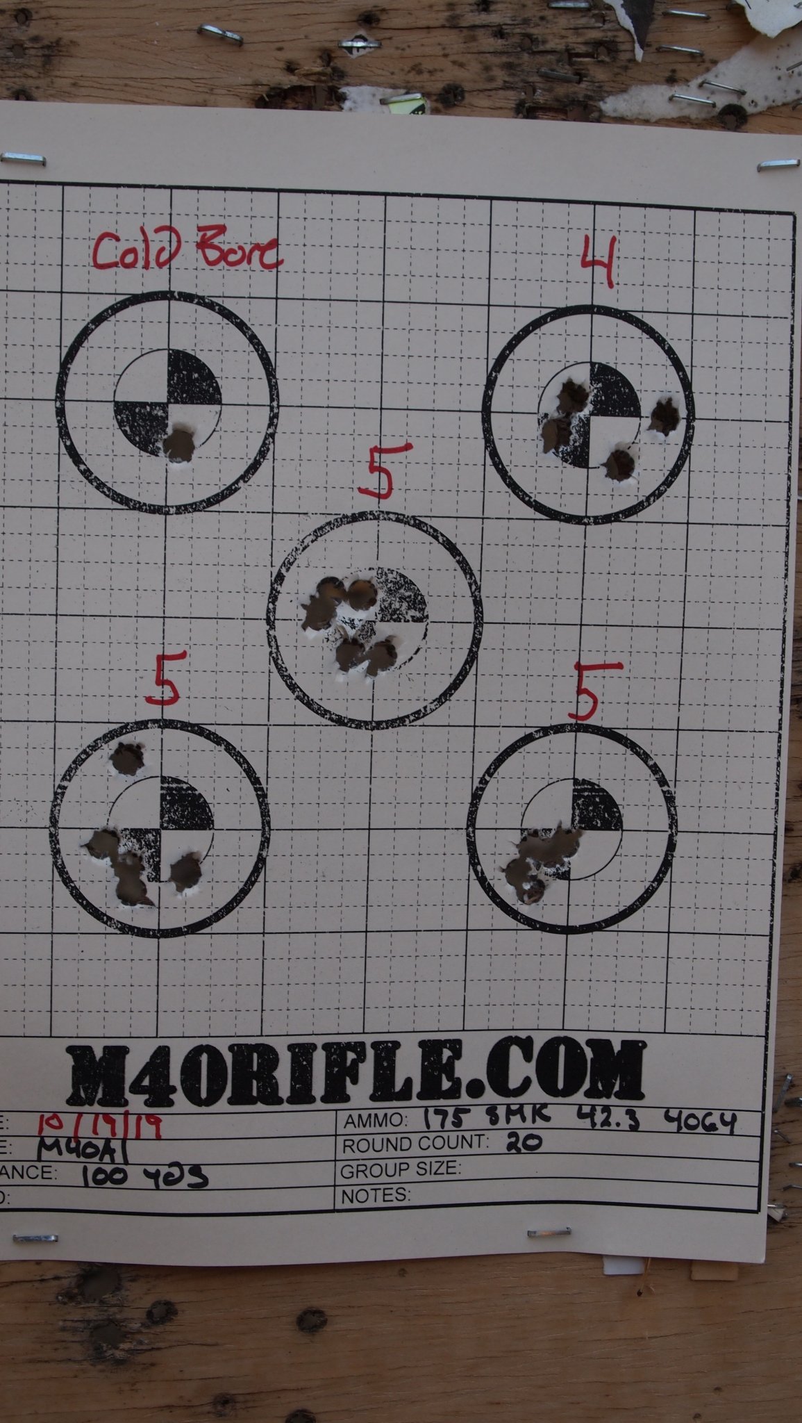

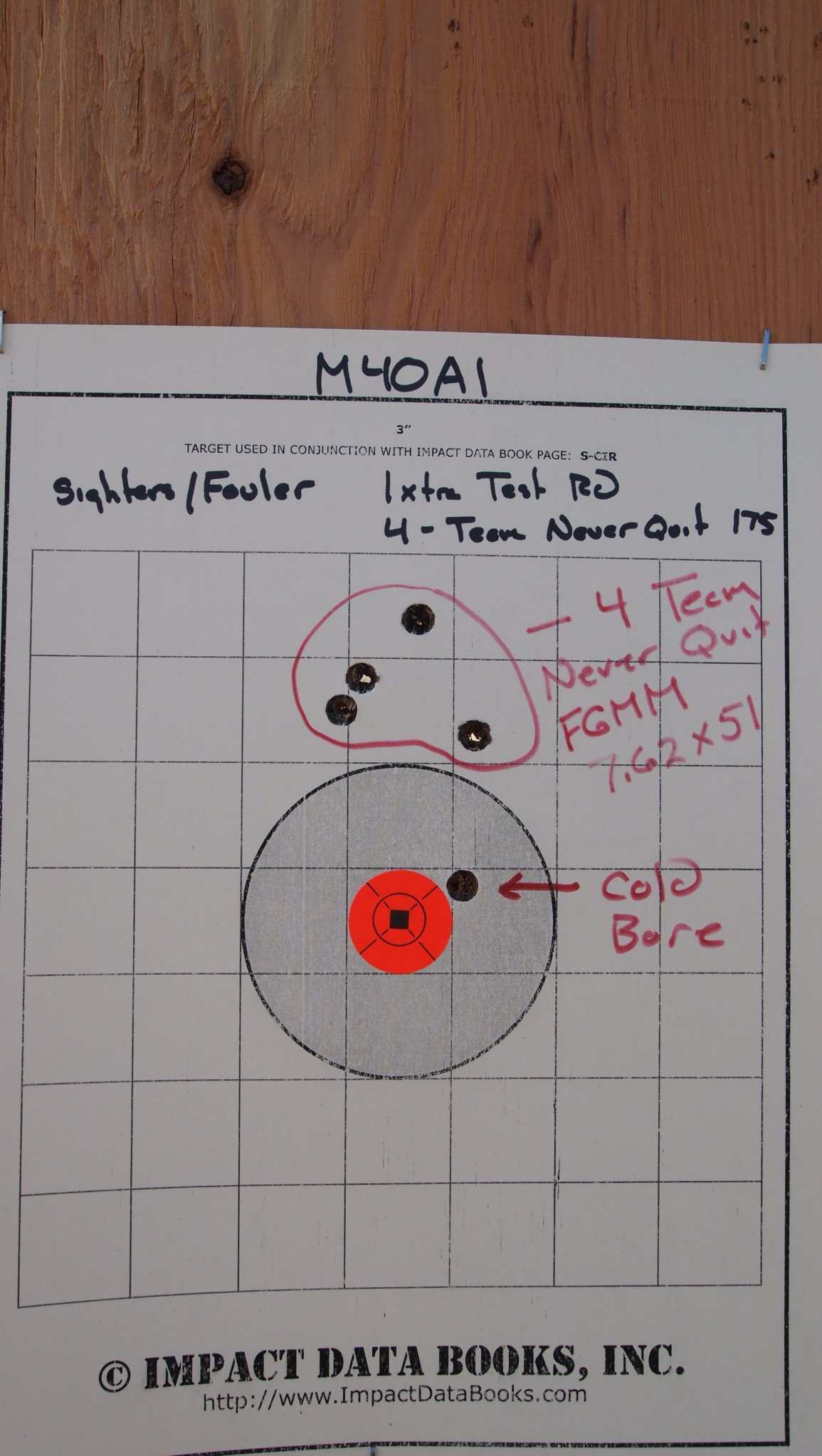

It fit today and I fired that round as my cold bore. I used 4 rounds of "Team Never Quit" (FGMM 7.62X51) to warm the barrel and shooter.
"Team Never Quit" approximates M118LR so my scope zero seems to be dead nuts. My starting dope on the MST was 3/+.5 E - 0 W.
I held the same dope and moved over to my second target.
I went spastic on my first five because it was for record. Looks like I need to reload my Sharpie.....how many grains of red ink?
I dialed off the +.5 on the scope and shot the next 15 rounds at 3/0 E - 0 W.
Pretty happy with that but Im getting at best three in the magazine. The rounds are too long.
The way I measured to Lands (Hornady Tool) Im probably actually jamming the bullet.
I have 25 more rounds of this made up and I am going to seat each group of 5 - .001 - deeper and see if I can get the longest round to feed five from the magazine.

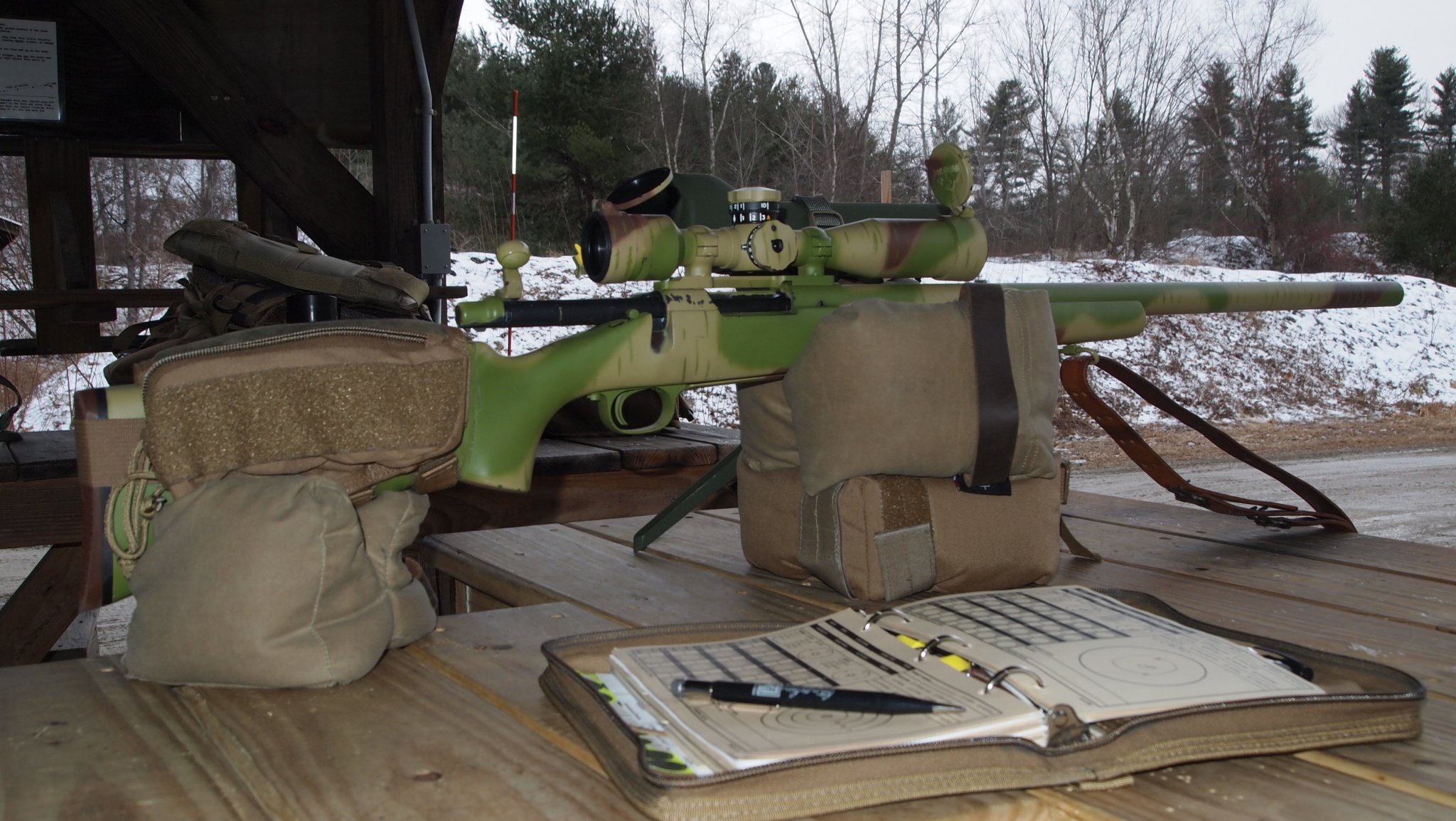

Shot my target in groups of 5 which I prefer to do.

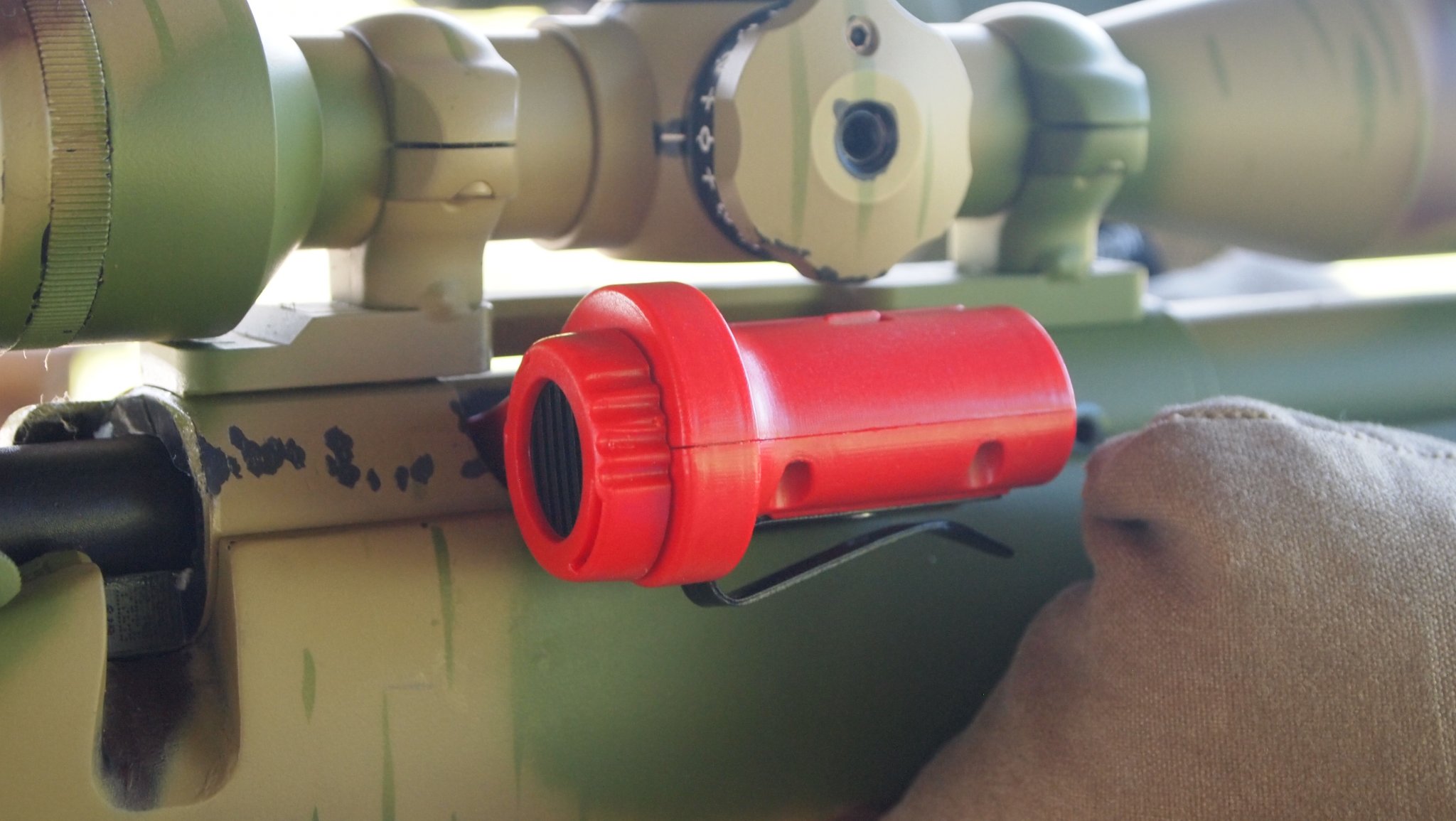

Used my new Rifle Kuhl to give the barrel a five minute fan session between groups....
Seemed to work good.

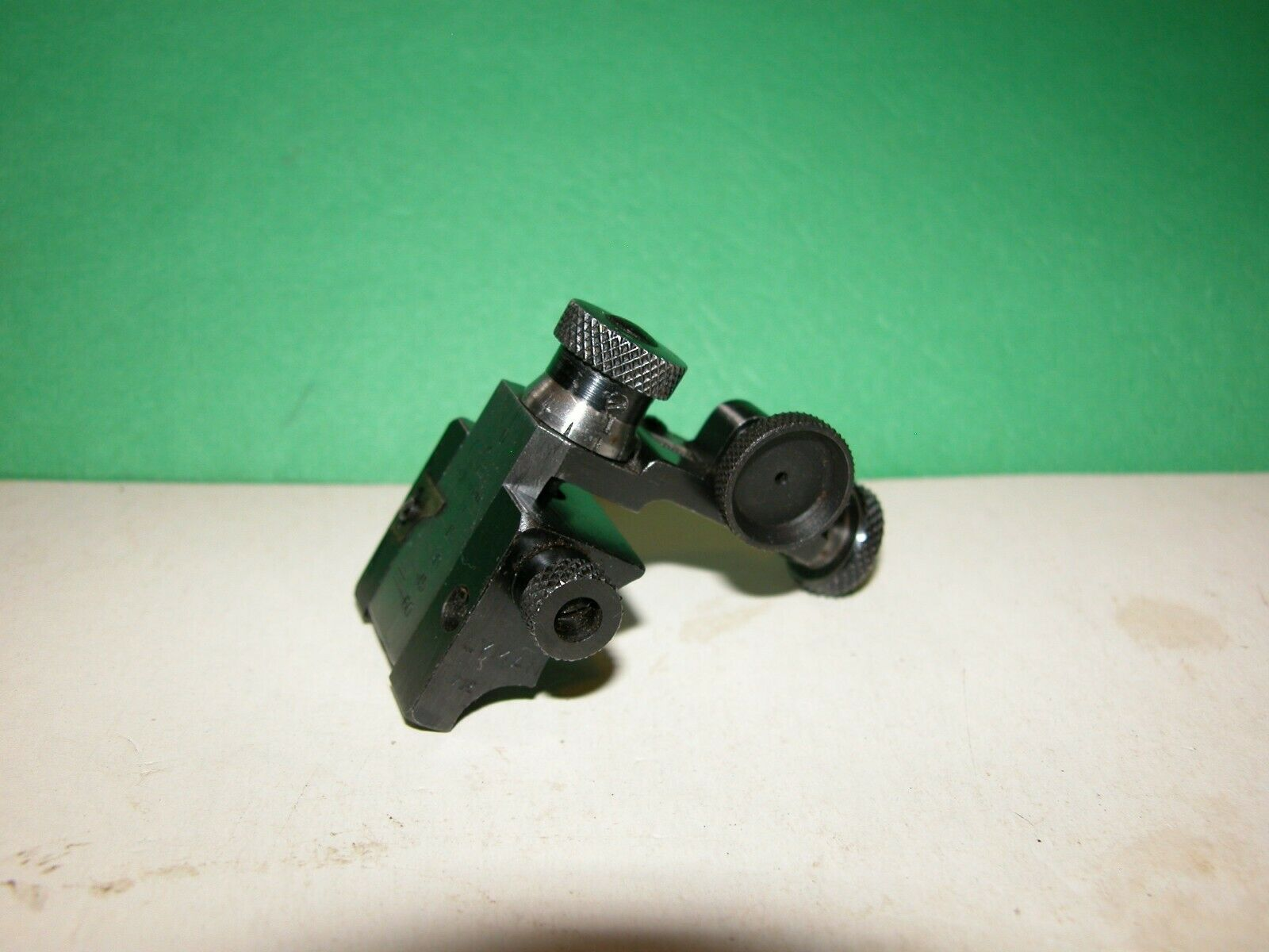

a sight for my Model 70

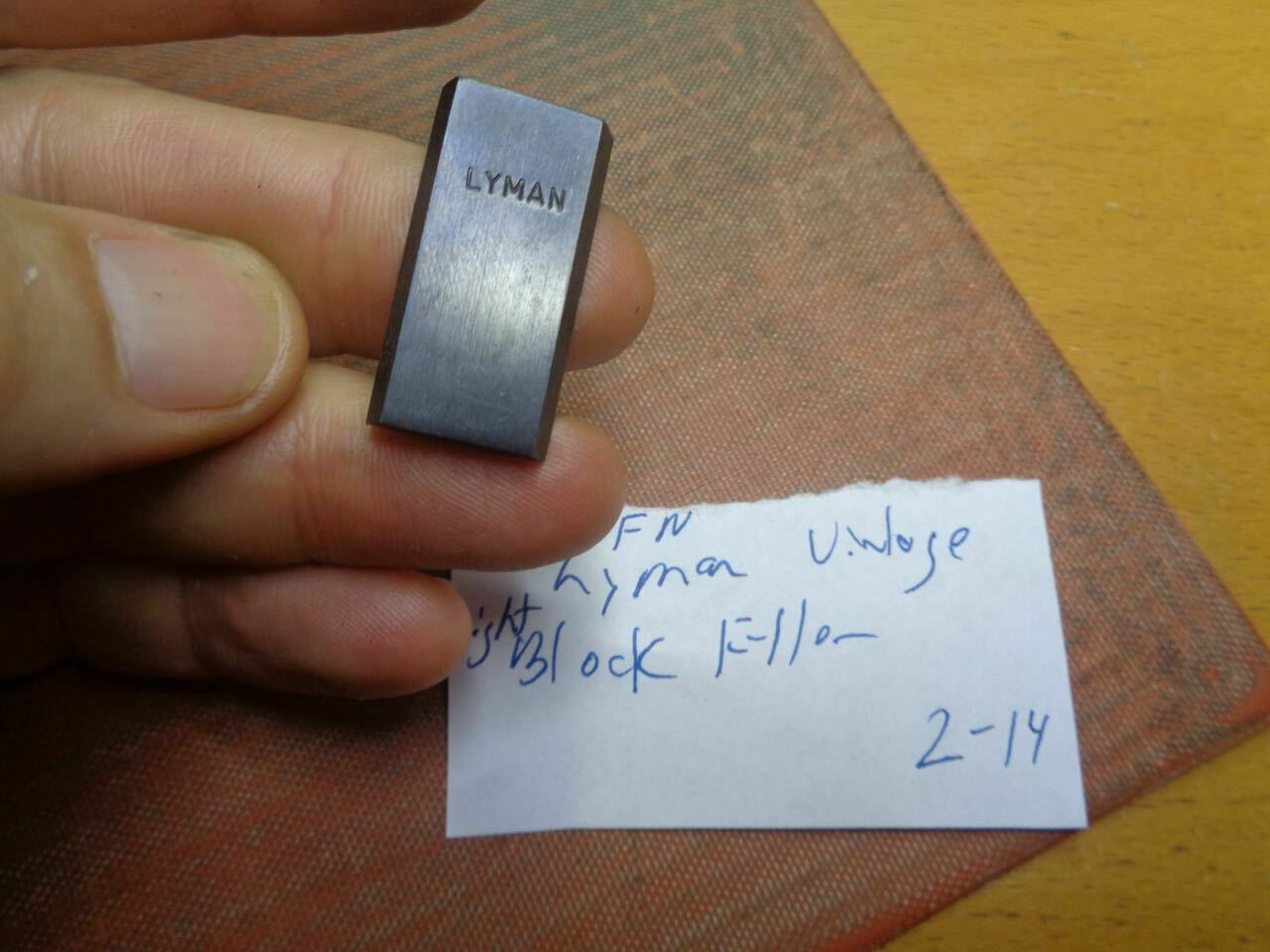

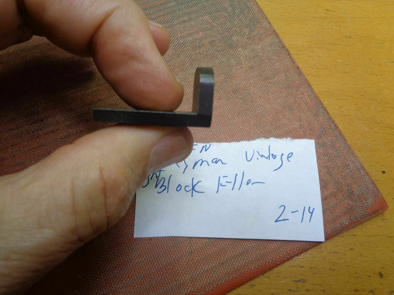

and what I thought I would never be able to find.......a 60 point slide filler for a Lyman receiver sight.

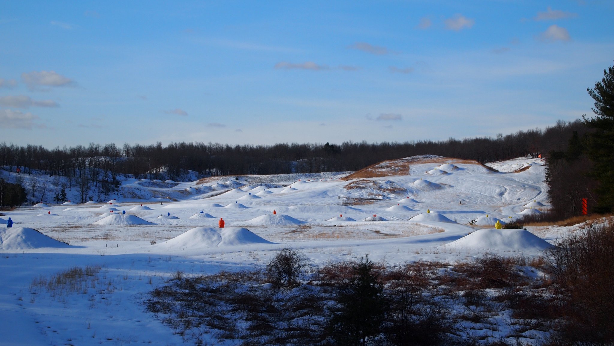

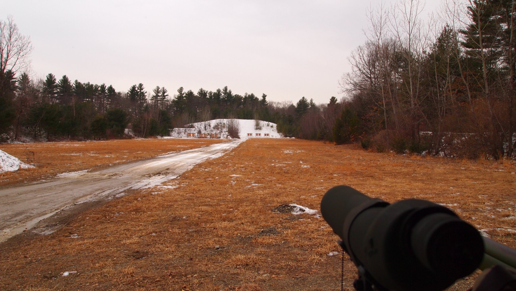

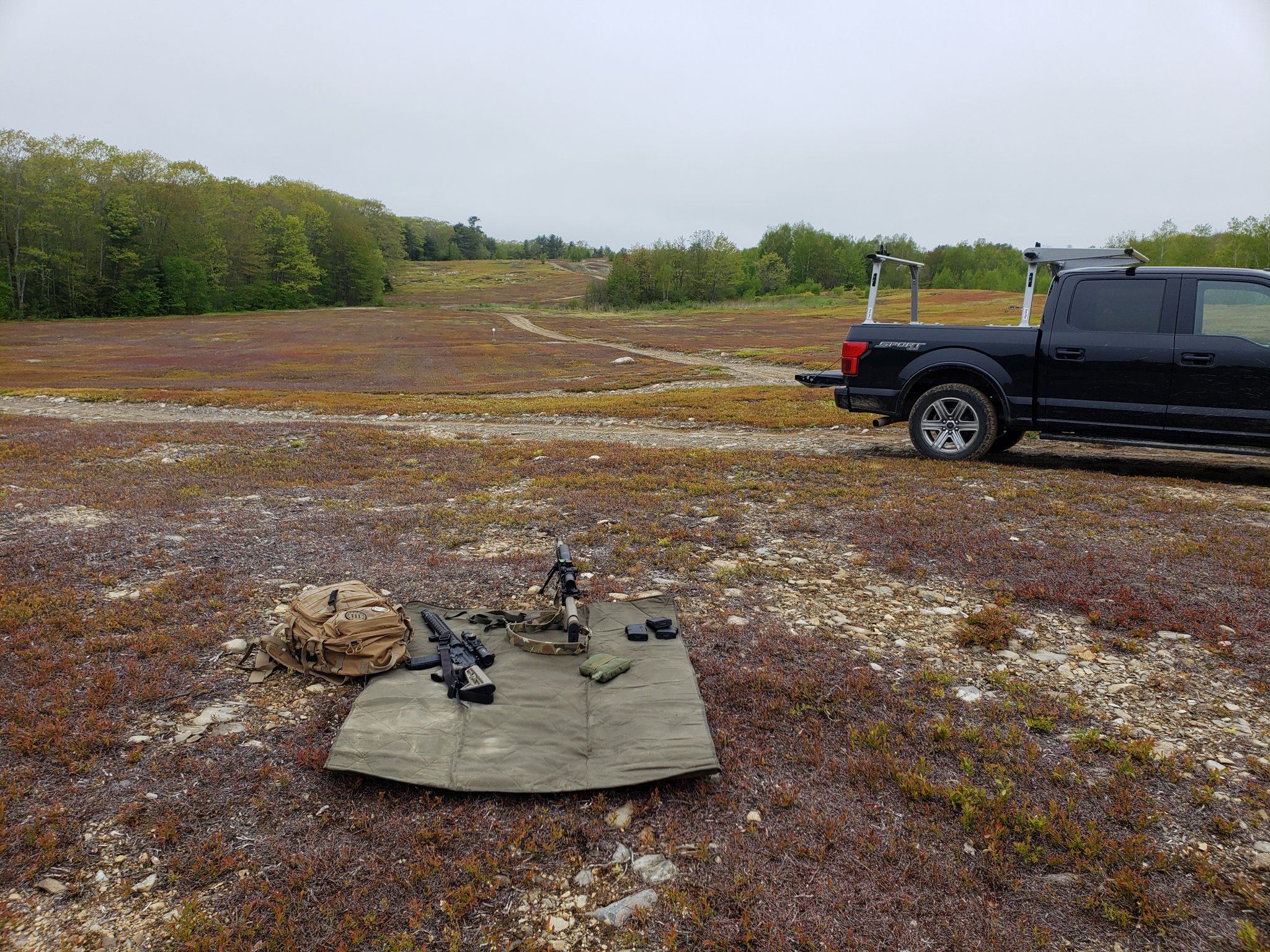

Very nice range.
Tough to judge distance in a 2D photo Im guessing at least 600 yards possibly out to 800 maybe more?
Jealous of you guys with the area to stretch out the lead.
You live in a beautiful part of the country.
Lobster off the boat is the best.
Have family further North and in Trudeauistan - PEI to be specific. Best lobsters I ever ate were "fresh off the boat" from the cold North Atlantic. Flash cooked than put on ice. They may have been a little short but man they were sweet.
Reactions: AMGtuned
Good eye! That side is 600. Turn the corner to the right and you can get 900

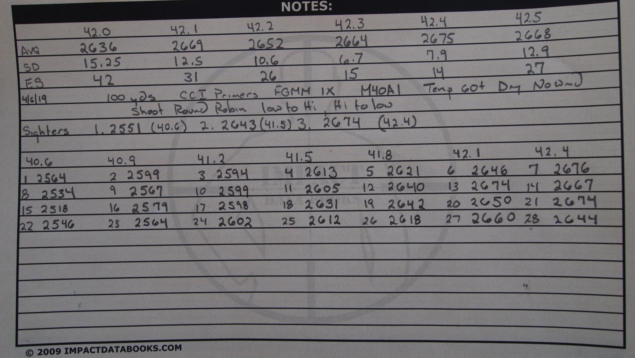

Just to put a conclusion to this....
Ran the numbers on 42.2 they looked less than my goal.
Upped it to 42.3.
Not as dependable as FGMM but it will be a good range round.
Why didnt anyone mention 42.3 at the start of this?
They will most certainly have a POI shift, but it will not affect group size.

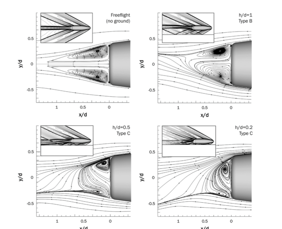

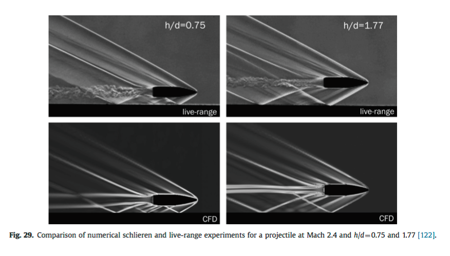

but the JIST is ... an object flying over a close surface at high speeds will have different aerodynamic drag, pressure, and shockwave interface on said body that can provide for a change in trajectory ...
In my rifles.. 5.56, 6.5-284, and .308 .. my rounds fly high with MS attached.. I have to aim .5 to .8 MIL LOW with the MS attached to get close to the MS OFF POI ...
further, if I rotate the bayonet to the side, the POI shifts away so if I move it to 3oclock the POI goes left, 9oclock right, 12 o'clock the POI shoots low... its repeatable every single time.

41.5 is a great group. 41.2 will win number wise. Really 40.6 to 41.5 all are pretty good.

It was clouds today with light snow fall so I went 300 yards......

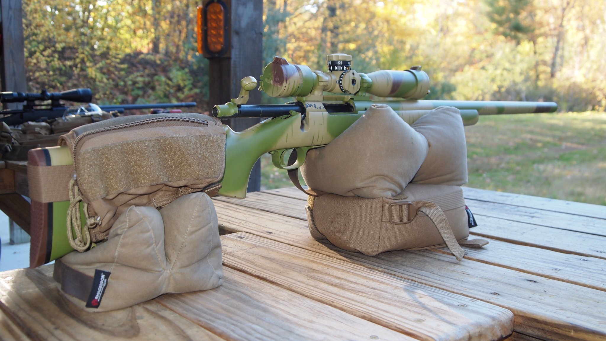

Setup rifle....
Used my suggested scope setting from my last 300 yard range session 3/0 Elevation with 1/2 MOA right windage.
Load.....
Data Book after shooting....
Shots 1-12 I used my initial data and it seemed everything was tracking low right.
For shots 13-20 I dialed 300 yards plus 1/2 MOA elevation and returned windage to 0 (1/2 MOA left).
Note the plot calls are not plot calls. seeing the impact holes with my 20X spotter are tough and the numbers in the circle start to run all over each other so I track my expected shot hole on the call sheets. I suck at calling shots my brain thinks every trigger break is centered.
When I got down range to look at the target I saw that I was not able to pick up the shot holes at the very edge of the target (marked with blue arrows. These will be my 1000 yard misses along with shots 15 and 20.
Everything else is acceptable enough. A better dope adjustment would likely center that right biased group up. Wish I had less verticle, Ill have to magnetospeed this again and see what the numbers look like. Next outing Ill use the 300 yard mark elevation with 1/2 MOA left windage.

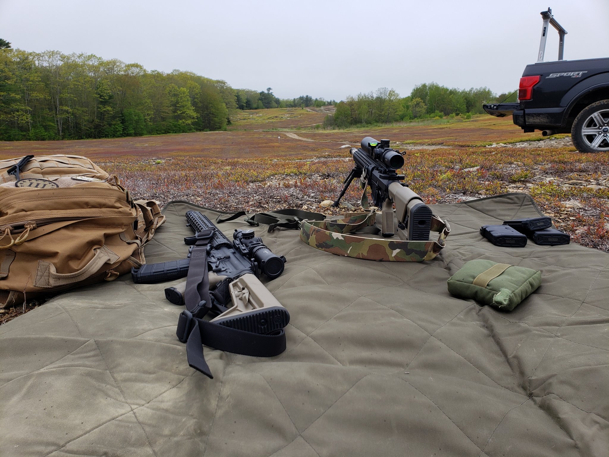

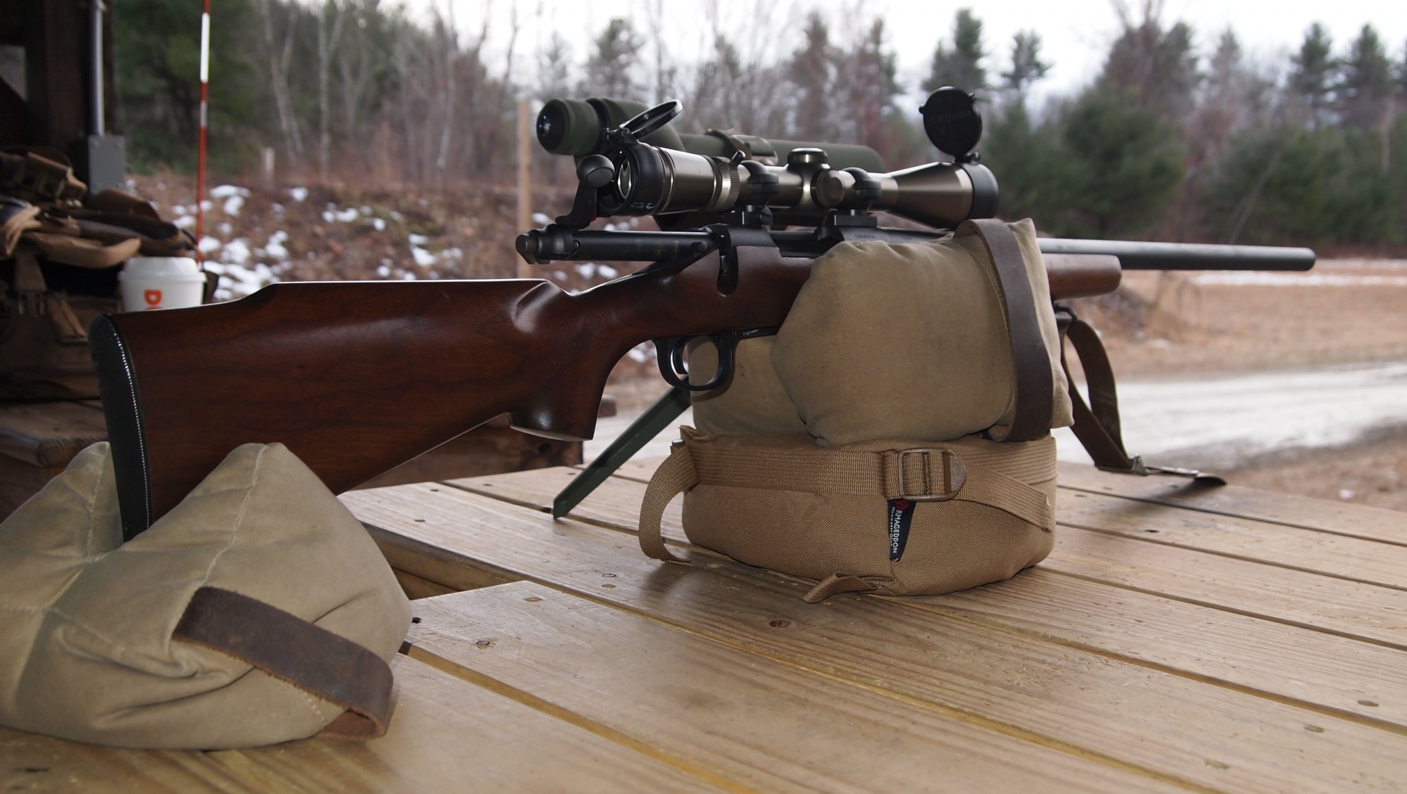

Should do better....
This is the target from the M40 at 300 yards having to hold 1.4 mils with my capped turret Leupold repro scope....
More lateral (shooter problem). Most of the shots within 1.5 MOA.
I want to bring this rifle to Sig and shoot their Reach for 1000 class using just holds.
To get beyond 600 or so Ill have to dial my magnification from 9X to approx 4X so as to "double" the reticle. I dont want to change my zero because the shooting beyond 300 is limited and I think Ill be able to make do at 4.5X.
Soldiers in WWII made it work at 2.5X.
