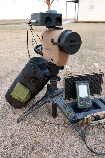

Got a pic? I’d like to see how u r using it

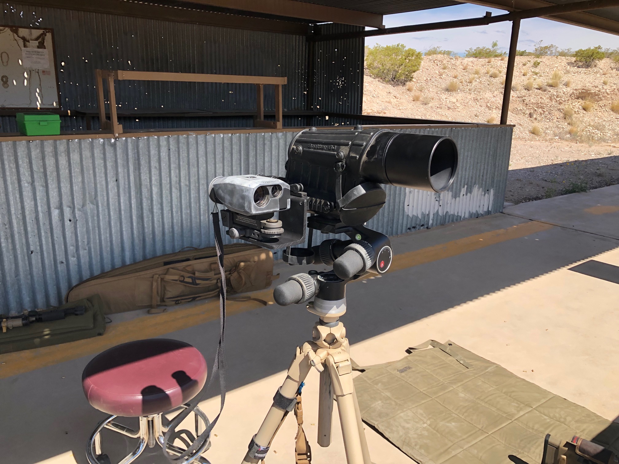

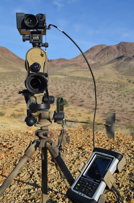

The simple solution is a L bracket with 2 QD pads attached. Place the spotter on the short leg and the LRF on the long leg with the long leg horizontal. Now you can adjust the spotter in the vertical plane and the horizontal.

View attachment 7562746View attachment 7562745

It is, but it just confirms what I was saying. It’s a co witness, it has an offset. There is no way to point the spotter at a target and the LRF be exactly at the same point.....until you adjust it on the mount. You made it seem like they were always the exact same.
