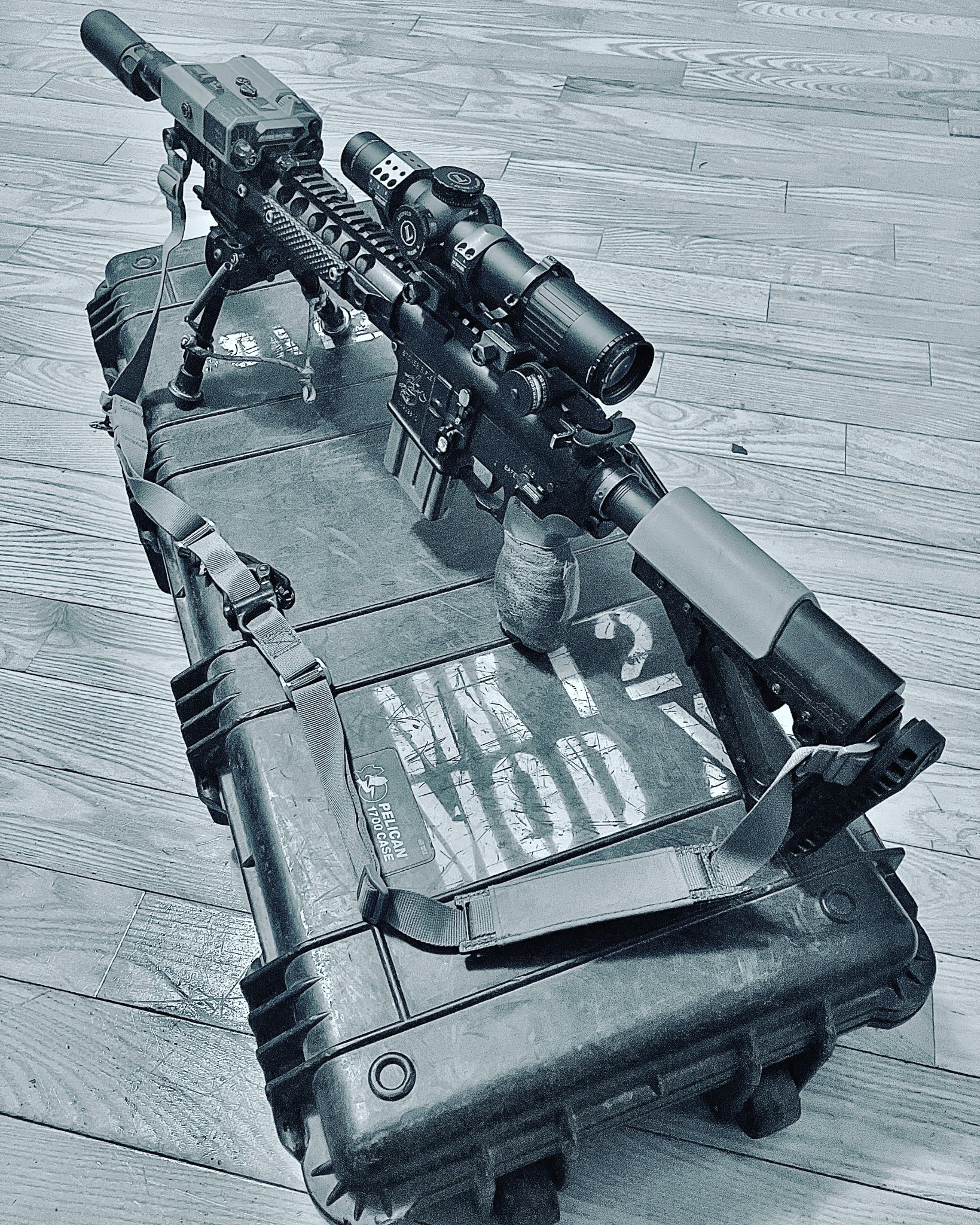

Test Bed
Notes on the test bed: Standard Knights SR15 lower, the Hodge upper was disassemble out of curiosity as I wanted to inspect the barrel extension/receiver fit. I have found that along with the general quality of the barrel, the barrel extension/receiver fit is paramount to accuracy and precision. And lets just say It’s fuck’en tight!
I reassembled the upper with a KAC URX3.1, the standard Hodge rail is sound but not aesthetically pleasing to me personally so I switched it out. I mounted a Leupold Mk6 1-6x w/CMR-W, which may sound like an odd choice and I agree at 1-6x is a bit light for truly effective DMish work in this day and age but the 0.5 MOA center dot makes great for 100y grouping. The parallax is technically set at 150y but I notice no discernible effects at 100y. Additionally I like only having 6x, I can’t really tell exactly where my impacts are so it’s kinda like shooting blind until your done, which is mentally preferable for someone as excitable as me.

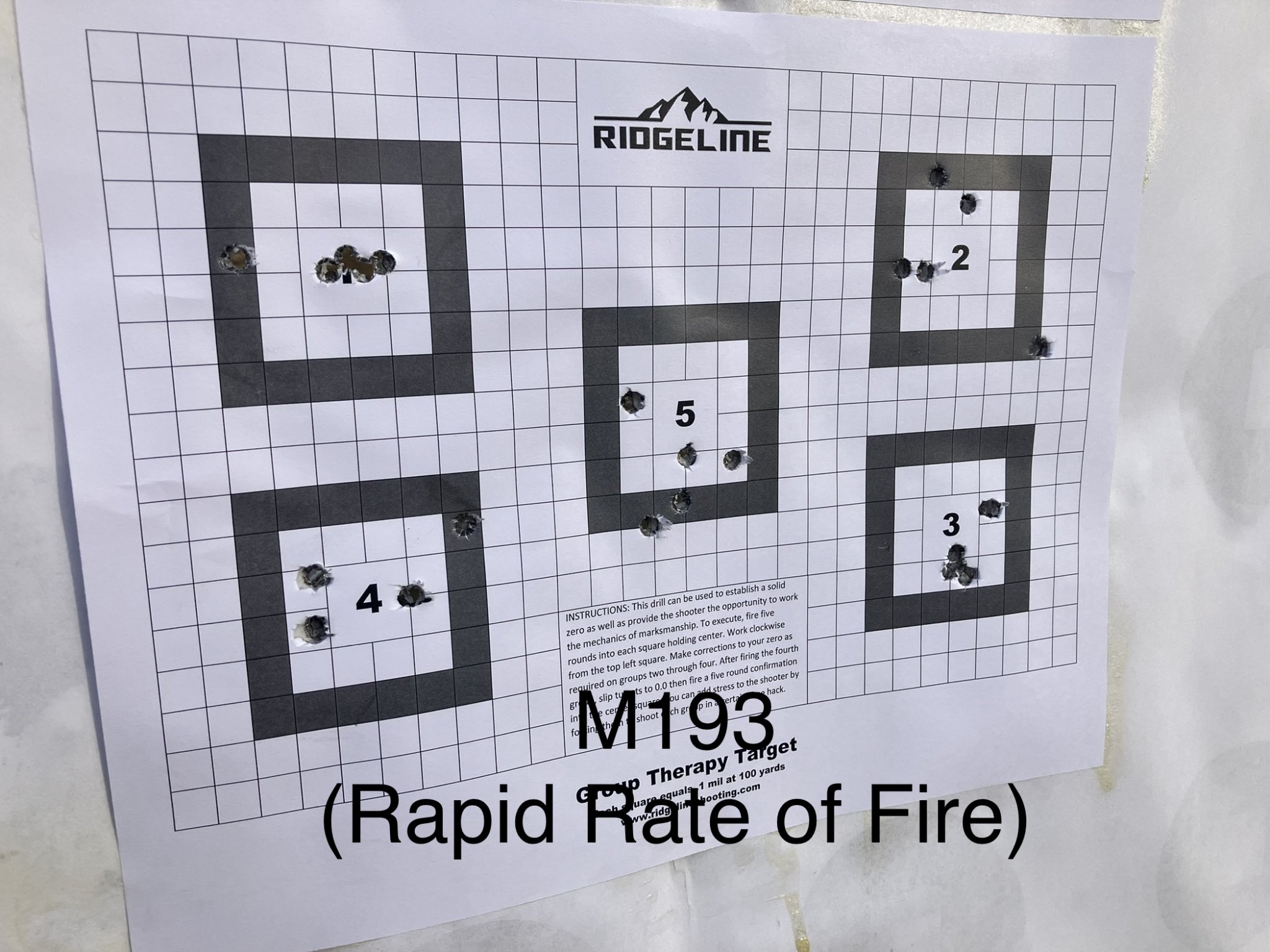

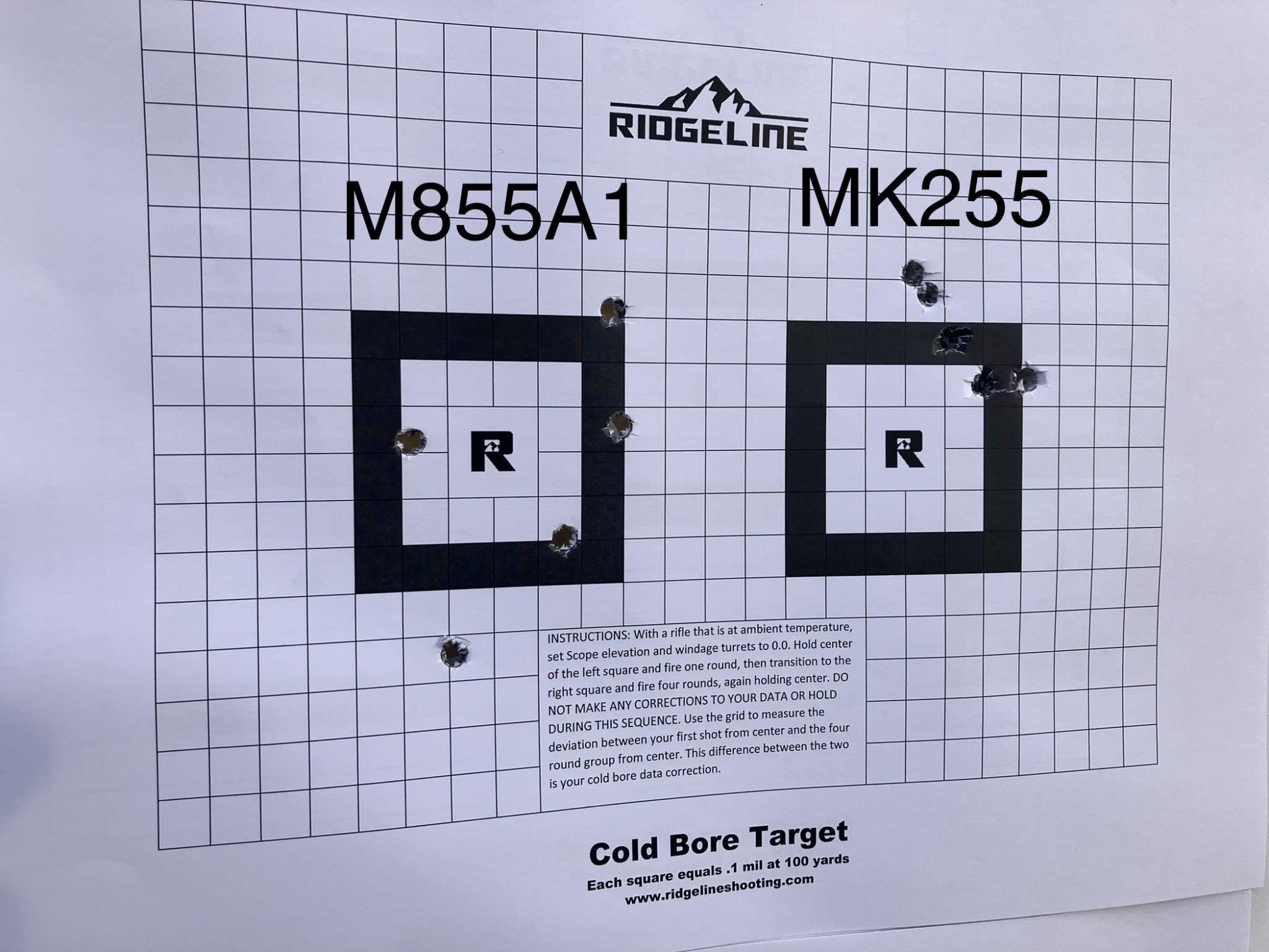

The initial review I shot here took place about an hour before our Advanced Precision Class. I ran about 20 rounds of some steel cases commie bullshit through her to test function and foul the bore a bit and get rough zero.
I then let the gun cool and then shot a quick series of 5 round groups using some standard DODICs. Rate of fire was approximately 5 rounds a minute with about 5 minutes between groups. All shot prone off gravel with a Harris bipod and Armageddon rear bag. Environmental conditions are as follows:
Station pressure - 28.22 inHg
Temperature - 21F
Relative humidity - 41%
(Grid is 0.1 MRAD)
(The red “x” was a called shot)

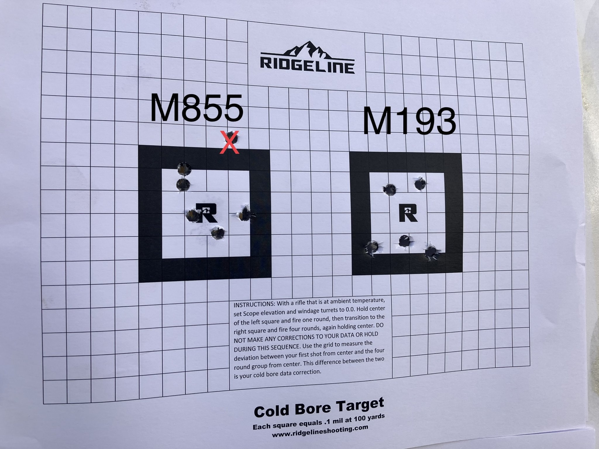

The initial 5 round groupings showed some interesting trends. Standard ball seems quite capable of about 0.4-0.5 MRAD and with little POI shift which while not particularly impressive is more than adequate to pay the bills at 500-600y. The solid core A1 didn’t seem thrilled to be there. I suspect this might have been due to the alleged “tightness” of Hodge’s barrels/chamber and the solid copper core of the A1. The Mk255 also performed within those standards but with a slight POI shift, which wasn’t surprising for frangible.

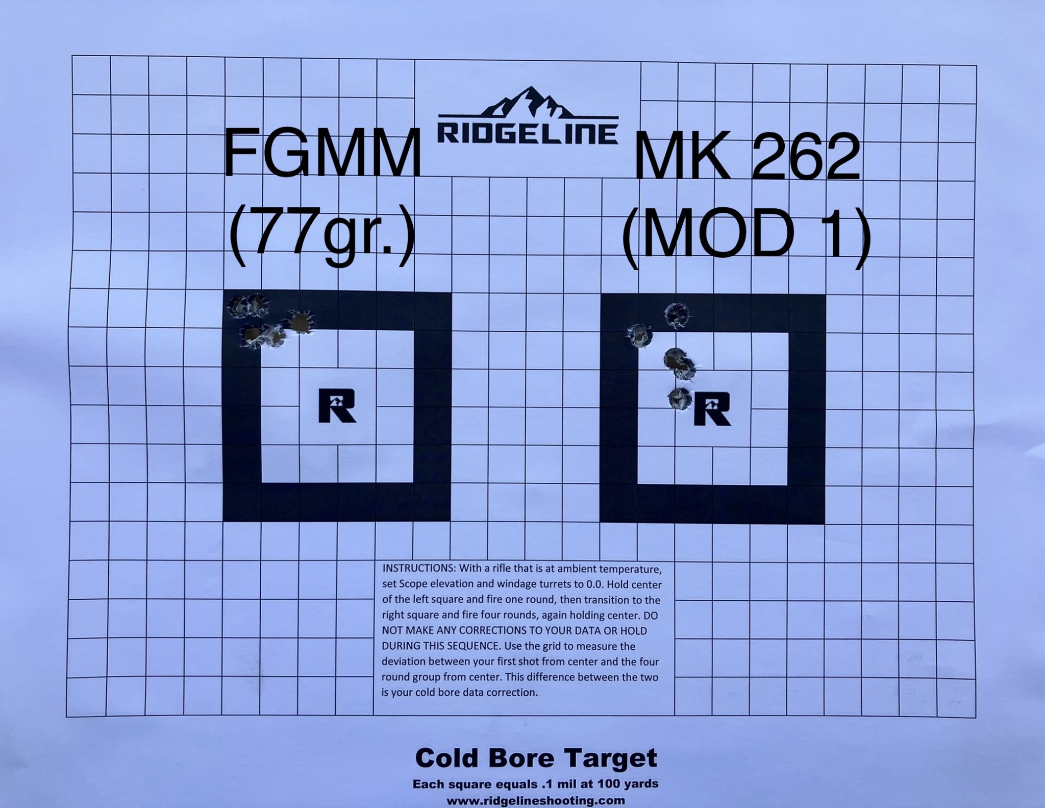

Following this I was curious to see if the barrel would exhibit any POI shift under the rapid rate of fire. The following 5, 5 round groups were fired in slightly less that 60 seconds, all with M193.
You can see it’s probably not my best work being rushed but fairly consistent POI in regards to the earlier slow fire groups.
Lastly I want to see what some match/special ball might produce.
The FGMM performance was splendid as expected and the Mk262 gave a heart warming show as well. Simply put the performance of QUALITY match ammunition is a notable thing. Both interesting trended high left in their POI, I made no adjustments in elevation or windage throughout the review.

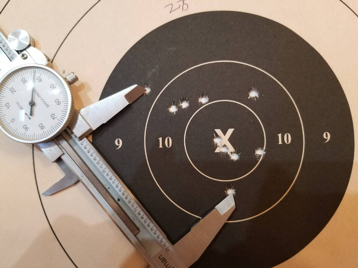

In 2010, my original SOCOM barrel with the “11/03” date-code produced a 10-shot group fired from a distance of 100 yards that had an extreme spread of 0.90”. That group was fired from my bench-rest set-up using match-grade hand-loads and a high magnification scope.
My newer SOCOM barrel with the “02/18” date-code produced a 10-shot group fired from a distance of 100 yards that had an extreme spread of 0.93”. This group was fired off of sand-bags using match-grade hand-loads and a high magnification scope.

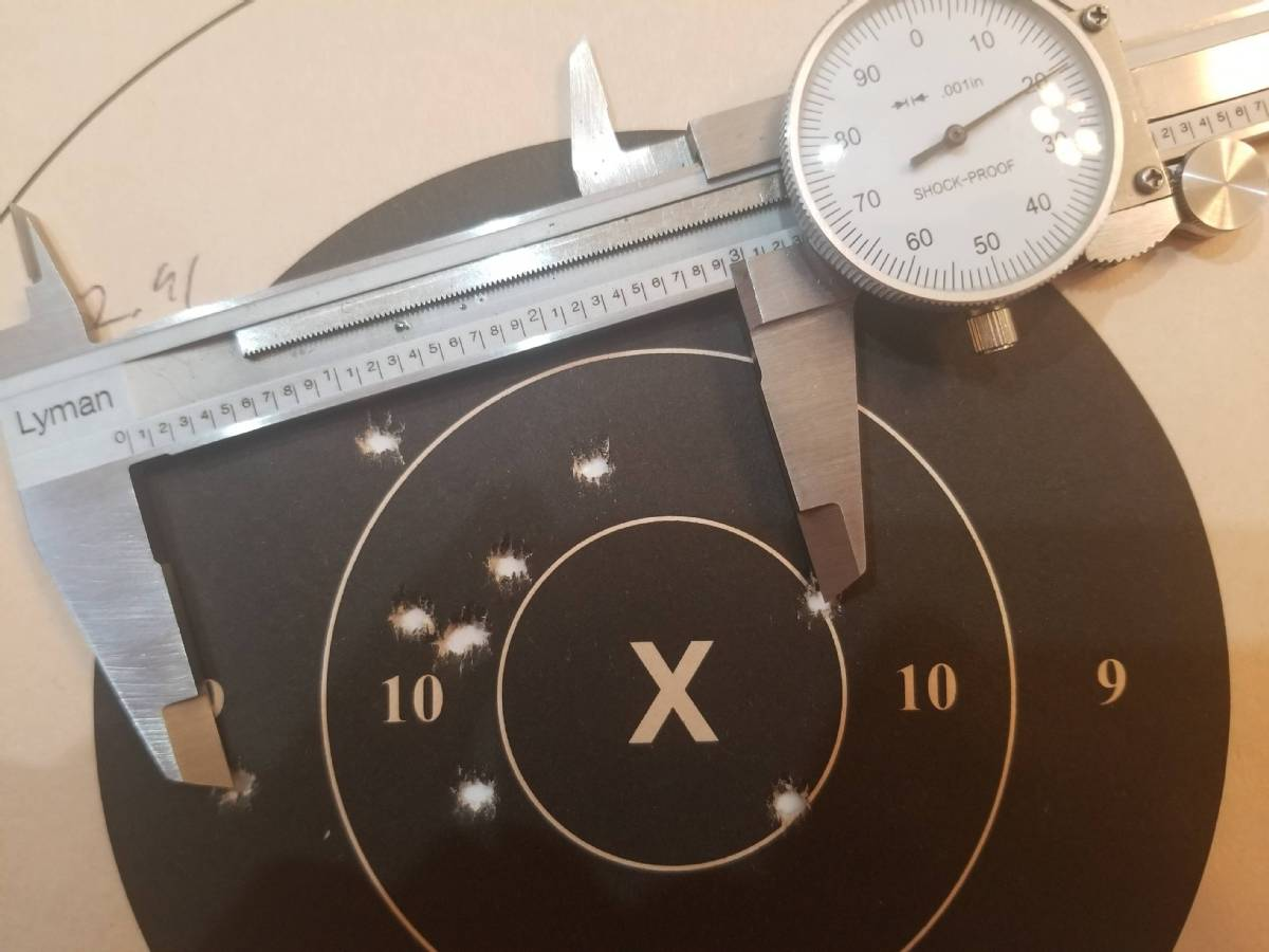

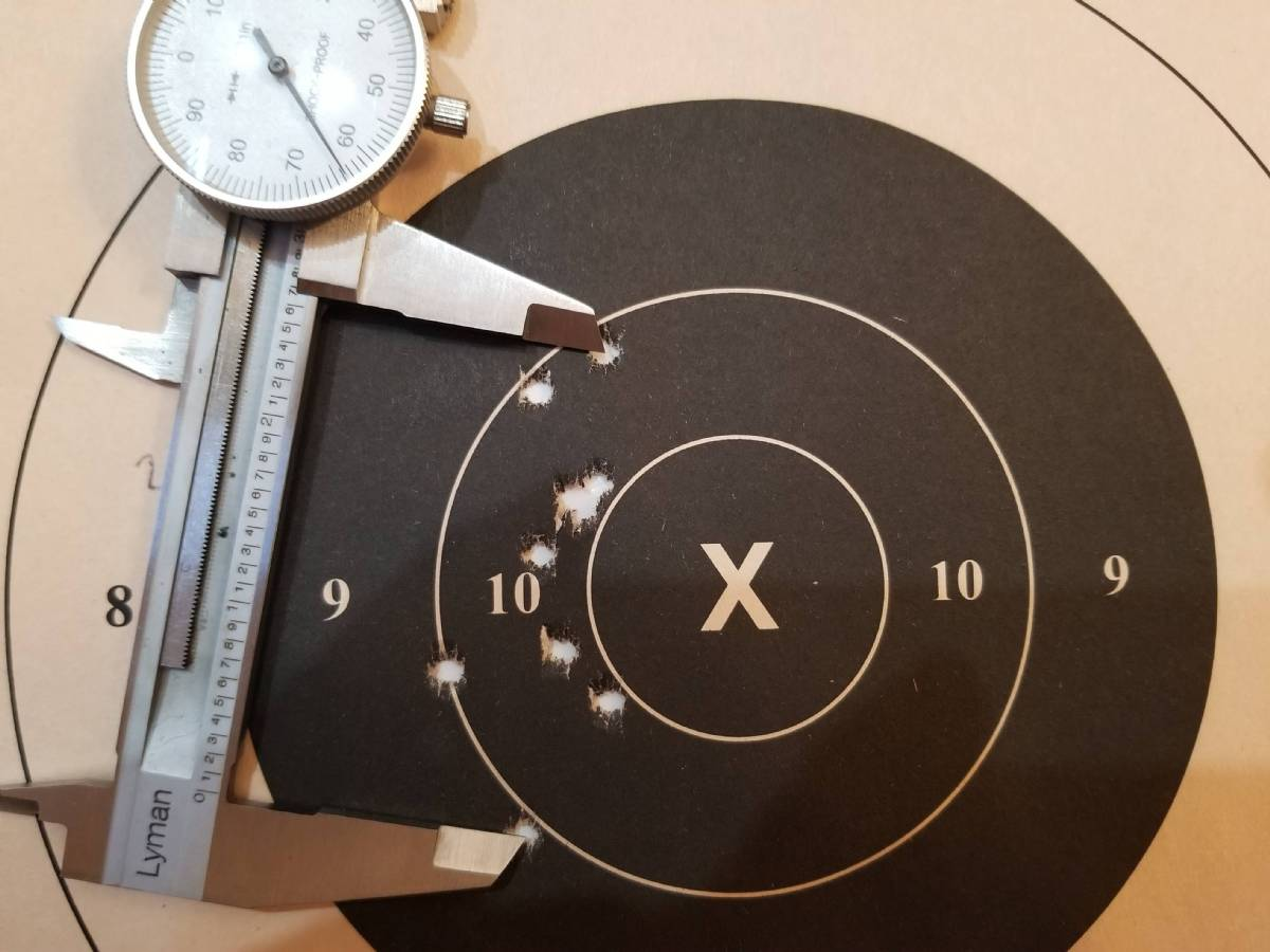

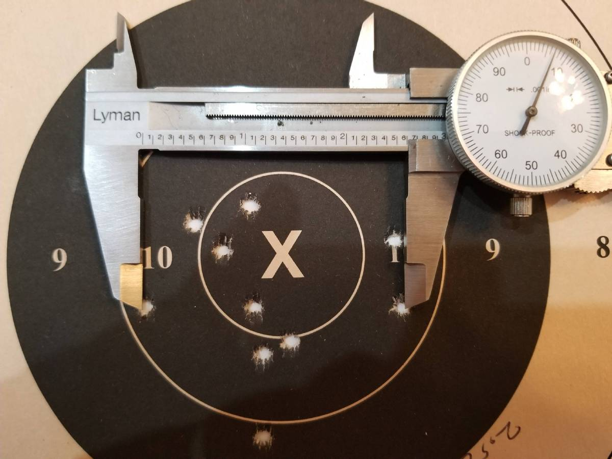

Stuck On Stupid Much? I fired the 10-shot group pictured below prone off a bipod using a semi-automatic AR-15. The group has an extreme spread of 0.54 MOA. Get back to me when you can post a pre-existing link showing that you've shot a smaller 10-shot group than that using a semi-automatic AR-15 off a bipod.
Oh wow, once again, comparing a Lothar Walther to an FN CHF. Dude, you’re a clown. Good thing Jim doesnt even know or care that you exist🤣

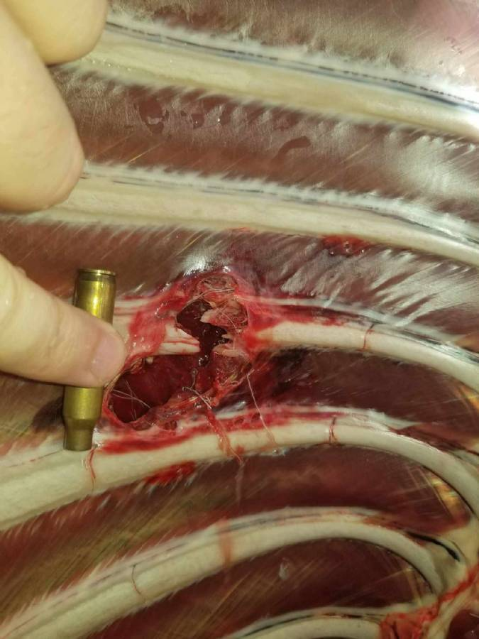

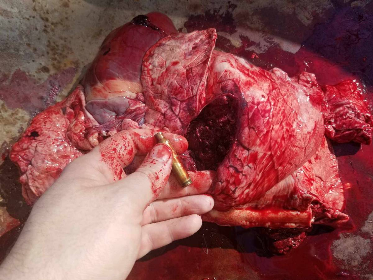

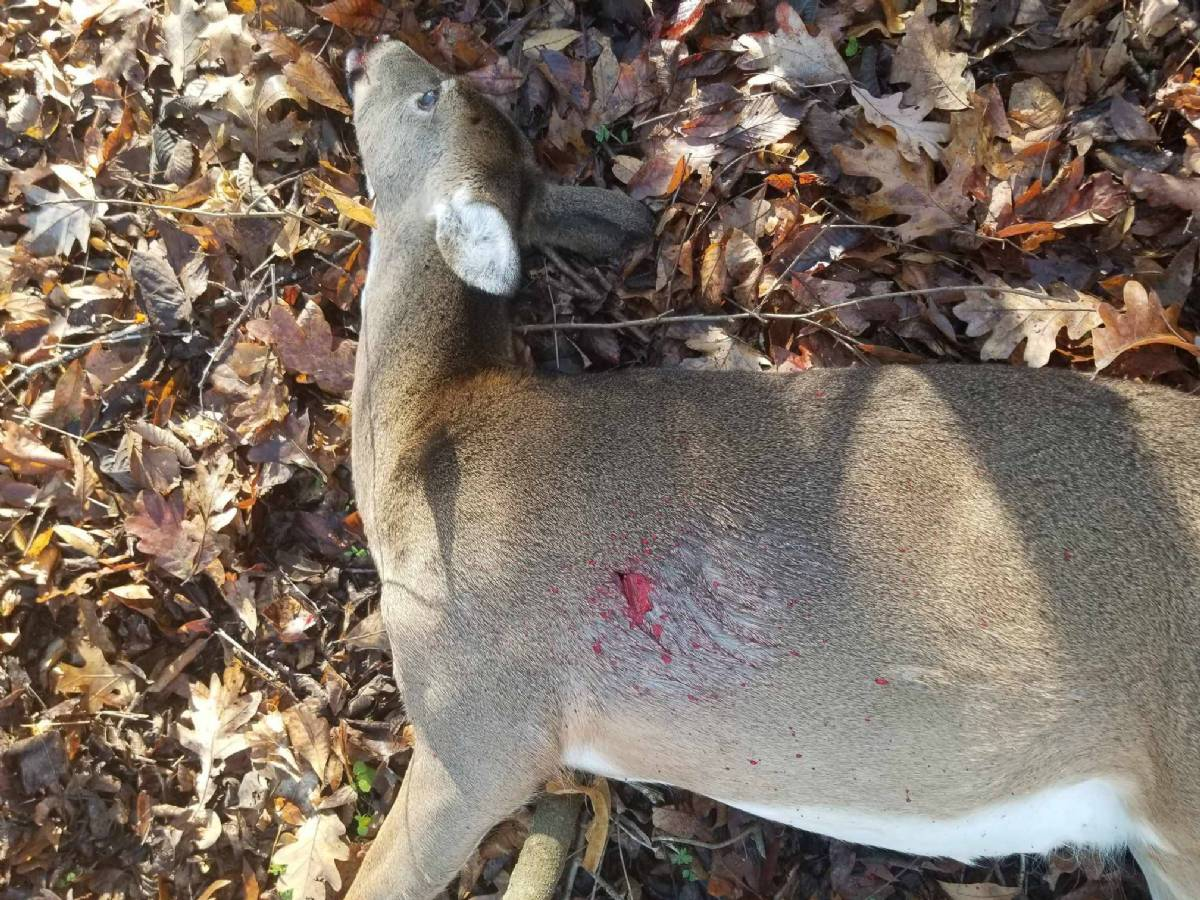

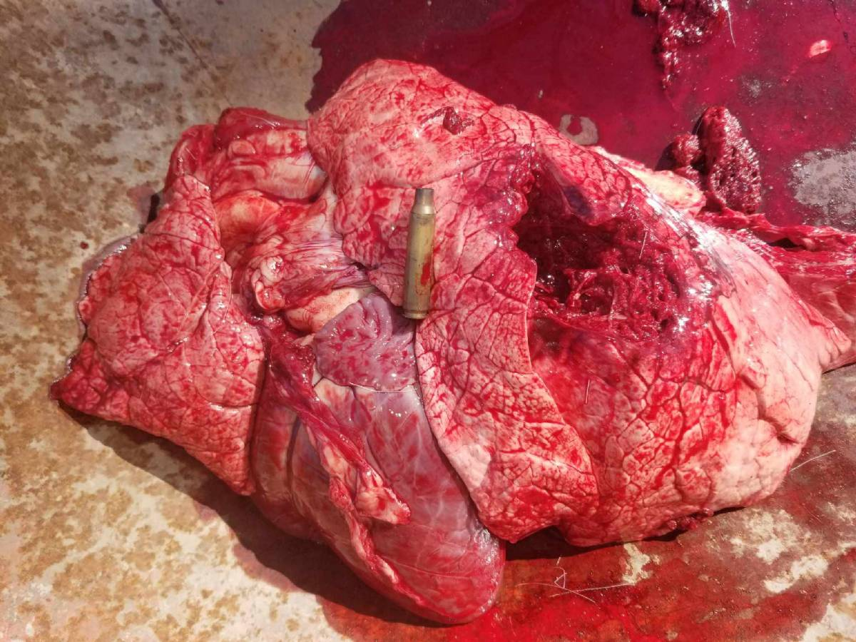

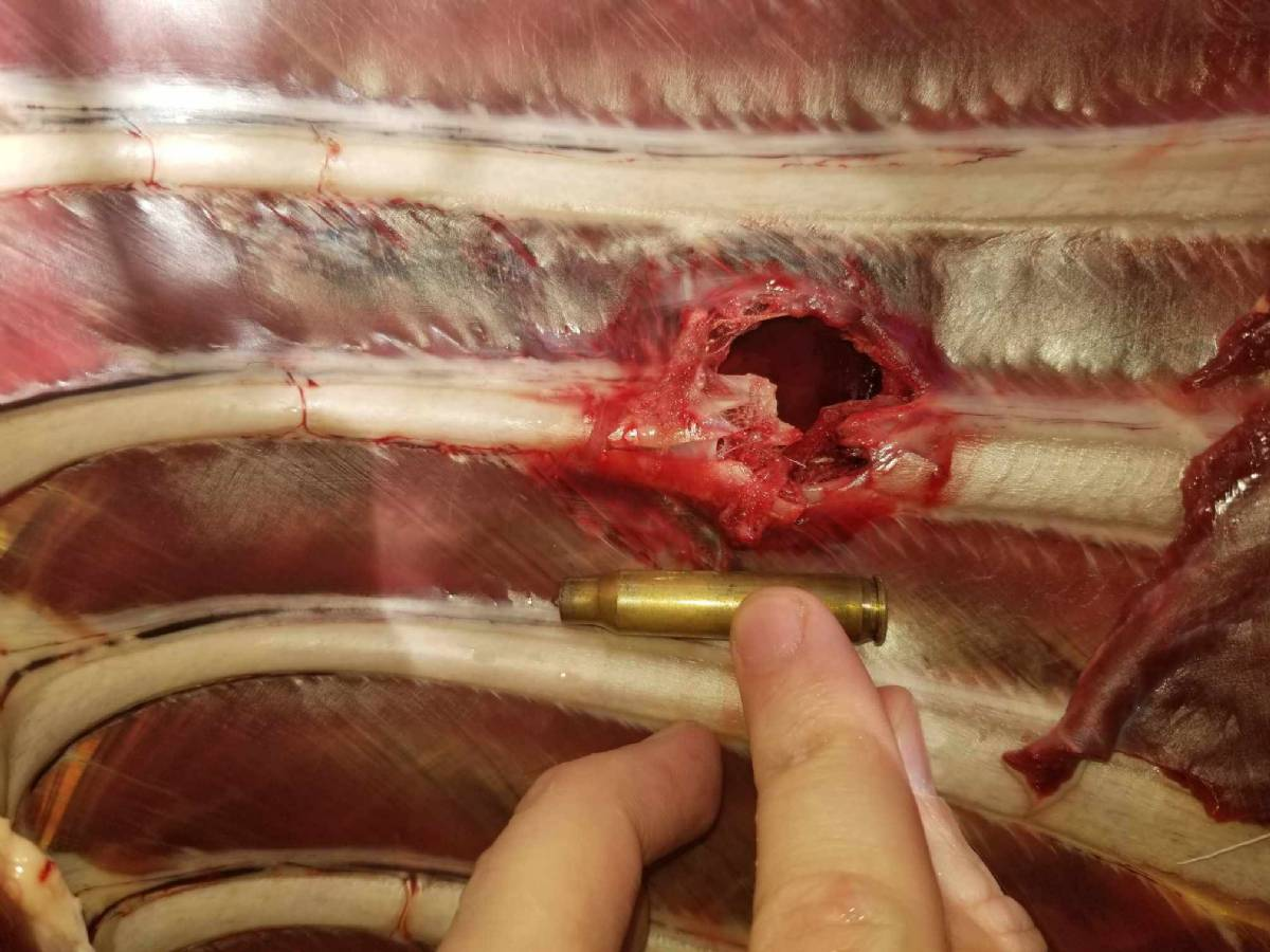

I know this comment is quite late to the game, but I spent some time training with guys from a CIF company (now called CRF i think?) and they said that A1's was like the hand of god when it came to terminal ballistics.
I won't say "hand of god" but its probably one of the nastier 5.56 projectiles and with a frag threshold down around 1900fps it brings a lot to the table for short barrels. M855A1's precision capabilities are a bit inconsistent unfortunately and limit it to a 400 meter-ish round in my opinion, which is fine for GP but lacking for SPR/DMRs. I typically use 10 round groups for rough evals of ball ammo and 2-3 MOA ball park out of Mk12s and Mk18/URGI's seems to be the average variance among all the lots I've shot over the last decade. I've seen early (2012) lots hover around 1-1.5 MOA out of but I've seen lots in the 4-6 MOA. Even with high end match barrels often times you'll see 8 or 9 rounds stack up in a 2 MOA-ish group and then 1 or 2 rounds zip out to bring the group to 3-4 MOA for no apparent reason, its an aggravating load to shoot sometimes, Lol.

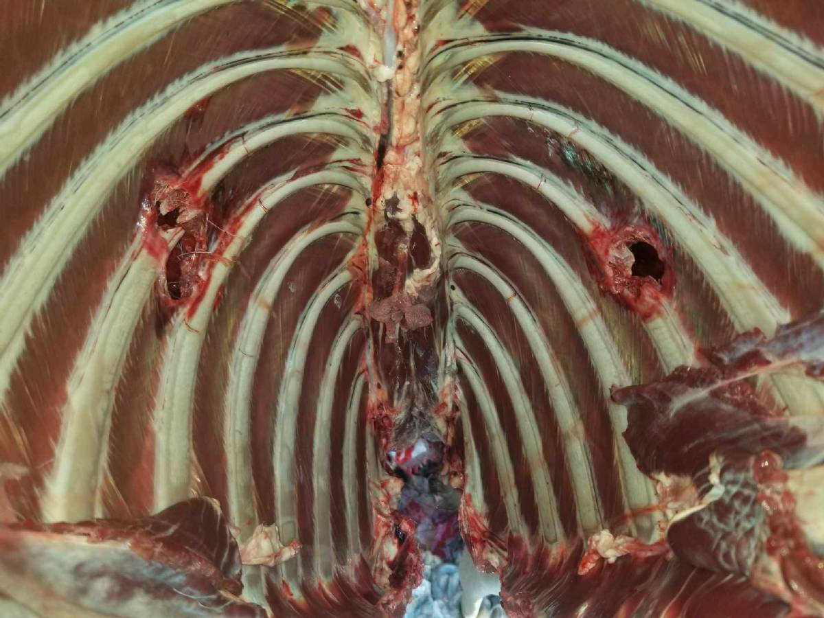

318 was about like Rudy described his A1 stuff. Firing 10-shot groups, 7 out of the ten would be 1” to 1-1/2”, and then there would be three rounds that would kick the group out to 3”. Happened every time. I stuck with 77gr.

I shot a doe which I estimate at 100-120# on the hoof. The shot was taken with an 11.5" 5.56 SBR, suppressed. The distance was 90m. The deer ran 125m and promptly expired. At the impact site there was foamy blood with chunks (lung tissue). Within about 20 feet of where the deer lay, there was significant blood trail. I did not bother tracking all of it, because I could see where the deer piled up. The reaction to being shot was a shoulder twitch (or maybe that was impact?) and a little "startle kick" and then the deer took off running, keeping pace with the other 2, until it didn't. It just collapsed and died. The structures impacted were ribs upon entry, both lungs, and ribs upon exit. The angle was directly perpendicular to the shooter. Ammunition used was MK318 MOD 0 SOST.
This is the exit, picture taken without moving the animal at site of recovery:
This is the entrance. Note the immediate appearance of expansion and disruption:
This is the lung tissue. Note the appearance of copper and lead fragments and small secondary channels caused by same (maybe not visible in photos):
Fragments were recovered from lung tissue (very small, not photographed).
This is the exit. Note fragments clearly visible embedded in rib and ribcage, as well as small secondary wound channels caused by other fragments:
Projectile entered from (photo) Right to Left:

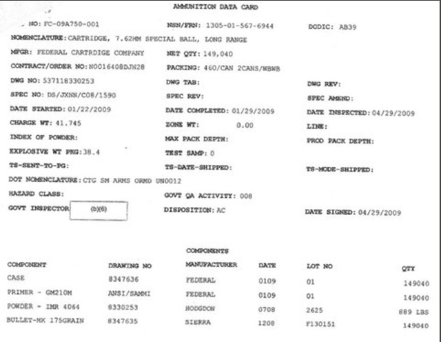

Has anybody been able to determine what powder is used in FGMM 77gr? That is a pretty good target by the OP. Maybe I bought one of these barrels so getting close to FGMM seems the way to go. thanks.
While exceptions exist, ammunition manufacturers typically do not use “canister powders.” Unless you can get the build card for the ammo, you’ll never know for sure.
Buy some FGMM and shoot it over a chrono, from your barrel. Pick a powder that is expected to deliver this velocity. Duplicate the velocity with your handloads. But, be aware that your barrel might not like the FGMM as much at the OP’s barrel.
As I said, exceptions do exist…
This is the entrance, picture taken at site of recovery, after rolling the animal to expose entrance:
I can’t see any of your photos for some reason.
I found myself curious, so I fired 4 ten shot groups, consecutively (letting the weapon cool, though), yesterday with mk318 mod 0 sost. I changed my position behind the gun for one of the groups, and you can see it shifted left and shows a bit of vertical movement...no butterfly shots here, though. The weapon used is a Hodge mod 2 with a KAC 11.5" barrel and URX4. It is topped with an nx8 1-8 in a Badger c1 mount. The muzzle is tipped with a MAMS, and this range session saw a QDC 5.56 can in place. The groups were fired from the bench with a bag under the front of the rail, and under the buttstock.
Distance is 100 yards.
