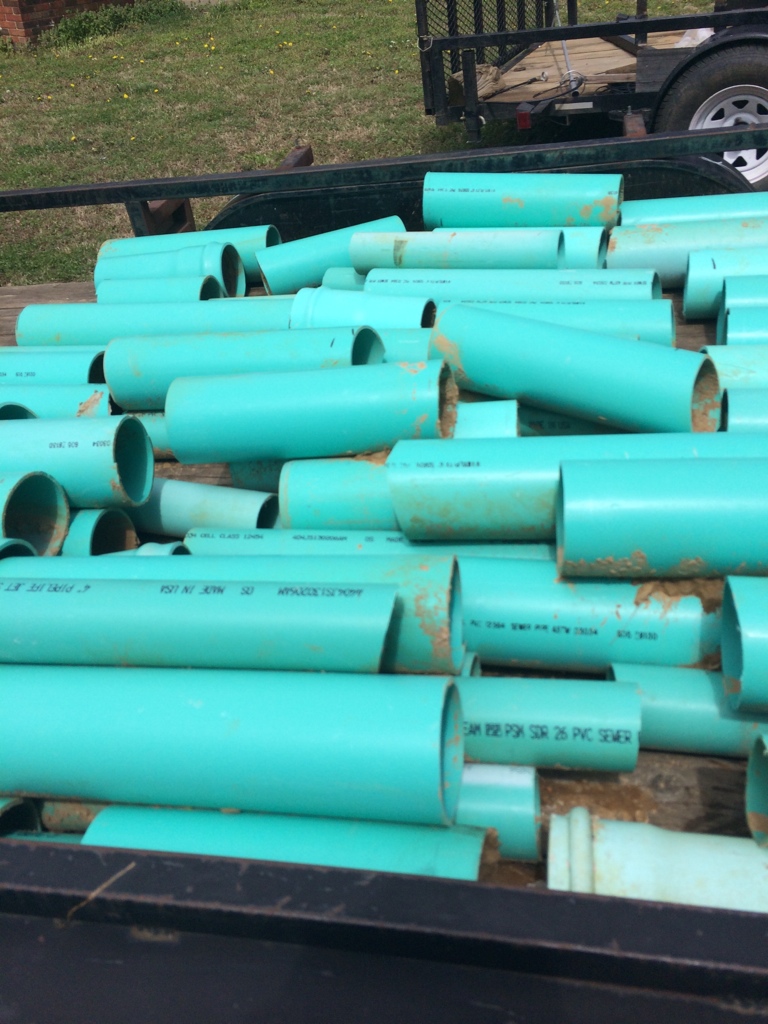

I came across some 6" pvc pieces. I am located about 35 miles north of Memphis. If anyone wants one it is free if you pick it up. I won't ship them.
--Daniel
