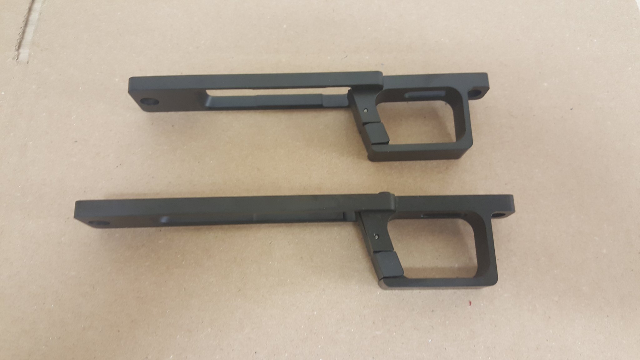

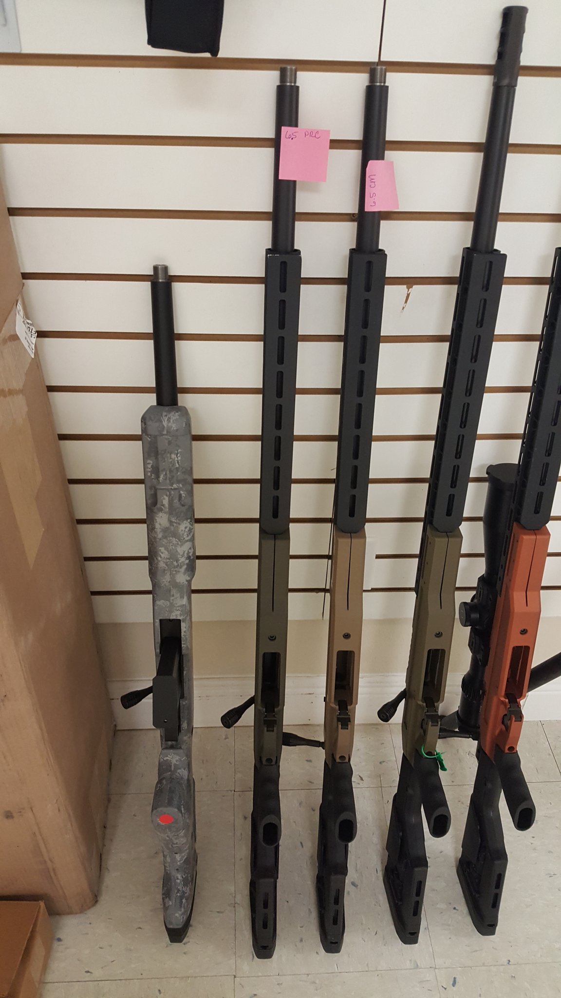

While we wait for R&D to finish that up; here is the DBM for the Kopis (Top) and Aspis (Bottom) that are ready for Sentinels.
4130 vacuum hardened to 45 HRC
Sincerely,
Theis

I’m bummed I didn’t get a chance to see this at Shot. I didn’t realize the top floor was done early. I didn’t get to the show until Thursday morning. I was really looking forward to checking out the finished product in person.
@THEIS
What does that 18” .308 in the Sentinel weigh?
Hi,
As pictured it is 12.6 pounds with the 18" MTU barrel.
Sincerely,
Theis

Still some things to work out.....The Sentinel has a lot of shape changes and geometrical shapes so it is hard to get flat things to line up evenly, lol.
Sincerely,
Theis

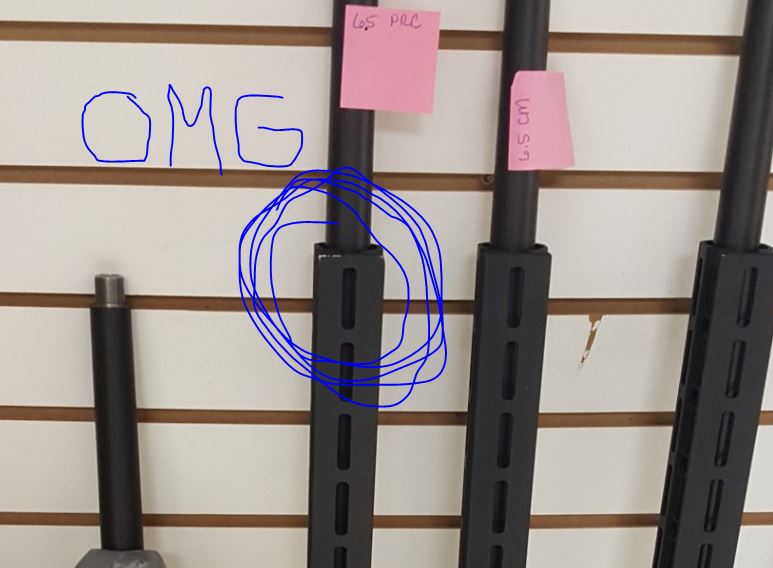

@THEIS
How the hell did you manage to scratch up that Birdsong?!
Or is it concrete residue?
Hi,
LOLOL Neither....those handguards are anodized, not birdsong..but we have been able to wear some marks in the birdsong on the interior section of receiver and bolt friction interface.
Handguards and Chassis are being transitioned to Cerakote since they are 7075 Aluminum. The wear samples are showing cerakote is harder to get off than the anodizing...and we can control the cerakote process; unlike the anodizing process.
