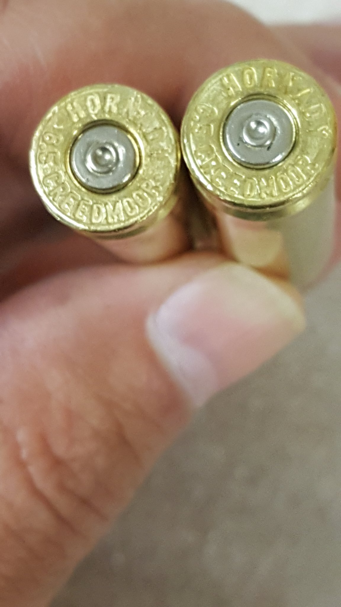

Hi,
Tick Tock, lolol.....
Will post them as soon as we finalize testing how different firing pin diameters truly affect (If any consistent affect at all) MV and pressures.
Sincerely,
Theis

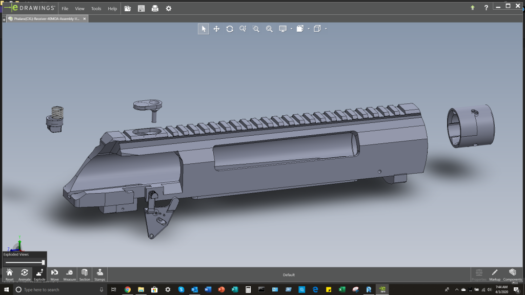

And, if you want to really get cute, make the hole spacing for the pic rail the same as MPA. Then the gray ops forward grip will fit on it.

So I’m going to assume those crater pics were a small firing pin in a big firing pin hole.
That’s certainly what it looks like.

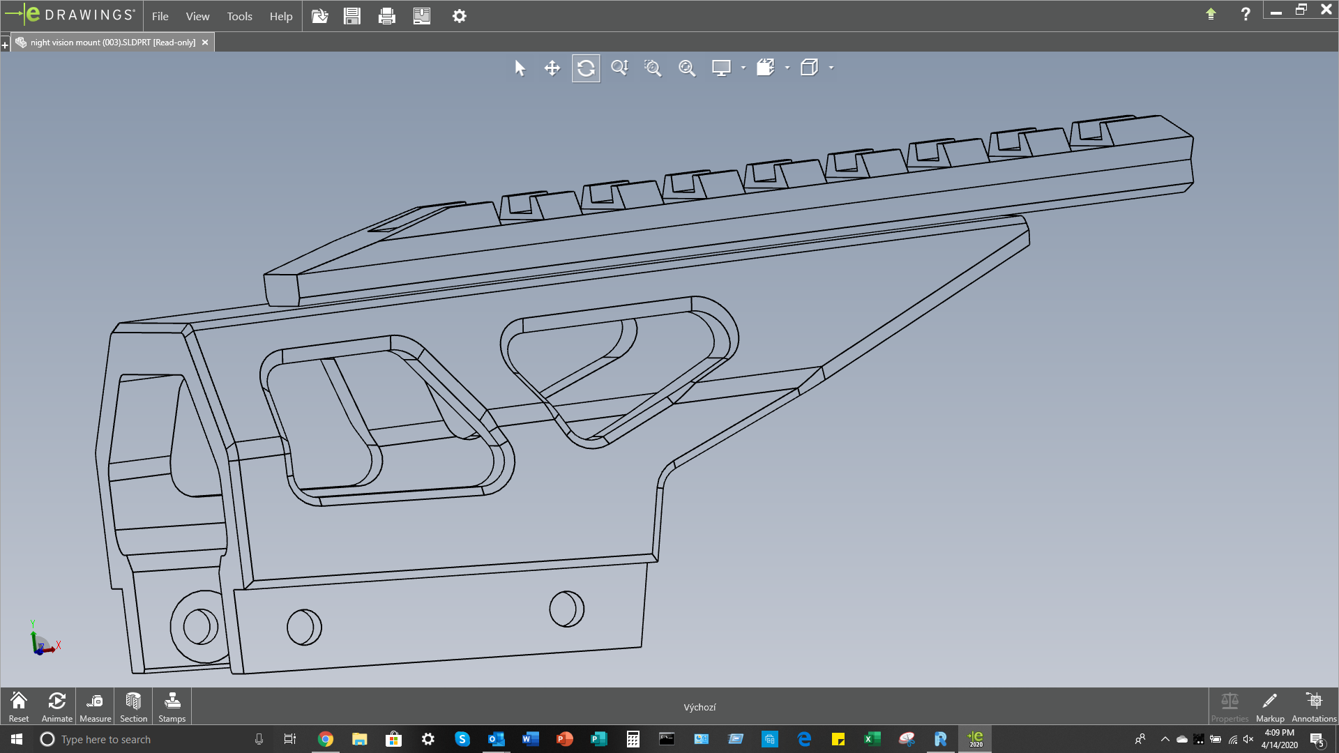

Make it mountable forward or backward facing. And anywhere along the forearm the user wants it (if you haven’t already done so). And you have a winner.
i can see the forward and backward depending on the auxiliary equipment (but only if the rail isnt long enough) but what is the reason for reversible?
Hi,
More than likely so end user can have more control of the NV/Thermal "connection" to the rifle scope.
Notice on the NV mount above that the rail extends more on one side than the other.
This is by design in order to allow a more perfect mating of the rifle scope to NV/Thermal.
So being able to flip the NV mount around helps facilitate that connection.
Sincerely,
Theis
Reactions: MarinePMI
in theory wouldnt a longer rail accomplish the same
if the NV mount had a rail that went from the muzzle to the receiver (although not a smart idea), there would not be a need for a reversible mount?
Rifle length rails get expensive, as well as challenging to manufacture accurately. Plus, they get in the way sometimes, and can add extra weight for areas rarely used.
Reactions: THEIS
Hi,
But then you have like 14" of wasted space and weight because accessories only take up x amount of rail space themselves, so instead of having all that wasted space and weight; the NV mount just needs to be move-able in regards to where it mounts...being able to flip it around allows the end user to even more custom fit the mating.
Sincerely,
Theis
average weekend warrior complaining about rifle weight...just had to (hopefully no offense taken @MarinePMI)
after looking at this picture again for a minute...how did they squeeze his head in that helmet
Besides the nvg connection it serves 3 other minor purposes:
1: many use nvg rail as a hand hold. Being able to reverse it lets the longer end extend further back for user preference choices
2: occasionally you’ll find yourself in some sort of port or hole you only have room to rest the barrel in. For this reason, I prefer the nvg rail not to extend past the end of the forend as it can make the rifle “taller” further than it needs to be. This is a rare scenario.
3: unfortunately, aesthetics. While this doesn’t matter much for mil/le as they shoot what they are given, if you are doing civilian sales, aesthetics matter. We see it mentioned 100’s of times here on forum “I like xyz rifle, and it’s stupid to say, but damn it’s ugly.” Hobbyists have to like to look at what they are shooting. Something as simple as being able to reverse and nvg rail adds options.
Also, just from a procurement standpoint with LE agencies, the more “options” you have, the better it sounds. So with something as simple as making the same bolt pattern so it’s reversible, you have a super cheap way of adding and “option” to the list in your brochure.
