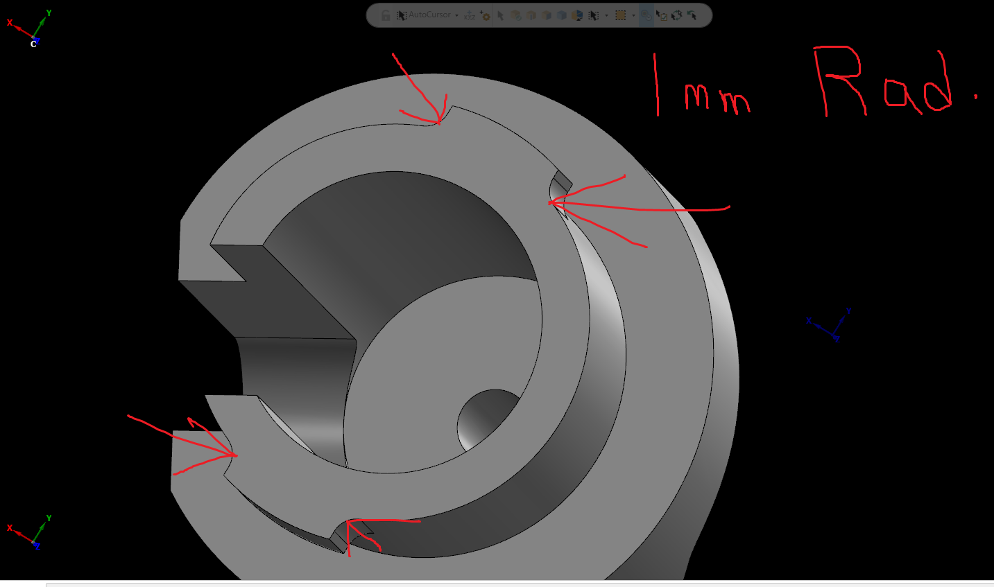

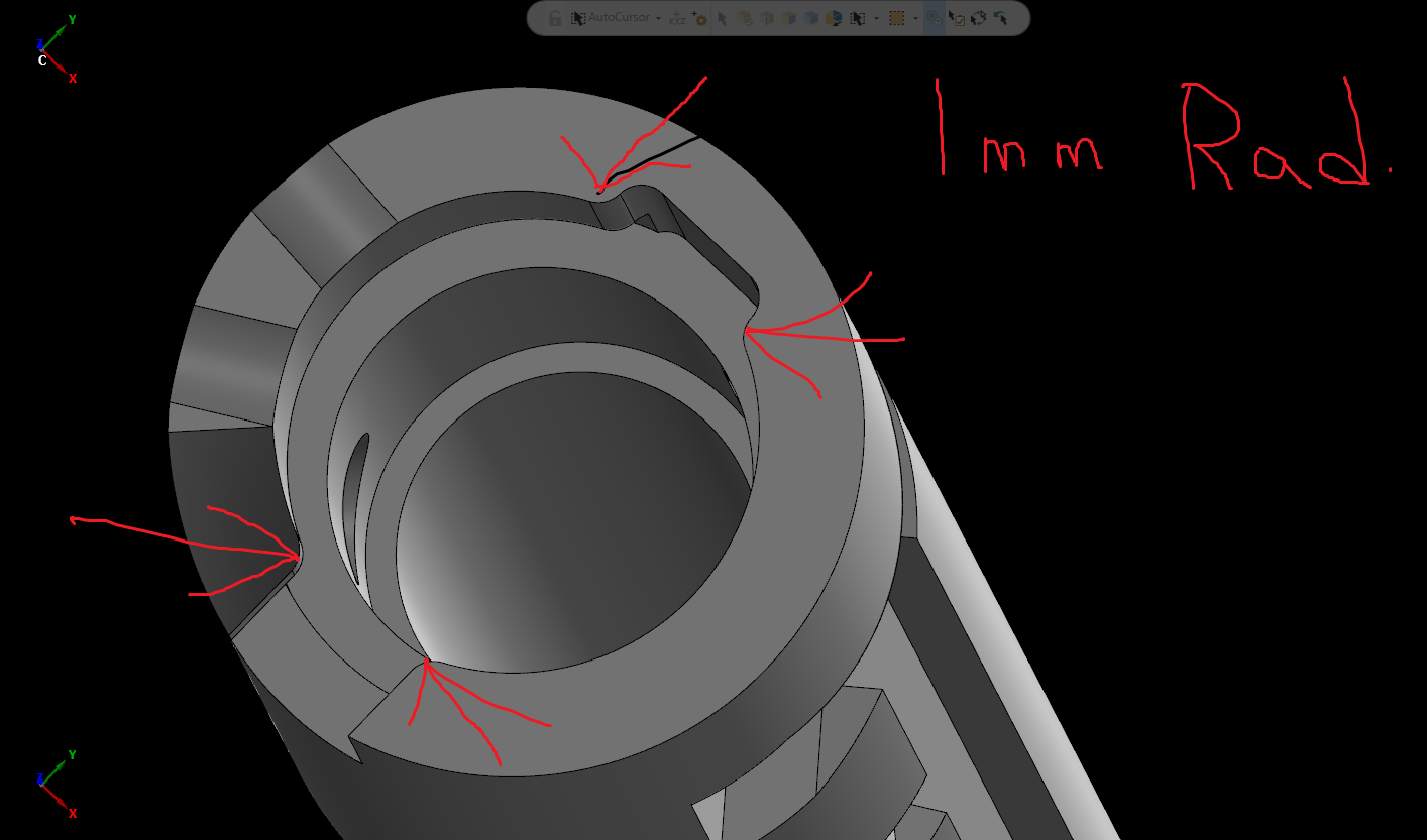

Finishing up on pure cosmetics of a few relatively unseen parts of the rear of the bolt and the rear bolt piece cover...
Only time either of these will be seen is when the bolt is completely disassembled for firing pin removal.

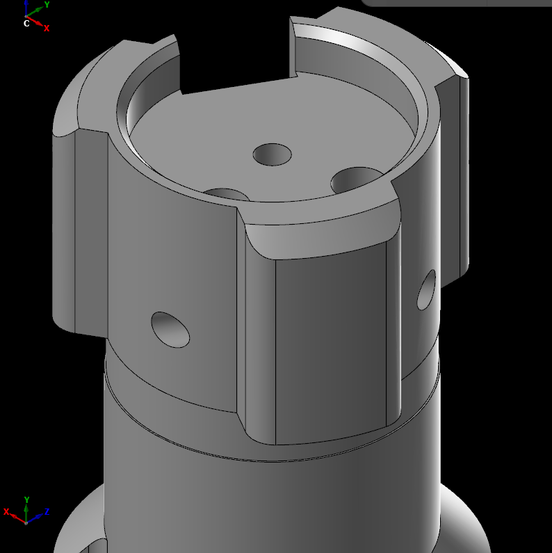

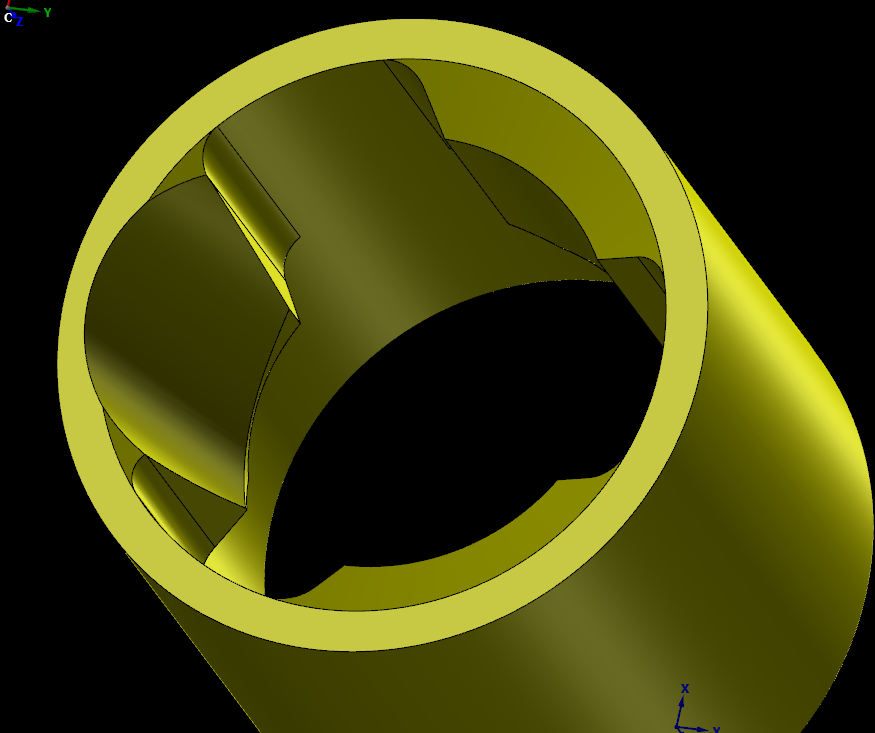

Details are indeed everything!!! For example...We could have kept the bolt lugs and the breech cylinder with squared off edges and saved a few minutes of reprogramming and saved a few minutes in the actual machining time but why??? So we made them with a 1.5mm radii because it looks better to the eyes and feels better to the hands :)

... and your machinists will thank you because they don't have to worry about cutting themselves and then have to deburr them anyway.

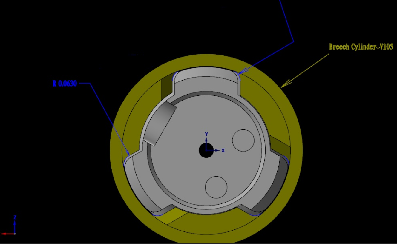

So here is front side view of the bolt lugs going into the breech cylinder :) .
