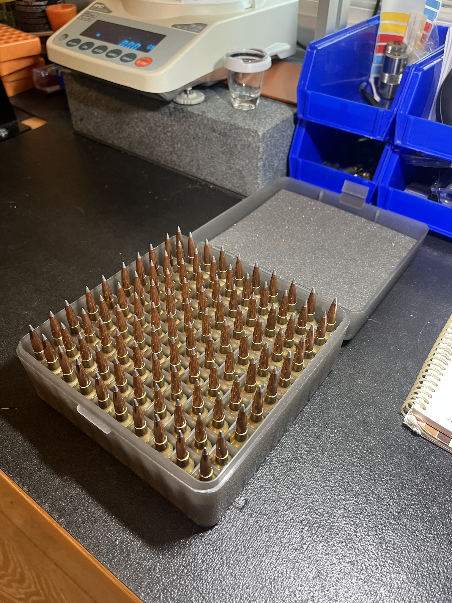

Well, I had some unexpected downtime so I decided to load the A-Tips. They're about the same length as a 112gn Match Burner except their ogive is ~15 thou further forward towards the tip (maybe a little more hybrid/tangent than secant/VLD).
I decided to load them up the same as I've been loading the 112MBs, same charge (33gn SW Precision Rifle), without touching my seating die, which should have them jumping around 35 thou to the lands.
They look great, I may be sorry I canceled the rest I'd ordered originally...

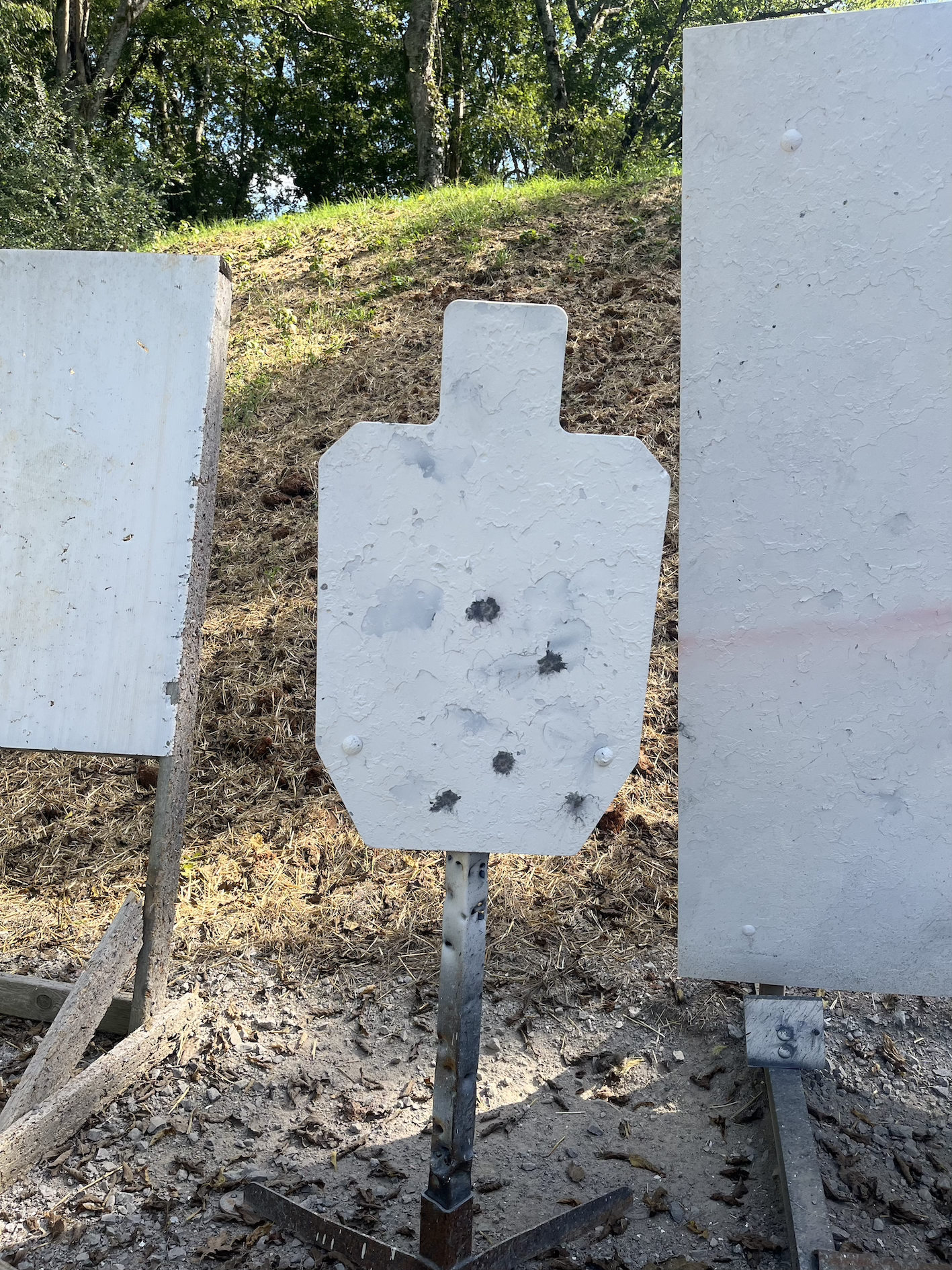

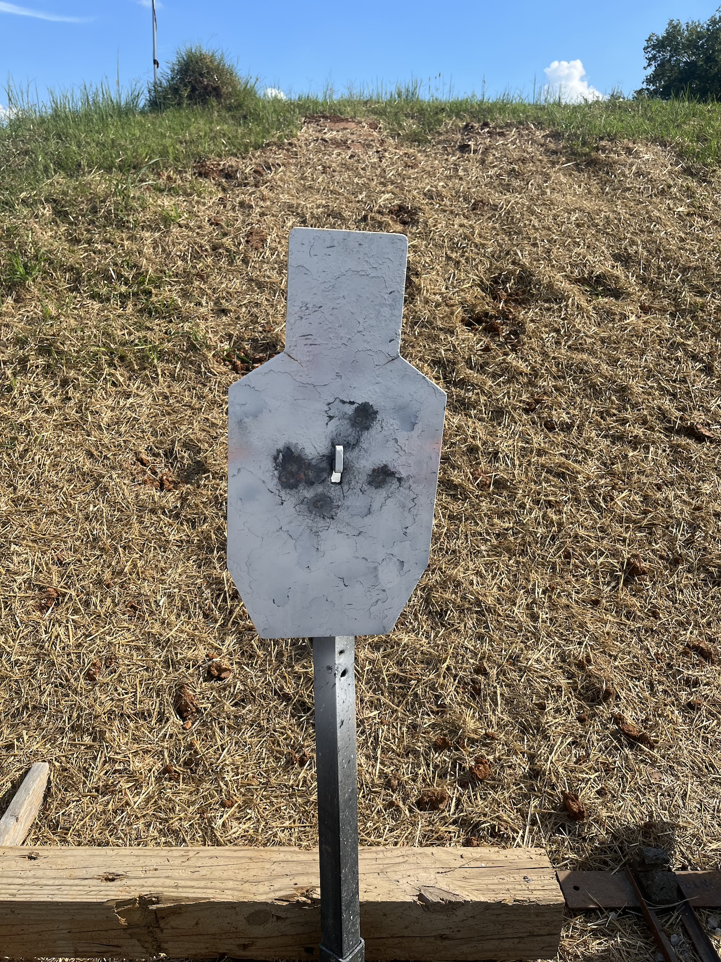

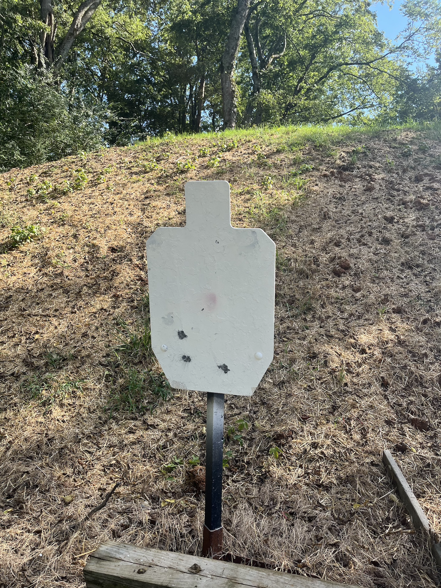

Zero load development, 6 shots at 750 yards off cattle gate/Shmedium, and 2 groups at 1250 off bench/rear bag/bipod, a 3-shot and a 5-shot, I didn't even chrono the rounds, just guessed the 106s were probably ~25fps faster than my usual 112MBs and the dope lined up almost all the way out. (I did however use Hornady's 4DOF instead of my usual Strelok Pro since 4DOF had the 106 DOD bullet in their library).

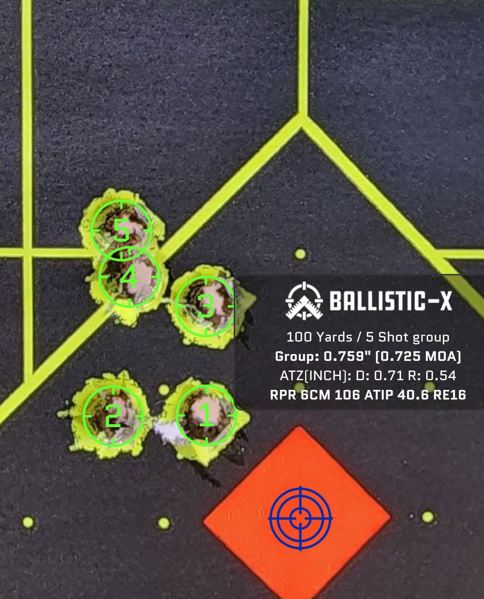

Saw this thread last week and ordered 200 of the 106 A Tip.
40.6 grains of RE-16 loaded to 2.795"
RPR Custom Shop 6mm Creedmoor, 26" 5R barrel
Hornady 1x brass, Fed GMM Large Rifle Primers
With just guessing that the 106s would be ok with the same charge weight of 110 A Tips and 107 SMKs, this is pretty decent.

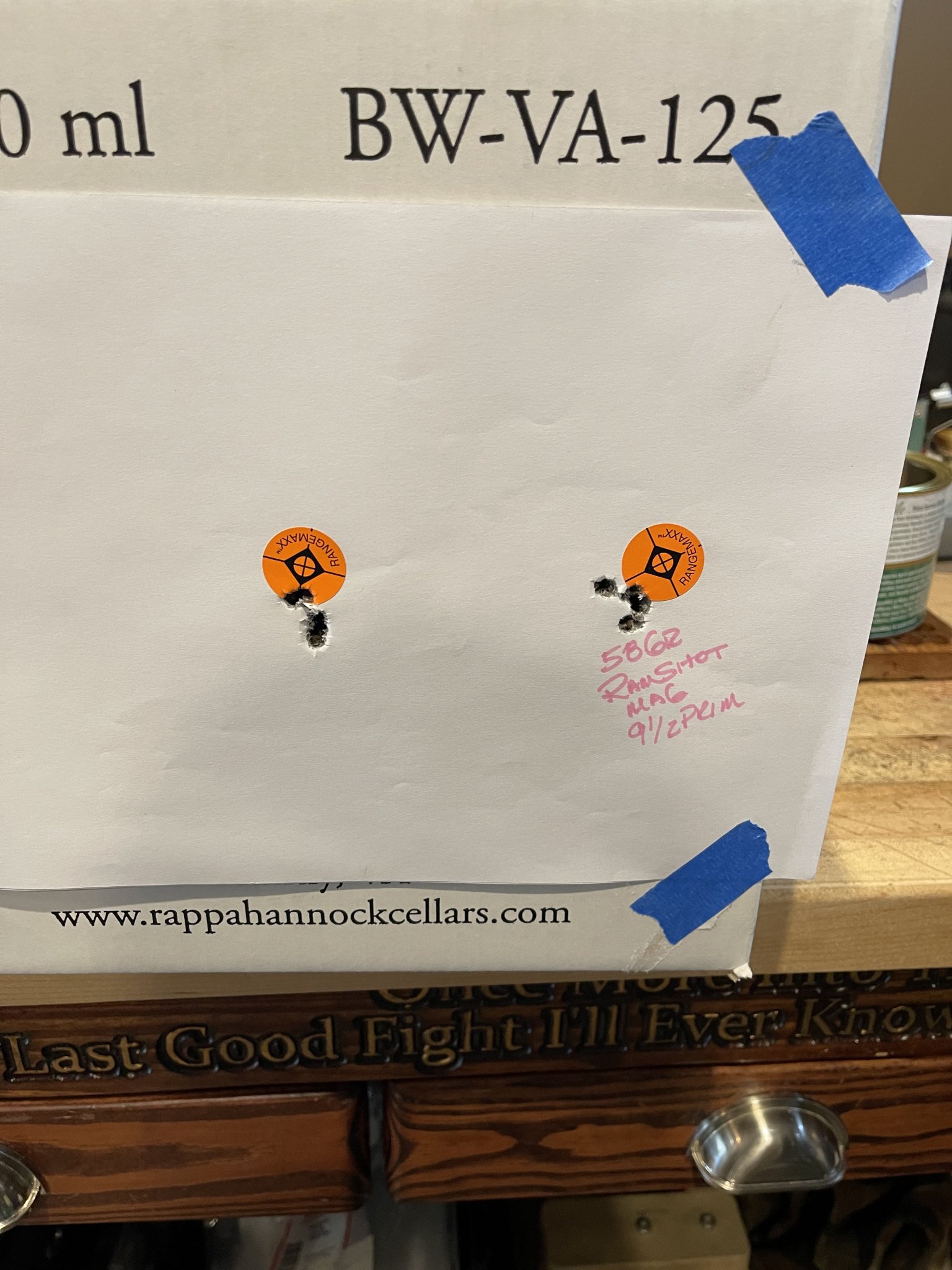

58 Gr of Ramshot Mag out of my 6.5 SAUM with the 153 Gr A-Tip seconds. 6 shots- top left was me. 100 yds. No SD obtained or velocity yet, but so far likin what I’m seein. Group to the left was 57 Gr. Might order a cpl hundred more. Not a big fan of the A- Tips at full price….but for .47$…..
