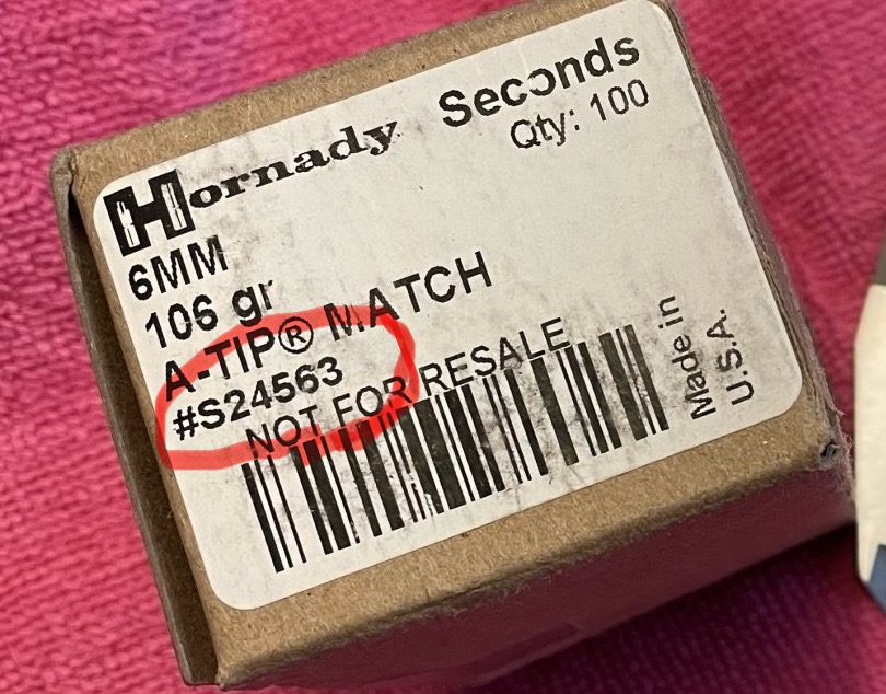

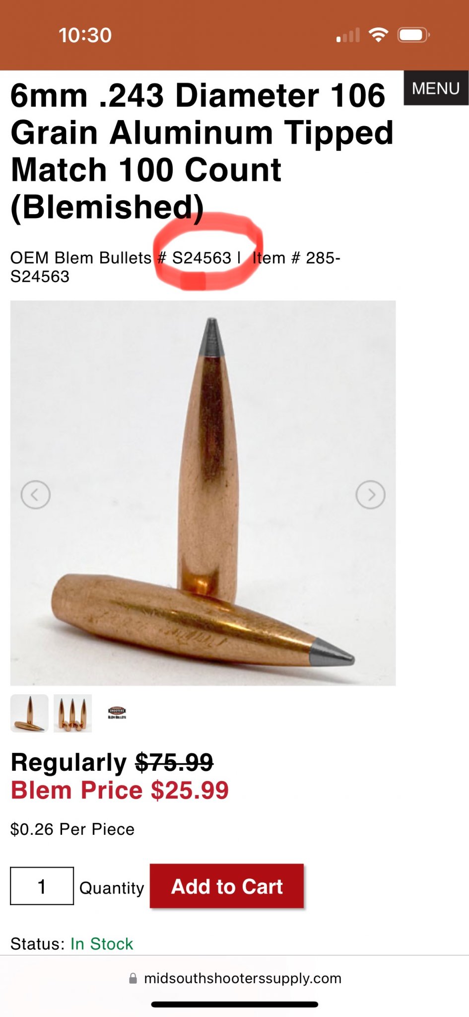

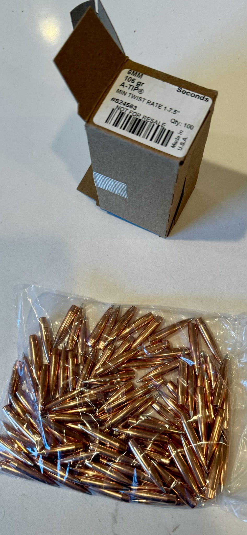

Get Access SubscribeWhat does that number mean?
Part number or sku. The same number was on all 25 boxes I had.What does that number mean?

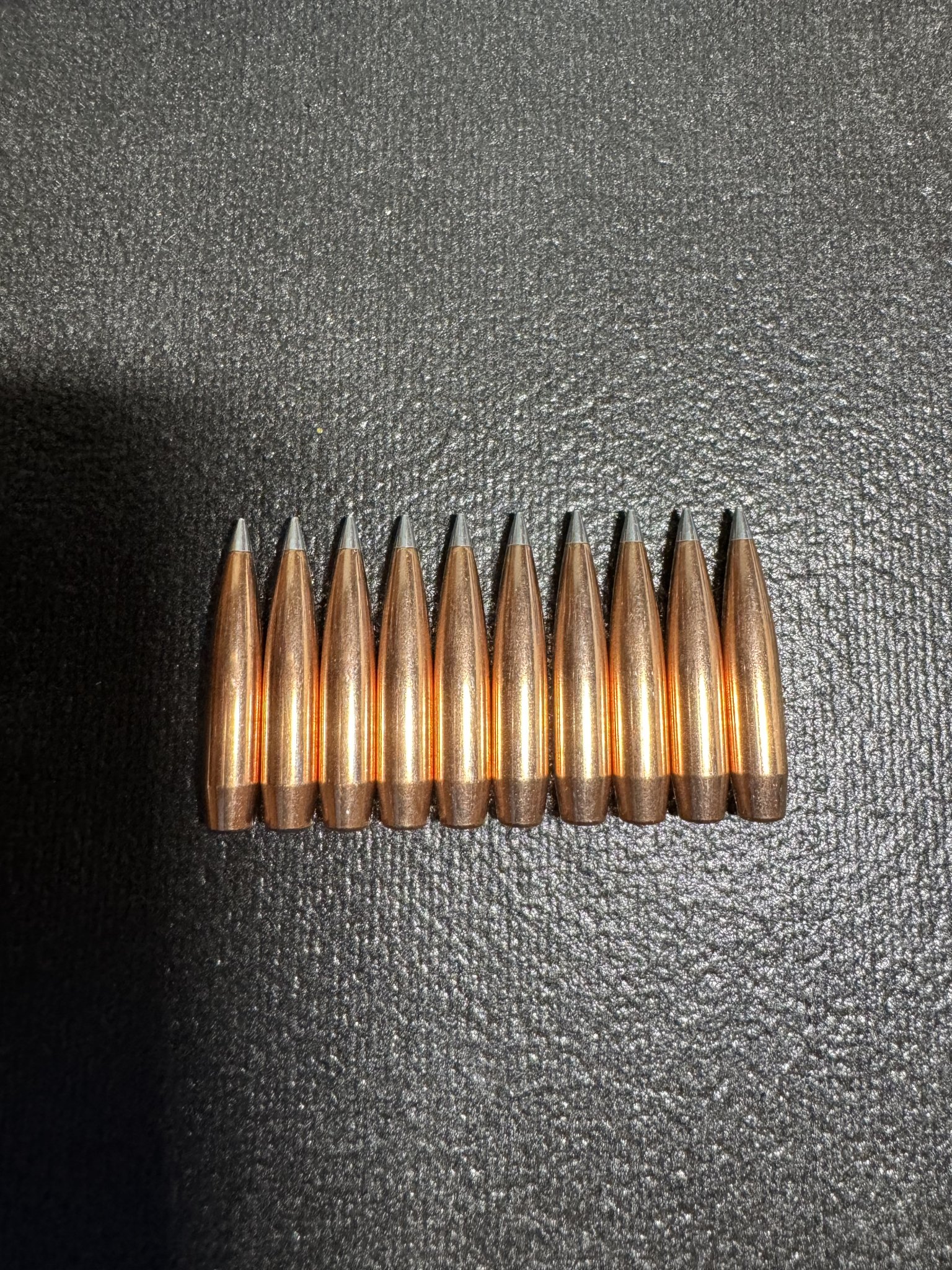

All loaded up with 30.2gr Varget 0.01" off using KM Arbor and L.E. Wilson inline chamber Micrometer seating die with their optional VLD seating stem..
Length is dead on consistent round to round measuring base to ogive...
Heading to the range here shortly to shoot them in my 28" Bartlein 1-7.5 6BR.

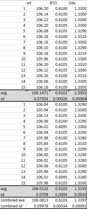

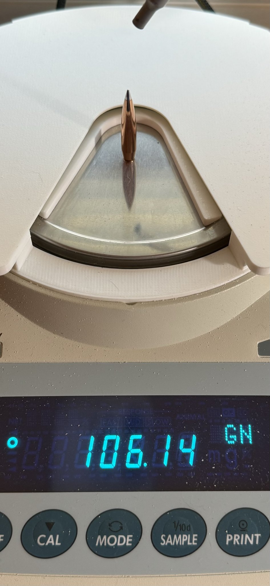

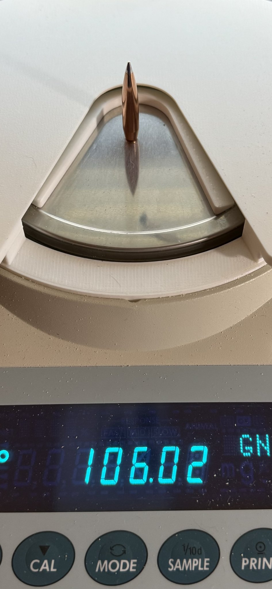

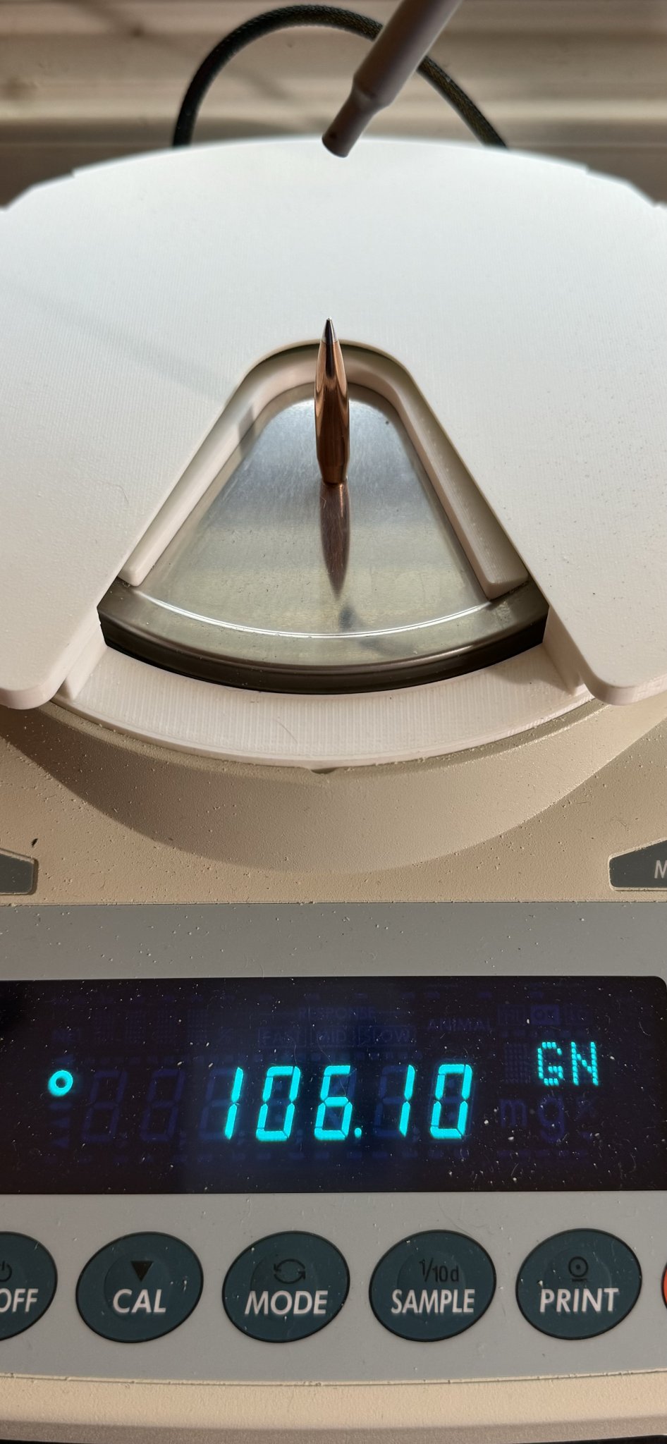

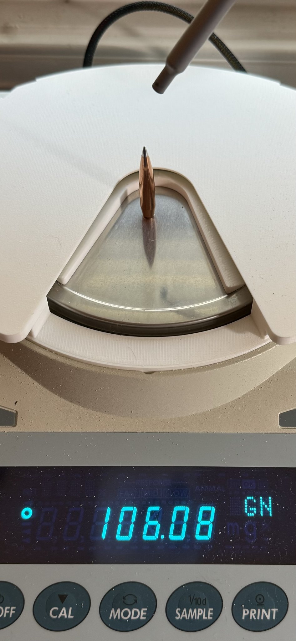

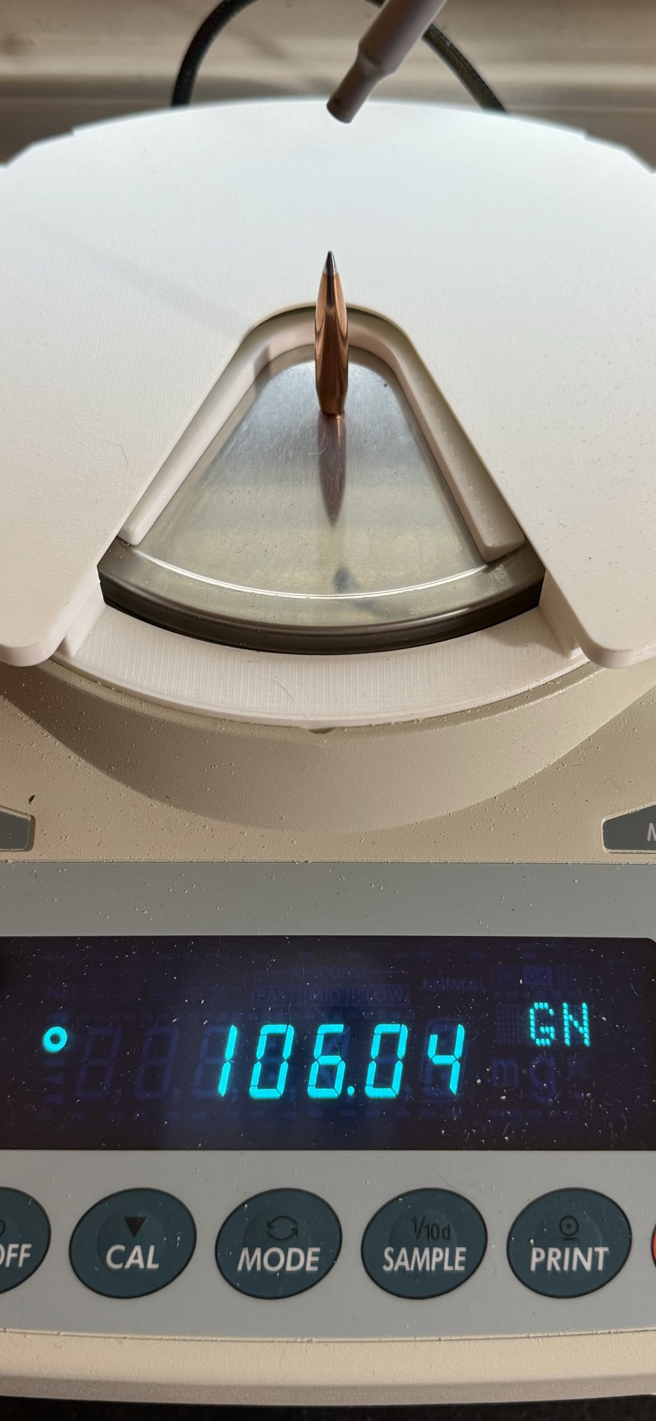

even if one has to cull 1/3 of them
Wow, I hope that's not what I will have to do!
Earlier in the thread guys were finding them consistent and shooting them with great precision.
Odd.I will add the PV lot was roughly .010 longer than the MS lot.

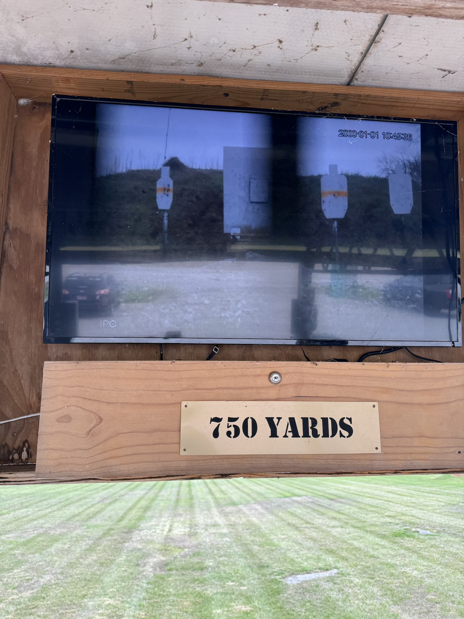

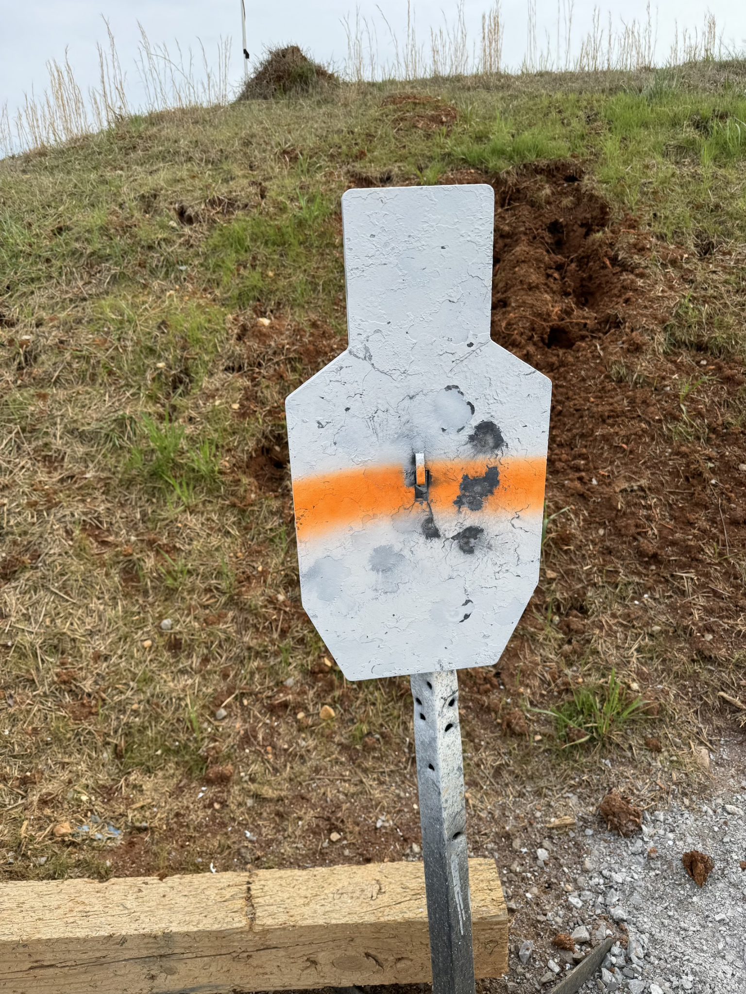

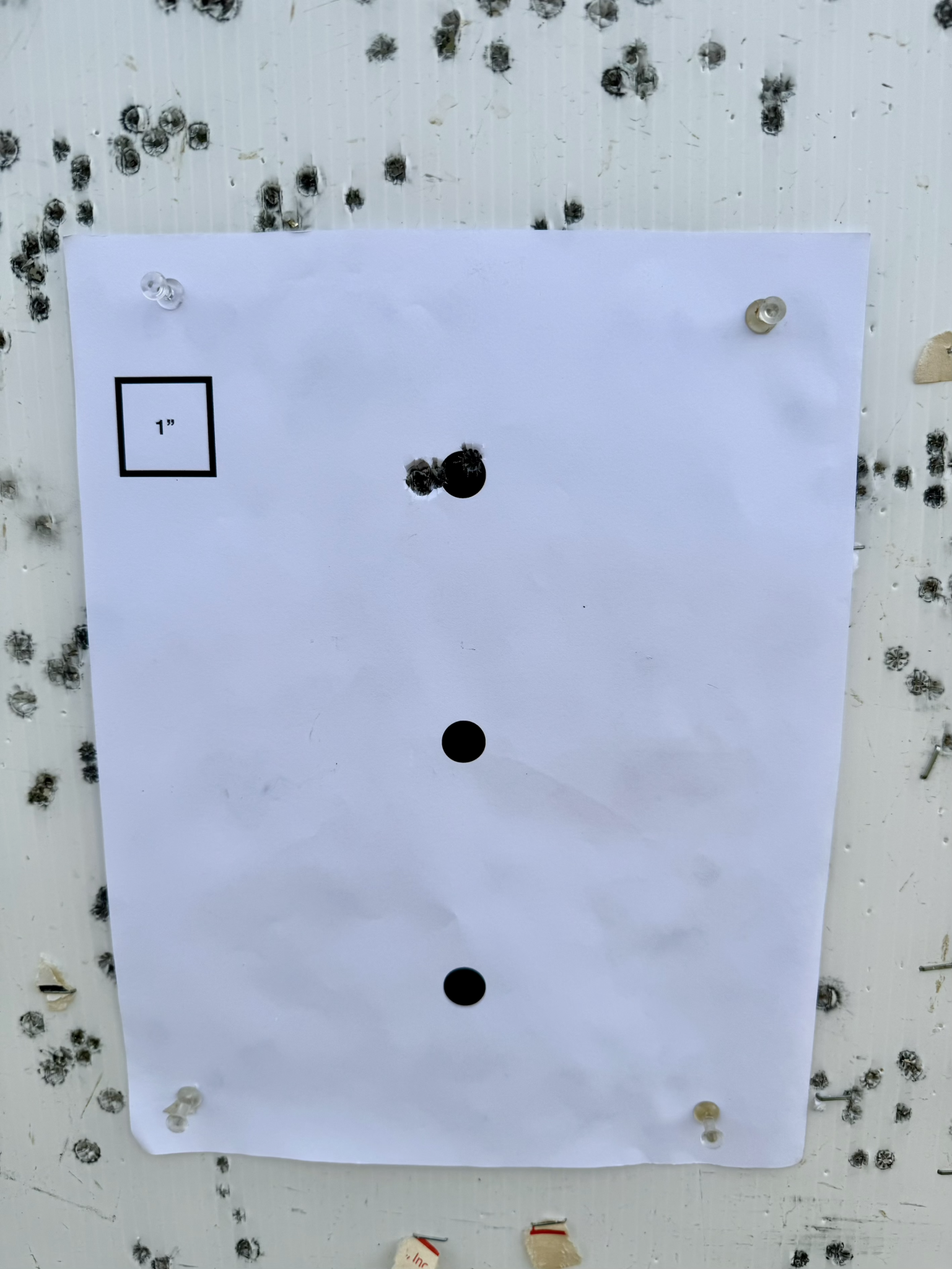

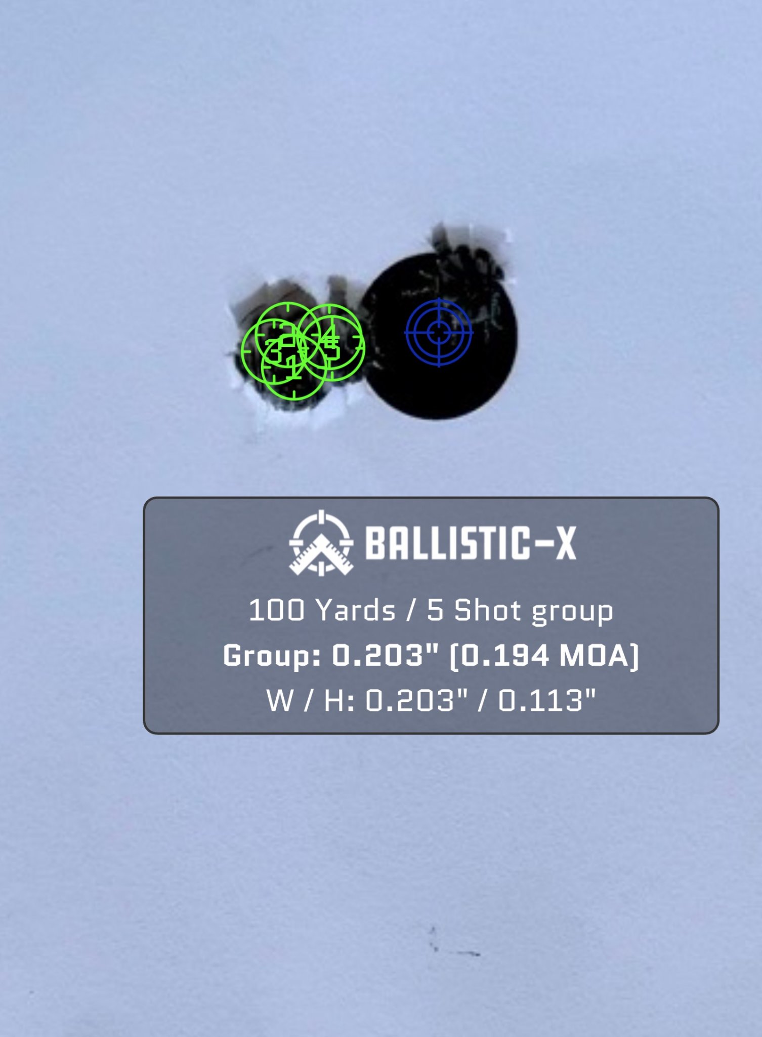

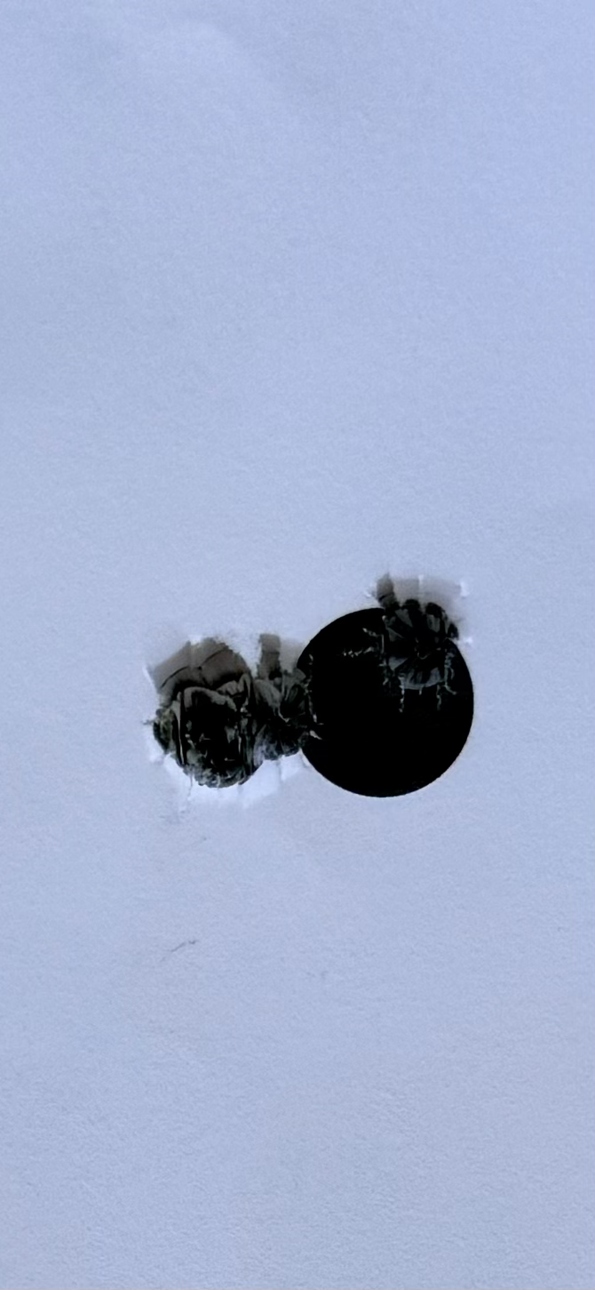

I loaded 300 yesterday and then put on a new barrel today, decided these A-Tips are all this new barrel will see...
These are rounds #4, then 5, 6, 7, 8, and 9 (5-shot group) through it today.
I showed up while the range was hot, so I put 3 rounds on a big 6' x 6' plate seeing if I could get it close before the range went cold and I could put up a target.
After putting a target up I sent 1 round into the top dot to see how close I was to having it zeroed... I stopped, looked at it, and decided it was close enough to where before adjusting anything I should send another, then another, then another, etc.
I'm kind of shocked. I wish I'd bought more.
View attachment 8375049View attachment 8375047View attachment 8375046
They look good downrange too.
View attachment 8375060View attachment 8375061View attachment 8375065

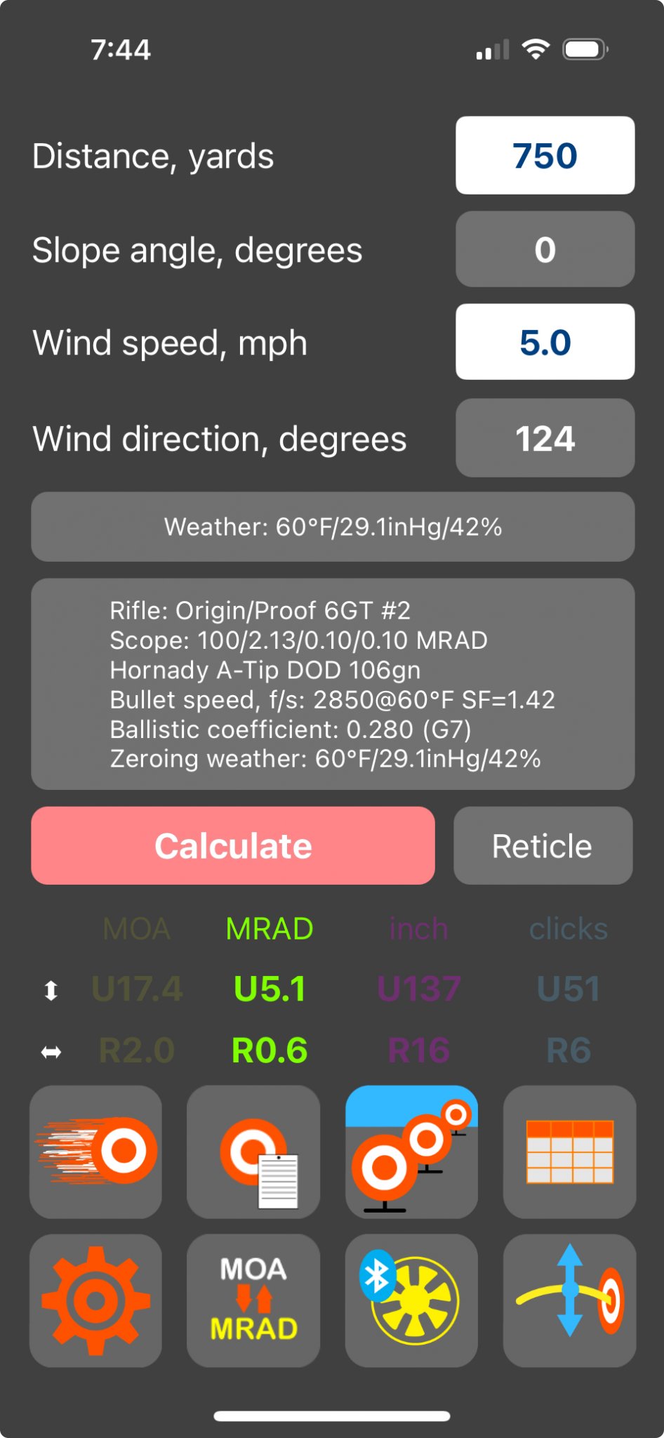

Load data and jump?
Alpha case ("Gay Tiger" headstamp), trim length 1.710", CCI450, 33gn Shooters World Precision Rifle, 1.965" BTO (jumping ~.010" I think, I haven't measured the distance to the lands yet, and not sure I care anymore lol).
I generally don't even think about MV/SD/ES numbers until after ~150 rounds down the pipe, but FWIW, I couldn't resist putting 3 rounds over a buddy's Xero (somewhere between rounds ~#30-60) and the MV was 2844/2849/2851fps, SD 5.8.
It's still speeding up, but ~2850fps is right where I'd like to be.
