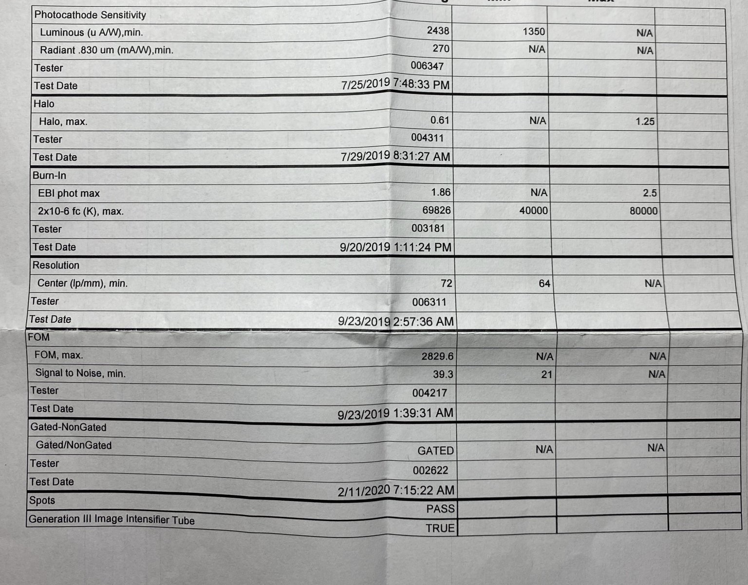

BNVD-UL L3 WP fIlmless 11769
SNR: 38.6/39.5
RES: 72/72
FOM: 2779/2844
EBI: 1.0/.8
HALO: .7/.7
PS: 2808/2743
LG: 69313/61474
BLEM: NONE/1 ZONE 2 .003-.006
VENDOR: JRH, satisfied. Previous tubes had lower ebi at .2/.3 but lower SNR at 32/34 and mismatched HALO which I found distracting. These have much higher SNR, matching halo and good but not as good EBI. Happy with new tubes, great deal of clarity, waiting for dark night to really watch them. Would like to compare the polycarbonate lenses against PVS-14 glass someday, some polycarbonate actually have higher light transmission than glass and less glare. I would assume this is the polycarbonate in my BNVD UL. Blem doesnt really concern me as it disappears in almost all actual usage and I would take a blame tube with higher spec over non blem with lower spec anyday. I do not like FPN though, dealbreaker for me.
SNR: 38.6/39.5
RES: 72/72
FOM: 2779/2844
EBI: 1.0/.8
HALO: .7/.7
PS: 2808/2743
LG: 69313/61474

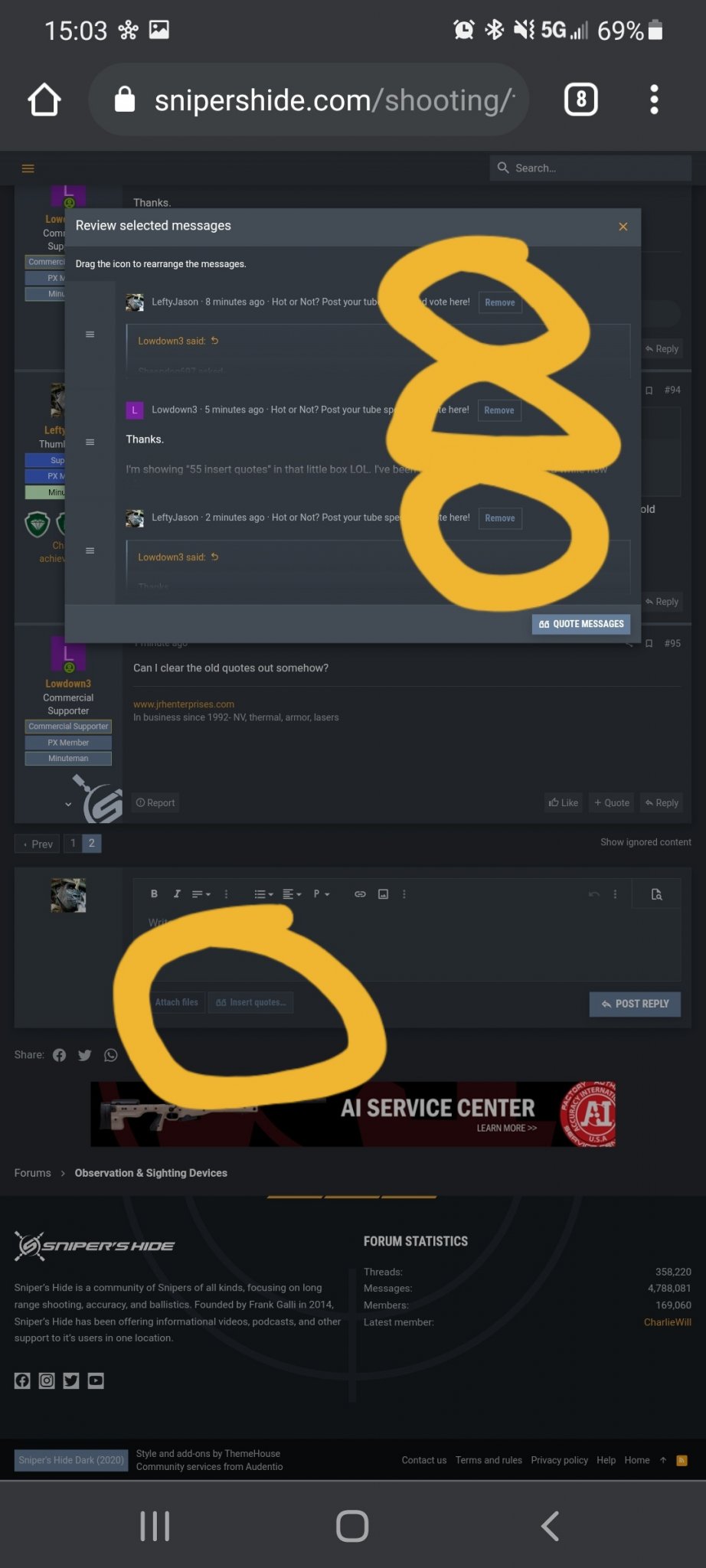

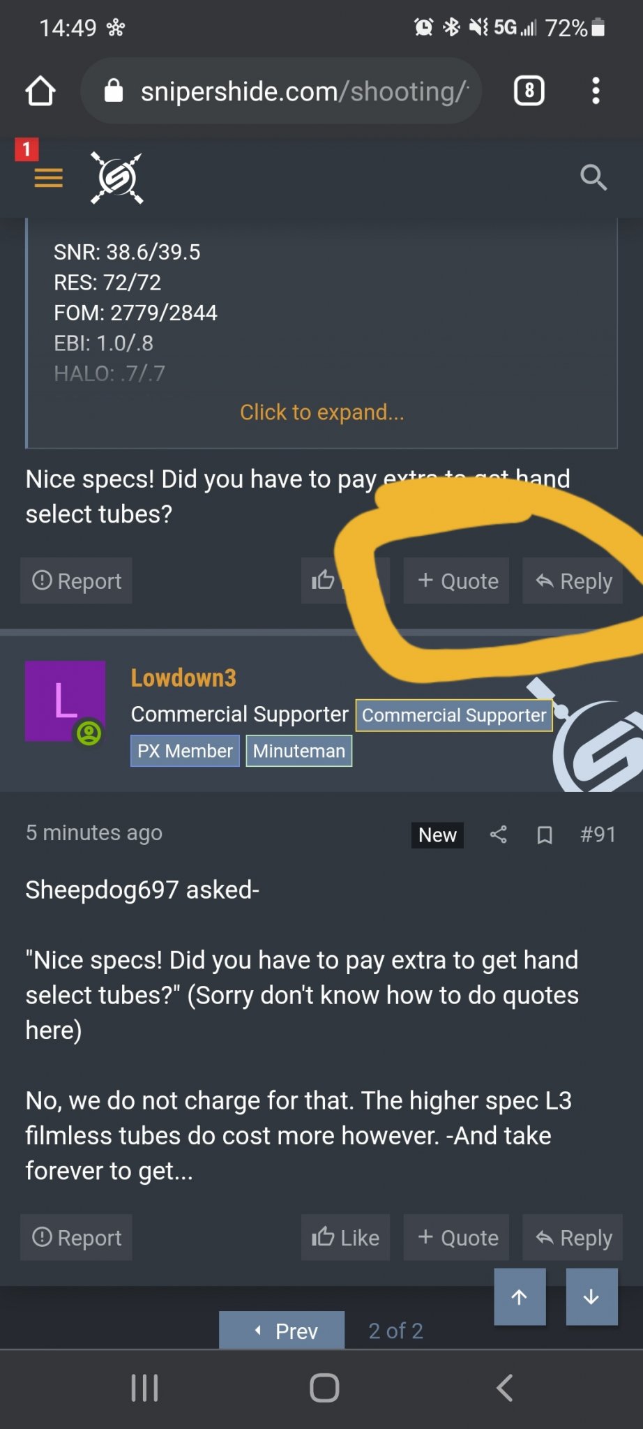

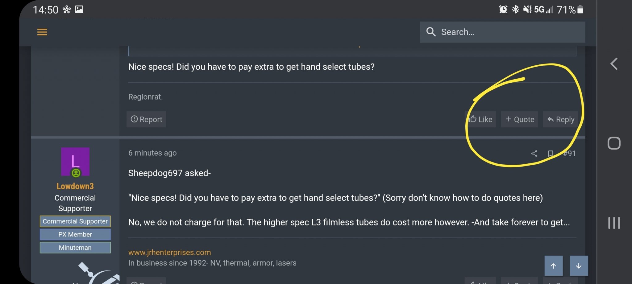

Here is how you do it.
Click in the circles.
Reply to do just that post. Easier than quote. This is what I did for this reply.
Quote if you want to do multiple different posts. Then arrange in what order you want. Insert.
Mobile
Computer (screen shot from my phone)
Can I clear the old quotes out somehow?
Yes. Press the Insert Quotes button in the box on the bottom. Then click the Remove in the box that pops open. Works about the same as far as I can tell computer or not.

Jay / SureShot NV
Just shy of $20,000
DTNVS with RPO glass
Dual 1702 4um L3 Unfilmed WP
3695 / 3303 FOM
91 LP / 40.6 SN
91 LP / 36.3 SN
