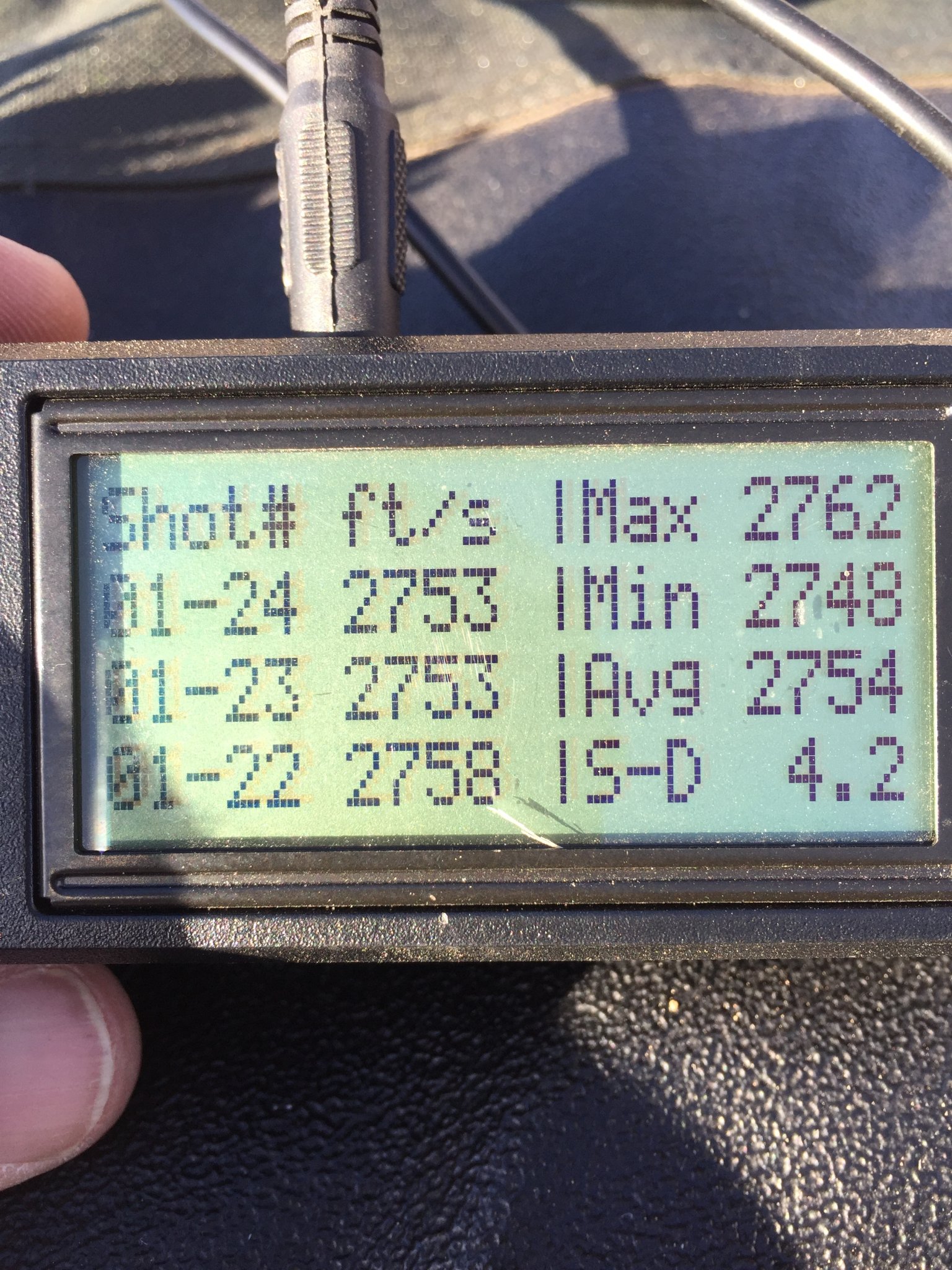

How about a14FPS ES and a 4.2 SD over 24 rounds...
Reactions: jackdesert and lash
@plinkin
6.5x47...curtius custom axiom...24" hawk hill 1/8 rem varmint...which i dont care for going back to heavy palma after this barrel
JGS reamer... .293 straight neck .100 freebore
charges weighed to +or- 1 kernel on an A&D FX120i
trimmed with a giraud
full length sized/seat with whidden dies
forester coax press
primers seated with the K&M tool with the gauge
the only case prep is primer pockets uniformed with the 21st century tool
annealeez...anneal every 2nd firing
lapua brass 300 pieces per barrel
stainless tumble every time...250-300 cases at a time...1 table spoon yellow ajax 1/4 teaspoon lemi shine cold water tumble 1 hour
FL size every time...shoulder stays the same or bumped ,001... .002 neck tension....12;1 100% Isopropyl alcohol lanolin for lube
trim every time
run the primer pocket tool in the pocket every time by hand
seat primers plus .005
i seat .020 off the lands and do not chase seating depth unless im really having issues which is rare and normally a different primer(i only use 1st fed205Ms or 2nd CCI450s)or a powder adjustment will fix the issue
now with all the said i check my velocity quite often because its simple with an MPA chassis and the RAT adapter...with my last 6CM barrel and the last 6.5x47 every time i checked my speeds i was 15FPS or under with 25 rounds fired.
now like LASH says the low 3-5 shot ESs-SDs look good and are impressive but the numbers are not going to be like that every time out...yesterday i had a 60FPS ES...i shot my first 12 rounds of a match over the magneto speed...round 1 cold clean bore 2902(normally 2935-2940)...round 12 2962...which i woundnt mind from cold clean to fouled bore BUT i had a 2930 a 2935 in the mix and round 11 was 2928....these should all be 2940-2960.
i had several go just under or just over the rabbit at 611yds and 1 go off the nose of the coyote in a 1-3mph from 7oclock wind...so my first change will be switching to a CCI450 which im pretty sure will fix the high ESs.
like others have said whats most important is whats going on at the target...if i were shooting bigger targets i wouldnt worry about the numbers so much but the smaller the target the more those numbers matter.

Heh, heh. I've been there before. Are you sure it was the rifle loads and not the load of stuff between the ears? Either way, sometimes the difference between good and great is just chance, no matter how well prepared, practiced or polished everything is.
Would 14fps difference have made a difference between a hit and a miss on a coyote at 600? Probably not.
i was shooting and feeling good but ill take the blame for at least 3 of my miss...2 bad wind calls and one corky the retard trigger jerk...pulled that one clear off the planet lol.
no a 14FPS spread would not matter enough at any distance but that was my first barrel...yesterday was with a new(200 rounds through it)barrel my ES was 60FPS so yes 60FPS would matter at 600 yds just enough to put me over or under a rabbit...going to shoot a 22 match today so ill be back later with all new and improved excuses.
