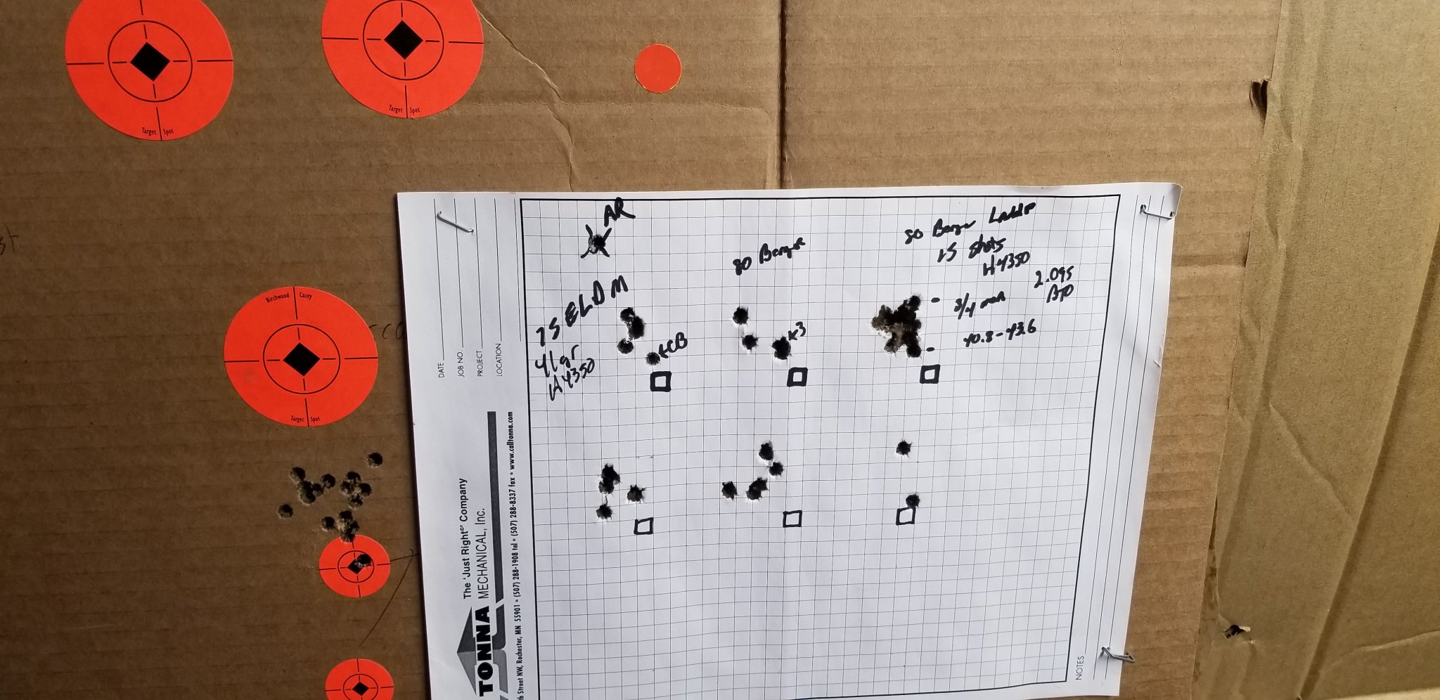

The group is in the upper right corner....15 shots..
the ladders that are seen above (upper right) at .75 moa for 15 shots over almost 3 grains of powder and then again with the same charges and a 75 ELDM on the orange dot(POA is the top little orange dot) are 15 shots also. And you can literally count 15 separate bullet holes with Hornadys but the Bergers shoot that well so I try the middle of the top node and the actual "node" load wont shoot as well as the entire 15 shot ladder test....hell, i dont know....maybe it is me but my other rifles dont seem to have this issue. Scope shoots fine on my PRS 6x47s. I am gonna pull it out of the Manners and put it in a MPA and see if the stock makes a differnce I guess....thanks again folks.

The group is in the upper right corner....15 shots..View attachment 7250641
I’m going to slide out on the limb and say this target reinforces what I said before. Short of copper fouling or something like that this target screams shooter error to me.
The 3/4 moa ladder test is the tell. How is the 15 shot ladder test the same or smaller than most of the groups? When people get “shoot a group” in their head it can screw with them. On the ladder test your mindset was different. You aren’t trying to shoot a group. You are shooting and allowing the bullets to fall where they fall. Mindset is a huge factor in shooting .3-.5 moa vs 1-1.2 moa. When you are expecting and trying to shoot a tiny group it can make you subconsciously do all kinds of weird things that will screw it up. Ask me how I know. The tiny aiming points will make all of this much worse.

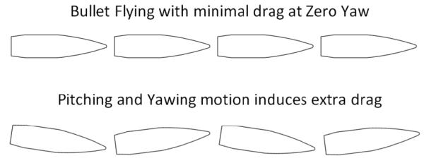

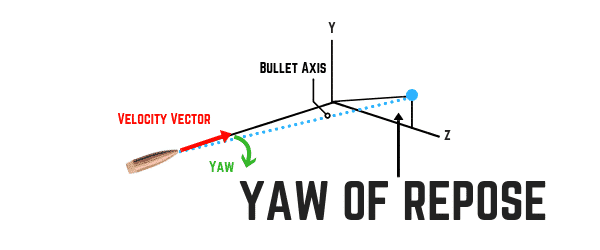

Why short range group size vary so much: The prevailing theory (proposed by Chris Long) appears to be that the pressure caused by the expanding gasses just ahead of the chamber creates a pulse moving from chamber to crown at the speed of sound (in steel) that inflates the diameter of the barrel and disturbs the shape of the crown allowing random gas blow-by, equivalent to a damaged crown that looks different every time a bullet exists. The pulse then reflects back and races back to the chamber side of the barrel, and pulse reflecting process continues. Ensuring that the bullet leaves the barrel between these periods of gas blow-by helps with accuracy.
The missing piece that has to be added to this theory is that Positive Compensation is possible and is driven by barrel whip and bullet exit timing (barrel dwell time) and PC can help to reduce vertical dispersion significantly at specific distances. [Curious what your experience is: How narrow is the distance range where PC works adequately?]

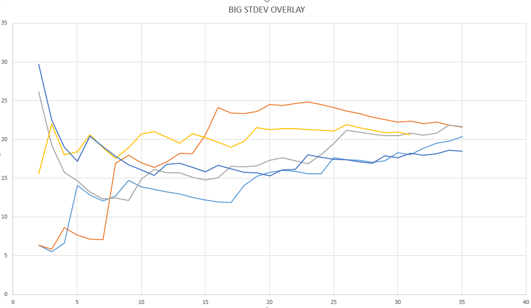

For your pondering, here's the SD vs. shot count on some 30-35 shot samples with a factory .223 barrel. The 5 different lines are 23.5, 23.7, 23.9, 24.1, and 24.3gr of Varget with a 75gr BTHP. I'm still fairly early into this testing and haven't really got a handle on what the knobs are. I have a few more rifles/barrels lined up to do similar testing with to try to see what matters and what doesn't. I'm isolating MV ES/SD first, then will mess with accuracy afterwards, though I am taking note of what is happening for accuracy.
One thing you can clearly see is that anything under 20 sample size is very liable to be a blatant lie. Very noisy.
ETA: SD in fps on the left, # of shots on the bottom
It's almost like basic statistics is true.

This is certainly interesting, for sure. So if I am understanding correctly, going out and shooting 5 rounds and getting an SD of say...5fps...is fantastic but also quite probably irrelevant in that it is not a big enough sample to give an accurate picture of reality. The answer is shooting 30-35 shots( a 7x larger data sample) and going with that number in the process of deciding if a load is reliable....am I understanding this correctly? It seems quite sensible honestly. The bigger the data sample, the more accurate the results are likely to be yes?
Yes, absolutely.
Reactions: jaybic
Correct. I have once seen my first five shot group of the day produce an SD of 3, post fouling shots (not recorded), but 45 rounds later SD ended up at 9 fps. In that particular case SD took about 25 rounds to mostly stabilize.... it usually takes 20-25 rounds for me. I think LedZep’s graph is pretty representative. Of course ES keeps growing (a little) even after 100 rounds. Very unreliable statistic and not to be taken to the bank....
So yeah 5 shot stats are meaningless....

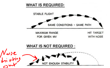

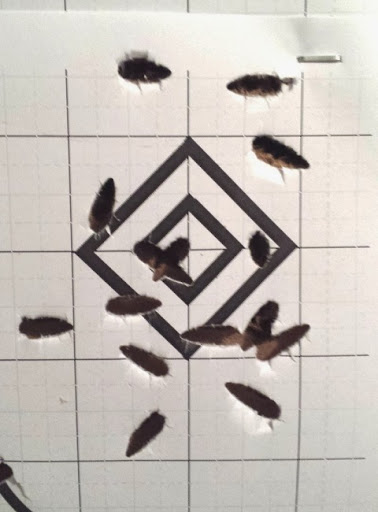

William C. Davis has reported on tests conducted at Frankford Arsenal on this subject matter. Using machine-rested, bolt-actioned, heavy test-barrels, one such test that was conducted on an indoor-range involved firing eighteen 10-shot groups on targets at 100 yards and 300 yards. The average extreme spread for the groups at 300 yards was 3 times as large as the average extreme spread of the groups at 100 yards.
In another test that was conducted at Aberdeen Proving Ground using .30 caliber match-grade ammunition, thirteen 10-shot groups were fired simultaneously through paper screens at different distances. The mean radius for the groups at 300 yards was 1.0”. The mean radius at 600 yards was 2.1”
Heavy/long for caliber bullets can shoot superbly at 100 yards. The 10-shot group pictured below was fired from one of my Krieger barreled AR-15s at a distance of 100 yards using a hand-load topped with the 85 grain Barnes Match Burner. The group has an extreme spread of 0.428".

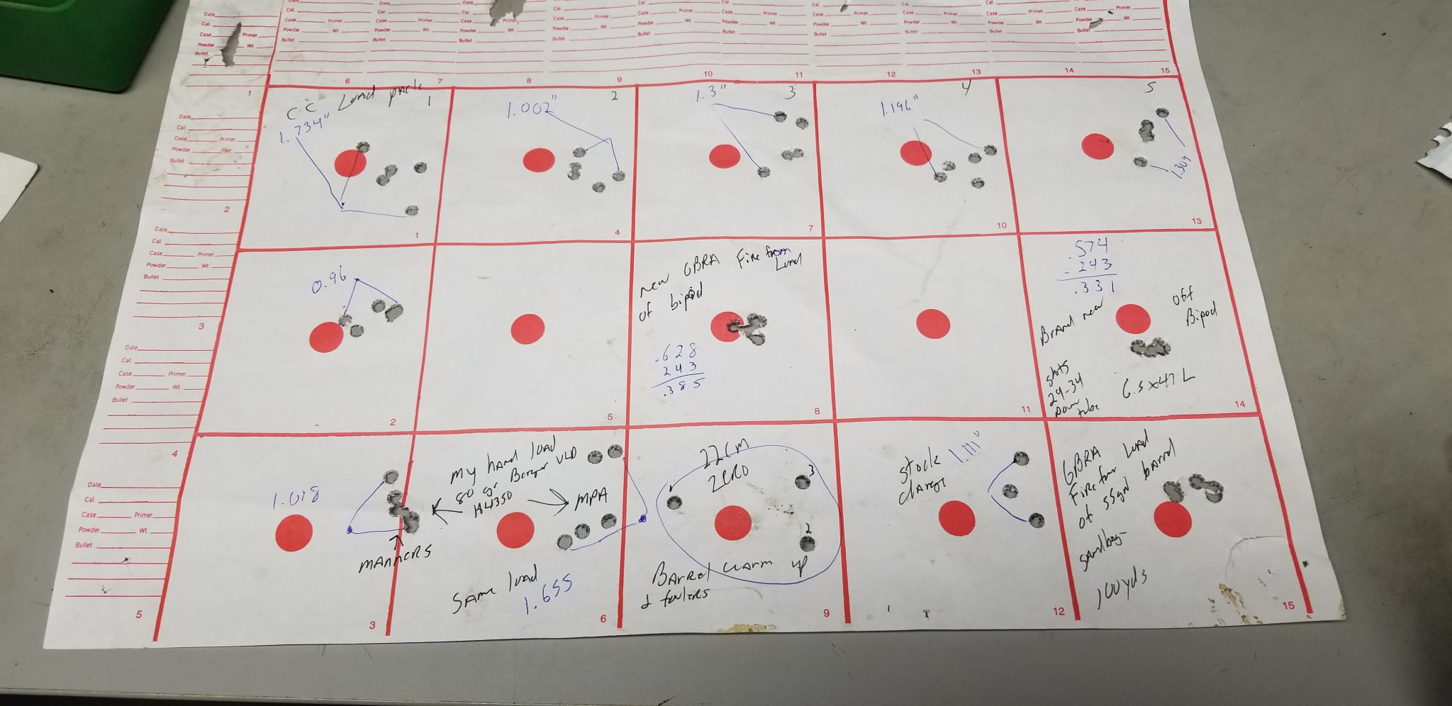

Well, after a little more experimentation using a custom load development pack AND my own handloads, perhaps this pic will bring something to light
Top row: 22 CM lightest charge to heaviest L to R. All 5 round groups. Never breaking cheek weld. Middle row center target is my new 6bra...5 shots. Middle row far right is my new 6.5x47....5 shots. Bottom right is my 6bra...off a rooftop(Correction...55 gallon plastic barrel) and a gamechanger bag only...5 shots.
The BRA is a 105 hybrid/h4895 fireforming load i just threw together as is the 6.5x47 load(rounds 29-34 on a brand new build(130 ELDM and Varget). Neither of these loads have been tuned it anyway, shape or form....just load and shoot to get rounds on the tubes prior to beginning actual load development. Some of the other groups are me trying a my handloads(very poor) and even trying a different MPA chassis rather than the Manners(did not help).
I only post to give testimony that, yes it may well be me, but I do have evidence that on that same day, same conditions, and same target, I had no trouble shooting under .5 with other rifles that had no where near the time and effort put in to them. And once again, I do sincerely appreciate the advice and insight in helping me get to the bottom of this rifle issue. Thanks to all...

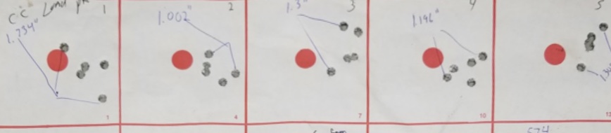

OP is getting five shot groups between 0.95 and 1.75 MOA at 100. That is very poor based on my experience. Most $450 stock Savage or Ruger rifles will do better than that. A blueprinted Rem700 with a Bartlein custom barrel and a trued bolt and recoil lug should be well below 0.7 MOA. More like 0.35 to 0.5 MOA.
With a different rifle, he is getting multiple 0.3 MOA groups with four or five holes touching. He showed photo evidence of that. So the man can shoot.
Copper Creek does a good job on their load development packs, but that did not work either. Handloads are also not working well.
Chassis swap did not help either.
His five shot groups with the non-performing 6 Creedmoor rifle:

I agree with the Op that often times my rifle will shoot better at longer range (usually around 300 to 600 yards) than it does up close, and while it may defy rational thought, it still seems to occur just the same. Not always mind you, but often enough to think there is something more going on.
I have two possible theories on the point...
1) Light refraction and mirage makes it hard to shoot tight groups at close range, (because of target displacement caused by light refraction humidity and heat) but at longer ranges, under the right conditions, perhaps the target displacement averages out.
2) The second possible explanation is that the bullet begins life with a certain imbalance that causes it to travel in an orbit about the directional axis. At close range, this orbiting has not settled out yet, or perhaps never does.

Bullets are either stable when they leave or they are not, there is really no middle ground because they wouldn't group.

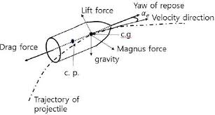

I think people are also confused about diagrams showing a spiral path for the tip of the bullet as it leaves the muzzle. That is called precession, and that can indeed be more prominent and then settle down. However, the center of mass of the bullet is still going in a smooth arc! It would be impossible for the center of mass of the bullet to travel in any spiral because there is no force acting on it externally. And this wouldn't increase short range group size, it would just cause the bullet to impact a few degrees rotated.
So based on the center example in this diagram, is it not possible for 5 shots to group larger at close range if the nose of the bullet is a few degrees off it's center axis?
That is super exaggerate for example. If the nose is far enough off to skew a group then youre going to have to be unstable and tumbling, it wont ever shoot well. If the bullet did hit all thrown out to the side like that above pic you would have a long tear in the paper as the bullet continues forwards, not a small circle.
So... no.
Yes, it does those little exaggerated shapes but it does them microscopically and at 2-300k rpms. That bullet is spinning in the air and in one second of flight time the bullet has spun a complete revolution 3-5,000 times before hitting the target. If by the time a properly stabilized bullet has had the chance to get off axis it has spun itself around to pull in exactly the opposite direction back on axis, aka, spinning cancels out the tumble by immediately putting the tumble on the opposite side to cancel out.
Look up yaw of repose and gyroscopic stability
A football spirals through the air just like a bullet, notice how if it isnt thrown as a spiral its all shitty and a shitty spiral flys like a wounded duck? Once it starts wobbling off its center axis faster than it can turn itself around and self center again any hopes of accuracy go out the window.
Edit: read this for brain explosions https://www.snipershide.com/shootin...llets-extended-reformatted-version.8/download
Reactions: 1moaoff and nick338
