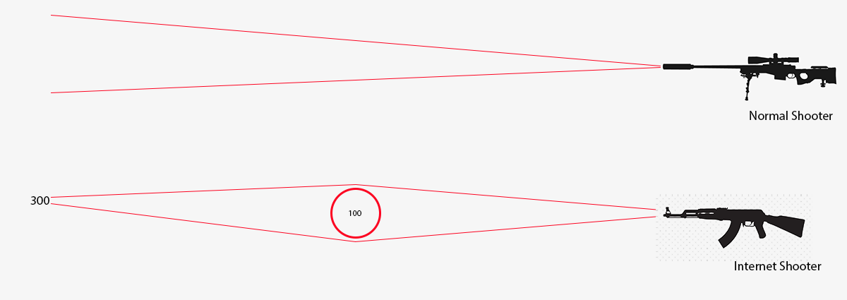

What you don't get is, old wives tales like Bullets Going to Sleep, especially beyond 100 is A MYTH and we are trying to tell you this, and you keep arguing back.
Old Wives Tales are such that they often get repeated and taken as gospel by plenty of well-respected people.
Again, if you look at the cases that are most prevalent on the internet regarding this observation, 90% are with magnum rifles. Why do we see this topic more so with magnum rifles vs standard calibers, one word, RECOIL.
When we lead a horse to water and they refuse to drink, you get mocked and mocked endlessly.
Think about what this topic is suggesting, that a dumb pilotless bullet will travel erratically early on and then stabilize mid-way through and somehow end up back on course? Without a pilot and if the bullet is indeed swirling in a circle causing a bad group at 100 yards, how does it self correct back on target? These are angles after all and angles cannot fold back on themselves.
You need an outside force to close things back up,
Furthermore, let's consider the minor variations in Muzzle Velocity, in bullet weight, and what you are trying to say is every bullet in that group is deviating at the same amount in the same direction. We know this is not the case, they all cannot be doing the same thing together as a group if they are doing things differently in order to open up the group.

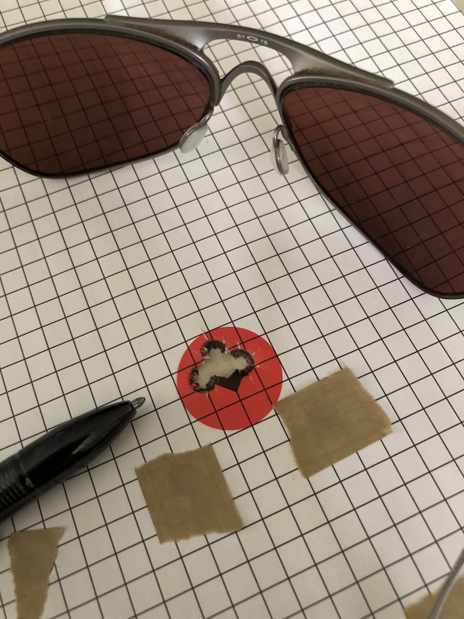

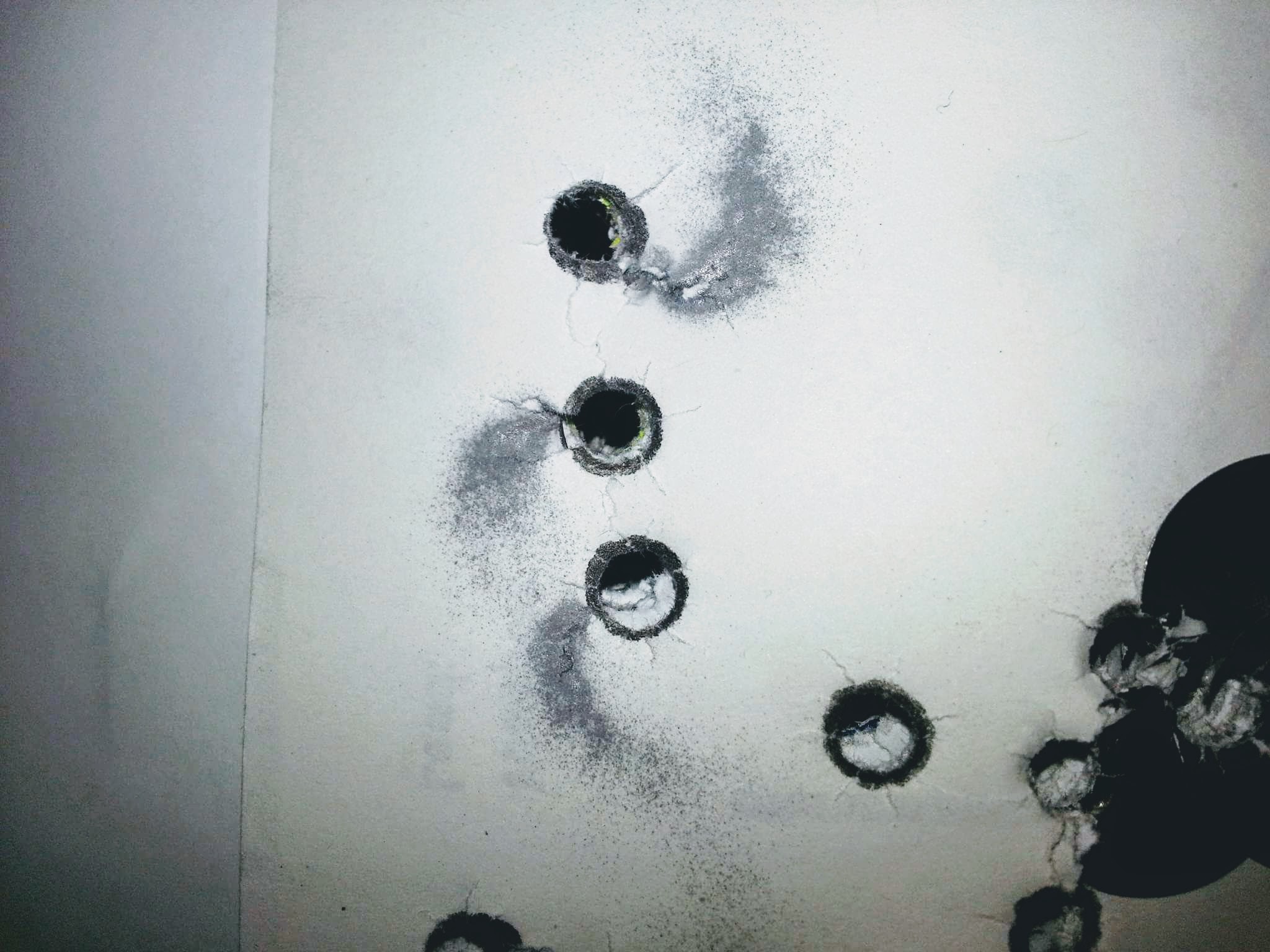

Since some people in this thread seem to be mis-characterizing what Bryan Litz has said on this subject matter, here's some actual data on the subject matter from Mr Litz, himself.
The first target pictured below shows a measured 5-shot group that was fired by Bryan Litz at a distance of 100 yards on his “shoot thru” target set-up. The group has an extreme spread of 2.46 MOA.
The next target shows the impact at 300 yards of the exact same 5 shots that were fired at the 100 yard target. The extreme spread for the resulting 5-shot group at 300 yards is 2.49 MOA.
and again . . .

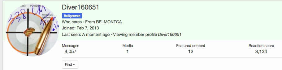

Below is an image of my Hide profile and the very same 338 bullets people shoot and claim needed time to sleep. It is a group off a bipod and at 100y. Assuming a bit of yaw, it is easy to see that any oscillation is hidden by the diameter of the bullet, even more so by the group's hole. With that said, if the tiny bit of yaw does reduce, how would it even realistically impact the group size?
