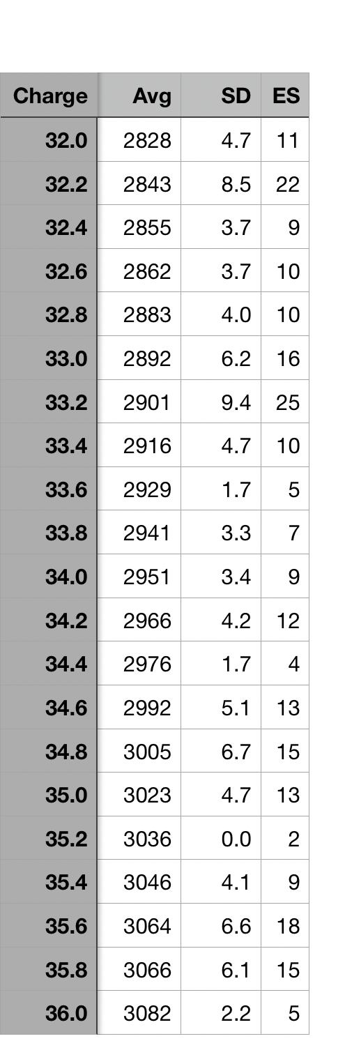

Here’s a random Internet pic as an example. You can tell this is a good barrel. Look at the change from 42.9-43.2. POI is really consistent and in between there it shifts up. I would hate to randomly choose 43-43.1 and be right on the edge of that shift. Sure you can be exact with your charges and such but why not choose a charge in the middle of that POI and have a huge pad on either side in case of variables?

You asked for reasons to look for a charge weight rather than just picking one. This is it. The chances of you choosing the “edge” charge are small but I’d rather avoid it considering how easy it is to do. And this is a subtitle target. I’ve had some on AR barrels especially that clearly show a pattern of the poi moving up and down pretty dramatically. My guess is this is the harmonics of the barrel but I have no proof of that. Either way it’s well worth the few rounds it takes to check IMO.

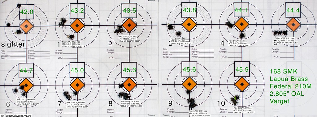

I use a chronograph for charge weights and then tune the seating depth after. This is the method used by members of Team Lapua/Berger.
I have never had a poi shift doing it this way to even remotely suggest it will happen, as I’ve turned the ammo to the harmonics of the barrel via seating and/tuner.
What you’re showing is the classic older way to find nodes which was designed when we didn’t have chronos and such that we do now.

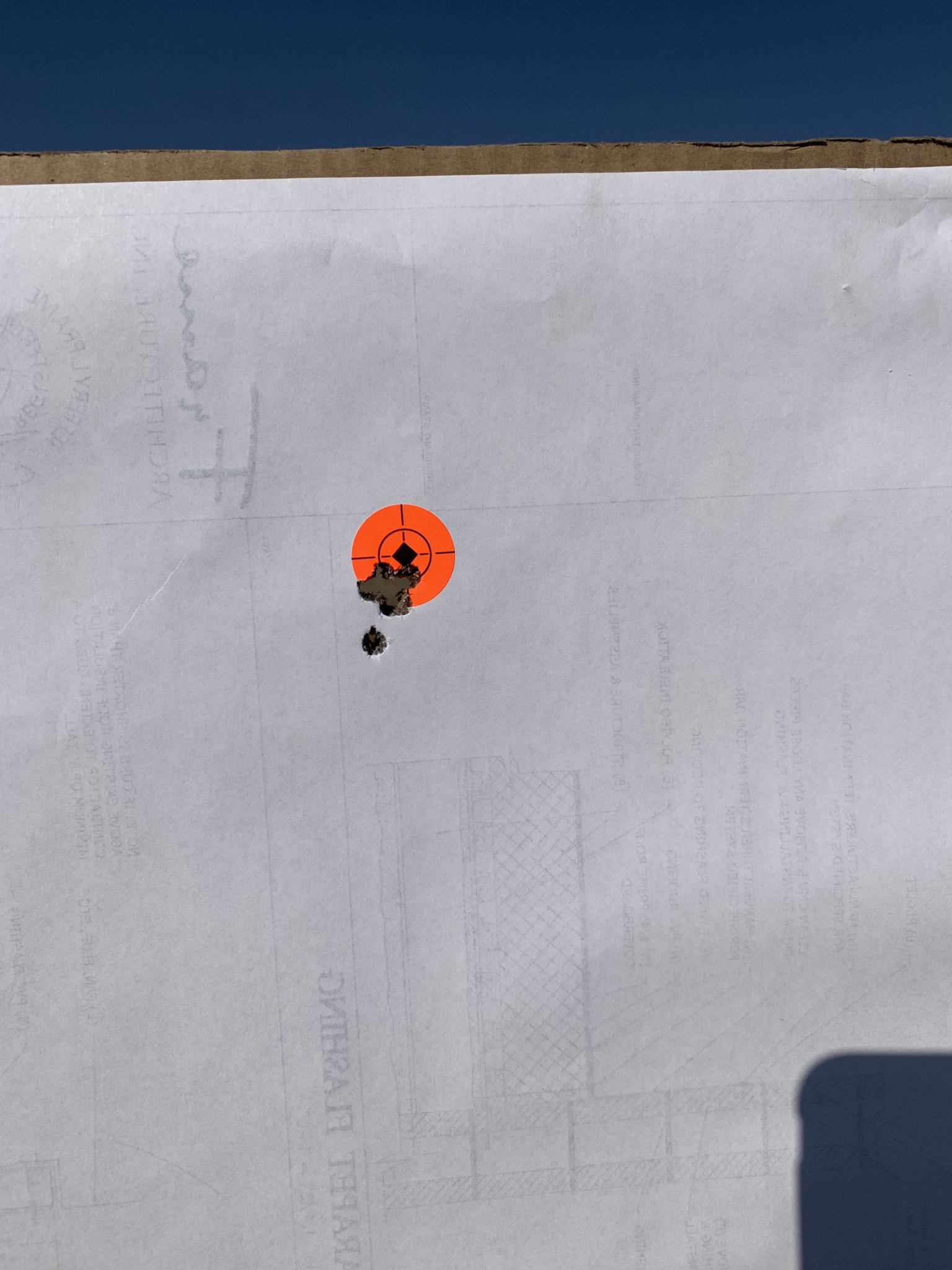

My definition of a node is a similar (mainly vertical) POI for a range of charges. Being in a node avoids landing on the edge of a POI shift. It has nothing to do with speed or numbers. Here’s another example.
I’d feel good about 45 on this target. Both sides of it show consistent vertical spread. But what if I randomly chose 45.5with no test? I would land on the edge of that POI shift down. Would it matter? I don’t know I’ve never attempted to land on the edge of a node. Could you tune it with seating depth? I don’t know. But POI shifts through different charge weights are real. Maybe it matters maybe it doesn’t. But considering how easy it is to test and avoid there’s no reason not to do it. You’re going to need to find your max load and check speed anyway. Just use that progression of rounds to check POI on the charges.

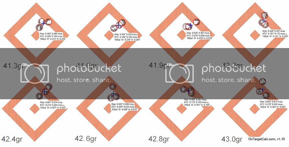

Here are 3 different things which someone may call a "node"...
- Powder charge: a charge range that results in a "flat spot" of similar velocities, i.e. 36.0gr - 36.3gr are all the same velocity (ignore group size and POI)
- Bullet jump: a range of jump values that results in minimal POI shift, or "vertical". See SAC/PRB data. (ignore group size and velocity)
- Group POI: call it the "OCW method", which looks at the POI of each group with varying powder charges (ignore group size and velocity), and selects the range which has the least POI variance
To me, as a complete non-expert, these are second order effects by which people attempt to hit a "node" but the first order definition of a "node" is when the muzzle is at either the top or bottom of the vibration sine wave as the bullet exits.
Am I wrong on this?

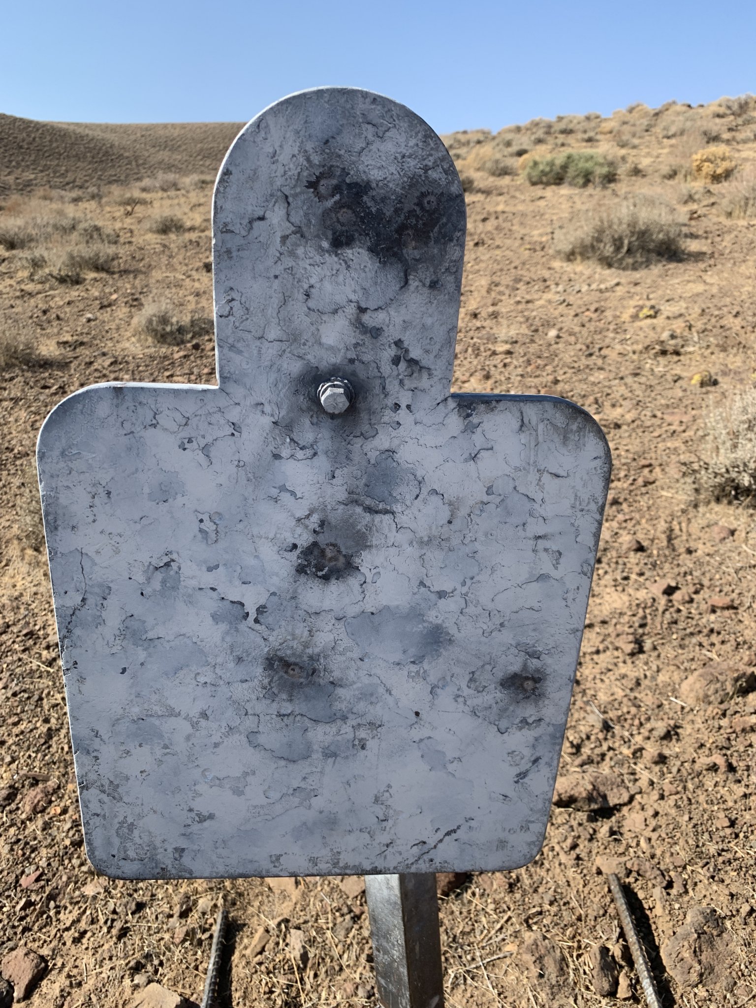

for all you node guys this is a 6BRA varget 109 hybrid all loaded on a Dillon 750 using the Dillon powder throw with up to a .6g(last I checked)difference in powder drops
11 rounds at 100yds
5 In the head at 714yds
@Dthomas3523
I agree 100% about powder...I do not do any brass prep as far as turning neck or uniforming primer pockets ECT and I recently started loading on a Dillon press...550 for a month or so now a 750.
11 rounds at 100yds
View attachment 7451029View attachment 7451030

@CarlosDJackal
Tell me why any of these charge weights wouldn’t work if I put them all on a piece of paper and pulled one out of a hat:
Node defined as a velocity flat spot is BS, maybe you get one most likely you will not.
And if you do get one 99% of the time you shoot the test again you will get different results.
I simply look for point of impact consistency for a range of consecutive charge weights that produce the velocity I am looking for.
If I can get say a charge of 41.1g to 41.5gr to group in the same spot that is my load. I will pick 41.4 and 41.3 and play with the

The chart you posted, if you are just picking out of a hat then why not just pick the highest velocity with lowest SD and your done.
Will the random load you picked give you consistency?
