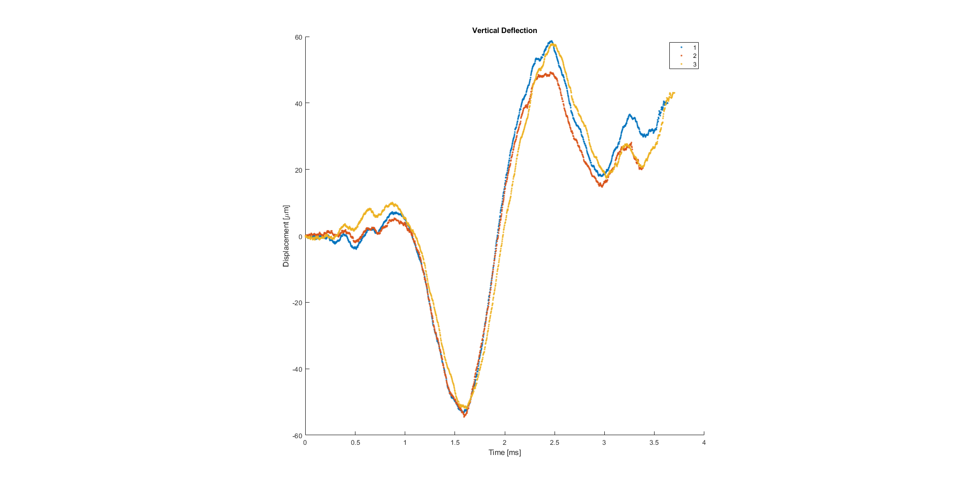

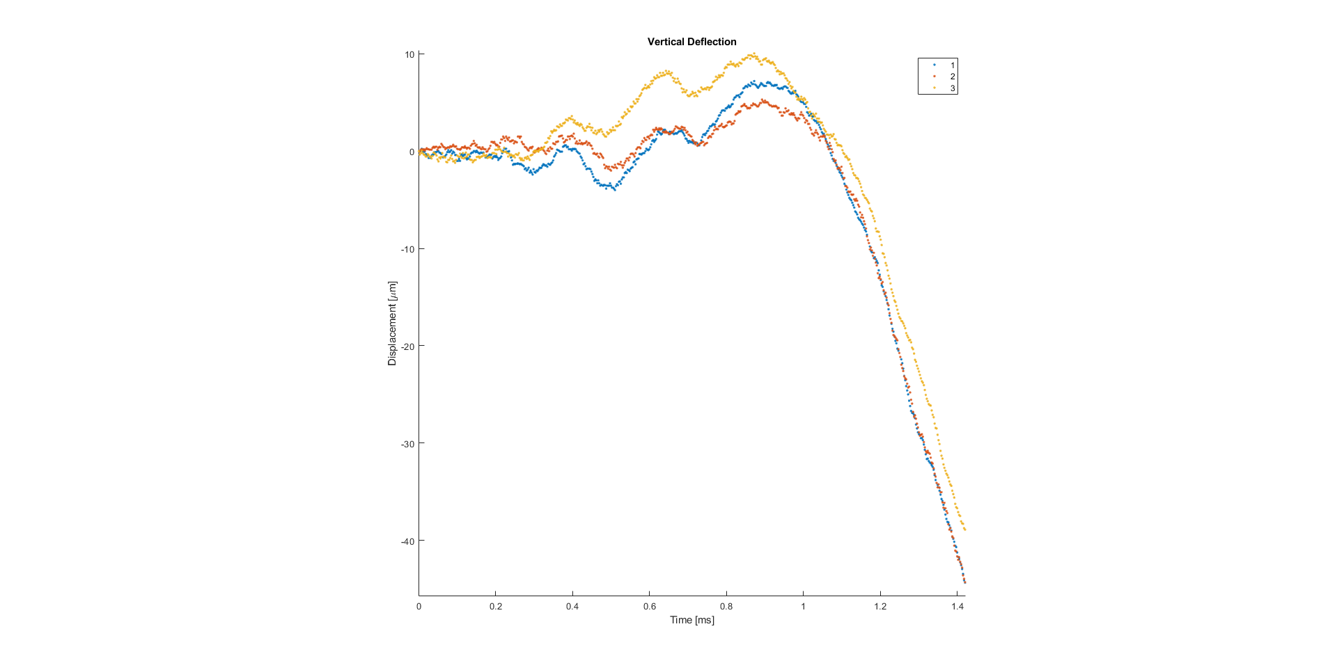

30k-ish worth of laser vibrometers. Specifically two Keyence LK-H027 sensor heads connected to a Keyence LK-G5001V controller. I won't be posting data until after it's published, but I will say that the overall curve shape is similar to those in the analysis I linked above. The primary difference is the presence of some higher frequency content that his model doesn't capture.
The higher frequency you are talking about is exactly what I mean by vibrations. As I said, in my mind it’s not a big wave in the barrel that you are looking to sync up woth. That’s just the easiest way to think about it. Im not talking about the bell swinging I’m talking about the bell ringing/vibrating.
Re: the site you linked with the models......I have a hard time believing the models mirror reality. The author said-
“The results showed that a more complex model was required to capture the dynamics of the complete rifle. There is a vertical plane of symmetry in the model and only motions in the vertical direction are calculated.”
If the dynamics of the whole rifle are not included and only vertical is calculated this is useless data about the forced response IMO. The missing parts/planes in the model would undoubtably affect the result of the vertical data. Every bit of the rifle is part of the equation and the reaction is dependent on the sum of its parts. Maybe I’m not understanding what he did. But the entire rifle and what it in interacting with would be important to take into account IMO.

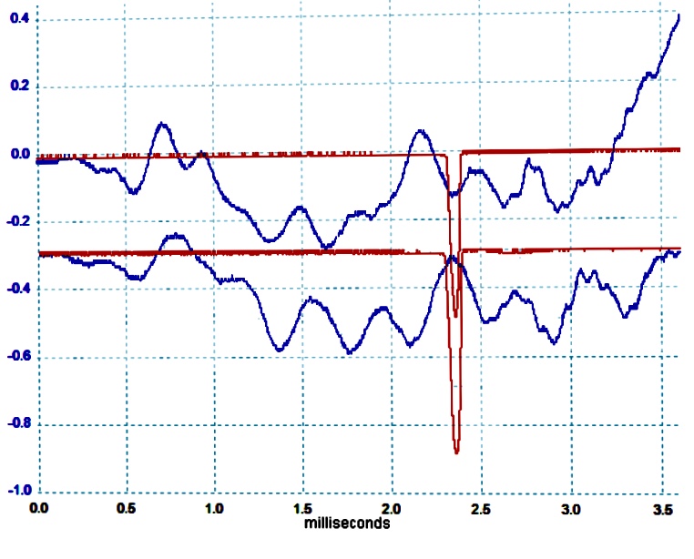

Study was done by Geoffrey Kolbe:
Rimfire 22LR fired twice with barrel tuner at different positions:
Muzzle position is measured at very high speed using an optical method, at microsecond resolution (every few millionth of a second).
Note that he has an optical sensor in place to detect exact bullet exit time, and the graphs were shifted to line up the bullet exit in each case (the dip in the red trace).
What is of interest here is that yes the barrel completes multiple vibration cycles before the bullet leaves (because 22LR is 3x slower than most centerfire calibers, there will be more cycles), but the muzzle position is far from a pure sine wave (the expected natural (harmonic) response of a steel pipe/beam or tuning fork that got a tap). Curve is much more complicated than that.
The two traces are somewhat similar, with the one blue line shifted to the right (due to barrel tuner moving out making the barrel vibrations ‘slower’), but they are not completely identical. Very many complex effects going on when a shot is fired, the bullet is accelerating down the barrel, the barrel expands (inflates) behind the bullet due to pressure expanding the ID, and that pulse in the steel races to the muzzle end at the speed of sound in steel (many times faster than the peak speed of the bullet) and reflects multiple times between action and muzzle before the bullet leaves the barrel. The barrel ‘whips’ in 3D in a very complex pattern, affected by the vibrations in the stock and even the scope all interacting.

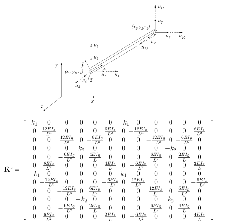

See Varmin Al’s simplified finite element simulation: Barrel, action, stock and scope all contribute and interact.
Also, positive compensation (PC) kicks in only when the bullet leaves the barrel when the muzzle end has the correct upward velocity (slope of the blue curve). Not all of these a-periodic cycles are wide enough to accomplish useful PC. But PC is not achieved at the peak or trough of the curve.
BTW: QuickLoads does not model this vibration aspect at all. Too complicated really to expect that. It tries to predict when the inflation pressure pulse will be at the muzzle end distorting the crown, which might also increase SD. Having the bullet exit at those time periods will be like shooting a damaged rifle with a badly mangled crown.
Kolbe could predict what bullet / barrel timing would give the smallest group due to positive compensation, and he was proved correct.
The theory actually worked.
Kolbe shows a pretty noisy pattern of data for a single shot. He doesn’t show that the pattern repeats identically for multiple shots, which it would have to if you are going to magically line up your bullet movements with these vibrations. I bet it doesn’t.
What is of interest here is that yes the barrel conoleted multiple vibratation cycles before the bullet leaves (because 22LR is 3x slower than most centerfire calibers), but the myzzle position is far from a pure sine wave (the expected natural (harmonic) response of a steel pipe/beam or tuning fork that got a tap). Much more complicated than that.
The two traces are somewhat similar, with the one blue line shifted to the right (due to barrel tuner moving out making the barrel vibrations ‘slower’), but they are not identical. Very many complex effects going on when a shot is fired, the bullet is accelerating down the barrel, the barrel expands behind the bullet due to pressure inflating the ID, and that pulse races to the muzzle end at the speed of sound in steel (many times faster than the peak speed of the bullet) and reflects multiple imes between action and muzzle before the bullet leaves the barrel, and the barrel ‘whips’ in 3D in a very complex pattern affected by the vibrations in the stock and even the scope.
See Varmin Al’s simplified finite element simulation: Barrel, action, stock and scope all contribute.
Also, positive compensation kicks in when the bullet leaves the barrel when the muzzle end has the correct upward velocity (slope of the blue curve). Not at the peak or trough of the curve. QuickLoads does not model this aspect correctly. Too complicated really.
He could predict what bullet / barrel timing would give the smallest group, and he was proved correct. The theory worked.
Yep, showing consistency is a thing if you’re looking to publish findings. I also find it interesting how/where the barreled action was clamped for the type of “testing” that was performed. The setup alone disallows any findings to translate to a typical barreled action in a stock/chassis.
And I’ll keep kicking this dead horse, the significant variance between contours/lengths would result in significant variance in frequency. So I’m honestly asking: how is it that we have “standard” loads that may only vary by 0.5% charge weight and/or seating depth with such a large variation in barrel geometry?
Yes, this study has several limitations. Also explored new ground in multiple areas (Instrumentation, and predicting reliably where positive comp will appear), so it moved the science forward. His group size did come down nicely, so many shots were fired, but apparently not measured (or at least not published).

I will be doing more test firing, but I doubt I will ever do a full 20 shot string. Here are two plots of the same three test firings taken at a point 6 inches from the muzzle. I'm still having a few issues with the firing mechanism causing overall drift in the data (data series 3 gaining amplitude at the beginning), but you can see that even the higher frequency data is relatively consistent between shots. In this case bullet exit occurs at about 1.37ms.
View attachment 7453693View attachment 7453694
Did any of his real world test fires print higher with weight toward the muzzle by increasing dwell time? Maybe I missed it but all printed progressively lower depending on how much weight was placed toward the end of the barrel, right? IMO he hasn’t’ proved anything until the real world bullet impact follows the model through a change of direction.
I’d be curious how you and others are mounting the rifle for testing. Is it in a vice? Wouldn’t this skew the result by increasing the forced response? If it’s not it a vice how do you prove the movement is not from the movement of the entire rifle? IMO you would need a sensor mounted at the chamber and a sensor mounted at the muzzle so you could record the relationship between the two. Then you would know how much the barrel itself is deflecting under normal firing conditions. The big question(for looking at actual barrel deflection) is how much is the barrel bending, not how much the barrel is moving. How are you making sure that’s the data you are recording? Not being combative I’m genuinely curious.
I haven't gone back through all of his plots, but I found at least one pretty quickly where the POI ended up almost exactly the same with and without the weight. As a purely anecdotal aside, I've had a rifle where the POI moved up when I mounted a suppressor.
My mounting system is extremely minimal (rifle barely supported), exactly due to the things you mention. The biggest thing to remember is that this is happening extremely quickly, under 2 milliseconds. Movement of the rifle itself is very small, perhaps a 10th of an inch in rearward travel while the projectile is in bore, and any rigid body rotation is smaller yet. The other thing to keep in mind is that I'm trying to match boundary conditions to my model, where I also capture a combination of barrel and rifle motion. Separating barrel movement from the overall movement is counterproductive in my case. Finally, total firearm movement is what actually matters for dispersion, not the barrel alone. What I measure is almost exactly what the bullet would experience being fired from a free-recoil position at a PRS match.

How is the second moment of area not relevant? That and modulus of elasticity will dictate deflection relative to the “loading”
What’s the formula you’re using to back up your observations of deflection?
Modulus is not enough different between the various barrel steels to be significant. Second moment would affect the amplitude, but not the frequency. This also has the potential to explain why larger contour barrels are less sensitive in general.
I'm not using a formula, it's a fully 3D finite element model.

We don't have to "prove" or wonder what barrel "harmonics" look like, people have been measuring barrel movement in one way or another for almost 100 years. This isn't black magic, it just happens that your average shooter doesn't bother to read scientific journals and conference proceedings where these things are published.
No offense man, but of course you’re using a formula. A stiffness matrix is a primary component of an Finite Element Analysis. I’ve had to set up and solve loads of these by hand back in my college days. Modulus of elasticity and second moment of area are primary driving factors in your stiffness matrix.
I have to ask, have you ever solved an FEA by hand - no computer ?
Have you seen data showing disturbances in the barrel itself, void of any outside noise from recoil or movement of the rifle? To me this what “harmonics” generally refers to- disturbances of some kind within the rifle system itself. This is what I thought you were posting before but you’ve explained that your measuring movement of the entire system. Of course movement of the entire rifle matters on target. But when attempting to describe/measure harmonics(in the sense that they are approached in load development) you would need to isolate disturbances within the barrel itself. Please post what you have seen/read that shows this. That’s not an Internet challenge I genuinely want to see the data.
