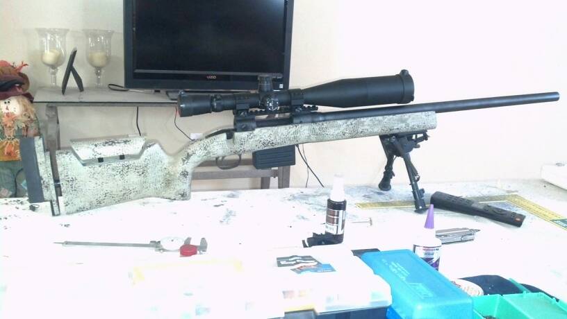

I have the same HS stock on my savage. Its lacking a bit in ergonomic feel. I don't like the palm swell. I can see why one would prefer manners or McMillan. That said, integrate a cheek piece and adjustable butt and it will feel much better:
