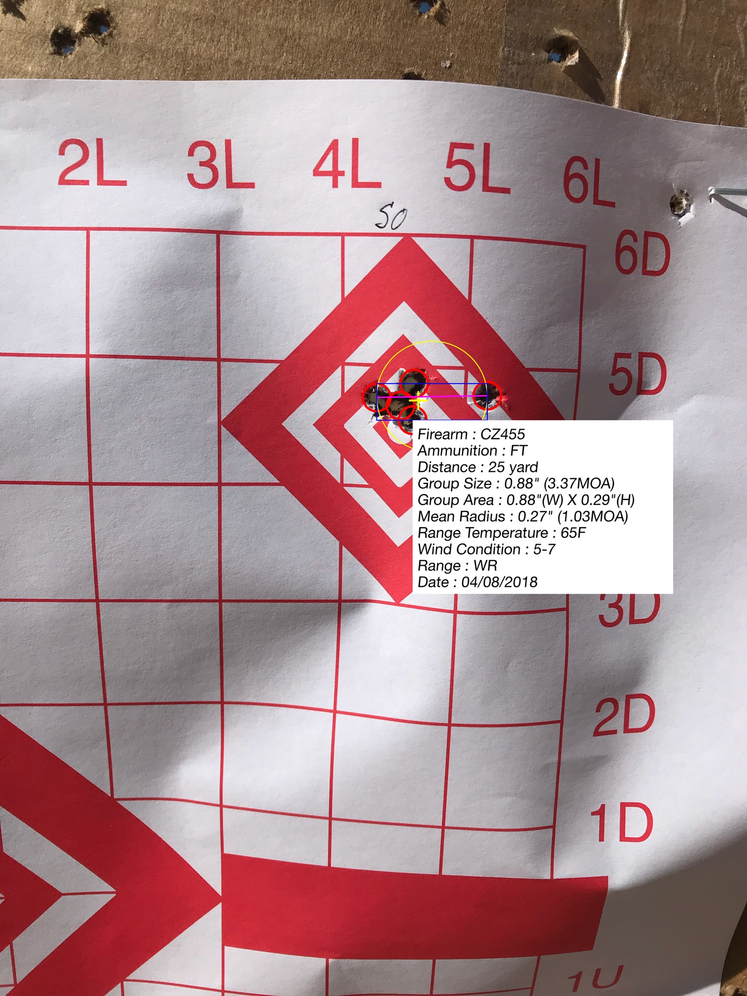

So had a few good shots in today, was pressed for time and was only able to gather data to 71 yards. Best and one of the few groups was 3.37 MOA (ish) 5 shot. Most of the others I was trying to gather data. Hopefully next Sunday I will be able to push it out further and maybe do some dot drills. As you can tell, I have a LONG way to go.
Anyways, obligatory best group pic... fist round flyer is all me, jerked the piss out of that one, settled down for the last four. Shot from a rolled up wool blanket and a rear bag. Love the stock.

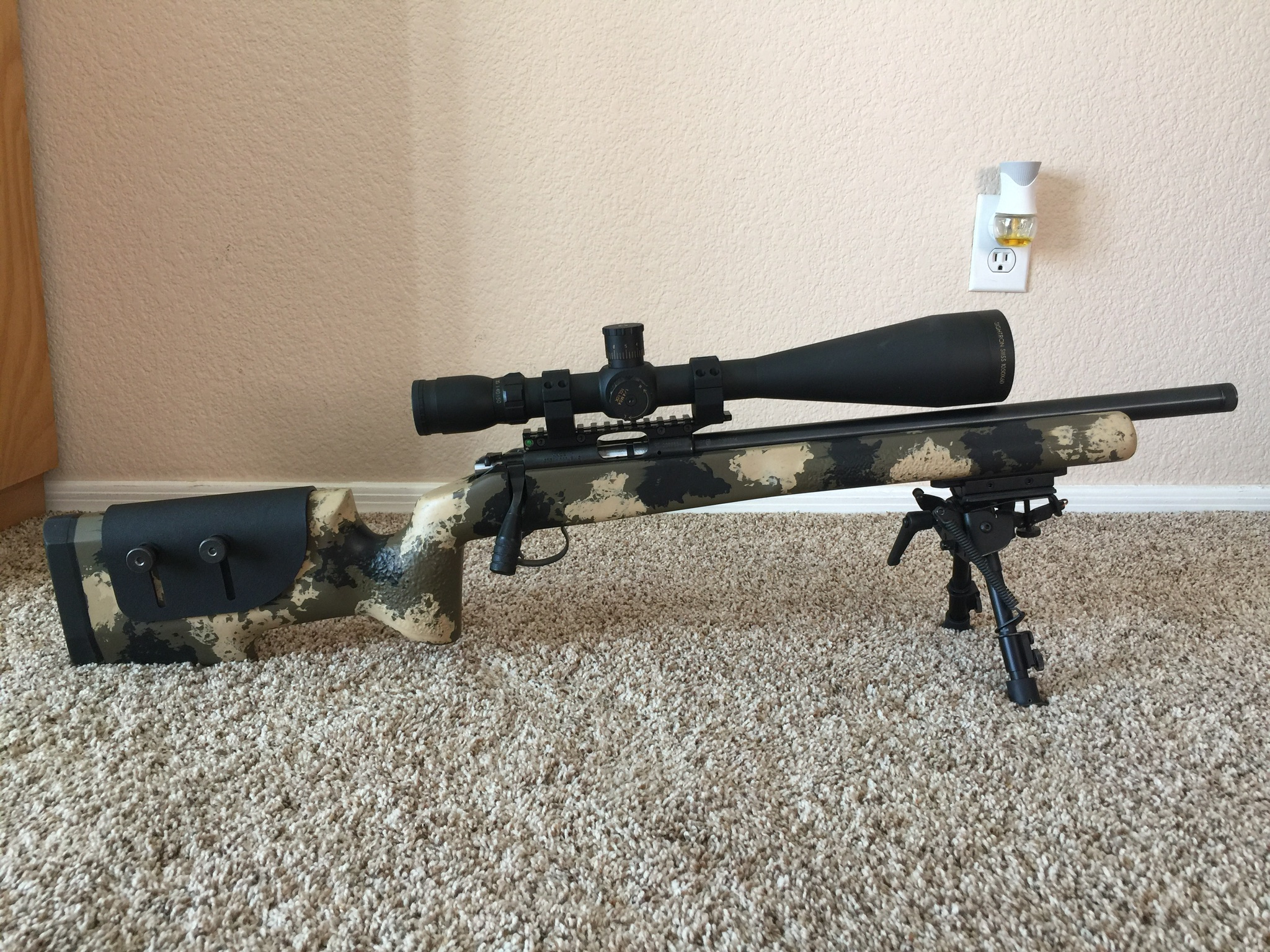

I have the Area 419 and to me it’s way better than the DIP I found the dip to slide on easily while the Area 419 is very snug going on and had to tap it on and once torqued I don’t think it will ever move.
Here it is on my 455 with Sightron SIII 10-50x60which is not a lightweight scope.
