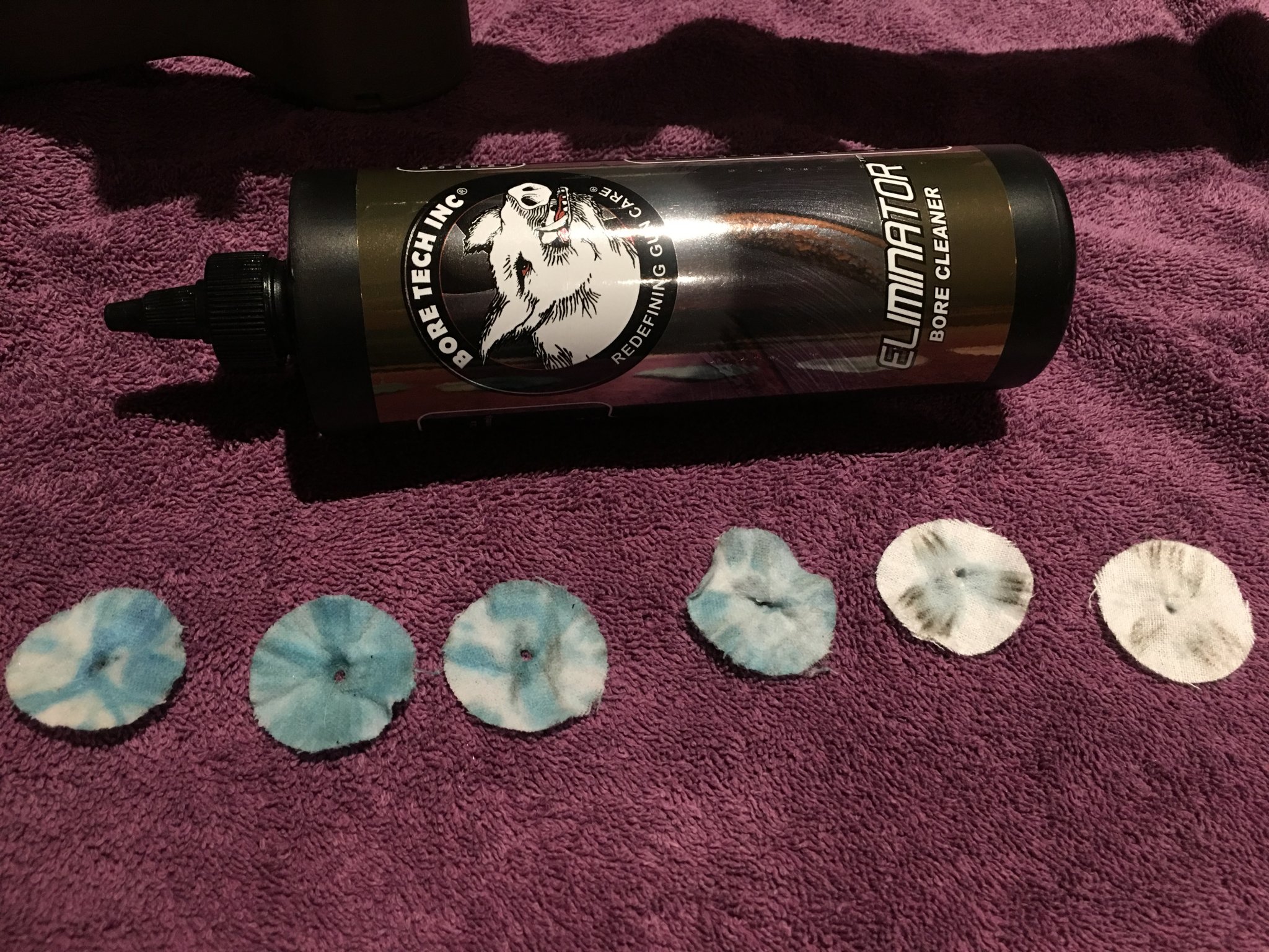

I think I just found my go to cleaning solvent.

Eliminator is what made me a believer in Bore Tech for cleaning products several months ago. I bought a bottle on recommendation and was blown away by how well it works. I've used almost every be cleaner out there and there's some that work a little better than others, but the good ones all work about the same. Eliminator works way better than all of them. Unless the fouling is heavy you don't even need to pull out a brush to clean. I run 3 soaking wet patches, let it sit for about 5 minutes, run another wet patch, and after another 5 minutes another wet patch and that's usually all thats needed. Even my 6.5x47 that had 600 rounds through it since cleaning cleaned right up like this.
About 2 months ago I bought a 6mm Proof Positive Bore Stix and a proof positive jag based on another recommendation after using Deweys for years, and again, Bore Tech is a superior product in every way. My Deweys would constantly unscrew during use which I never knew why until after I got the Bore Tech which didn't and I researched it and found out why. Bore Tech claims their's don't unscrew because of the bearing design, and damned if it doesn't work. I also love the 8-32 female thread tip so no silly adaptors to mess around with.
A week after I got the rod I ended up placing a big order at Bore Tech basically replacing everything. I got their bore guides, custom collars for my rifles, proof positive jags and nylon brushes in all the sizes I use, and a slew of other stuff. I can honestly say that Bore Tech is hands down the best cleaning products I've ever used and it makes gun cleaning not suck.
Also try their case cleaner in your SS tumblers. I started using it mid last year and it works wonders. I use about 1-1.5oz of it with warm water (no lemishine or dawn) and after 10 minutes my cases are clean. The short tumbling time eliminates the peened necks and mouths.
I've also heard the C4 is pretty much the best when it comes to removing carbon rings so I picked up 16oz of it too, but thankfully I haven't been able to test that yet.
