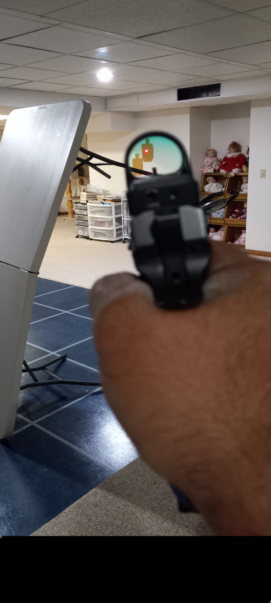

Here's what a 10 moa dot looks like on a 1/3 scale uspsa at about 8 yards, so this would be a 24 - 25 yd shot IRL. It's faster for my eye to center that on the lower A zone or head box than a much smaller dot.
It's the only way to get bigger lens.
I've concealed a G17 with an SRO with zero problems AIWB. The bulk of the optic sits right at the belt line.
It's not as big of an issue to conceal a larger optic as some make it out to be.
I should have looked before I spoke there's not a significant difference...I am going to have to take a look at the HD.
Thanks for the picture.
Just curious what you shoot - what gun is that SRO mounted upon?
The pistol is a CZ Shadow 2. The sight is a C-More RTS2.
I have two SROs and one of them is what used to be on that gun. But the SRO's biggest dot is 5 moa and I wanted to try something much larger.

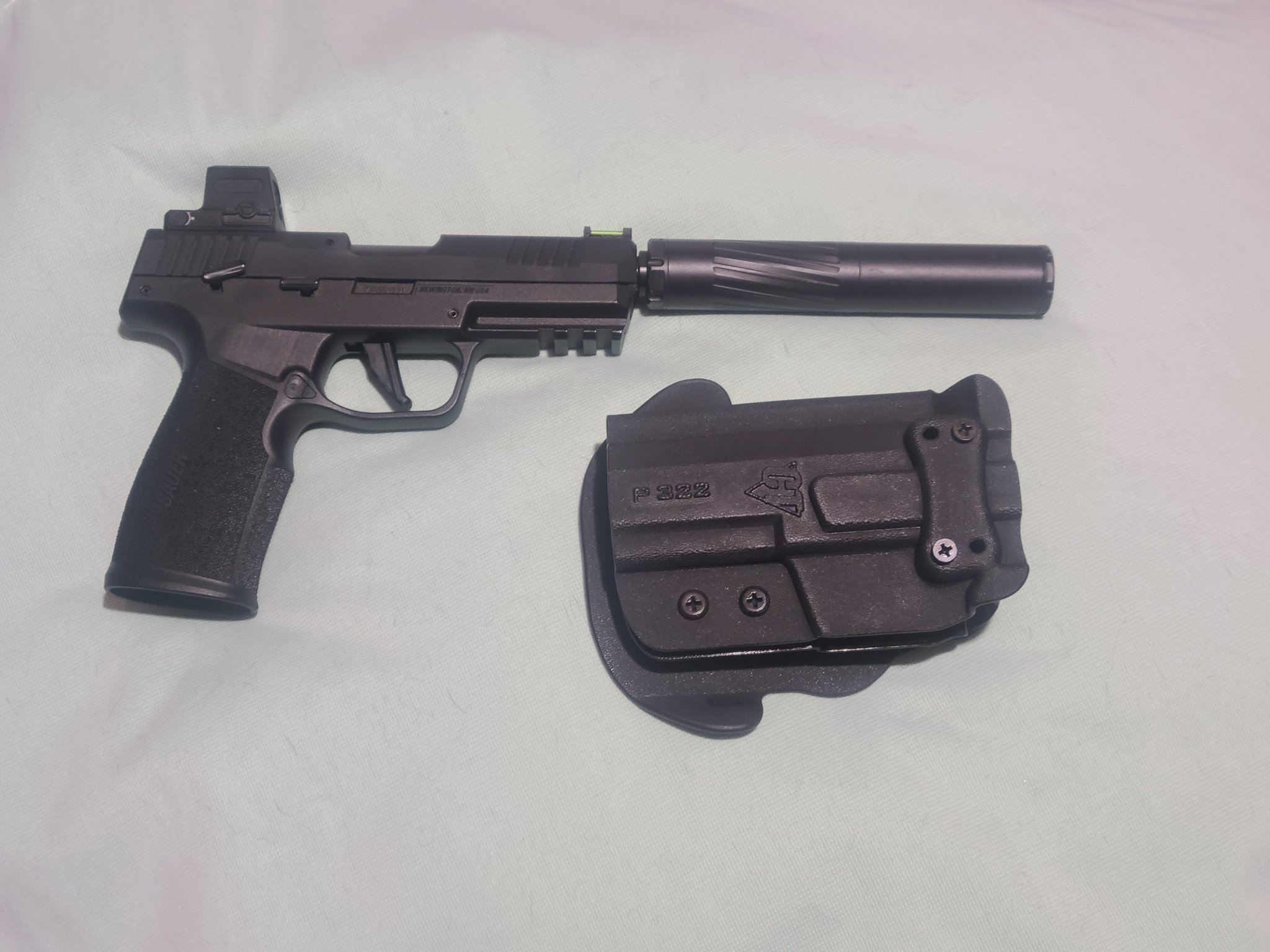

I shot the cheap dot Saturday night. I decided I really like the red dot. It started out almost zeroed, adjusted and shot about 40 rounds of draw and shoot a single shot on the timer. After we were warmed up and started feeling good we switched to fresh targets and I shot a Bill drill. Way slower than I thought I would be and only got 5 in the A zone. On the second try at a Bill drill, something happened... After the second shot I did not see a red dot anymore and something smacked me in my mouth. It was the glass flying out. I'm slightly disappointed, but not suprised at all. I'll see if I can get it replaced or returned, it has a one year warranty.

I've got the holosun eps carry green mrs. Narrower body but I like it. Have it on my Sig 322 22lr pistol. First optics cut gun I have and wanted to try it out. It's one of my guns that I can get my wife to shoot. Now it has me wanting to get a Walther pdp pro SD 4" with a holosun eps green mrs or eps green 6.
