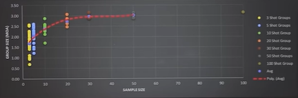

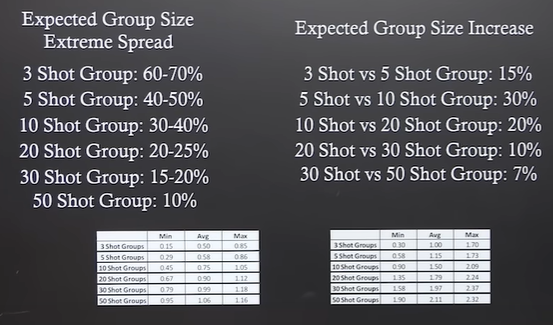

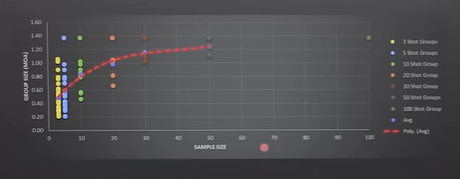

For Software hit probability purposes the ES of the group size for the half minute gun is .7" for the 3 shot group.
The 1 minute gun has a 3 shot group ES of 1.4" & requires a 30 shot group to achieve a group ES of .79 i.e. close equivalent predictive accuracy.
The graph used in the podcast is a little misleading since it's scaled to show at the same size. The 1 moa gun graph is condensed by over 100%, if it wasn't the group ES dispersion disparity would be a lot more obvious.
If your gun shoots 1 moa 3 shot groups tomato stake that POS.
1 moa 20 shot barrel is certainly workable. Problem is we all speak different languages when it comes to the moa of our rig.
The same data sets used below to show the value of high shot groups can be reversed in our favor.
So if I want to develop a load using 4 different projectiles & 4 different powders at multiple charge weights there's no need to burn out the barrel. I am about to do this for a 22GT.
Per stats below if I toss any 3 shot load over say .6 and short list anything shooting .4 or less for more testing. Anything that'll maintain a .4 avg 3 shot group, statistically should not exceed .72" for a 20 shot zero.
Another take away I hadn't realized before is that the group size ES is statistically worse for a 10 shot group than a 5.

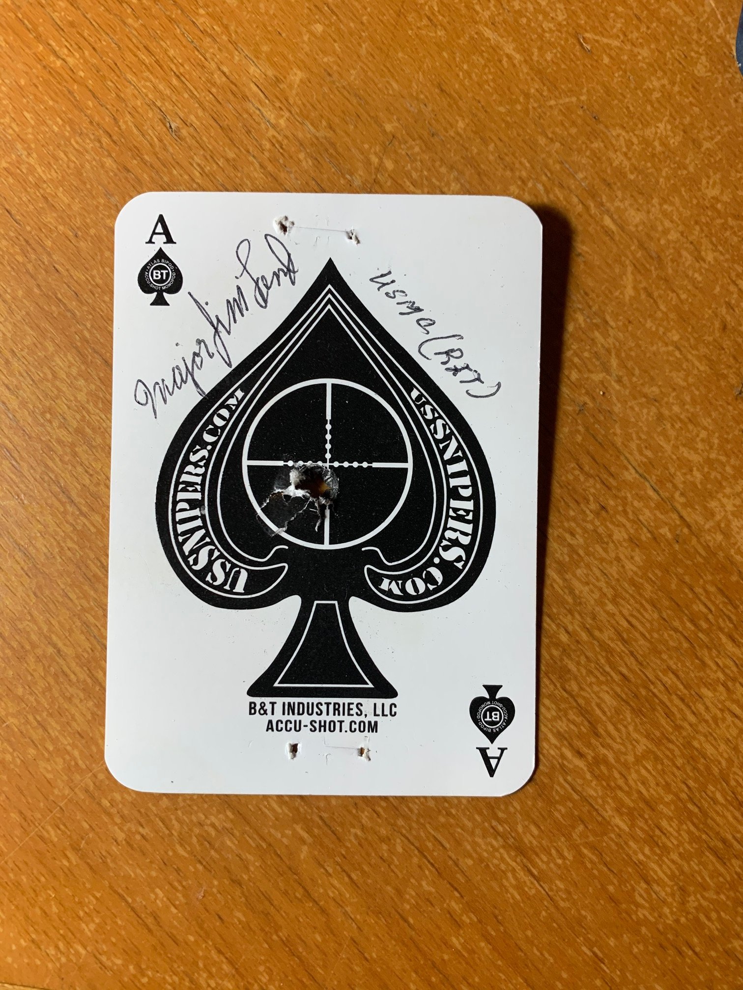

One good habit I've started doing is to recheck my zero on the gun after it's fouled, and again after day 1 of a 2 day match or after a 1 day before cleaning.
Those damn Ace of Spades often happen after 85-90 rounds.

And, I've done the work, and have REAL samples in the REAL shooting world to prove it. Outliers are real, and they can only be ironed out (maybe) by increasing the sample size. In small samples containing outliers the distribution becomes NOT NORMAL, therefore useless as a predictive tool.
In shooting it happens all the time. Someone shoots a nice 1/2 MOA 3-shot group. Then they shoot another 3-shot group, two shots are close to each other and one is wide. The group is now 1 MOA. The shooter says: "Man, I got a "Flyer" (an outlier), so I'm not going to count that one - I have a 1/2-MOA rifle!"
I call bullshit. Somewhere in the REAL world there is a piece of paper with three shots that are 1-MOA apart, for you and your rifle.

The follow up video came out today. Here are the highlights.
I am not a court reporter, so some of my words may be slightly different than theirs, sorry but ya get what ya paid for....
0:00 Intro, a follow up to the previous podcast video
4:00 A 500 shot group didn’t significantly change past 50 shots
6:00 Discussed the procedure used for the rail gun in their lab.
7:00 Barrel heat and cadence
  • Cadence was discussed for difference between cooling off versus long strings.
  • 30 – 50 shots was too much even for the 1.25” Dia Test barrel profile of the rail gun
  • Their test barrels are typically SS single point cut rifling, not button rifles which may have issues with heat
11:00 Was the last video a conspiracy to sell more bullets, ha ha ha, lol.
14:00 Pick a load and go, versus waste time and resources on false load development
14:40 They reiterated the stats problem with small samples
17:30 Why do we shoot groups at all? To predict the future shots.
21:13 Do what you want to, but own it. We ain’t telling you to follow us if you don’t want to.

52:50 Miles stated that almost nothing hits dead center. The statistical distribution looks like a volcano with a dip at the center of the group.
54:15 Miles on group metrics
  • Group size versus mean radius or SD
  • He prefers the mean radius
  • He likes to estimate a capability at +/- 2 Sigma
  • Prefers not to rely on just the ES or group size alone.
56:00 Jayden’s take
  • Group size only uses outer shots
  • Mean Radius uses more of the data
  • Looking at all of the data is better than looking at just the two outer ones
59:00 Discussion of CEP and other group metrics that use more of the data.
60:00 Discussion of future topics
  • Chamber designs and jump sensitivity of bullet designs
  • Barrel Tuners
End of session.
