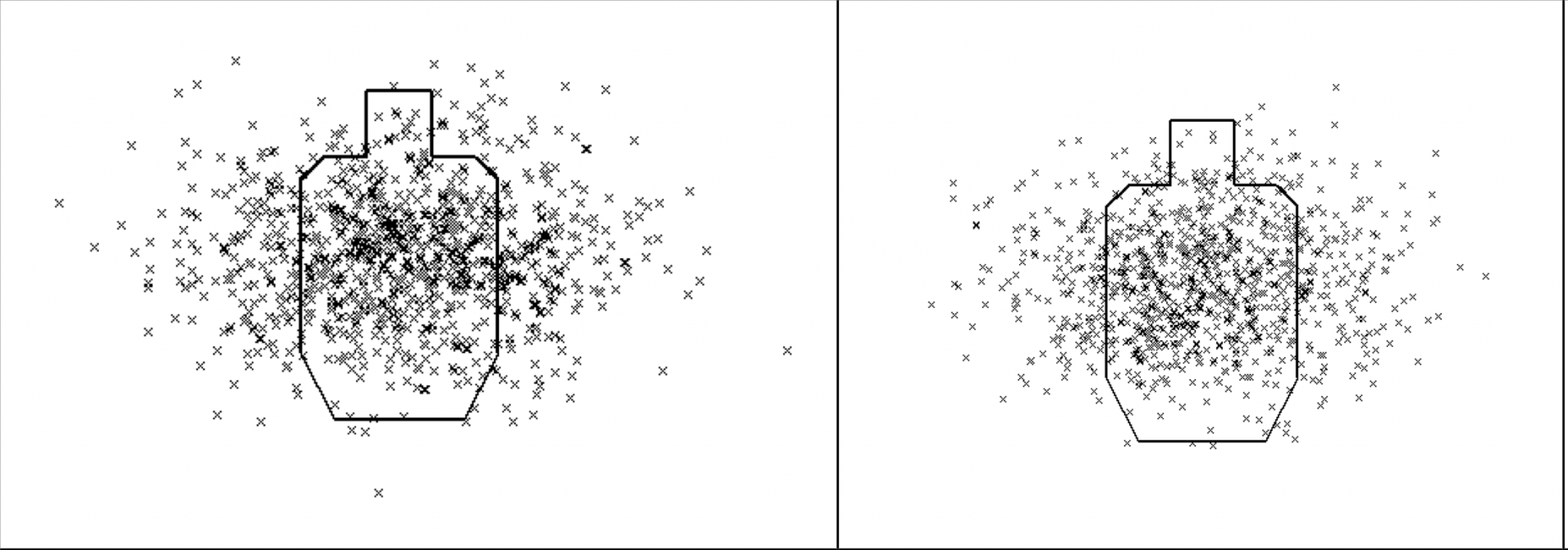

I think people forget why we shoot groups. it doesn't follow at all "your groups are too small" if larger groups take longer to shoot, as 30 and 50 shot groups definitely do. larger groups are longer duration groups, all other things equal...larger, longer duration groups are inherently less "accurate" when shot in field conditions by normal humans.
But the induced innaccuracy of larger groups, to a first approximation, is not simple stochastic variance...and thus it doesn't go away by shooting larger groups (sample sizes)...its just the opposite, actually...and this is thus essentially a boring and tedious point to make the title of the Podcast.
If we are exploring accuracy limits (as in clinics, comps and load dev, etc) we want to shoot in format that is more accurate not less. that means shorter time windows, and smaller groups that go with them...all other things equal. The "innaccuracy" induced by the TIME ...doesn't get removed by shooting larger groups, over longer periods of time, because the source of innacuracy correlates to the time exposure.

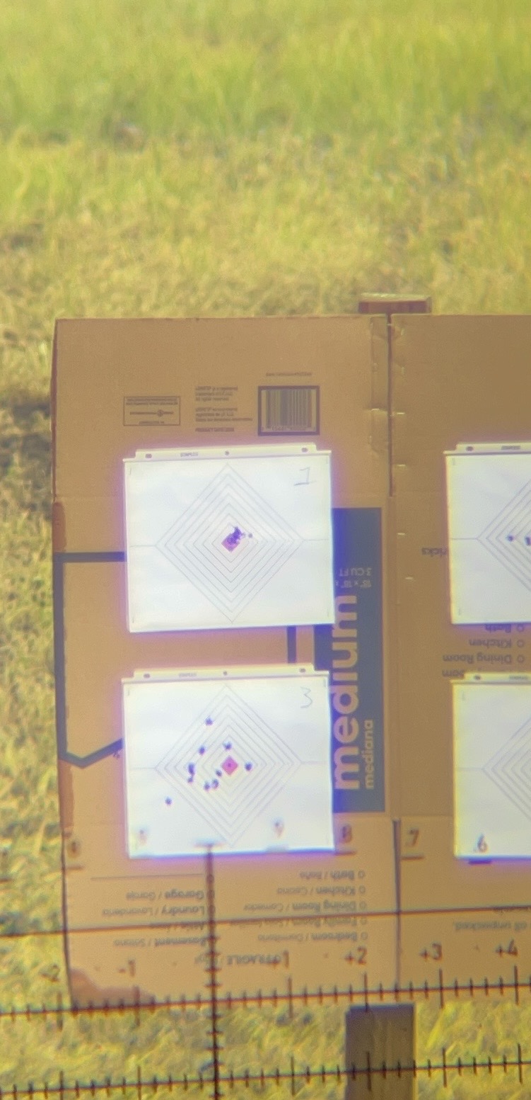

I'm not sure that's correct. Larger groups can be a lot of 5-shot groups. I have just that example from this morning. I went to the range this morning and tested 3 different brands of .223 ammo. I fired a total of 70 rounds. All shot and chronographed in many discrete 5 shot group shot consecutively, with four "cold range" calls interrupting.
Guess which ammo did the worst? Yup,the first one tested. Worst Chrono data and worst accuracy. The Best was the second one tested, and it barely won over the third one.
So, I have to kind of disagree with the premise that "longer duration groups are less "accurate"". Unless it's a semantics issue that I'm not following...
It's common sense, we cannot maintain our focus like that unless you are a world class athlete
You can shoot 5 x 5 and breaking it up is not the same as trying to do a 25 shot group in one sitting, but you can do 25 in blocks, that is what he is saying.
The biggest issue is recoil, it moves us and we have to reset the position which changes the variables. Using a fixture like they do, and the fucking barrels are giant, so fuck the guys that think its' the same, the fixture stuff I know Hornady has and I have seen are nothing like our "Guns" and as noted, the fixture vs human discussions was put to bed years ago, funny we have to revisit, the Human Factor cannot be under or overstated.
The test would be, get a bag of ammo, start shooting a group and don't stop until you drop one outside what you consider correct. Everyone is different, where you fall down has a ton of factors. Sports medicine is real, they know what happens to our bodies and mind with these types of endeavors, it takes a lot to overcome it.

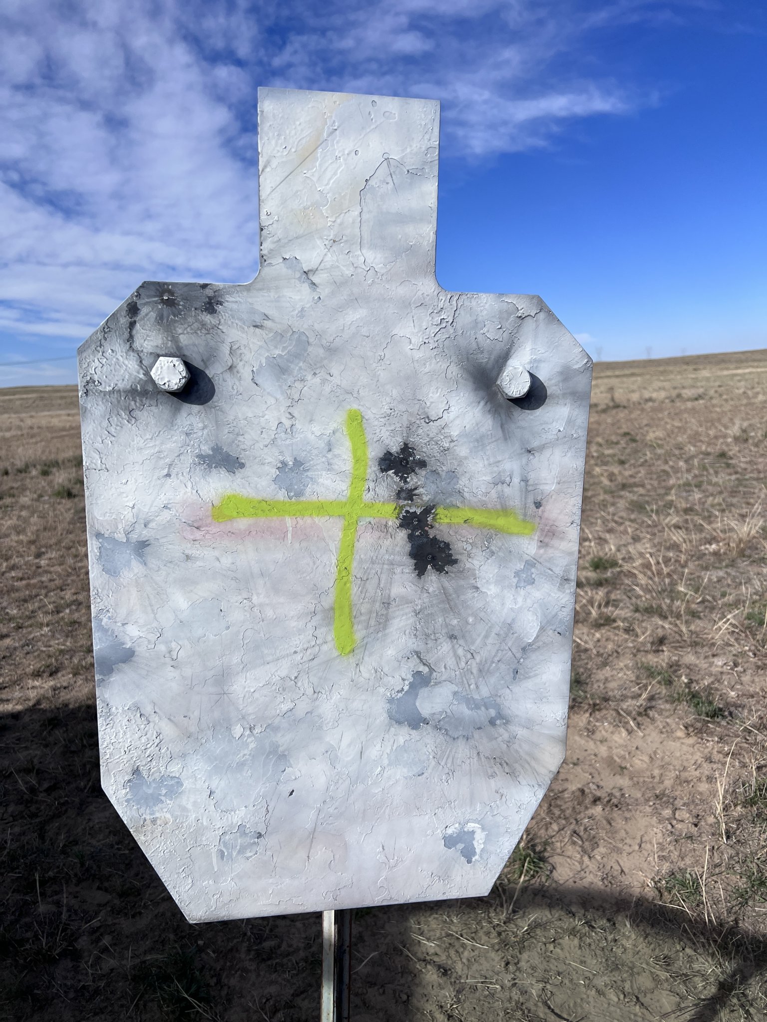

A Kraft Target Drill, 3 shots, prone, sitting, kneeling, standing, from support. The target on the top is a mentored shooter, the target at the bottom was a high end Law Enforcement Division.
Saying a plate shooter needs to be doing X which is more on par with what we see in the BR world is the controversy, hence a well made viral podcast.

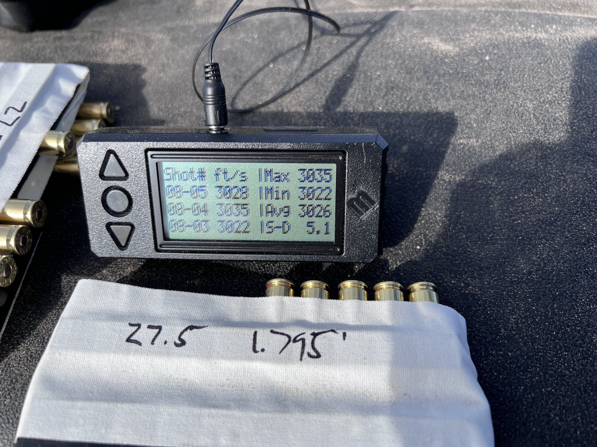

When I ran the machines and one of the semiconductor fabs I had to manage the following for a simple resistance measurement:
Wafer to Wafer Variation Avg
Wafer to Wafer Variation Std Dev
Within Wafer Variation Avg
Within Wafer Variation Std Dev
Tool to tool variation Avg
Tool to tool variation Std Dev
Its rare that people understand how these interact with each other and tbh i see 0 discussion of how the variations mix.
Most people can tell you the SD, but they have no idea what it represents.
Fewer can tell you how the SD of the Ammo combines with the SD of the Shooter.
TLDR Version: Statistics isn't "More Data"-- A real discussion of "how many rounds to zero your rifle" needs to take into account the shooter, the equipment, and the conditions.

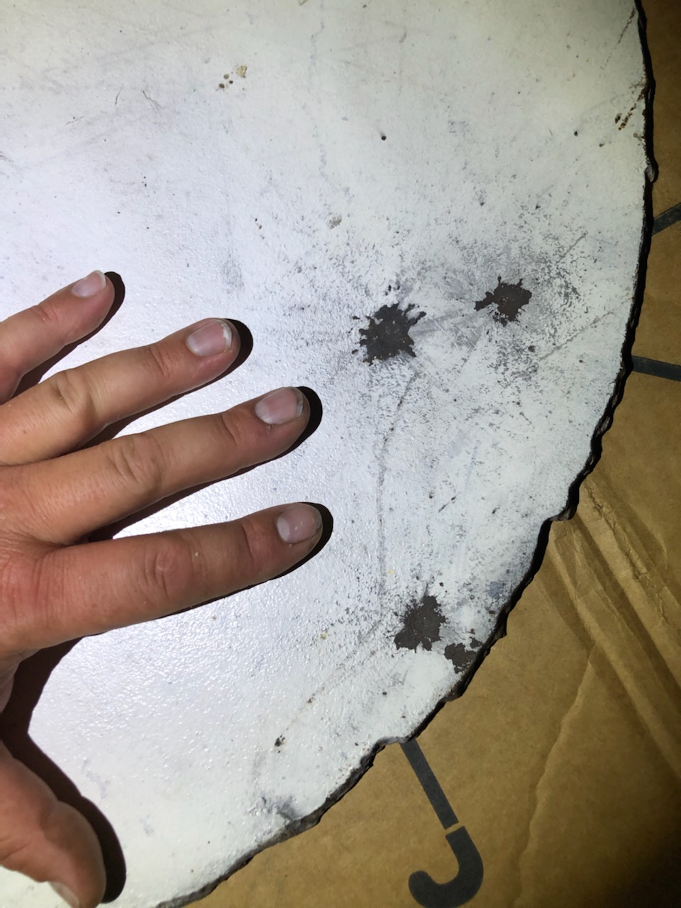

Wep Math worked like magic for me. Never owned a chrono until this last Christmas. Wife got me one :ROFLMAO: .
I set up a new 6mm rifle from scratch last year and I used Wep Math exclusively, using the factory ammo box number for velocity and validating it as I went.
How good did it work? I'll tell ya! By the time I got to steel at 626 yards for the first time well, my cold bore shot is below. OK! So it was low but by only ~.2 freakin mils!
To me Wep Math was indispensable. As a matter of fact, I used to get home from a shoot, get myself a scotch and my calipers and adjust my 4DOF calculator. That said I have it dialed in now but I'm still going after a better zero. Can't argue with more excuses to go shooting!
That all said, once dialed in 4DOF works perfectly. And that zero angle shit is a perfect solution for a "forever zero". Sweet!
Cold Bore 626 Yards - All Wep Math:

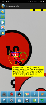

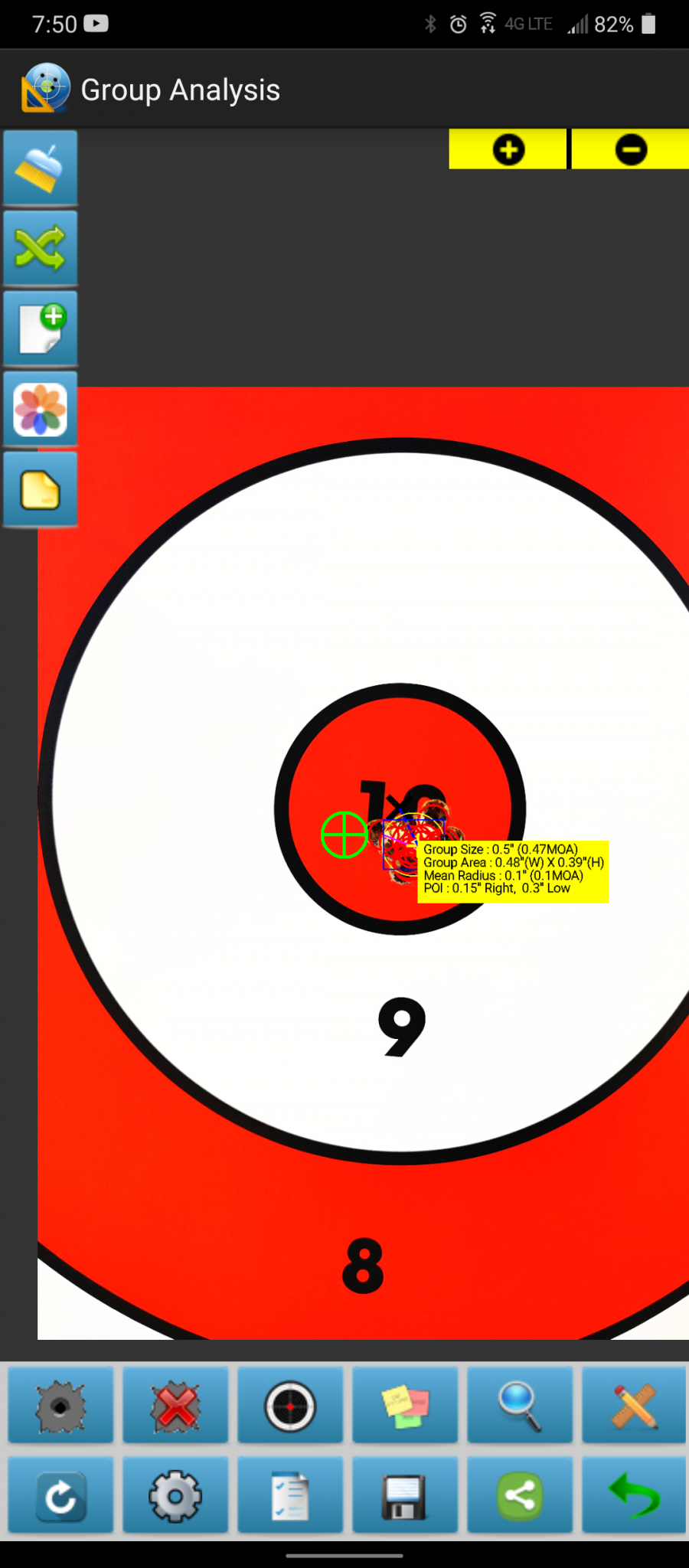

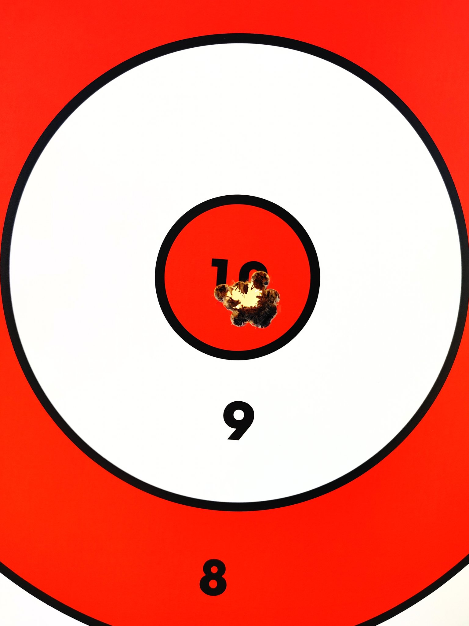

So I tested this stuff this weekend just to see if theres something to it. I dont think I learned anything just burned 60 rounds of components. Two 30 shot groups. I guess I should have shot 50 round groups then thy would open up. 100 yards 6 dasher hawk hill heavy comp.

Here was my success story, I was loading for the Valkyrie, I knew I needed speed so I loaded it for 2950+ and by chance landed right at 3025fps with an SD of 5....
So if you look at the seating depth I had several loads, 1.7 to 1.795, which this one was good. However the group was about 3/4 of an inch at 100, not good.
So I added a tuner and didn't even dial it in yet and an my group immediately went to 1/2" and at 600 I did this :
Now I have a 1/2" group at 100, and 4" vertical at 600, I bet I can now tune this guy even better because I haven't' even messed with it. I can now dial this guy in , even at distance.
