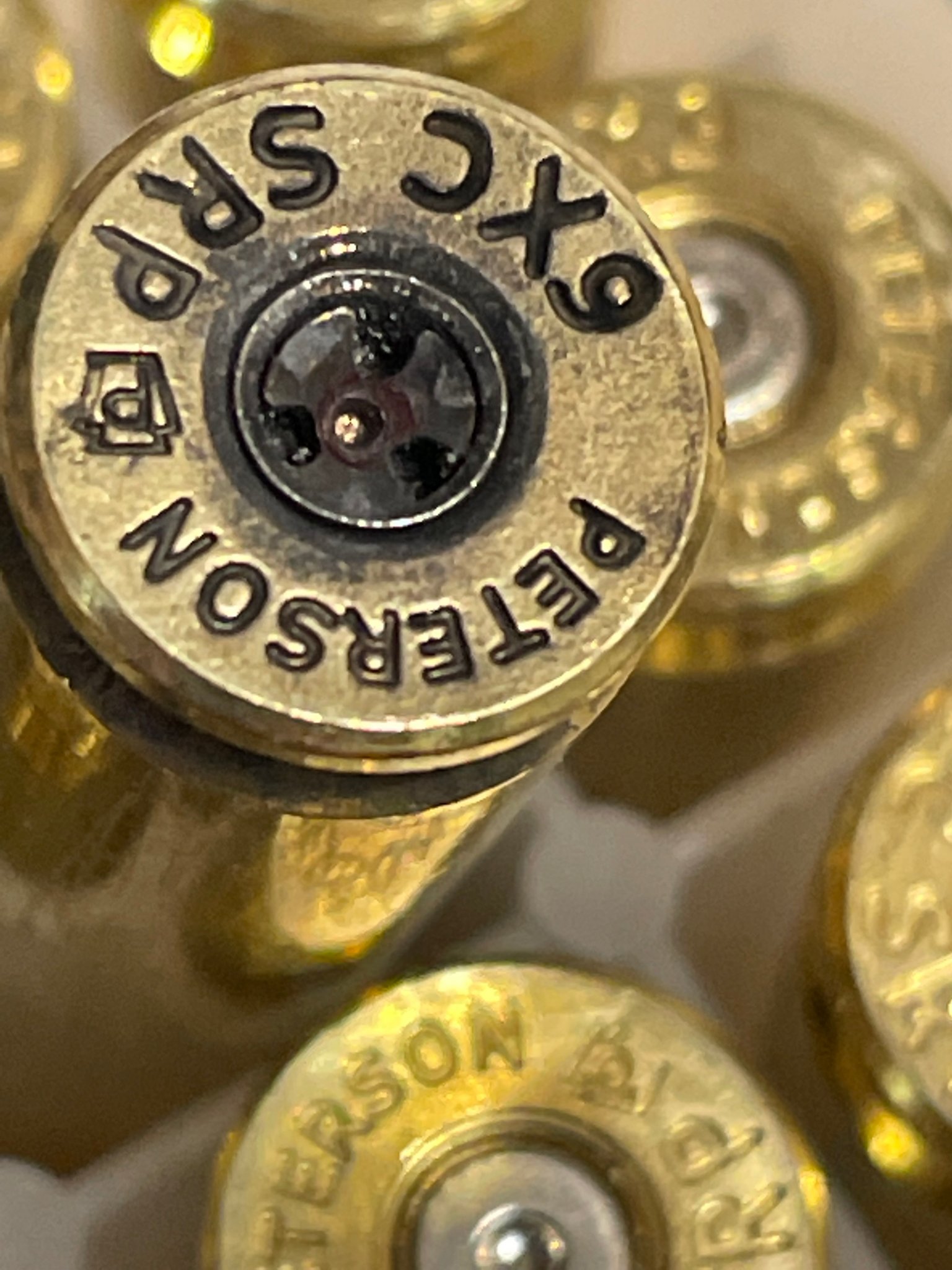

If your neck thickness is .014 and a fired case is .296 then you should have .268 ID on a fired case. Your bullet is .264 but won’t fit in .268. 🤔
If your necks are too long the case mouth will pinch the bullet when the bolt closes.
I'm old to and shoot alot,I find if you run to hot of a load 41.5 say of h4350 to fire for new brass is a waste of time I'm with bad eyes with no glasses so I check everything twice then again ladder testing! I want everything perfect so if need be ill ream a new chamber to hang my creed bullet out the case like a 7 mm mag I was a little machinist boy at 16 then after put my self through college and many degrees pursued. A career in education in Elizabeth nj teaching vocational machining I'm my experience your finesse and feel dictates my fit in a build even with custom made barrels the chamber can be to tight Evan for new brass in any dimension, burrs sharp angles lack their of can run havoc! I got go no go gage and use it but it's a not a finish tool it's a ball park parameters! If I got to rent a chamber gauge from Manson tools to finish clean the chamber to my comfortability then I stop shooting right away and get her dome! The manufacturer don't dictate what's perfect I do !
The case mouth ID is smaller than the rest of the neck, therefore the bullet won’t drop in.
Case mouth = .268
Bullet OD = .264
Bullet OD is smaller than case ID therefore bullet should fall in!
Measure the case. The case mouth diameter is smaller than the rest of the neck. The harder the neck, the smaller the case mouth diameter.
