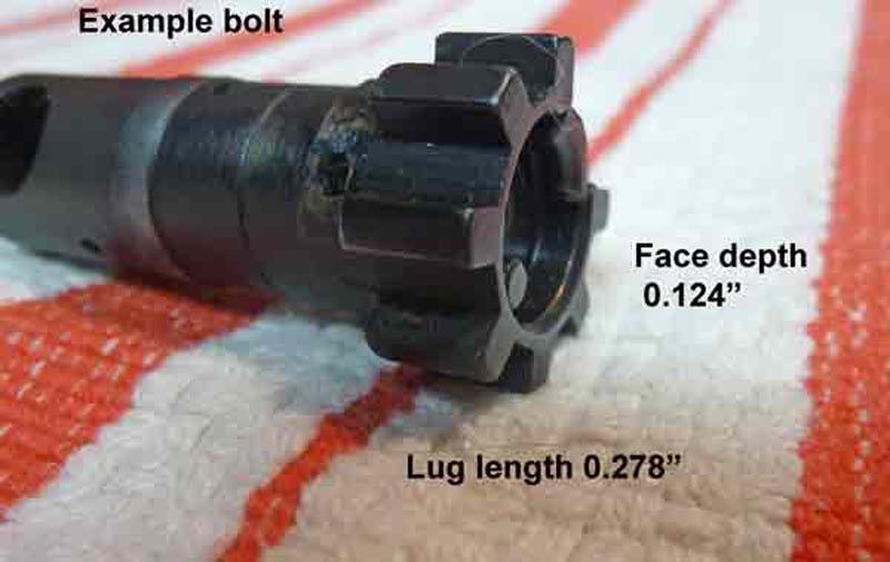

To swap bolts you can measure lug length and face depth and compare bolts for equal head space.
For example, I don't have an AR-15 bolt that varies over 0.001".
IF tail diameter is too large it won't fit. You can measure to compare.
