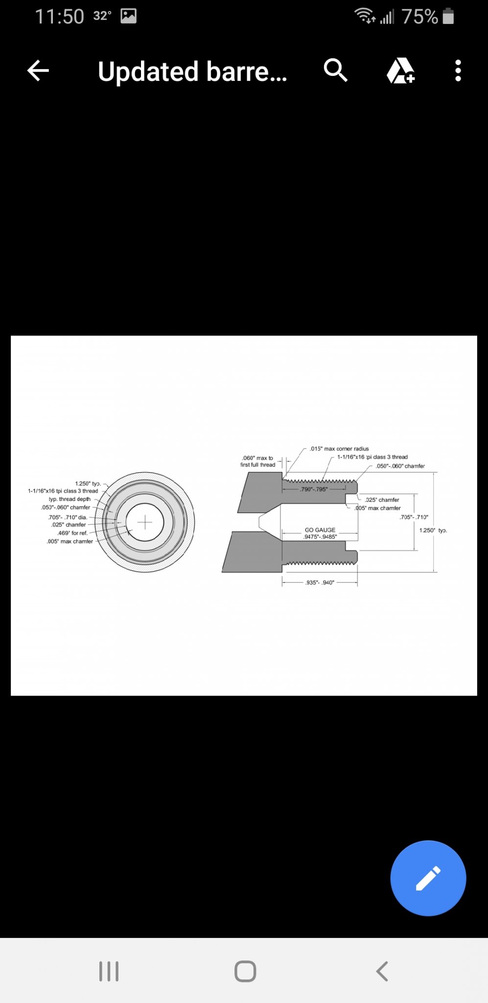

Here ya go. 1-1/16-16 3a thread. .705/.150 counterbore. .950 headspace.

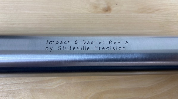

Any competent gunsmith can chamber your barrel for an Impact, so no you do not have to stick with Impact for new barrels. That is just another convenient option. Impact keeps chambered barrels in stock in popular match and hunting calibers. These chambered barrels are called “Impact by Stuteville”. This allows the end user to order an in stock chambered barrel and have it shipped to his door for them to install themselves.
Can anybody confirm these specs? I have multiple impact prefits from pva and proof and the tenon length is around .930 not 950.
