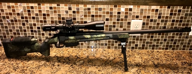

Bit of a different setup but it's finally done.

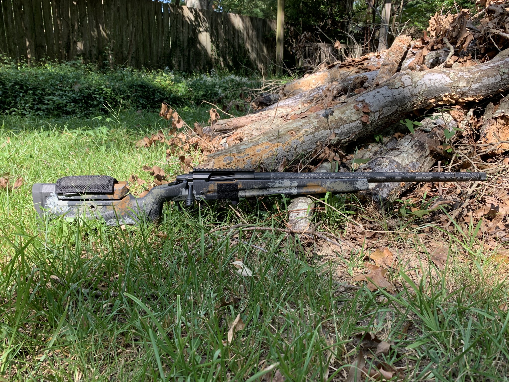

Finally got my Impact Valkyrie build all sorted out and it’s a smooth shooter for sure. The MDT modified mags from CH Precision worked really well on a JAE chassis but not so well on the Manners. I tweaked a regular AISC mag and ordered a Primal Rights 6br conversion and it should feed fine as I have done this with an Axiom build.

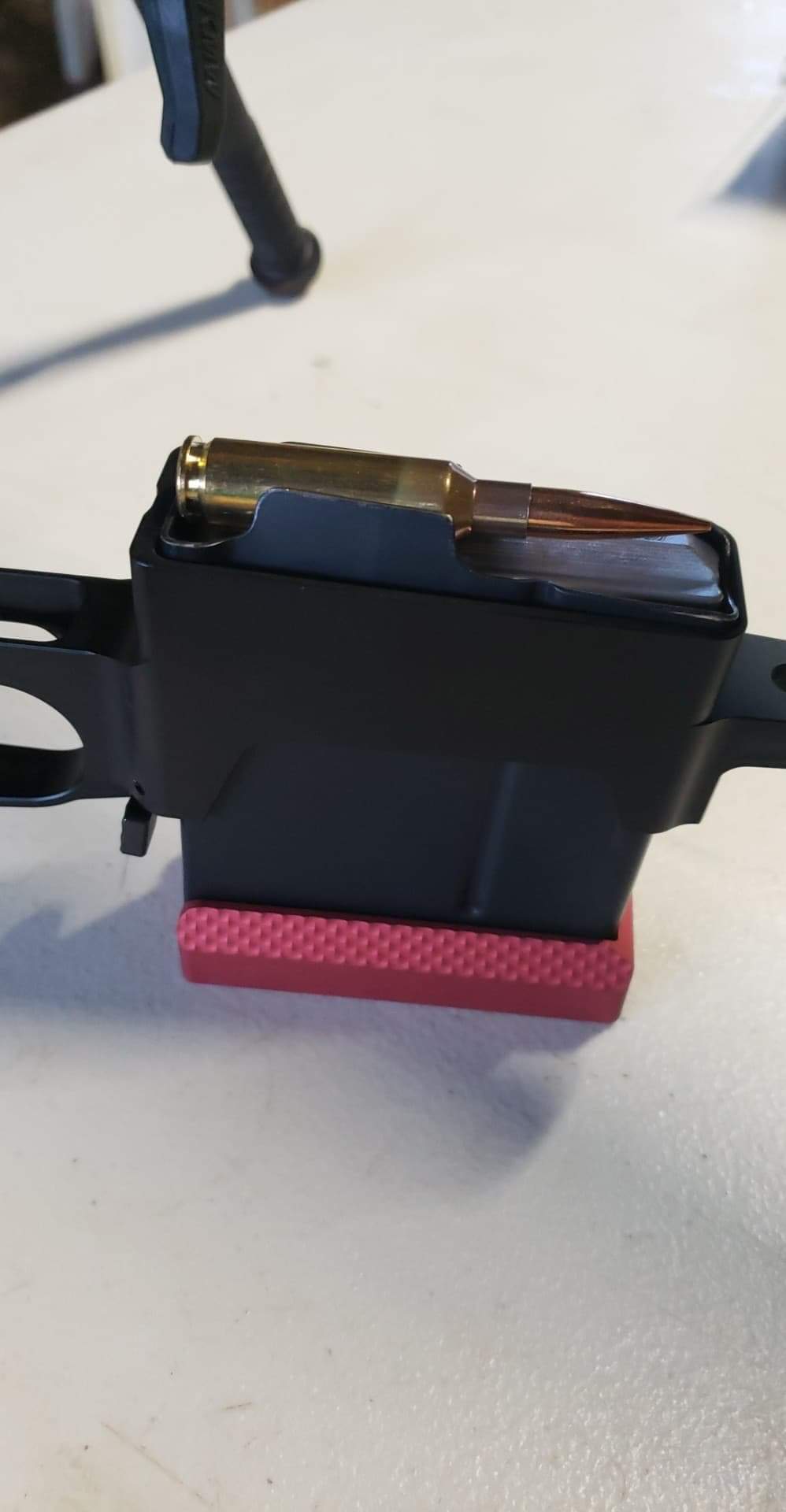

I am wanting to run a ARC magazine bc they are a lot shorter with same capacity. I was wondering why it doesn’t want to fit just right in my Hawkins BM...
The tab for mag catch latch need to trim a little..i filled a little.so basically the oal legth of the mag with mag catch is several thousands longer that internal oal length for hawkins bottom.its easy fix
