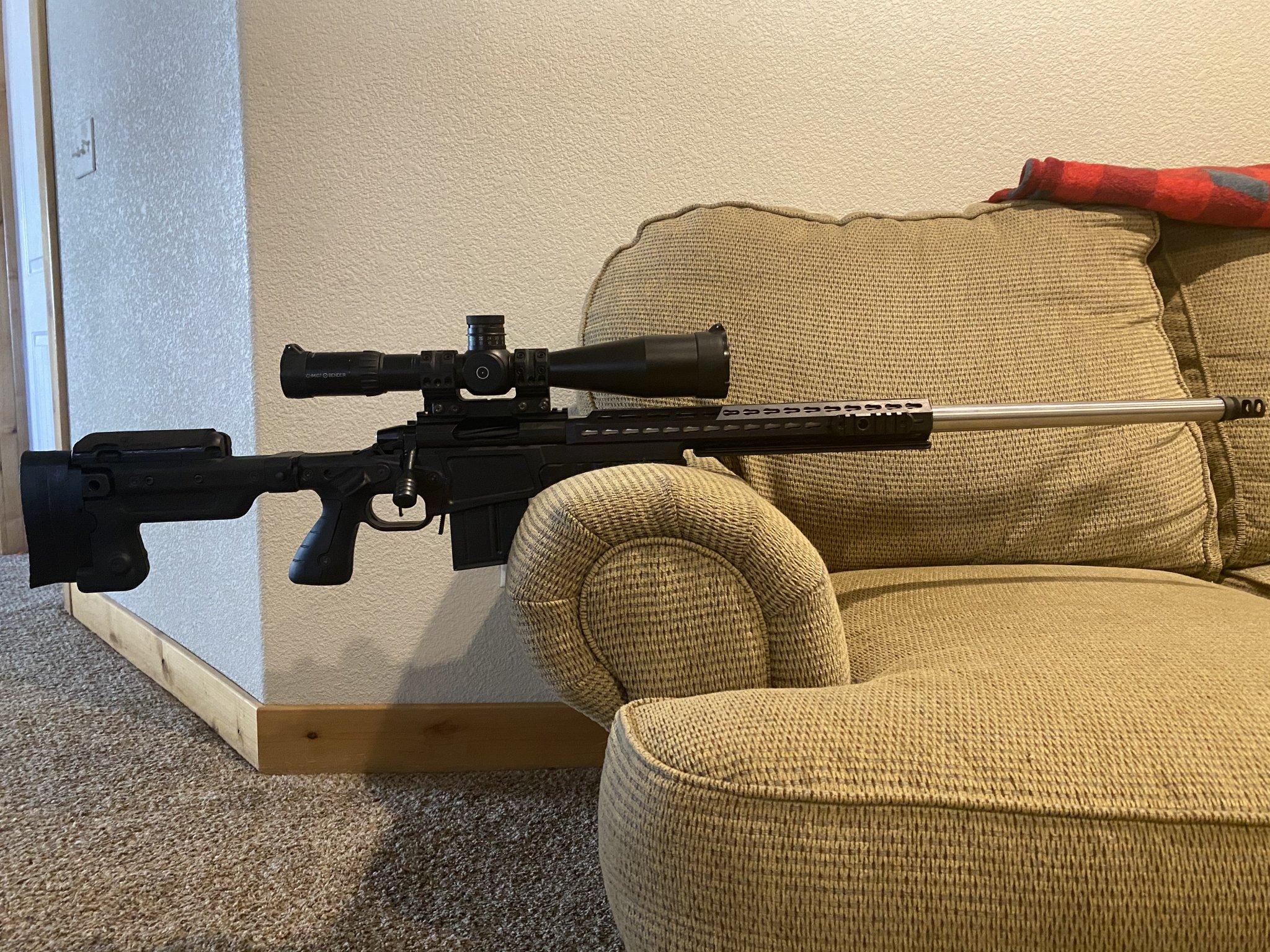

I bought my Impact 6.5cm barreled action from Altus this January having never felt one in person, and only based on it’s reputation and user feedback. Dropped it into an MPA chassis on my own, and it shoots absolutely lights out. Easily holds .6 MOA with bulk Hornady American Gunner 140gr.
I was also a bit worried about dropping that much on a rifle without getting hands on, but it’s been an absolute dream. Paired with a TT Diamond and properly tuned mags, the bolt is insanely slick and takes VERY little effort. I’ll be an Impact customer for a very long time.
congrats on the new rig. Sounds badass!
I’m changing up my rifle to one that’s similar to yours. I’m glad to hear your is running smoothly and shooting the groups it is.
That factory bulk ammo from Hornady is actually really decent. My pops and I have been able to get one hole groups with it at 100 while most spanning 1/3”. Mainly use it for warming up the barrels, or fouling shots. Plus some extra brass never hurts.
The only difference in the new rifle coming at the end of the month for me is I’ll have mine in a Mdt acc chassis. I’ve only ran aw mags in the past and now I need to switch. Ts said he’d try and get an aw cut impact for me but I’m not counting on it, because It seems like their hard to find or special order. Can you help out with telling me the mags you’ve ran so far in your rifle chassis with the impact?

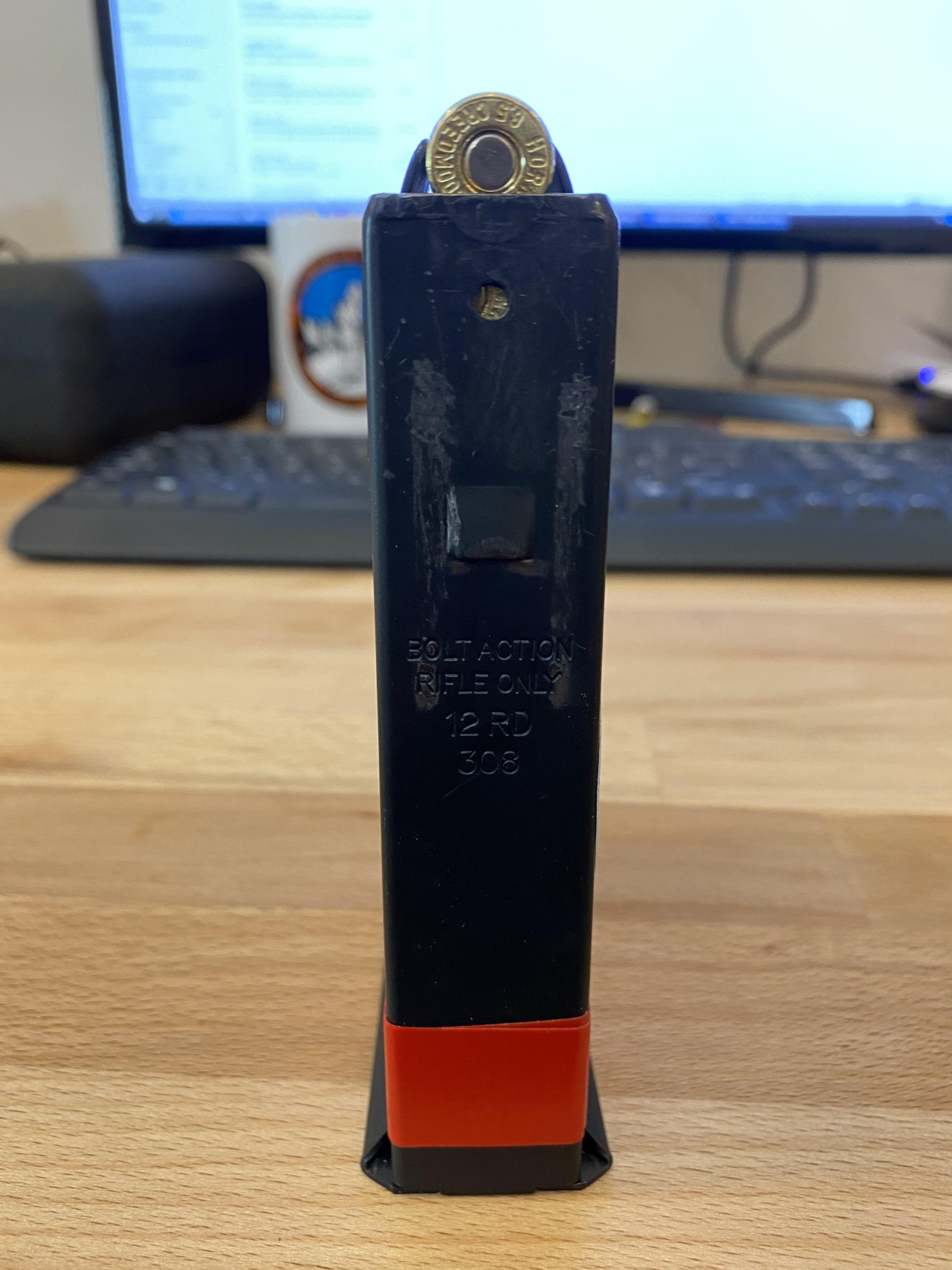

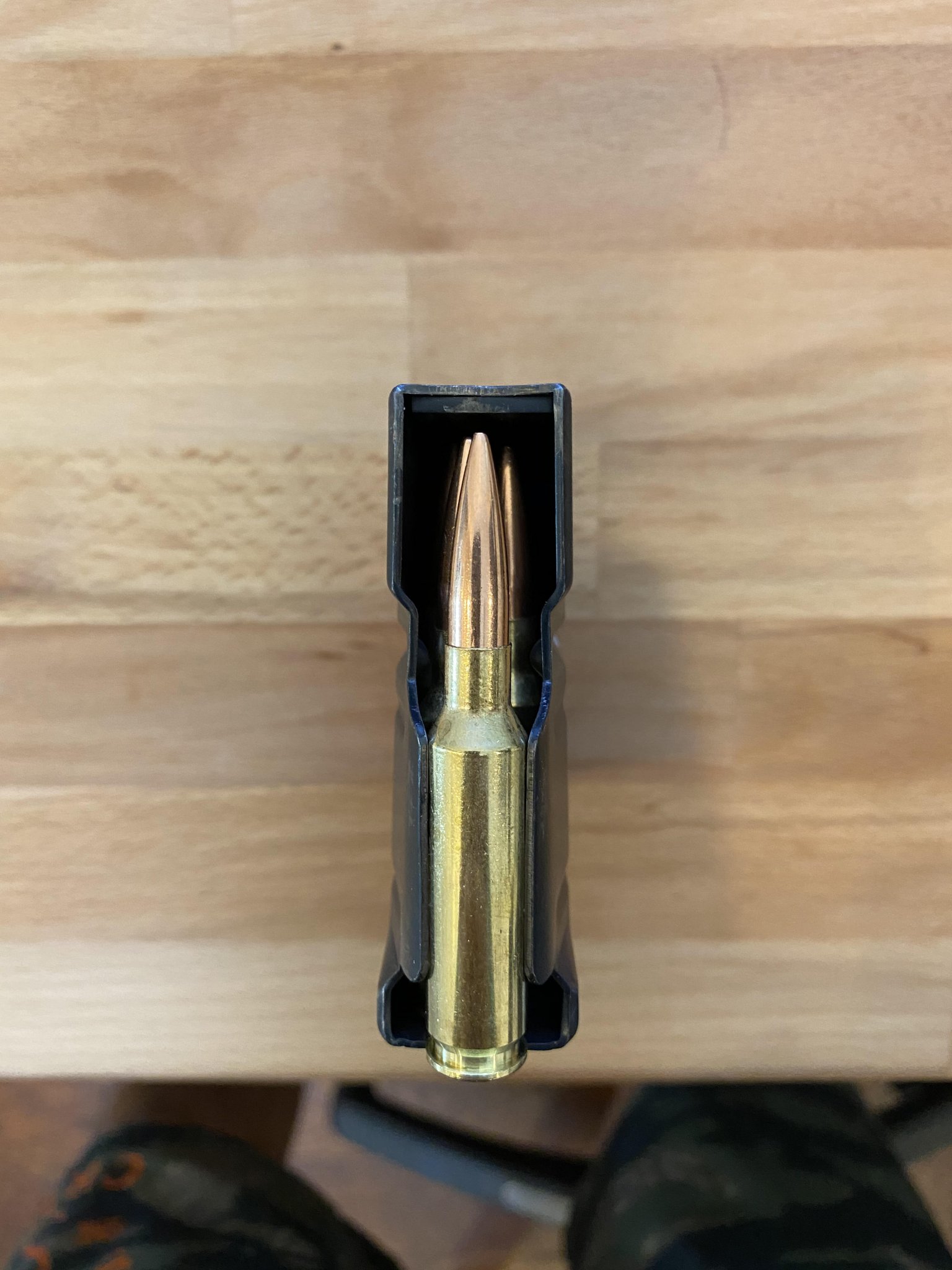

I'm running the MDT AICS mags with binder plate, both the 12 round and 10 round versions. Once I tuned the feed lips, they've run perfect. I use a micrometer gauge to get them to 0.408" wide, even across both the front and back of the lips. I'm running factory ammo, and both the Hornady American Gunner 140 HPBT and ELD Match 140gr fit great. Here are a couple pictures of how I'm running my magazines.
Reactions: Tweedycarcass23jonb
View attachment 7303762View attachment 7303763
That’s super helpful thank you. I appreciate the help and taking those measurements too. ??

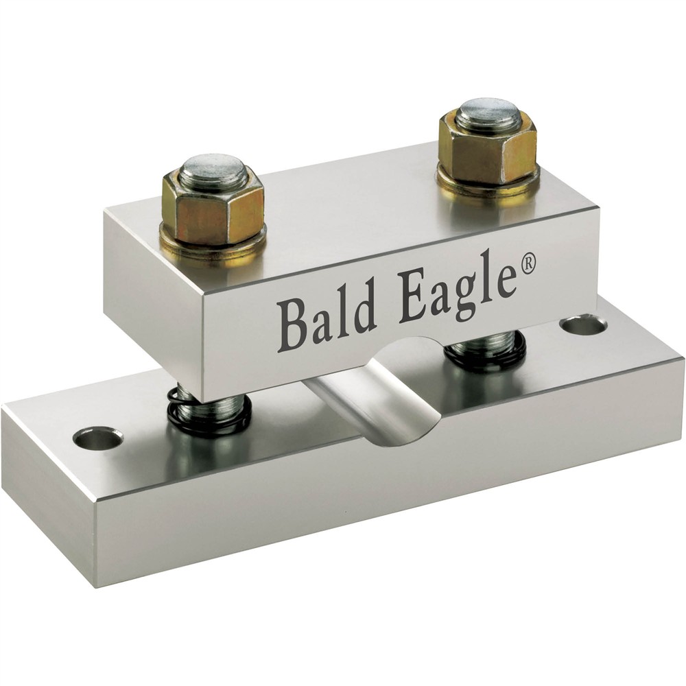

What barrel vise and action wrench’s are you guys using?
i dont recommend this vise ^^^ i have one and it takes a ton of torque and rosin/sand paper to hold my barrels...i have to tighten it to the max to use it
the shop has this one ^^ and it holds much better, with less effort and no rosin/paper, dont need the leather either...i can tighten and loosen it with one hand pretty much
